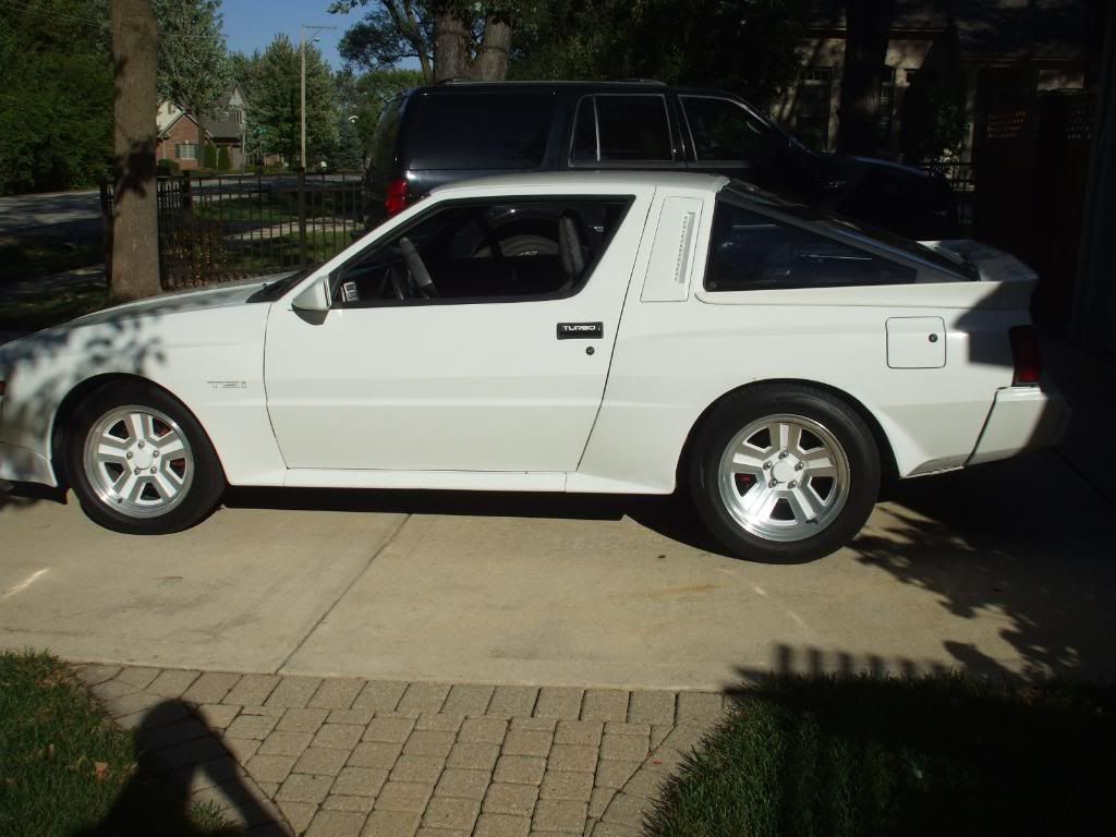

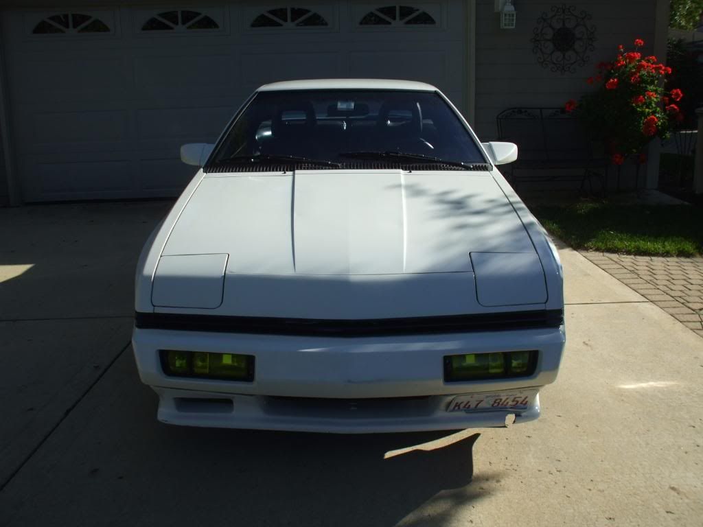

    before she was put away

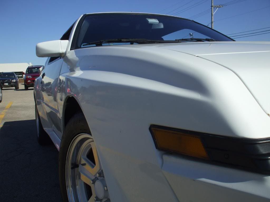

    sunkennnnnnn
    4x4

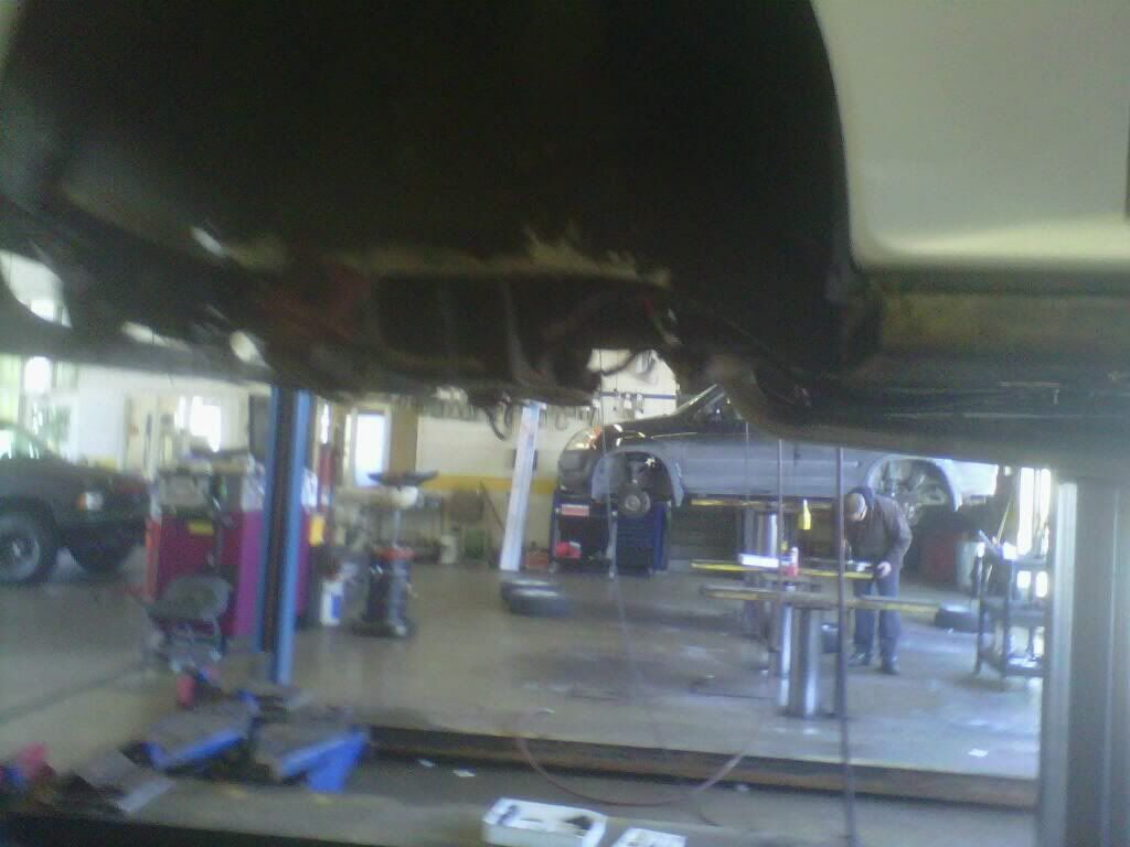

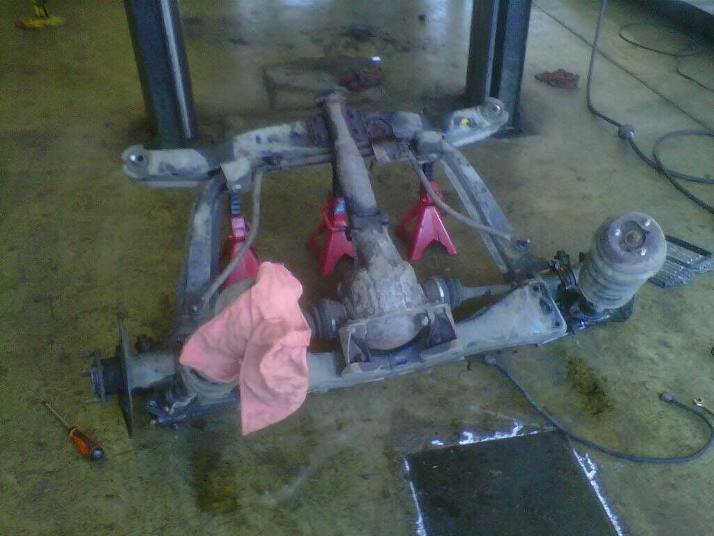

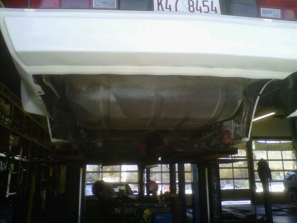

    Now... Here is some good ol disassembly...of 23 years worth of corrosion. It has taken weeks of periodical work to get all this damn rusty shit out. Dropping the rear end was a beautiful 6 nuts, but getting it down piece to piece is a challenge.

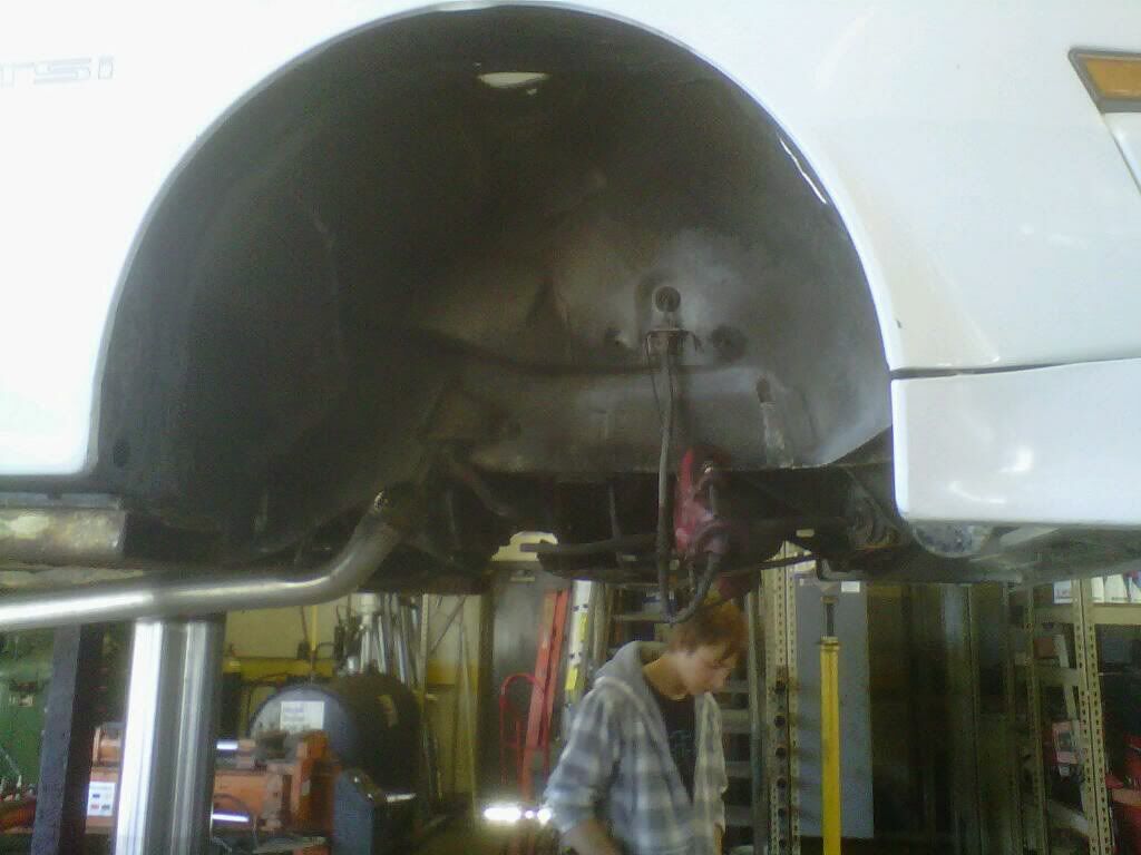

    and the front end all nice and empty
    I am getting down to the last main bolts for the A arms out back. I have to cut them out because every single metal inner bushing sleeve has seized to the damn bolts, which is preventing them from coming out because, well, the sleeves are bigger than the holes.
    From there, its refinishing time, and reassembly time
