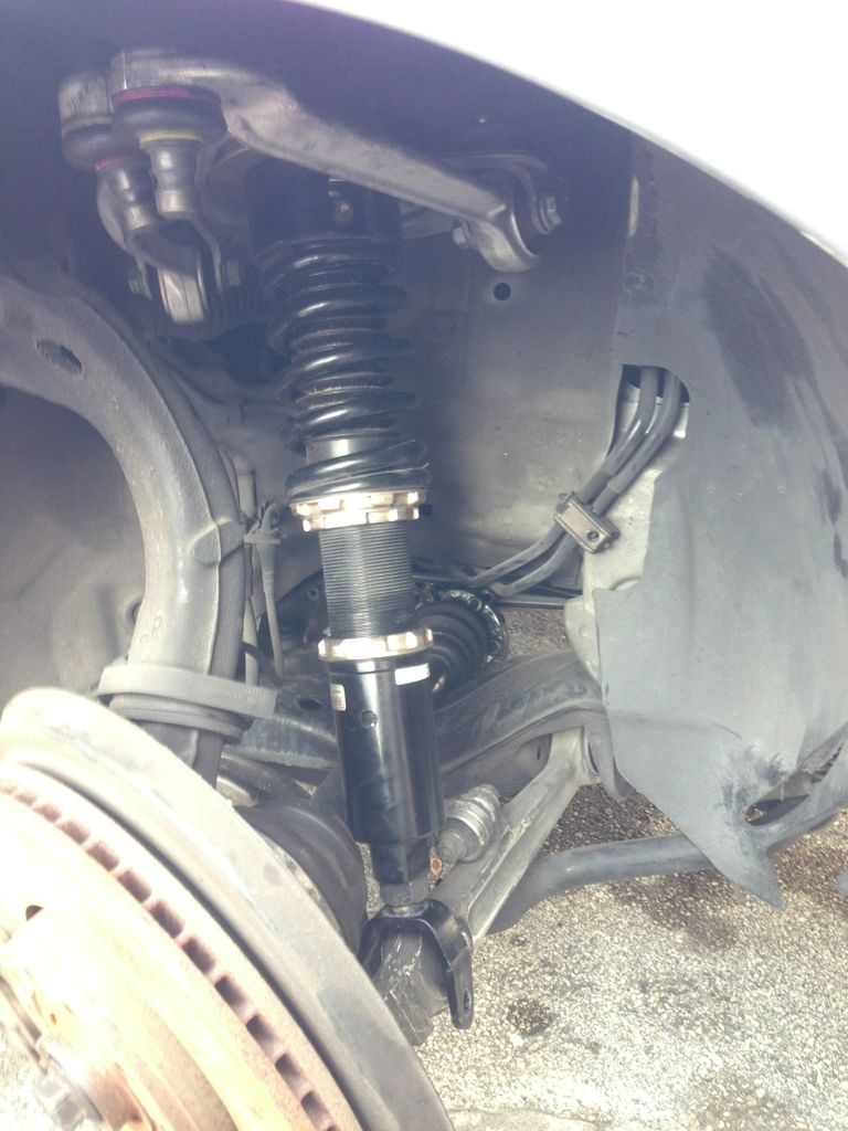

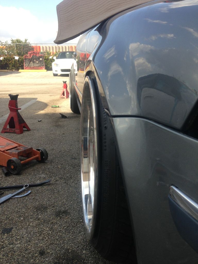

      10K front springs, 8K rear springs, fully threaded shocks, threaded adjustable fork mount, 30 way adjustable shocks (of course set to full stiff.) Basically what you get with airlift struts but with a spring instead and more serious dampening.
      In this pic, the shock is all the way down, the fork is set at its lowest setting, and the preload is all the way up.
      I think its undriveable at this height because the control arms are probably resting on the frame, and if not they are very very close. I'm gonna try to get it driving very close to this height. I'll raise it 1/4 inch and see what happens. They should be pretty damn stiff so i might be alright. On that note, I was able to turn the wheel which is a good sign.

          • Wait a sec, you haven't cut reliefs for the upper control arms and you're at that height?
            Strictly Pleasure/Zero Clearance/Stretch Your Legs
            Alex

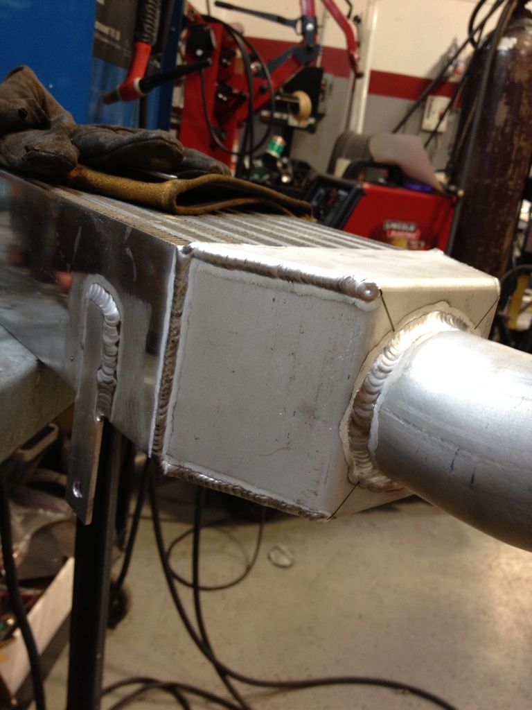

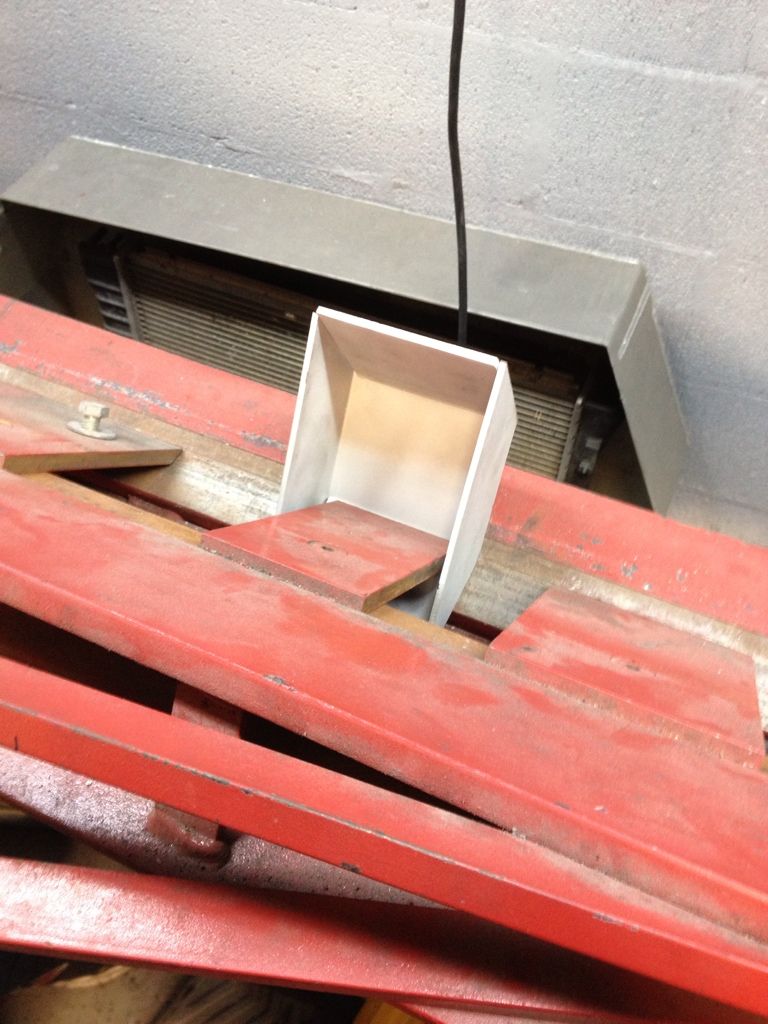

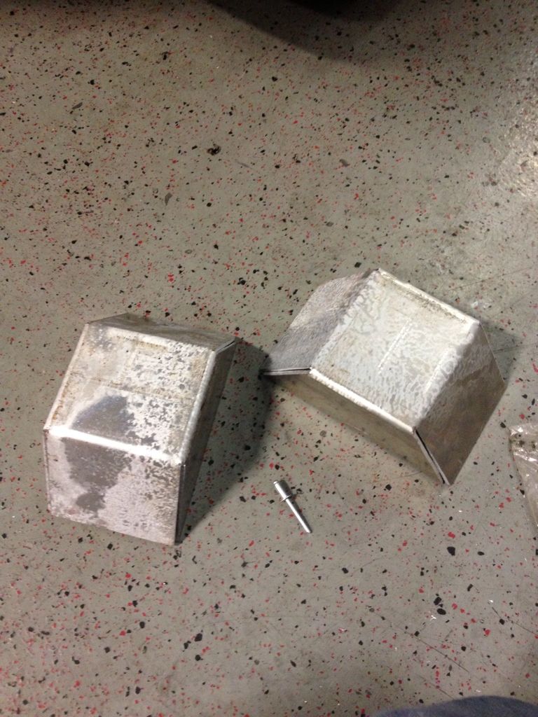

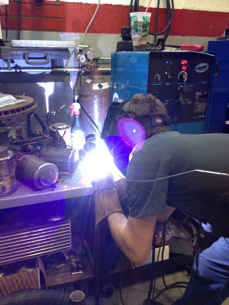

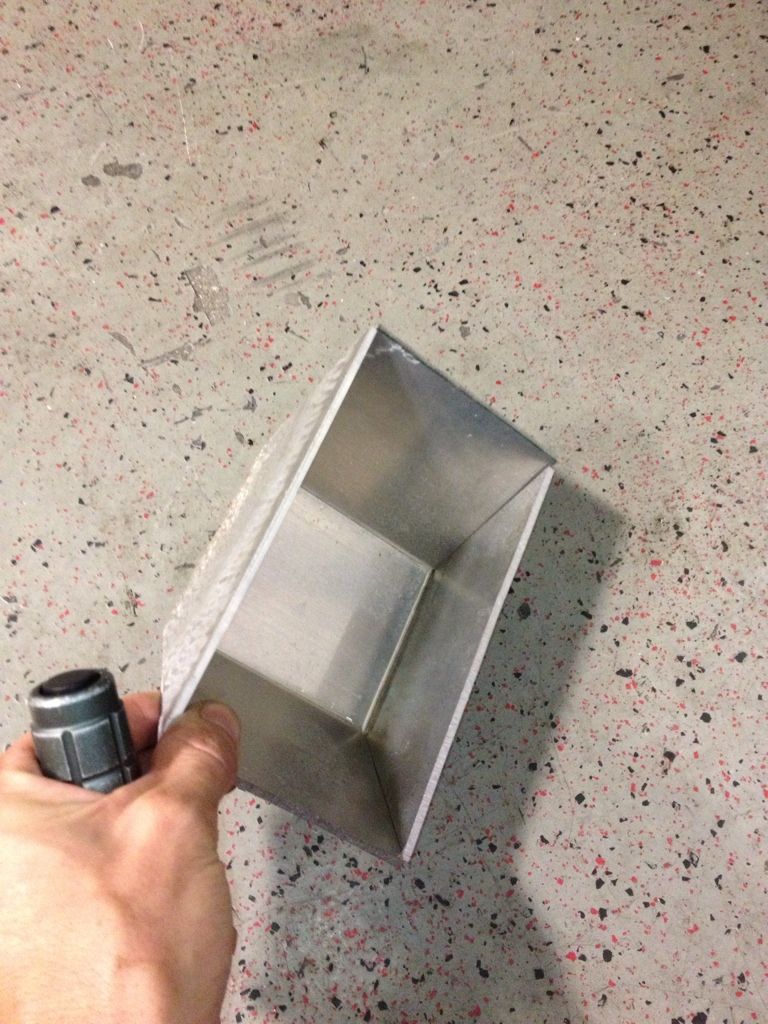

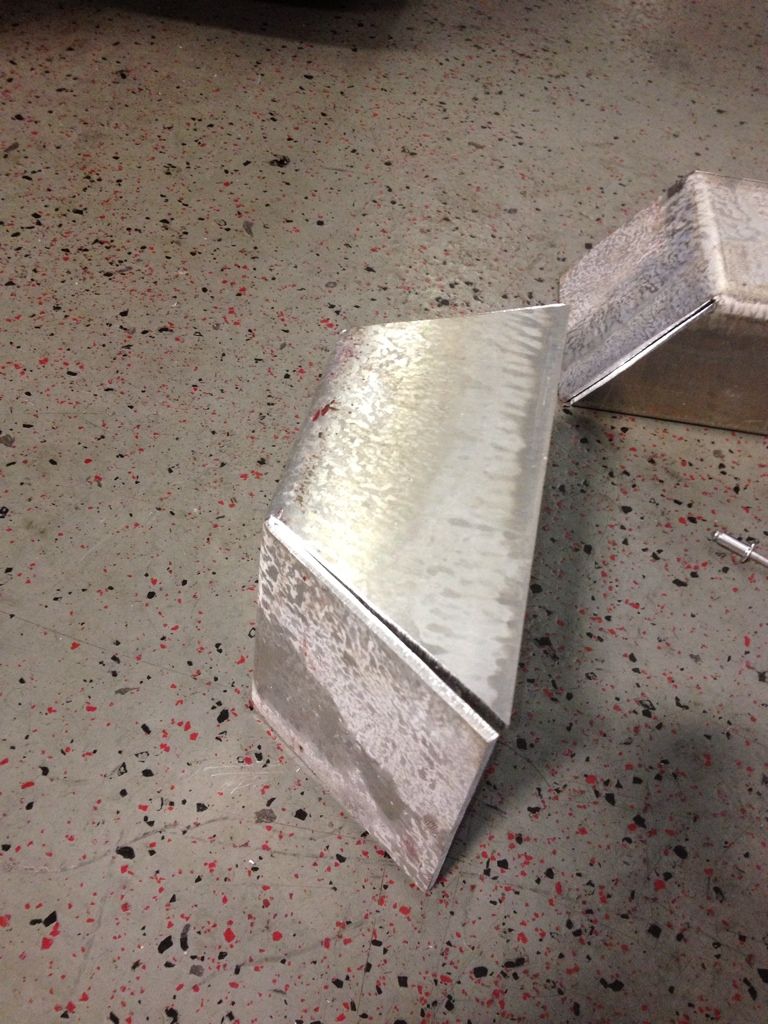

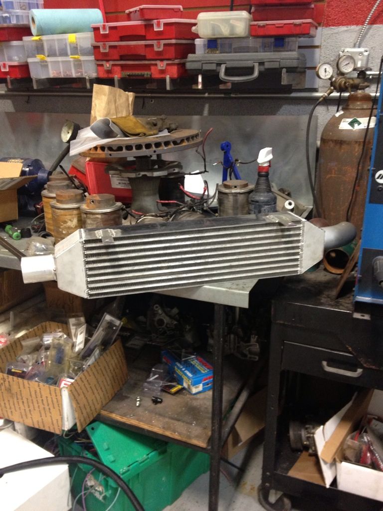

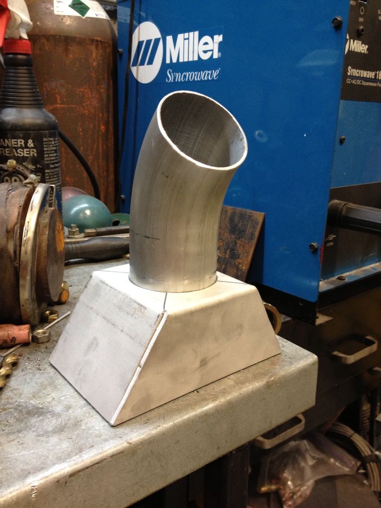

              Folded up some aluminum
              Then Jared welded them to the intercooler
              Mounted. Nice and stealthy.

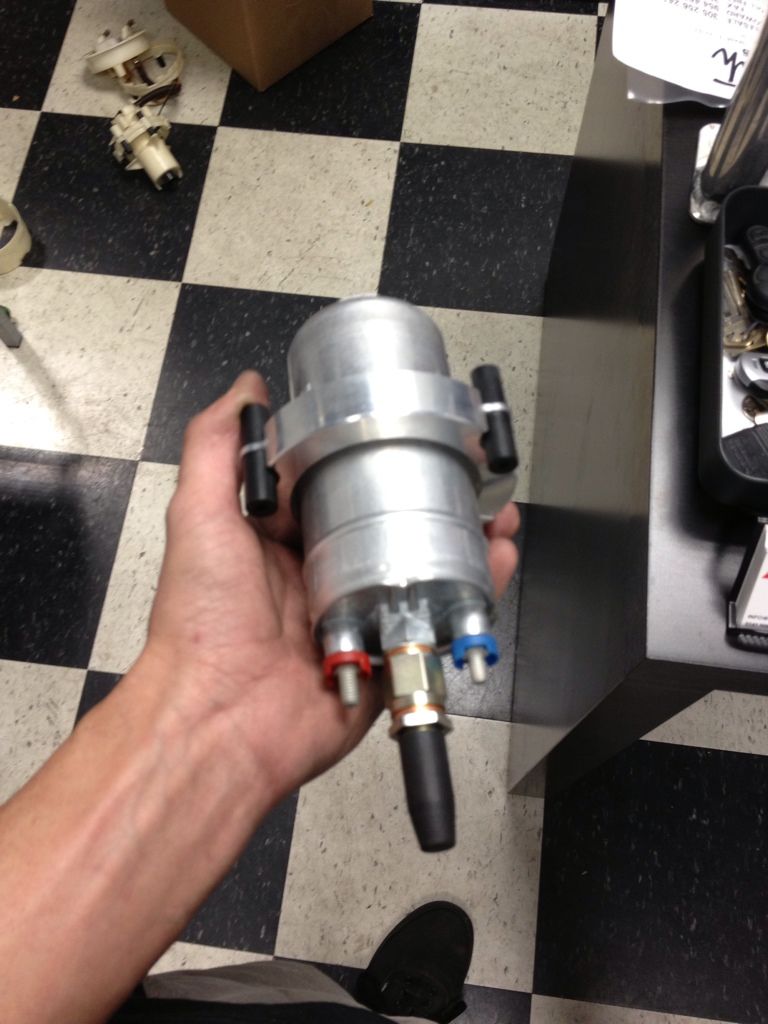

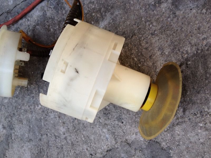

              Next up is figuring out how to get this fuel pump to mount. I bought the 034 Motorsports billet fuel pump bracket for the bosch 044 pump
              Pump didnt come with a pre-filter, so we came up with something to mount the stock one to the pump, but I gotta wait for him to make it on the lathe.

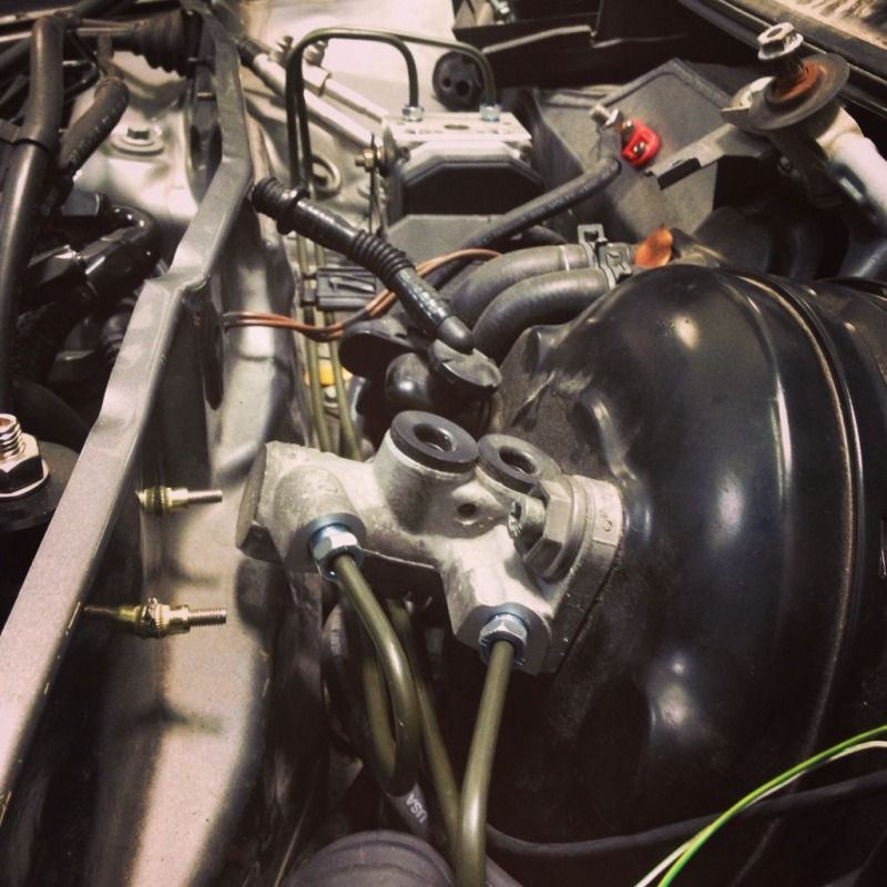

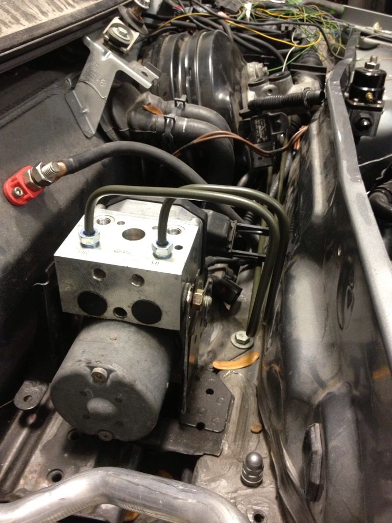

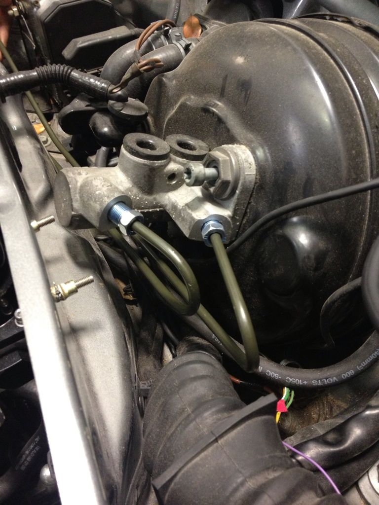

              Also started bending line for the abs relocation

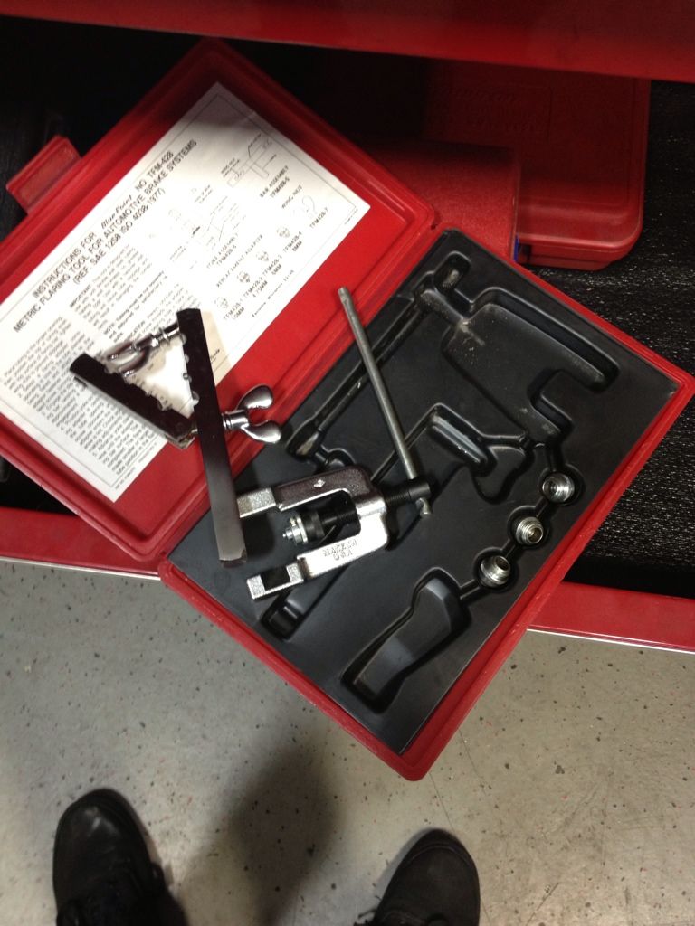

              First time we use the bubble flare tool

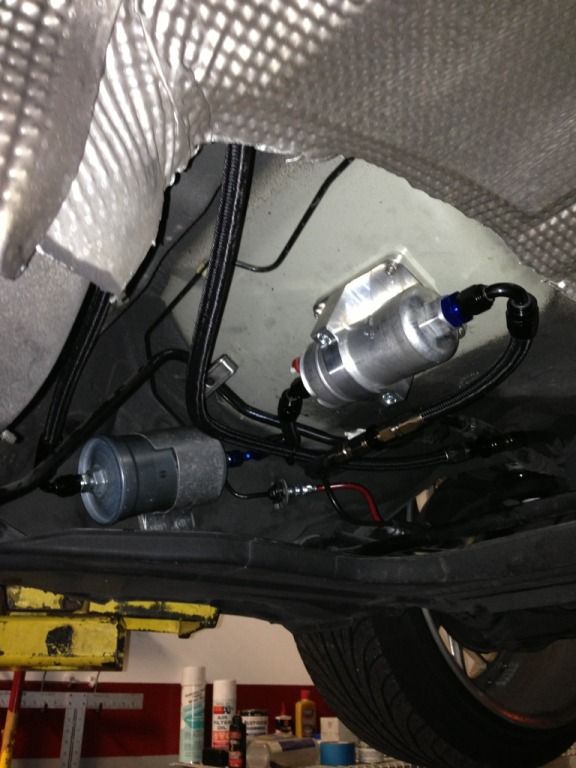

                Without fuel I won't be starting anything, so I finally had to sit down and figure out how I was gonna tackle that. The 034 didn't end up fitting in the tank, so plan B was either a surge tank, or just inline. Surge tank is a bit expensive and I'm always weary of them as I've heard you can have cavitation issues, so I decided to just do it inline. The stock pump will feed the 044, which will then create the fuel pressure.

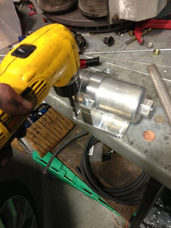

                First things first, since I'm using rivnuts to mount it under the seat I had to drill out the holes on the bracket

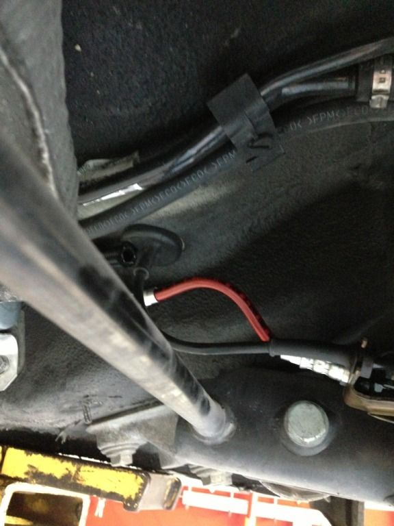

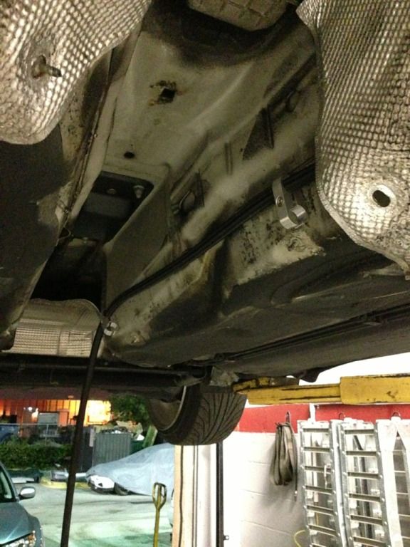

                All braided hose back to the factory rubber hoses that feed into the tank

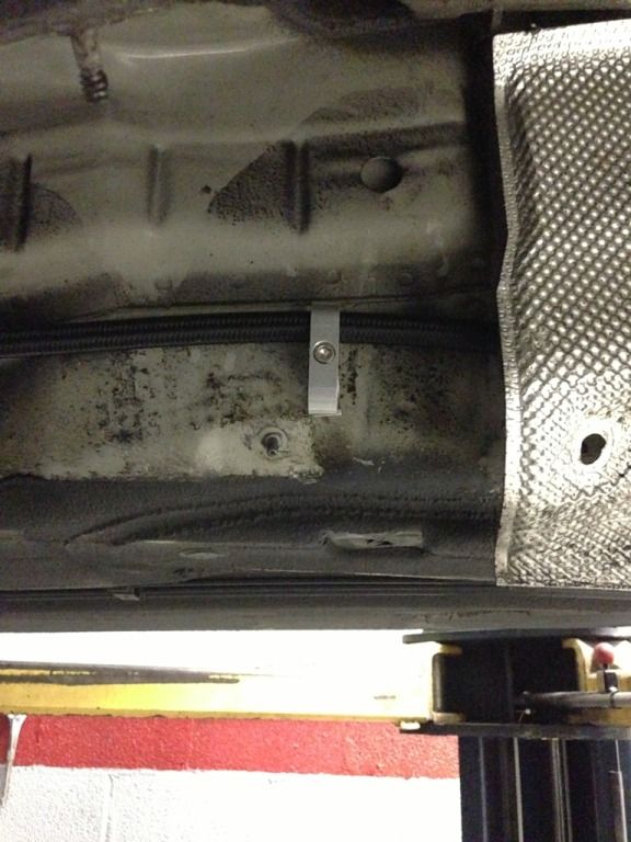

                Used a few clamps to secure it to the body

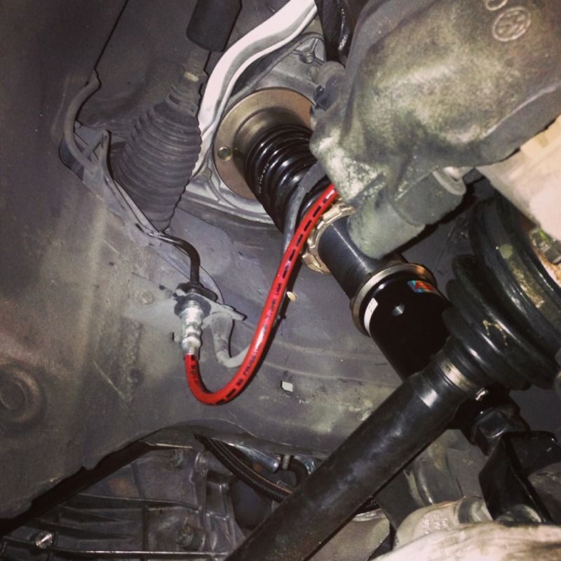

                Did the ECS stainless steel brake lines while I was back here
                Used the integrated engineering fuel filter that comes pre-fitted with -6 fittings and mounted the pump
                Finished making all the hose and secured everything.

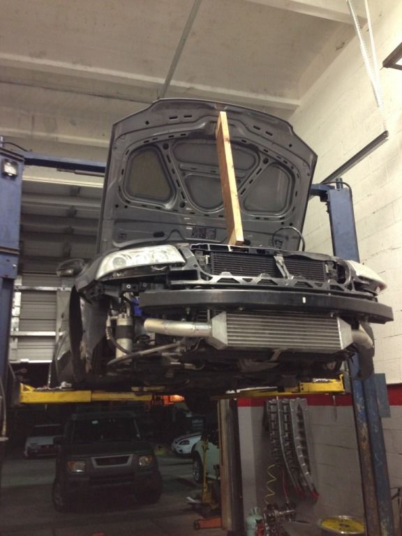

                Also finally finished the intercooler. None of the pipes stick out past the grill

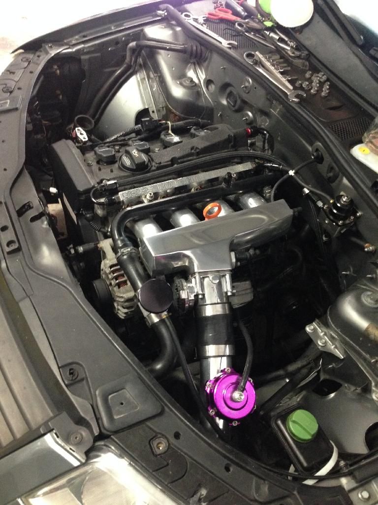

                Someone stopped me and took a pic of the engine bay at sowo

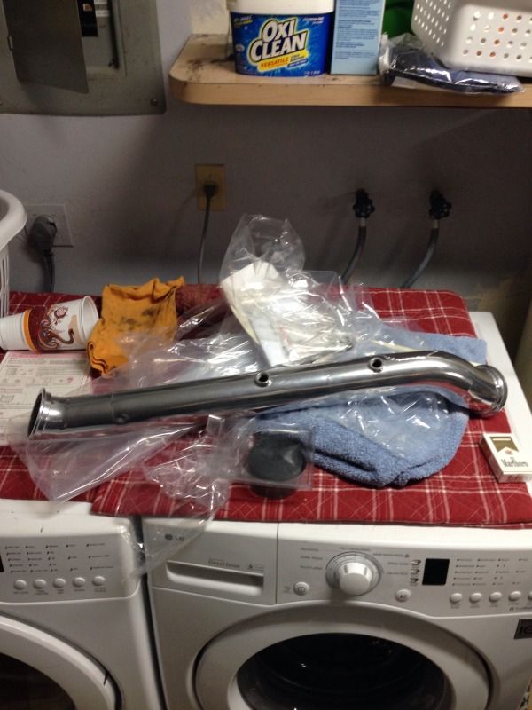

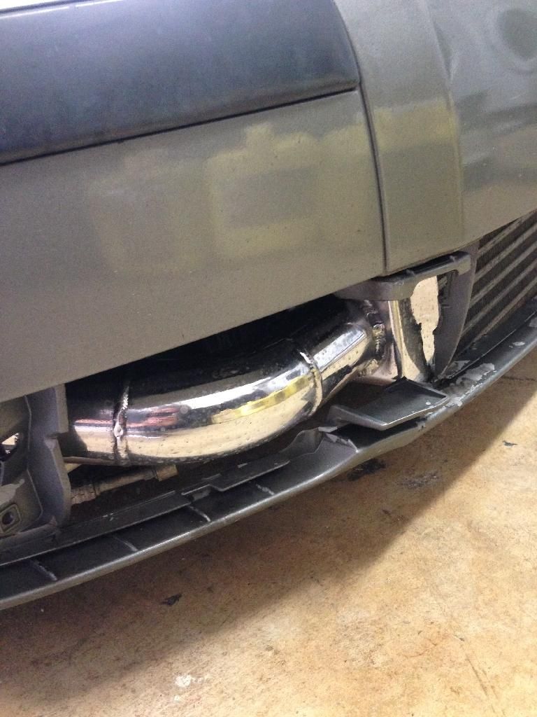

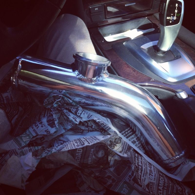

                • Sent intercooler stuff to the polisher and got it back a few days ago. I got bored one night after I ran out of trees to smoke so I started putting it together
                  The fucking ding on that pipe is driving me NUTS, but there's nothing I can do for now. Luckily its not very visible with the clamp in place.
                  Got the clamp polished too.
                  Now I need to trim the bumper to fit the intercooler. Started already and it fits much better.

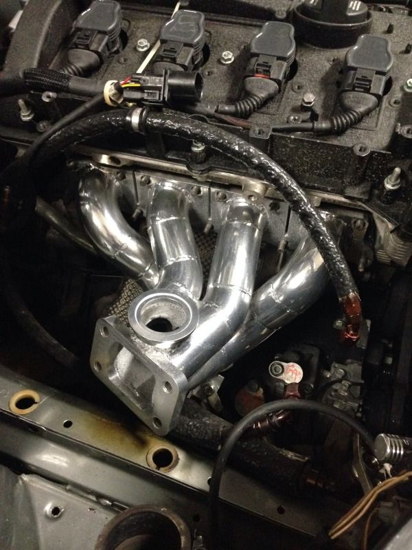

                  Remnants of the oil leak on the turbo and burnt paint. Gonna clean it up some today. All the hot shit, including the turbine housing, manifold, and downpipe are now off and getting ceramic coated. Turbo is getting a new comp wheel and thoroughly cleaned. Then once its all back it will be wrapped in fiberglass insulation to further reduce heatsoak.

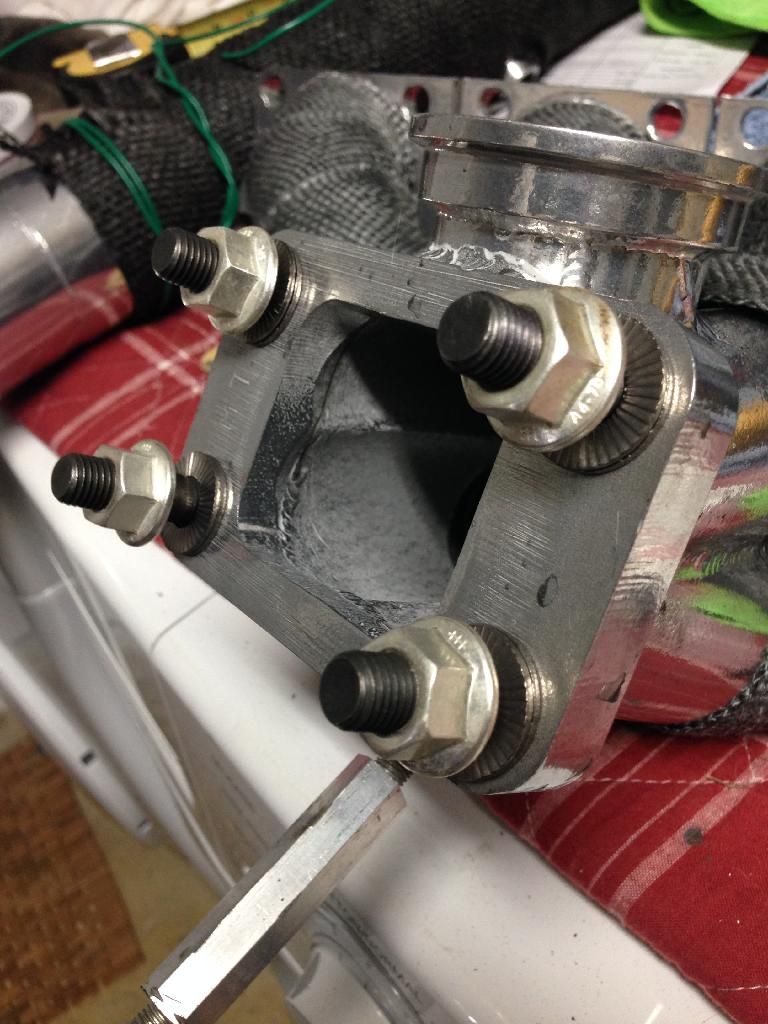

                                My box from full race came in. Iconel steel studs with silver plated nuts and anti-vibration lock washers. I was gonna drill the studs out to put a cotter pin, but I want to give these washers a try first.

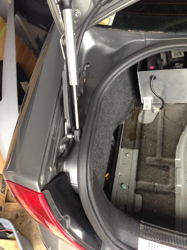

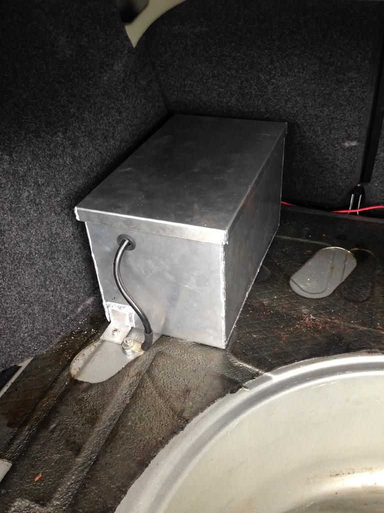

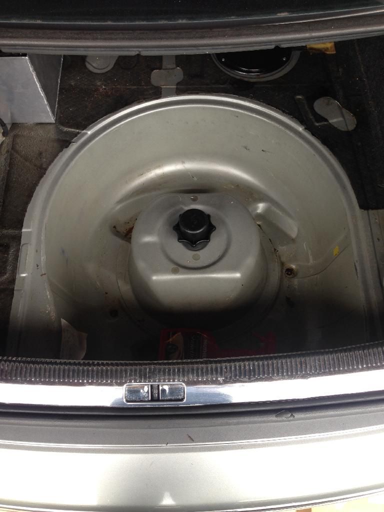

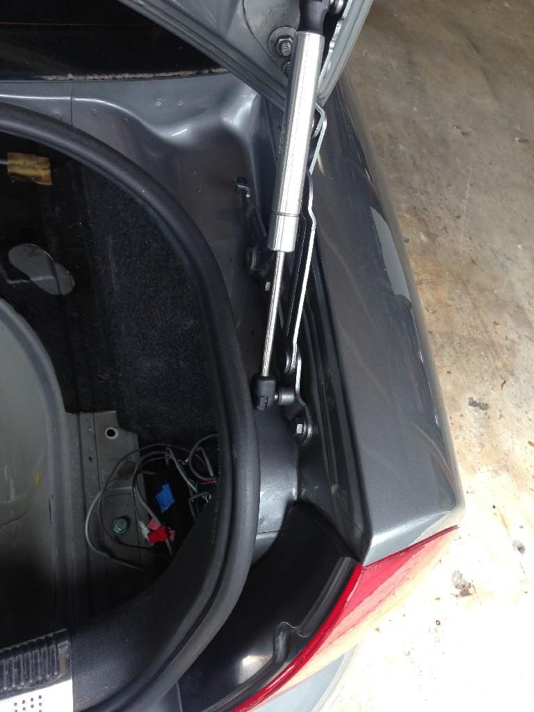

                                My battery box in the trunk. Jared made it for me but I'm not sure I want to run it. I'll leave it for now but I'm gonna try to hide the battery instead so the trunk looks stock.

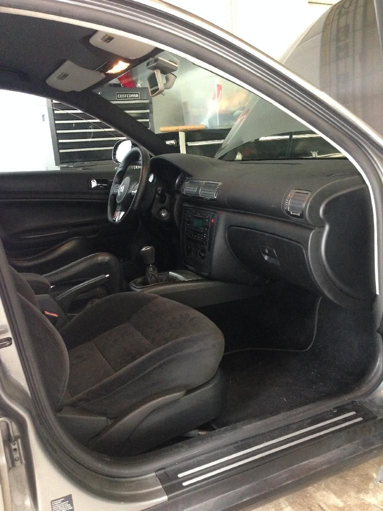

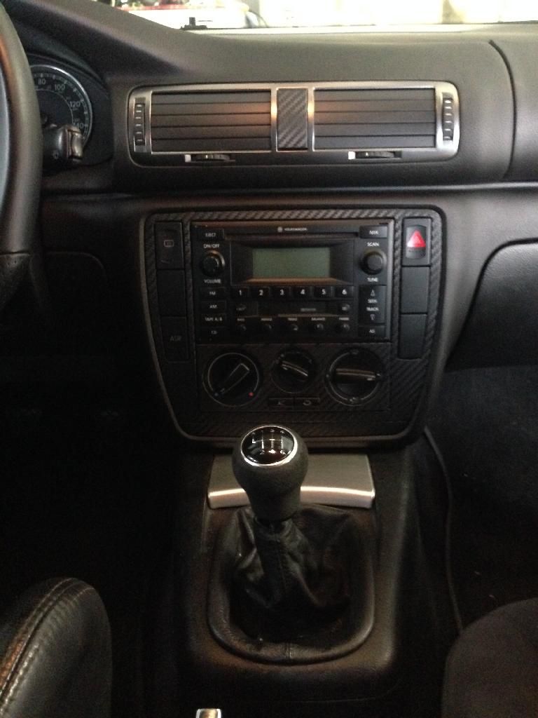

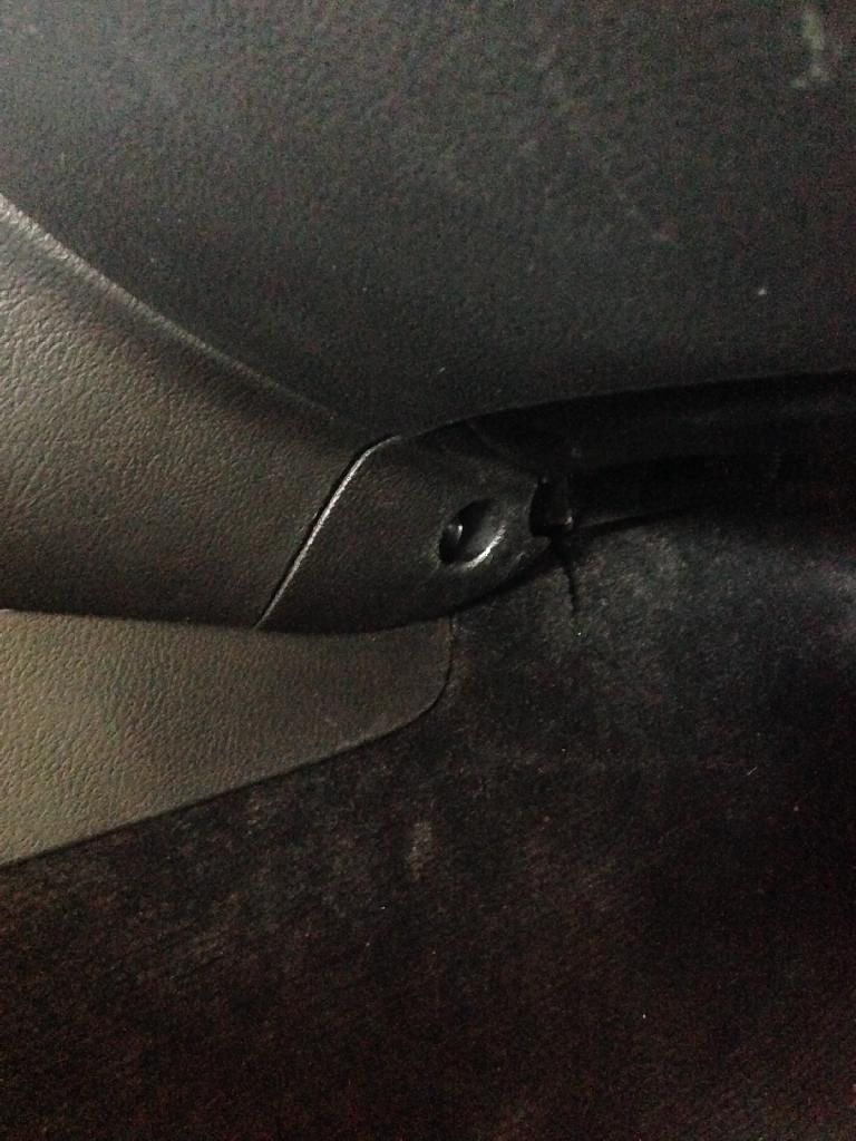

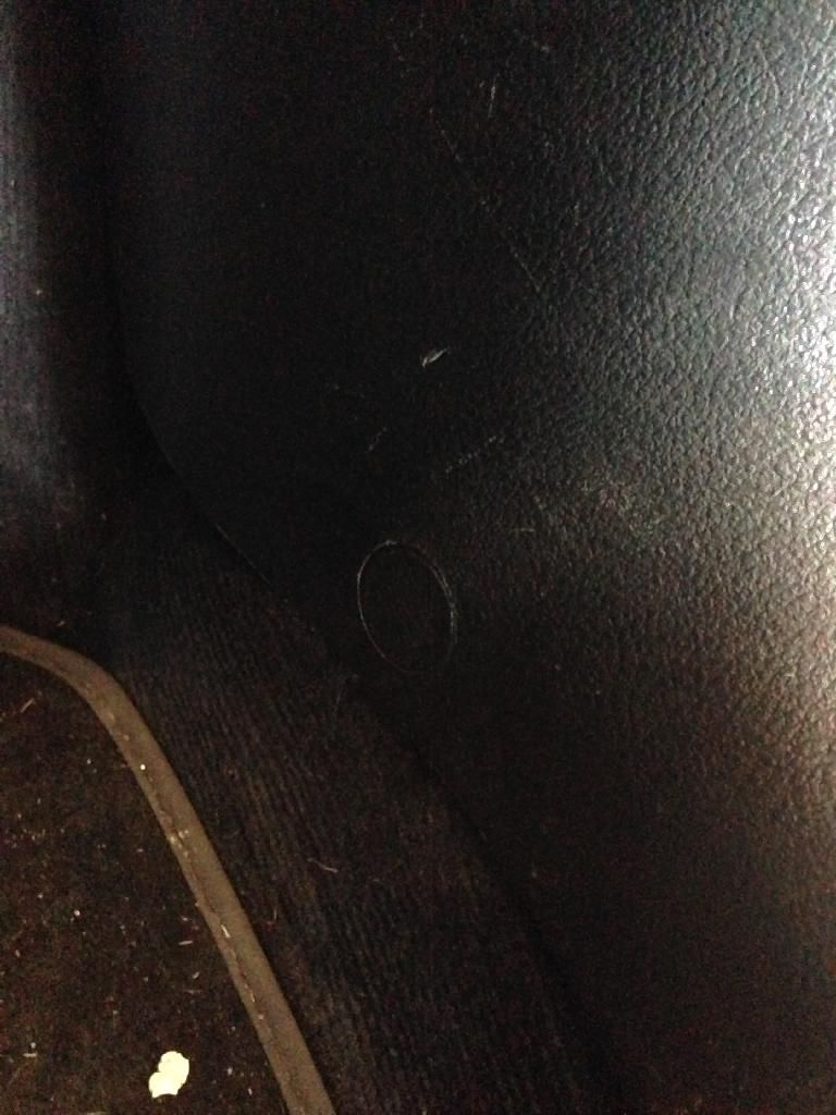

                                I've also been tidying up the interior. Replacing any missing screws or covers with new OEM pieces.

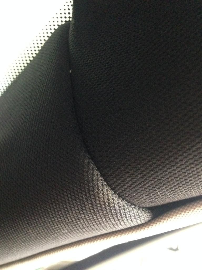

                                The headliner came back from the upholstery shop. I didn't want to go with the typical suede for a more OEM feel. I forgot to take more pictures of it but I'll get some up.

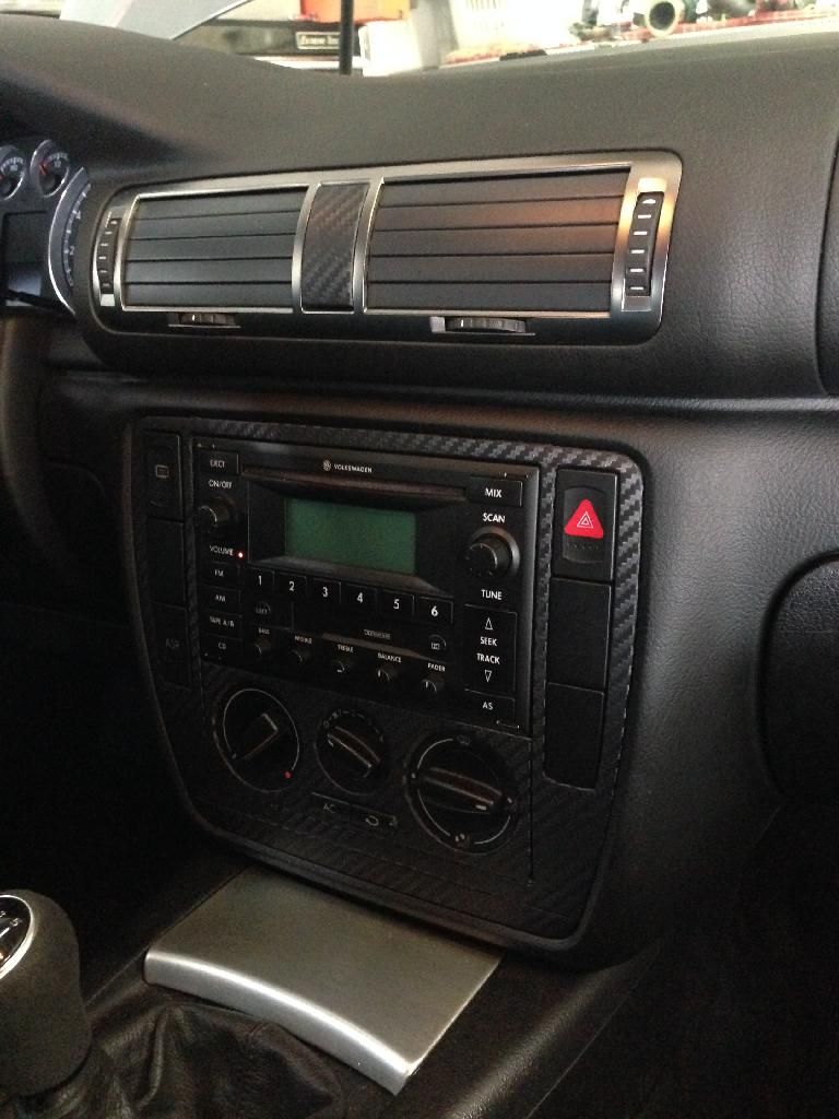

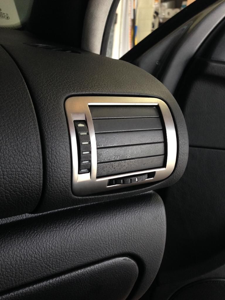

                                The Skoda vents in the new dash.
                                Net optic ash tray sanded down to a brushed aluminum finish, and RS4 shift knob, need a boot for that. I'd like to eventually replace the wrap with real carbon.

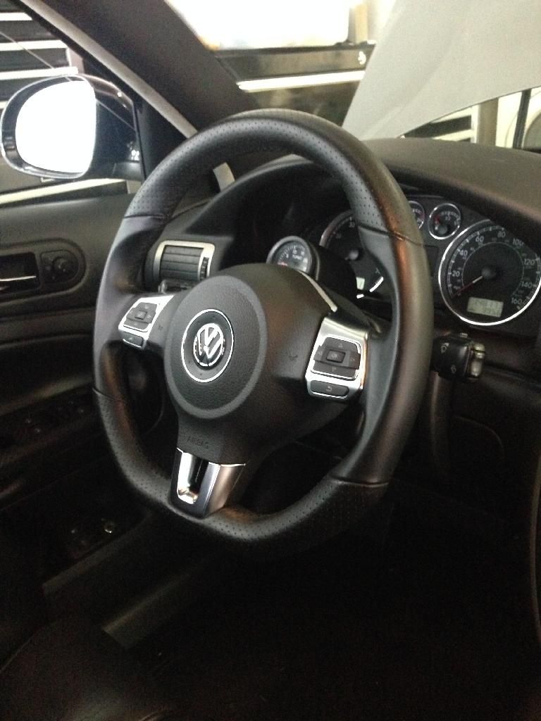

                                I love the Passat cluster. AWE boost guage with a new south pod. I **** it because the cover squeeks. Its a shame they don't make the 42dd pillar pods for the Passat anymore.

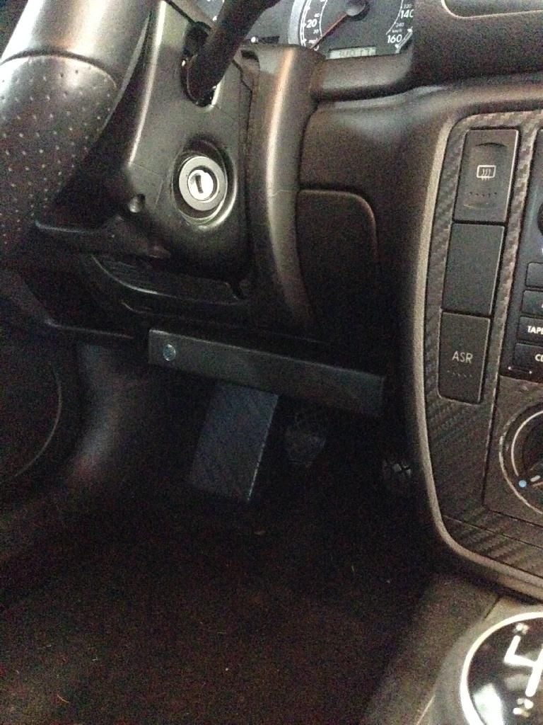

                                The knee panel is kind of a pain in the ass to install properly, but its in there with all the proper clips and screws.
                                Haven't had these pieces in like 5 years, finally picked up a pair from the dealer.
                                New plugs from the dealer as well for the kick panels.
                                The wheel again just because I love it.
                                You can see the headliner in this pic too, I need all the black headliner parts.

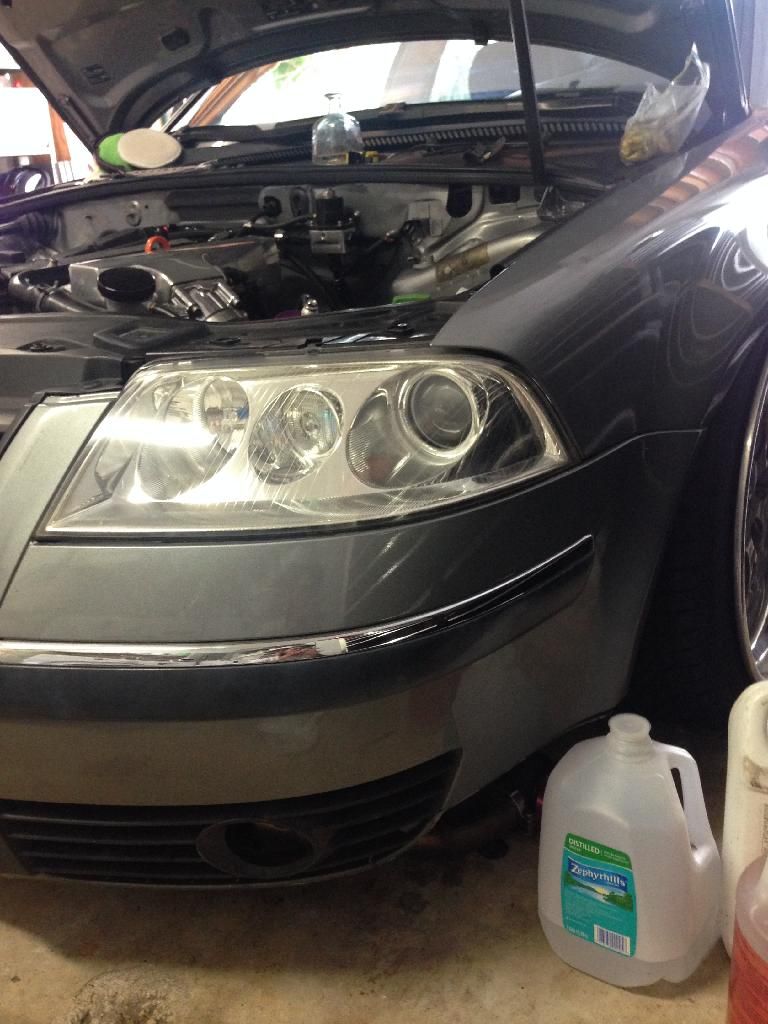

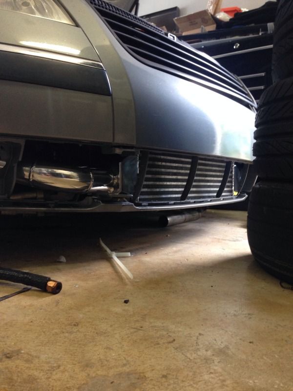

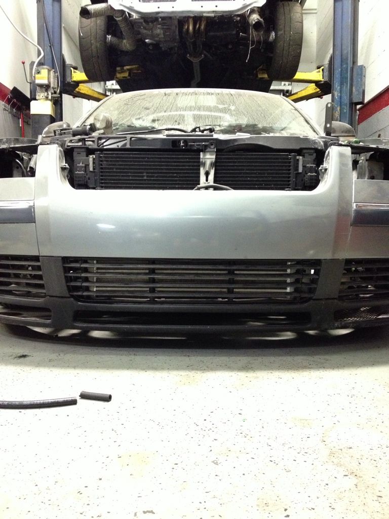

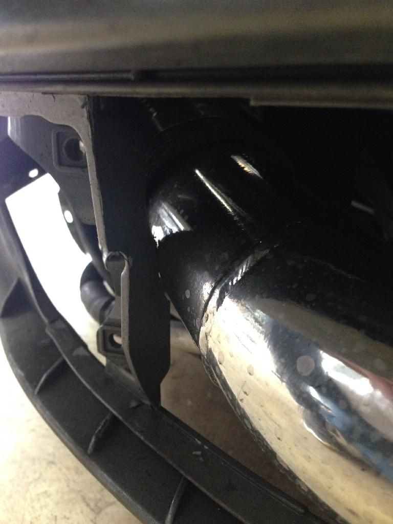

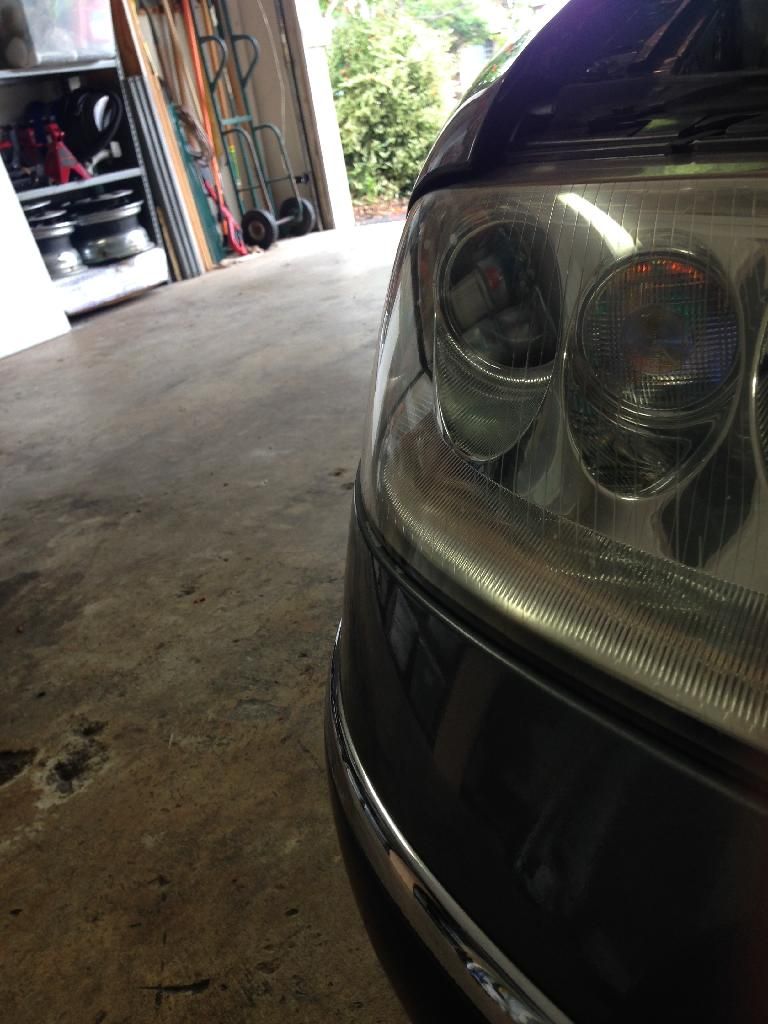

                                Ive been trimming the bumper to fit now as well. Now that the intercooler is polished I don't want the bumper rubbing on it and marring the finish.
                                The body guy is gonna clean it up nice when it gets sent off to paint. Still want to trim a little more just to make sure it won't rub.

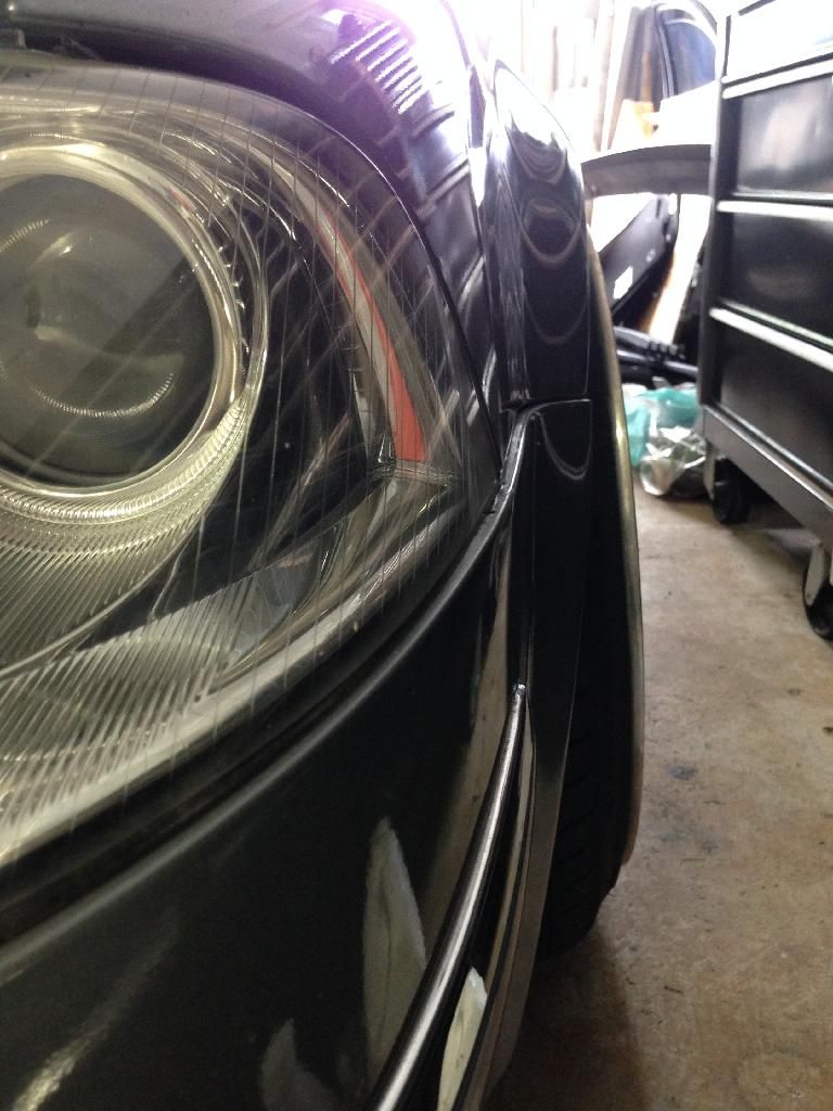

                                The bumper fits MUCH better now. This side was sticking out the worst. Once the bumper is on properly I can mess with the headlights a little more to get the fit perfect.
                                It's still not great, but considering it isn't held in by any screws right now it's pretty good. I'm going to continue to tweak it. I think I need to buy a new fender bracket, I fear the OEM one is bent.
                                This side is better.
                                There aren't any screws holding in the headlights right now so thats why it sags

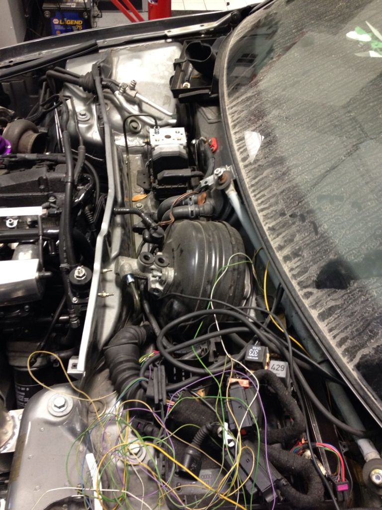

                                Cleaning like a madman in here.

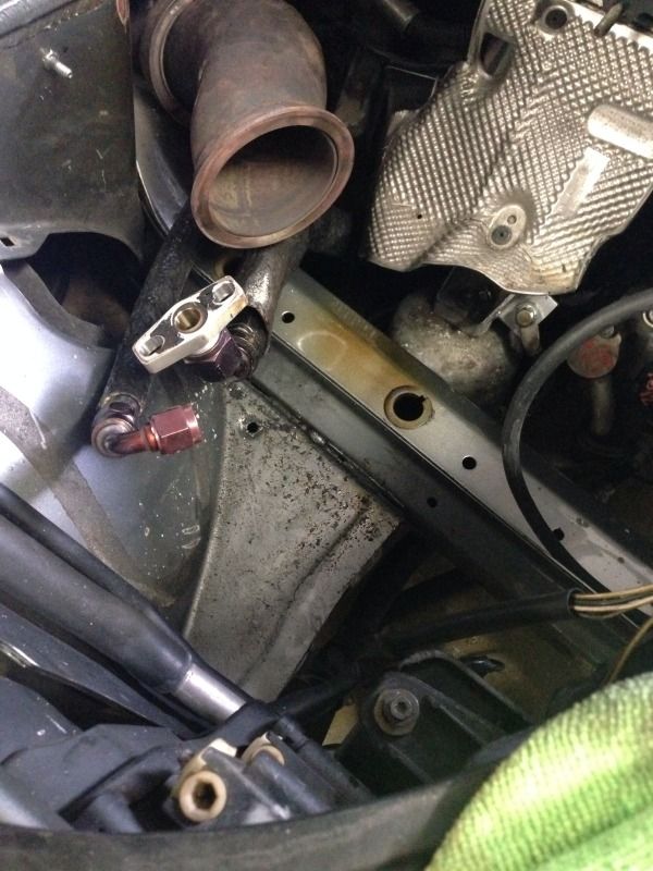

                                You can see where the paint is burnt from all the heat in there. The ceramic coating and thermal wrap should help. I'll also gold foil that part of the frame rail.

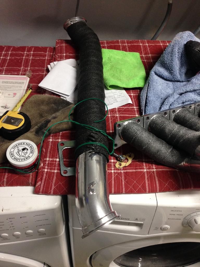

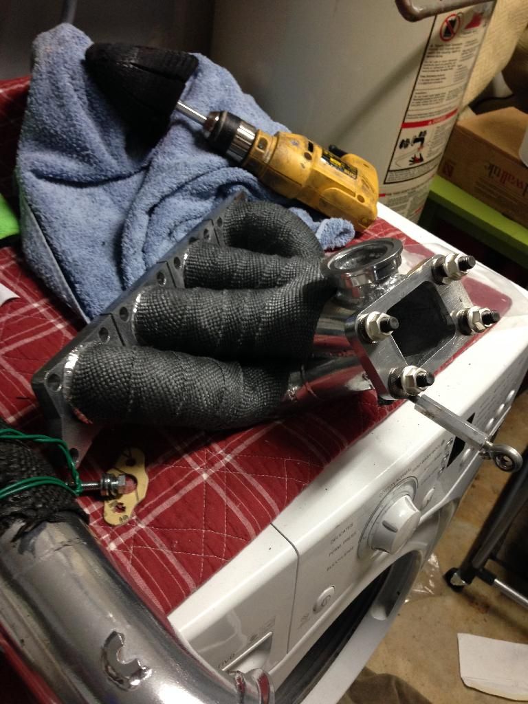

                                Started wrapping the manifold but I ran out. Gotta get another roll and some ties.
                                Downpipe wrapped, need ties for this too.

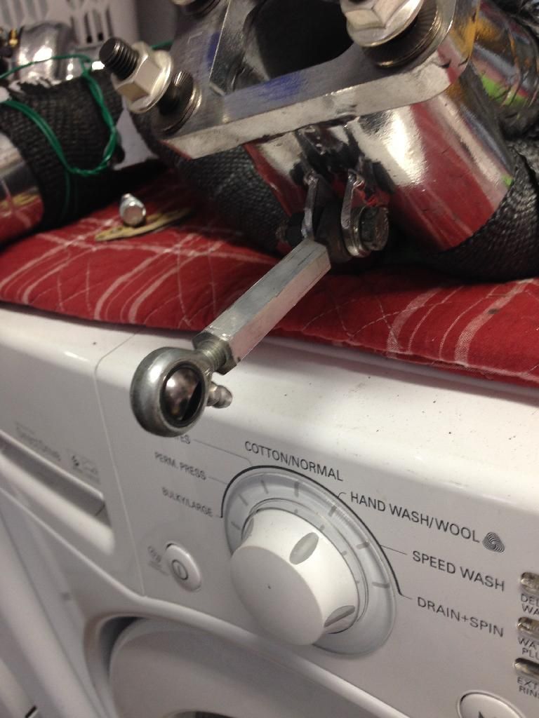

                                The brace for the turbo manifold.

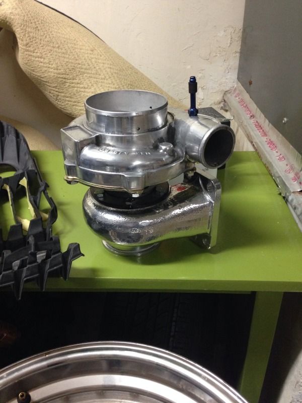

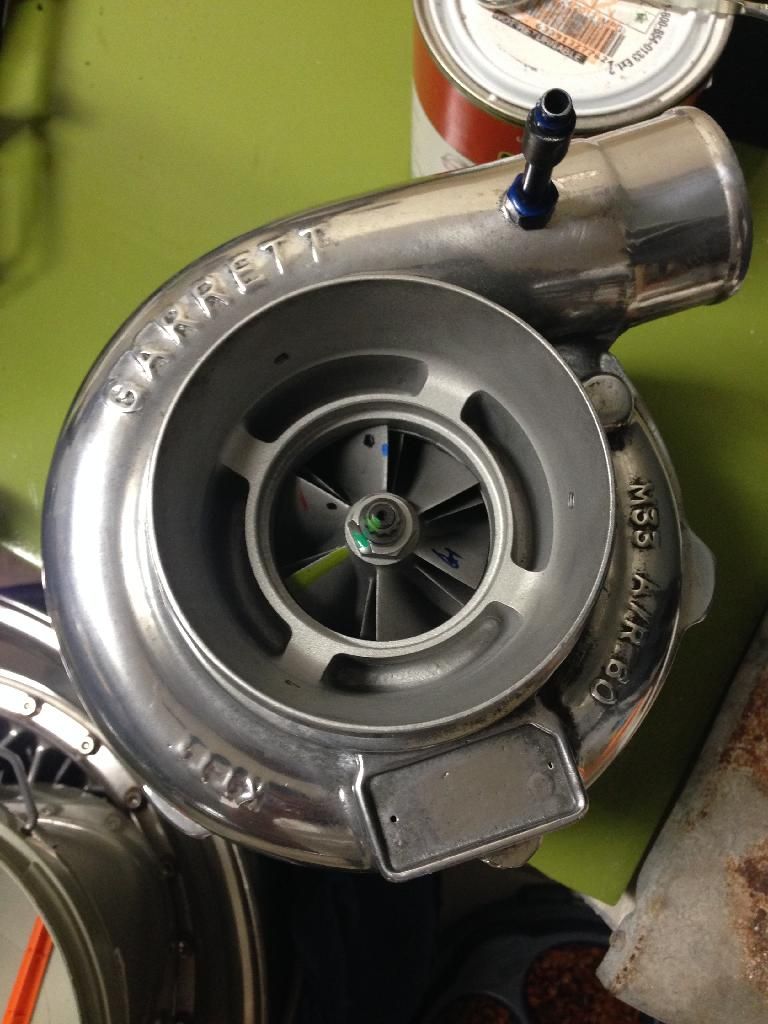

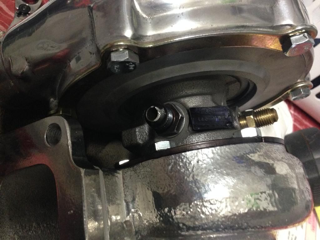

                                New wheel on the turbo, all cleaned up and ceramic coated as well.
                                More cleaning. This was filthy, couldn't even see the paint.

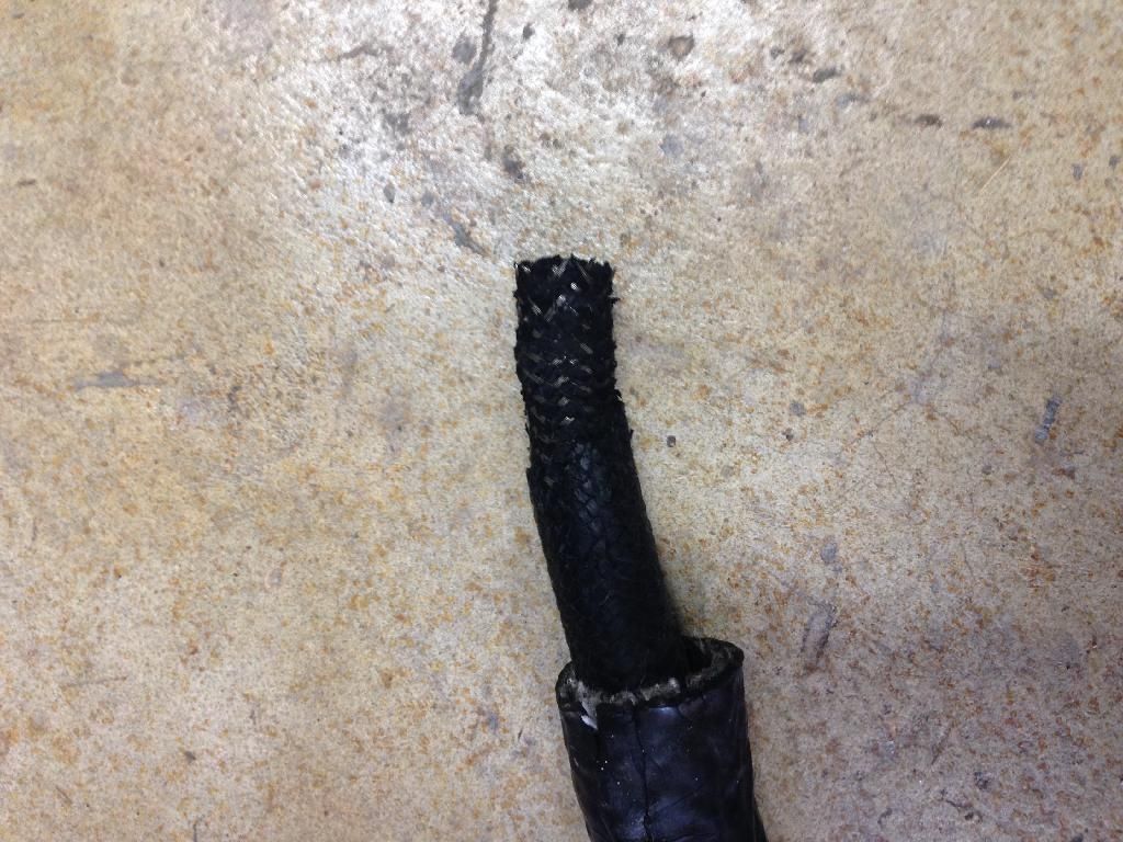

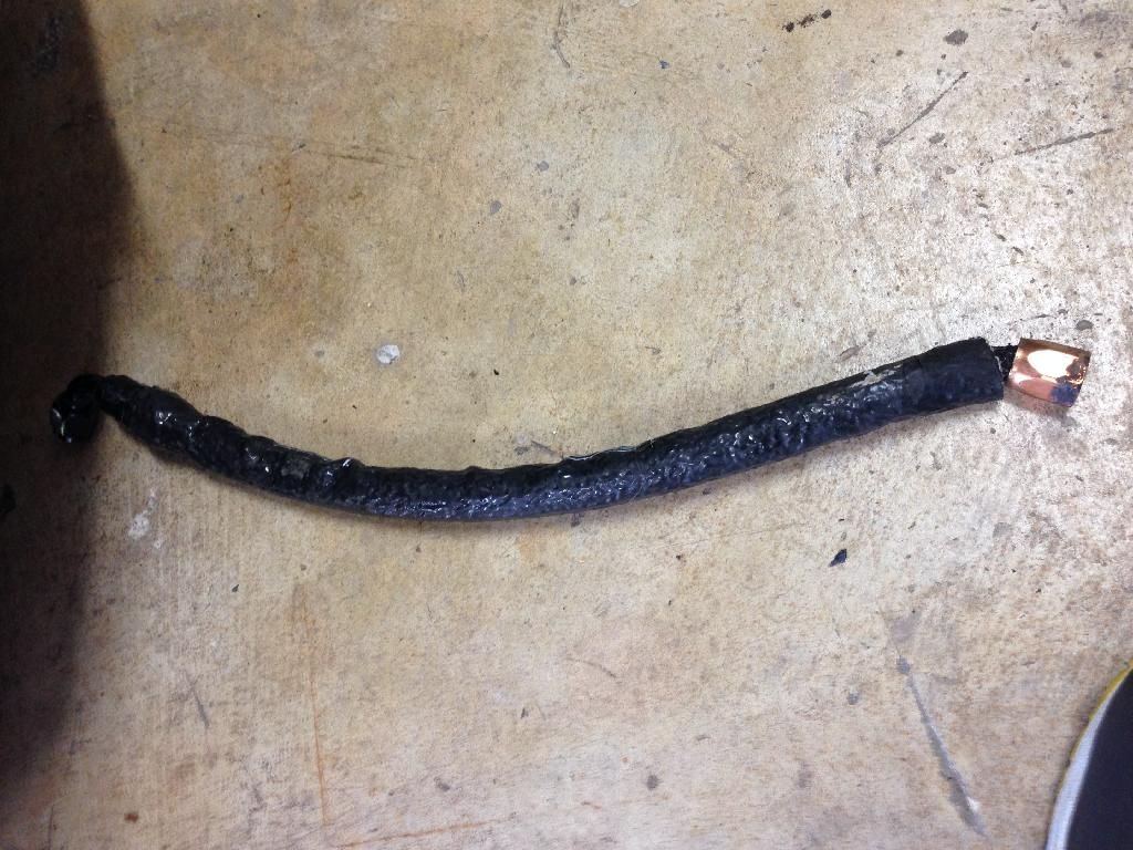

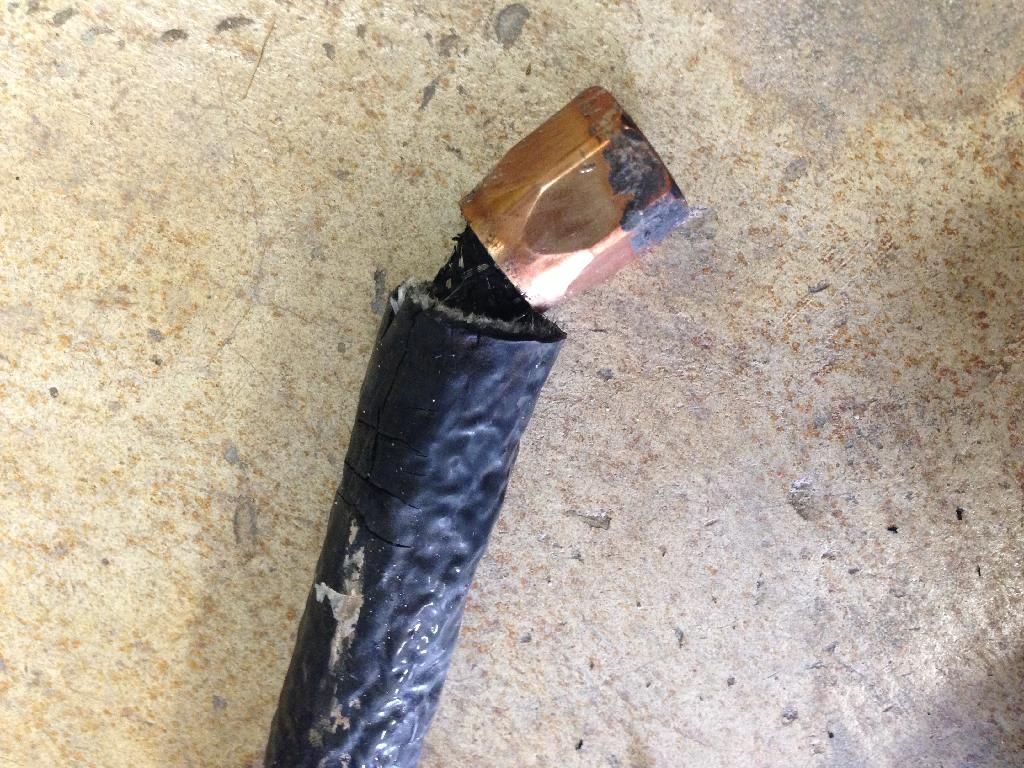

                                With the bare manifold it would get so hot that this coolant line melted, even with fiberglass shielding.

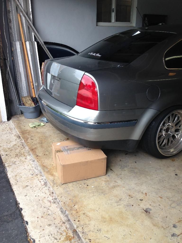

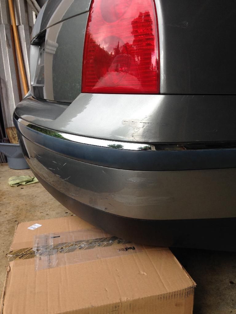

                                New to me back bumper. The other had a nice hole in it from my lovely neighbor's tow hitch. This one will be an easy fix for the body guy.
