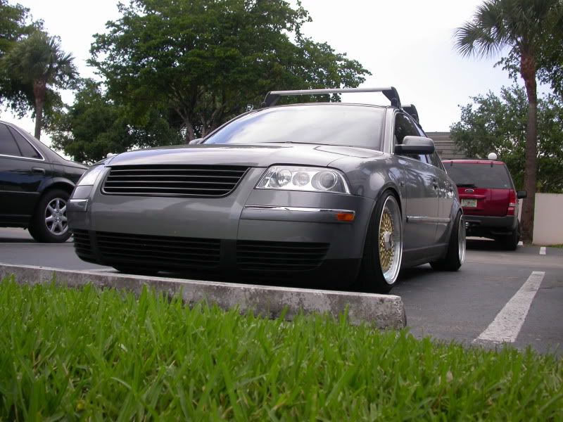

    Monster trucking that bitch with 265 rears :banghead: After a few months I bought some coilovers. No pics but I splurged on KW V2's and some smaller tires, 235/40's and 215/40's. Fought with the suspension for a few hours until I finally got it installed and went through a mission to get someone to mount stretched tires for me, and it ended up looking like this.

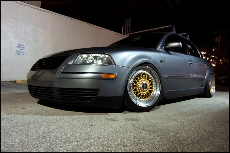

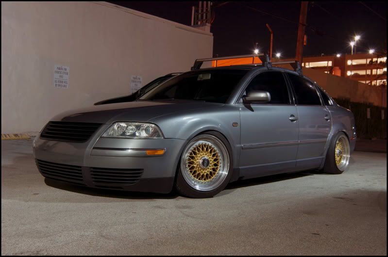

    OMG wheel gap! I thought that was crazy stretch too : Dropped it some more after these photos and took it to a meet. This is the best pic I ever got on these wheels, which is a terrible photograph.
    The stance was awful, especially by todays standards, as you can see in this pic.

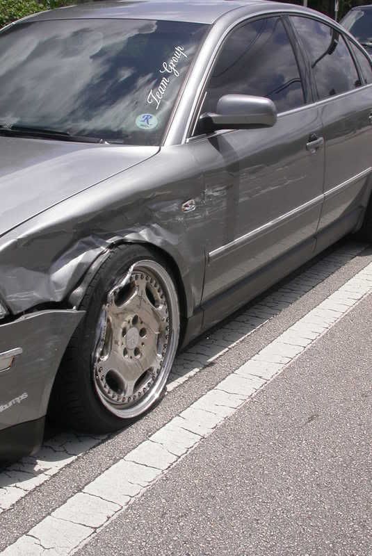

    The day after i took that pic, disaster struck in the form of our notoriously terrible Miami drivers.

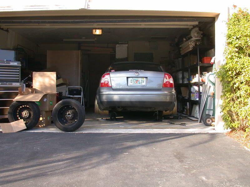

    Wheels were destroyed, so I sold them. While it was at the shop i got a a free manual transmission out of a 99' Audi A4, so I said fuck it, lets convert this bitch to stick. No progress shots as I was way too green to attempt this kind of install so I had a shop do it.
    It hasn't blow up yet so I guess they did a decent job.

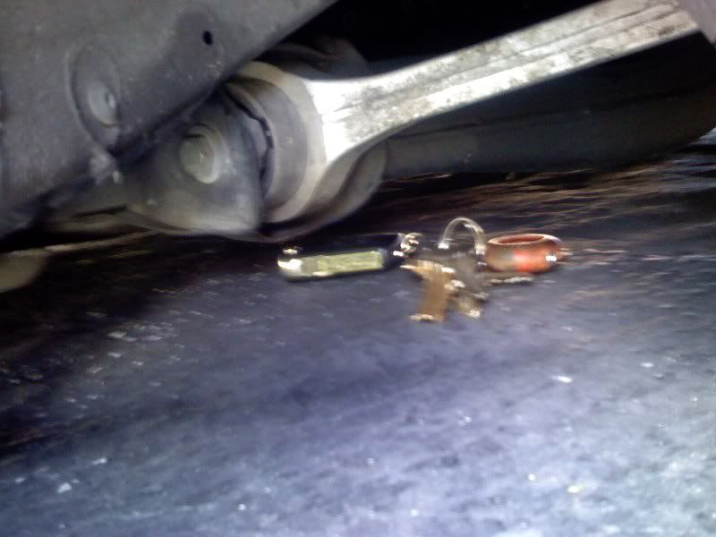

    Got bored with it while I waited to save up for new wheels and decided to max out the coilovers which resulted in...
    Popped the pan.

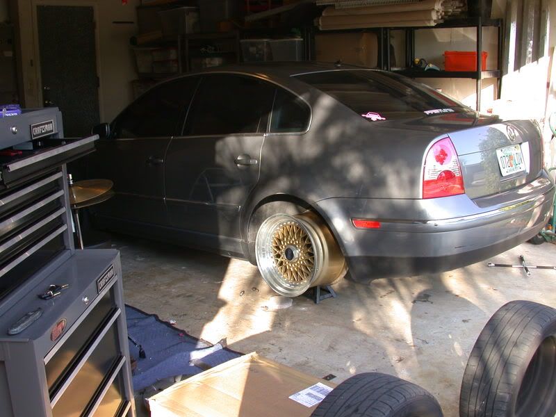

    17x9.5 et 55 front and 17x11 et 36 rears. Needed to redrill the rears, and the front offset was too high, so instead of redrilling and running a spacer I made 25mm adapters for the fronts.
    Test fit
    You may also notice caster is off in that last picture, i had to purchase a new lower control arm since it got bent in the accident to fix that.

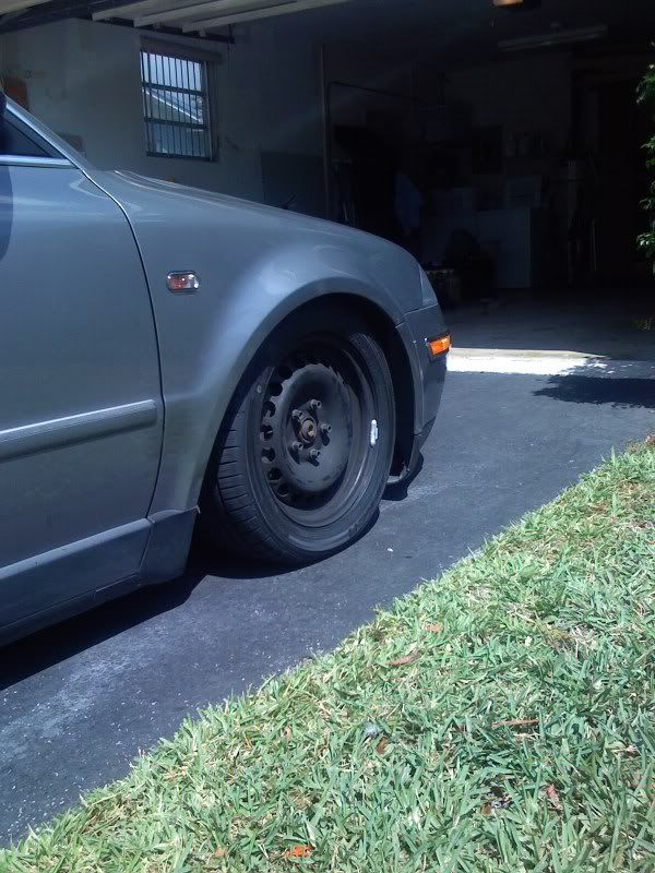

    Then i bought and mounted the tires, first time I used a cheetah. 215/45 fronts and 235/40 rears.
    Now these didnt clear the twist beam axle on the inside, so i had to cut out a notch to clear them since i refused to run a bigger spacer in the rear. And I also had to do this.

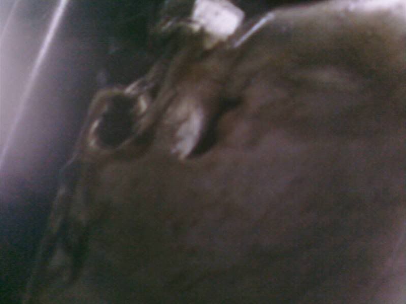

      Oil pan #2 destroyed. Ran over a folding table on the highway. Yes i was paying attention, no i wasnt tailgating, it flew off the back of a catering truck and i had no where to go because I was in a pack of cars. Get it on the lift and discover that this is probably the biggest hole in an oilpan I have ever seen
      also managed to break another motor mount, so I bought some RS4 motor mounts and transmission mounts, no pics of install.
