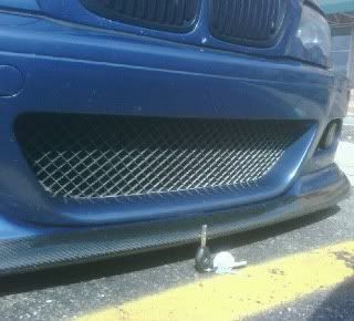

I'd be keen to see a picture of how low your car is userix, sounds like it's on the ground
Here are some pics. It's a good 3" off the ground, not even close to slam. The fronts are pretty much maxed (one thread from the bottom). I know I can remove the helper spring and bumpstop to get it lower, but wouldn't I run the risk of bottoming out the front shock now? The rear is completely maxed with the perch still in.
See? That's what I don't understand. Why is it so high even at max drop? I checked everything. the shocks are installed correctly, they are all from the KW v2 kit, nothing is mix'n'match. The rear perch is turned all the way down to allow the lowest drop. I don't understand why my car only sits this low at max?? As for the rear, is it because I am riding on the bumpstops? With BC coils, are there required bumpstops for the rear shocks? It's driving my crazy trying to figure out why it's not going lower. Any slammed e46s out there, let me know how you guys are doing it.
yea, that doesnt look right... i had KW V2s on my e46 M3 and i was slammed and still had about 1" left on my fronts and nothing left in the rear
