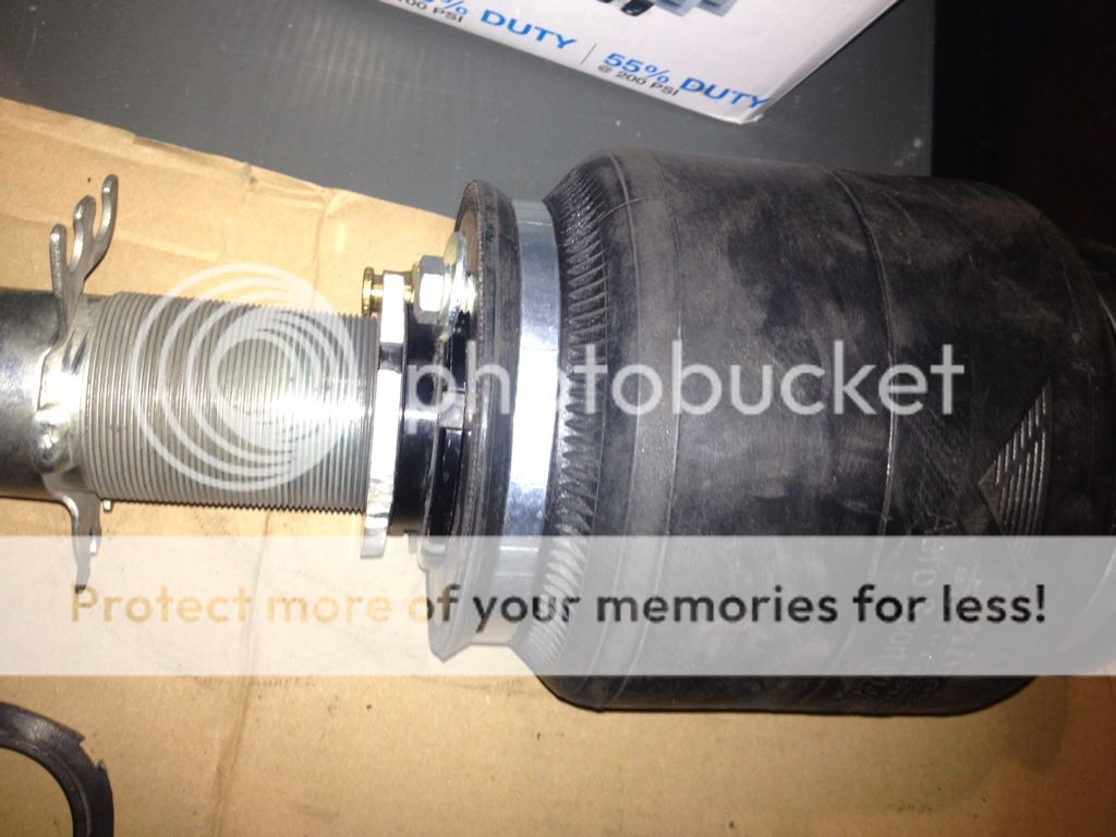

mounting strut bag to coilover?
Originally posted by mike410 View PostThat is a possibility, but you have to make sure that the bag which is 5.875" in diameter clears the wheel.
if your gonna do it the way mentioned in the first pic this is the right way to do it
just did this install on a customers car,
you want to flip the bracket so that its facing downward this way you can shave the lower perch down to clear the bolts and fitting but still lock the collars together. The biggest problem you will run into with bag overs is that the bags want to spin and can eventually rip the air lines out or pull them into the tire and rub through
