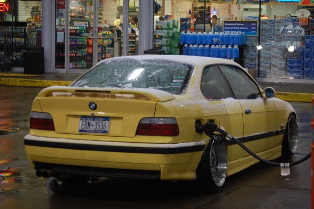

    Originally posted by cabezzz View Post
    Theres someone here running them on his e36 M3, ill look for the pics
    Yes but with 205's camber and rolling and pulling
    Those are NOT Remotecs and NOT 9x17 ET8. Those are Rials in 8.5x17 ET13.
            Yeah, but hes running a 10mm spacer up front, to clear the breaks. So his final et is 3, on a 8,5''. If your are gonna run 9'' and et 8, you are gonna poke 1,5mm more.
            So you will need to roll the back fenders, and a little pull (depending on how much camber you will go with) And on the front, you will need to remove the liners(plastic inside the fender well) and roll them. (also depending on, if you are gonna run camber plates)
            Hope thats enuff help.
