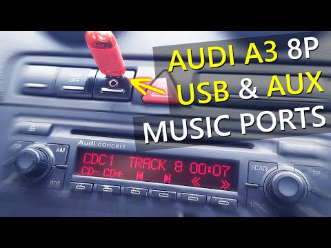

        In order to connect the ground , which is the last thing i did, you need a T8 torx bit, I used this kit
        Untitled by mgpdoc, on Flickr
        Worked perfrctly just like in the video I showed before. Veru helpful video overall, except for one part. We are getting there.

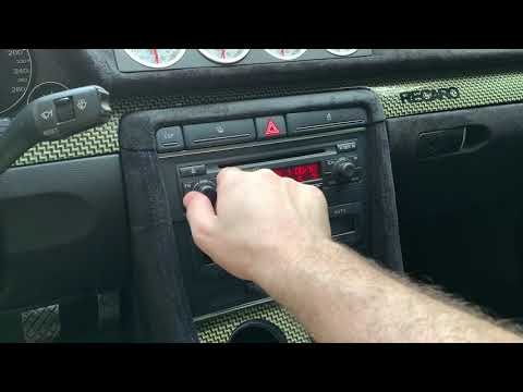

        • #49
          And a video of how it works, and the delay it has the first time u turn it on, that reads the music files
          Cheers, I hope you like it guys

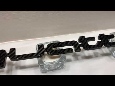

                    And a short video of the finish I achieved.
