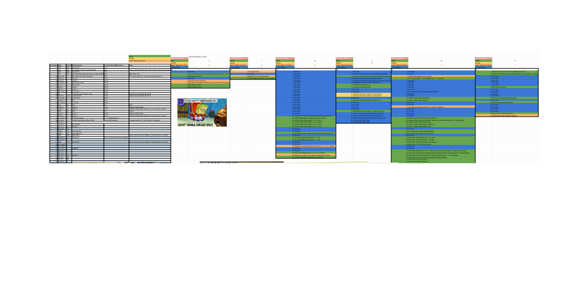

              LOL sorry I didnt die. Work and such has been wild. Does anyone know how to attach a google sheets file to a forum post? That would help a lot.

                  Just FYI oem air fuels are really lean (13.4 at WOT) so be careful there. Also your 99 should have the M62 not the M45, the M45 is hot garbage.
                  Option 2 is what I am doing after the manual conversion.

                          hahaha yea! Just so you understand how I laid it out: there are the 6 factory harness plugs that are labeled KA KB KC KD KE KF. Before chopping those, label each wire as I marked, so you know which to keep and which to toss, then reterminate into the micro rusefi harness to the pins as shown, or whatever ones you want it to be. Should be pretty straight forward.
