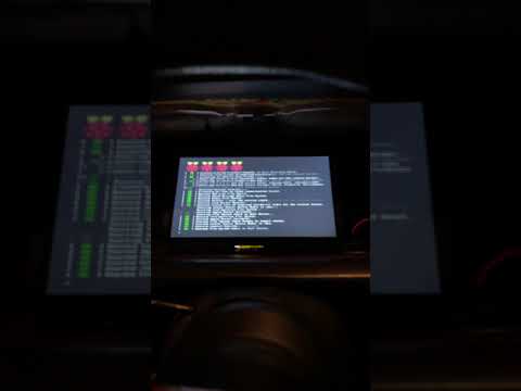

                              Ive been working diligently with the rusEFI team for the mercedes M111/M112 PNP Hellen ECU!
                              I have mine and will be installing it soon. In the meantime I have been building my digital dash. Heres a garbage video of first start up. I will be reducing start up time and having TunerStudio start automatically and have a nicer display. Also it connects and controls the ECU!
