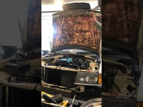

        UPDATE: IT RUNS IN THE CAR!
        video soon

            Heres a vid of startup. Idle was high just in the ETB settings so thats what im doing at the start.
            rusEFI is the best. Someone here should try it out.
