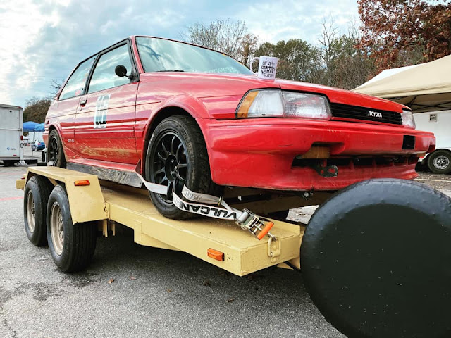

      The weekend started out with a bang when - 30 minutes into the drive to Summit - my trailer's axle rotated in its shackles and ripped out the wiring for the brakes. I showed up to Summit later than I had planned on Friday night and just grabbed the closest vacant paved spot I could. Temperatures dipped below freezing that night and the comforter I packed was not enough to keep warm in the back of the 4Runner. Looks like some kind removable of window curtain/insulation might be in the cards for a project before next season, as those cold nights are pretty brutal.

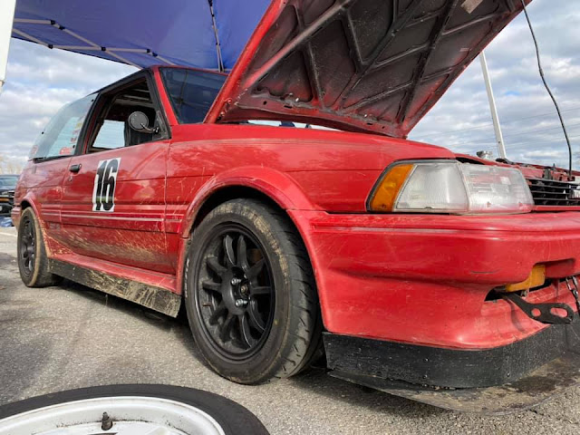

      Although the car was a bit muddy, nothing seemed to be broken, apart from my pride. Onward and upward, let's learn from this and not repeat it.
      Unfortunately the car seemed to have other plans. About 3/4 of the way through first session Sunday, I started smelling coolant and the temperature gauge started climbing. After pulling in the pits I couldn't find any obvious hose leaks, and all the coolant seemed to be coming from the water pump itself. My weekend - and therefore the season - was over.

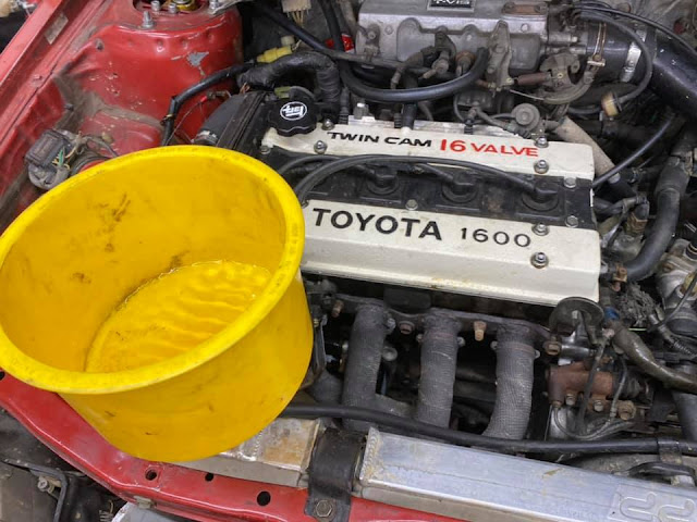

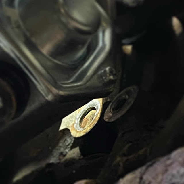

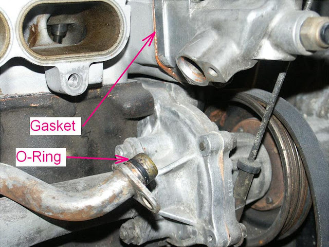

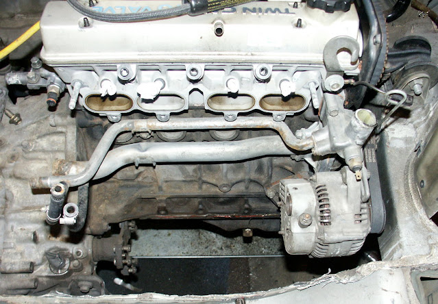

        Turns out the coolant issue was not water pump related. The water outlet bolts had worked loose and that's what did it. Some new gaskets everywhere made short work of that issue.

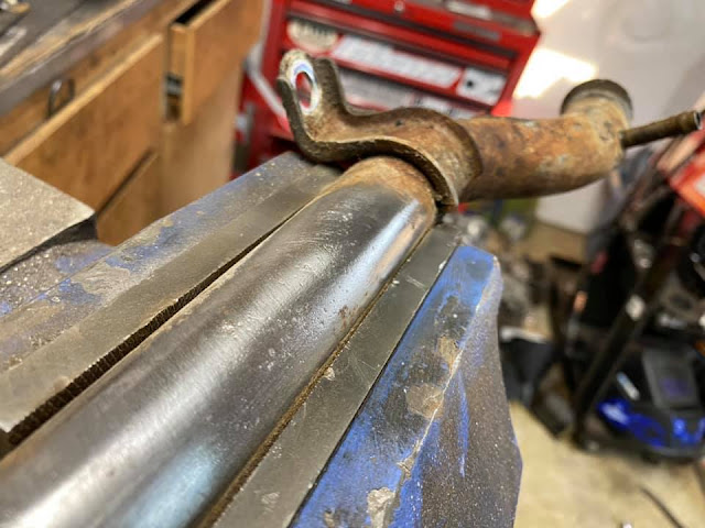

        While I was in there, I went ahead and de-rusted the water pump inlet pipe and removed the barbs for the IACV coolant supply.

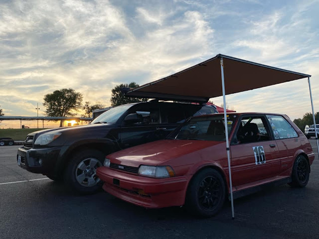

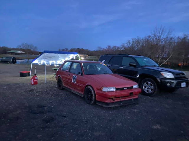

        With the Corolla holding coolant again, I decided to step up my trackside camping game with some portable power. This is the second smallest power pack Jackery makes, but so far it's been more than enough for my needs on a track weekend.
        I got to test it out in March at VIR, the first event of the 2021 season. Even after running the rope light for 4+ hours, charging my phone twice overnight, and inflating/deflating my air mattress twice, in near-freezing temperatures, the Jackery was only down to like 75% capacity. Absolutely a worthwhile purchase.

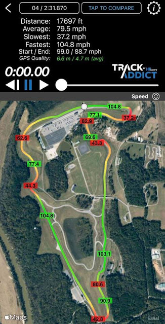

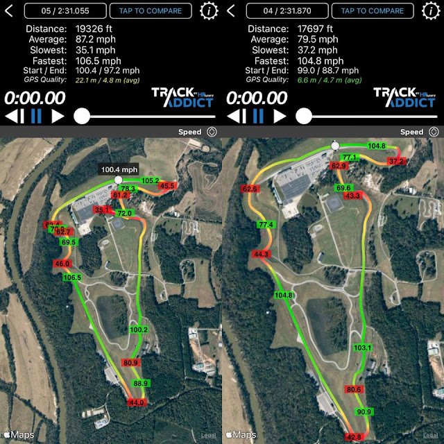

        Here's the speed map from the March event. I was still struggling with rear wheel lock-up and turned the right rear tire into an octagon. Here's some takeaways from the weekend I wrote down at the time:
        1. I feel much more comfortable and less nervous on track, though I do still have to remind myself to breathe before the climbing esses. Those will never be comfortable, but are super satisfying to get right.
        2. Once I got the brake bias right, the car felt so much more stable under braking, which gave me the confidence to brake harder, and the lap times fell accordingly.
        3. Even with an octagonal tire I was able to turn pretty consistent times within a few tenths of a second when not dealing with traffic.
        4. I’m pretty sure with the correct gearing and some round tires I could drop under 2:30. This whole “3rd gear to 105mph” situation has got to go.

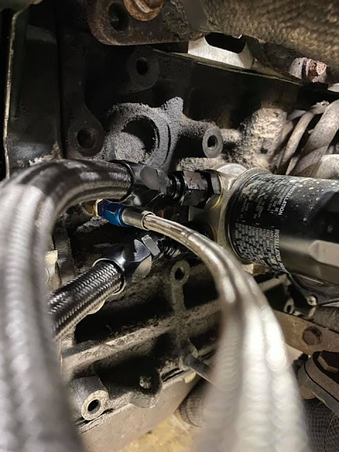

        For the May event I was anticipating hot weather, as historically that weekend at VIR is usually well into the triple digits. The stock oil cooler had been bugging me for some time. It's a decent size but uses 3/8" hoses and likes to leak from all the connection points. Since I already have a filter sandwich plate with AN fittings I figured there was only one logical conclusion.

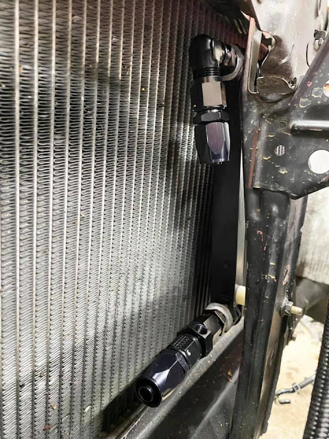

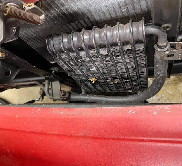

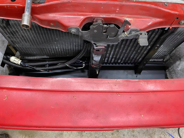

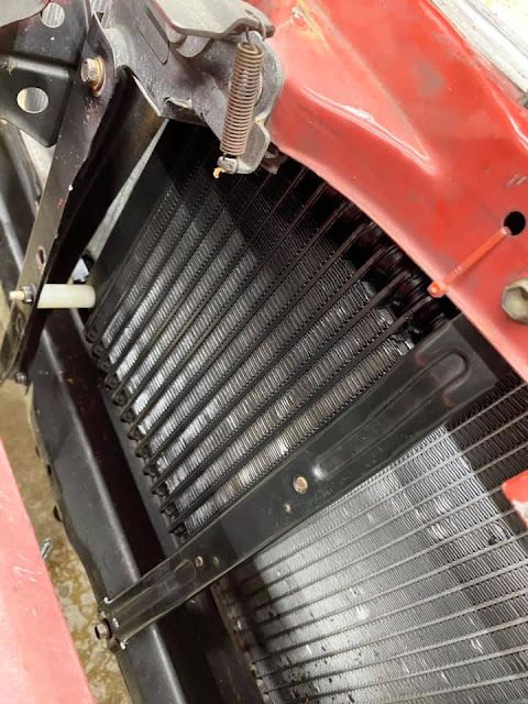

        A larger oil cooler with beefier -8AN lines was the obvious choice. A slight modification to the OE bracket actually fit pretty well.
        Another advantage to this setup is the ability to relocate my oil temperature sensor from the drain plug to the cooler outlet line. This will make oil changes much easier.
        With a couple of 30* hose ends at the sandwich plate, everything fit perfectly and - so far - remains leak-free.

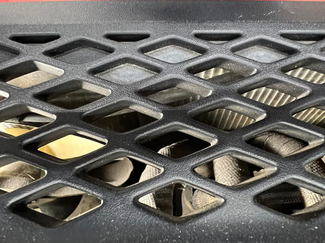

        I also added an additional air guide along the bottom of the radiator opening. Now all air coming in through the front of the car is going straight through the cooling system.

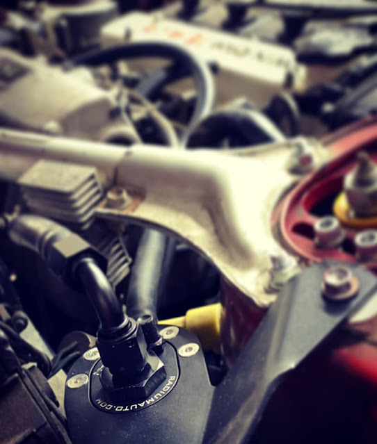

        I also added a Radium catch can to filter out any undesirable fluid residue from the PCV system.

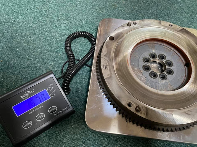

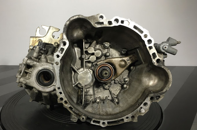

        In a kinda-sorta last-ish minute decision I decided to go ahead and pull the trigger on installing the spare AE92 transmission. Of course if I'm already there I may as well upgrade the weeny OE clutch/flywheel setup to something a little more suited to this car. The stock flywheel weighed in at a hefty 16.7lb.

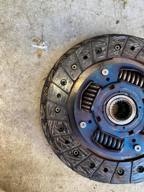

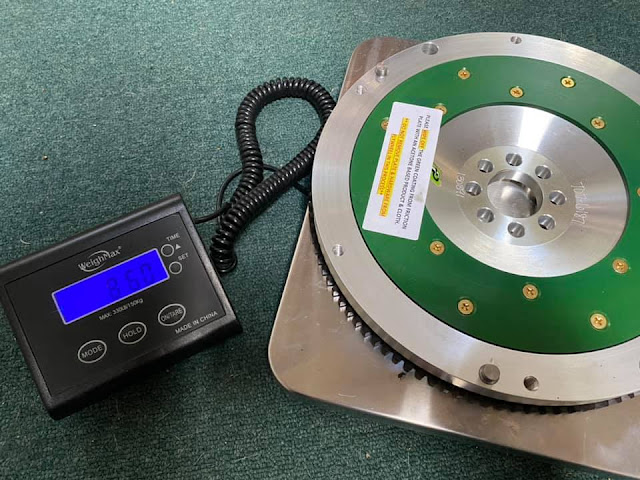

        Instead I'll be running a Fidanza aluminum flywheel weighing in at 8.6lb. Nearly half the weight. I've run a similar setup on my MR2 for nearly a decade with great results.
        The new clutch is an Exedy OE-spec kit for an AE92/AW11 MR2. It's a larger disc for more friction surface, and it's all a bolt-in upgrade over the smaller FX setup.
        With the octagonal rear tires rotated out, and a fresh pair of Falken RT660's up front, it was time to give it another go at NASA's May event at VIR.

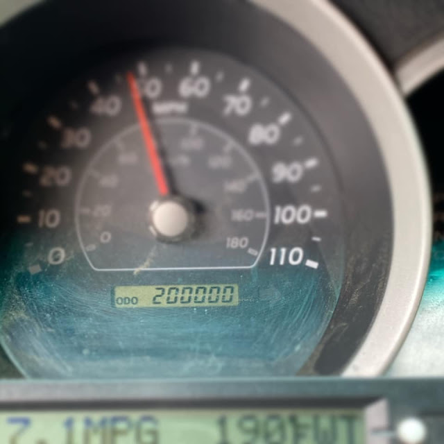

        Bonus - the 2Runner hit 200k on the way home. Finally broken in.

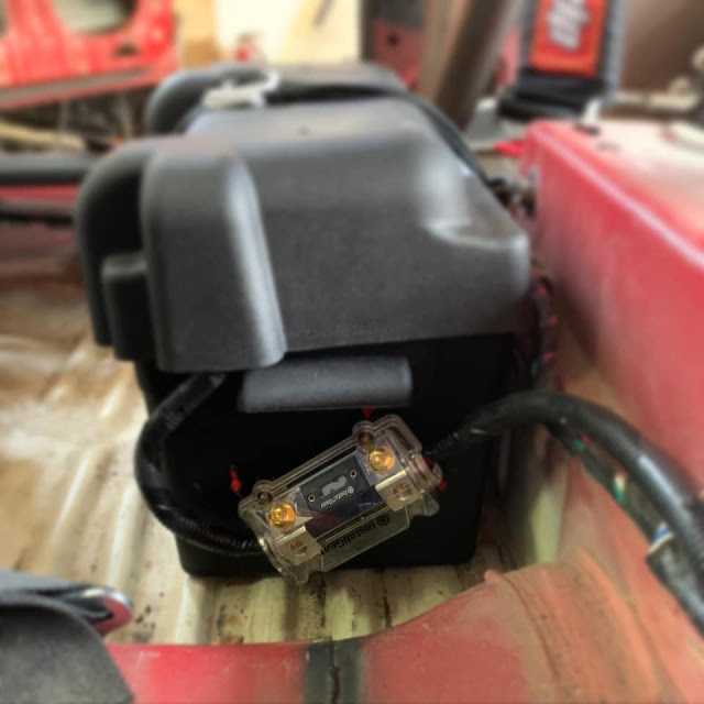

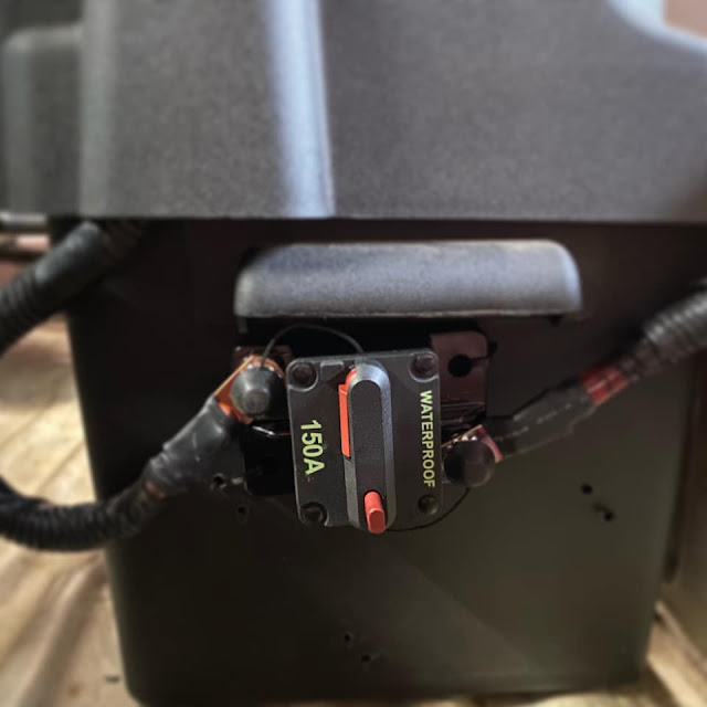

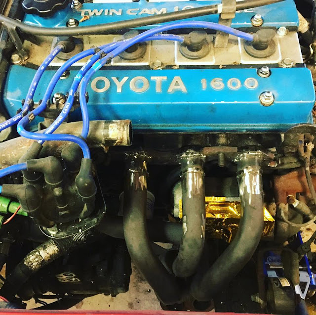

                At the last VIR event back in May, I had some electrical issues that almost killed the weekend when the starter signal wire grounded out on the exhaust manifold flange. This resulted in some sketchy work-arounds that meant I needed a push-start for the last session of the weekend, and would have meant a tow if I spun or stalled on track.
                When the starter wire grounded out, it blew my main fuse at the battery. While it's a good proof-of-concept that this design did its job and prevented a fire, having to leave the track to find a replacement fuse between sessions is no fun.
                To fix this, I replaced the fuse with a breaker. That way there's no parts to replace if it trips, I can just reset it (after fixing whatever the issue was) and continue on my way.

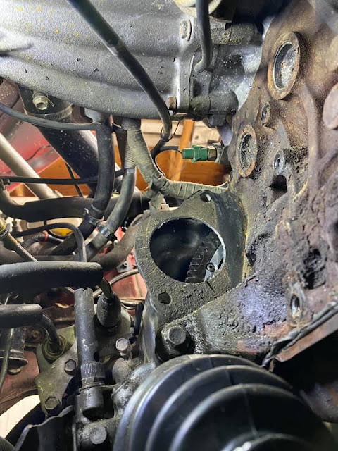

                The issue with the starter on these cars is that it sits on the front side of the engine being gently hugged to death by the hot exhaust manifold. To change it you also have to remove the oil filter and sandwich plate because there's nowhere else for it to go. You can sort of see it with its gold heat shield in this old picture.
                So, what's the best way to prevent the wires from touching the hot exhaust? Move the whole thing to the intake side, obviously. The C52 transmission has two starter locations built into the bell housing for use on different vehicles. Since my starter was verified toast, just giving a "click" and emitting wisps of acrid smoke, I ordered a starter for the intake side - one for a 88-89 Supercharged MR2.
                Over on the intake side, there are a few space constraints. The main issue is the water pump inlet pipe, the larger bottom pipe in the picture. While you can retain the original small upper bypass pipe, the larger inlet pipe has to either be modified, or replaced with one from a 88-89 Supercharged MR2 (4A-GZE engine) to fit around the new starter.
                Unfortunately the spot on the block where the GZE pipe bolts to is not drilled/tapped on this block. I ended up welding a bracket to bolt up to one of the starter bolts to give the pipe proper support.
                As for mounting the starter itself, I made a template and used a 75mm hole saw to cut the correct hole in the dust plate.
                After sourcing the right bolts, the starter bolted right up! The only other modification required is bending the intake manifold brace that bolts to the bottom of the block. I made a block-off plate to cover the hole where the starter used to go, and it's job done.
                It starts! Now the starter should be a little easier to access if I need to replace it in the future, it's farther back in the chassis, and it's away from major sources of heat. Win-win!
                With some fresh front brake pads and rotors installed, the car is now basically ready for Hyperfest at VIR in a couple weeks. I can't wait to get back out there!

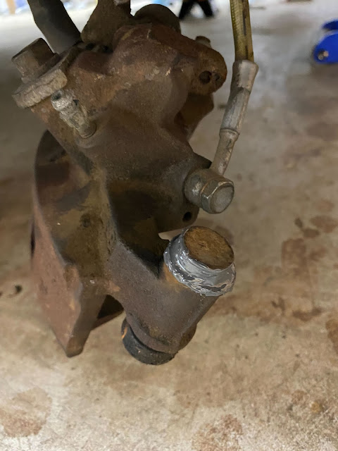

                    The only real mechanical issue I had at Hyperfest was losing a caliper bolt. The upper bolts on the rear calipers are contained inside the caliper itself with a little press-fit cap covering it. This cap had fallen off and allowed the bolt to back out at some point. A quick junkyard trip to find a 4th gen Celica caliper cap and some JB Weld assured that I wouldn't be losing this one, along with some Loctite on the bolt assured that this wouldn't be happening again. This fix was applied to both sides.

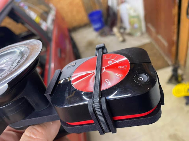

                    One lesson re-learned at Hyperfest was how imprecise the lap timer is when relying on the phone's 1hz GPS module. HPTuners recommends a Dual XGPS160 for use with the Track Addict app, so I picked one up to try out.

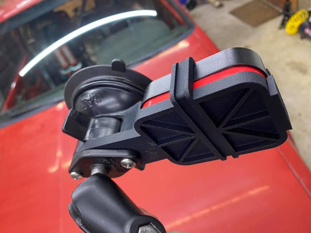

                    The XGPS160 connects to your phone via bluetooth and not only bumps your resolution up to 10hz, but also contacts more satellites, both US and Russian, for much more accurate positioning than the phone's GPS alone.
                    Some industrious individual designed a 3d-printed mount for the XGPS160 that works perfectly with RAM mount bases, and secures with a ziptie. Such a neat piece!
                    What better way to end the season and try out the GPS than running one last event at the local track?
                    It was a pretty nice day and a fun way to finish out the season. The GPS worked a treat and I set a new personal best with a 1:43.860

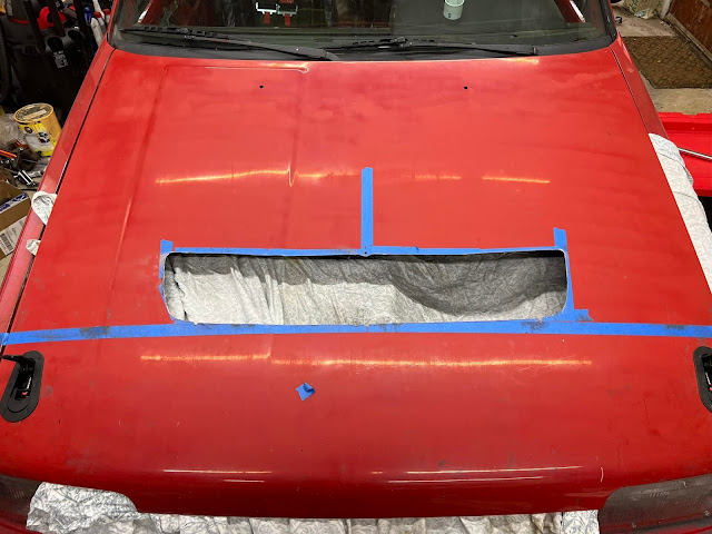

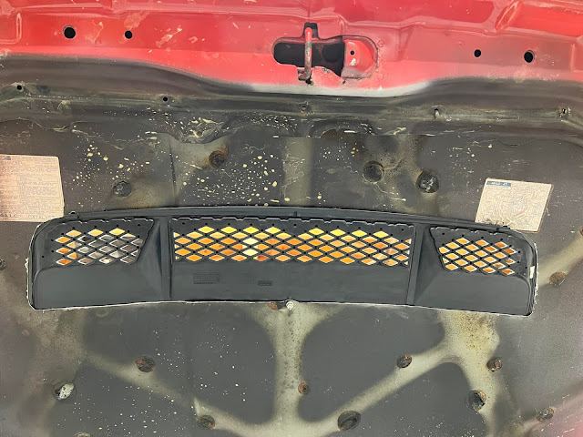

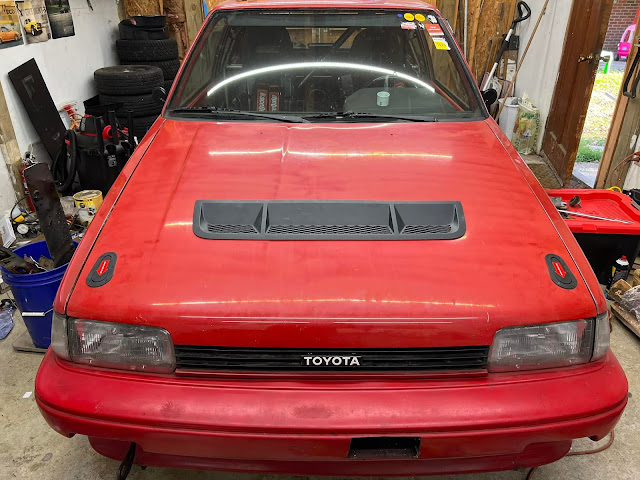

                    After some careful measuring with a template I made, this GT500 Mustang hood vent fits perfectly. The Aerocatch latches went in at roughly the same time. I used the arrow stickers that came with them even though they are a bit visually tacky, so that if the latch is open I will immediately notice from inside the car.
                    The GT500 vent is pretty cool because of how it mounts. The entire front edge has a lip that slots under the sheet metal to hold in place, and has a captive stud and nut in the back for really secure mounting. As an extra precaution, I used Gorilla tape around most of the edge as well. This thing is going absolutely nowhere.
                    The opening sits directly over top of the exhaust manifold, behind the radiator. Hopefully this will evacuate some heat and get some of the pressure out of the engine bay for a wee little improvement in aerodynamics as well. Additionally, removing the bracing and latch under the hood (other than the very perimeter) resulted in around 10lb of weight savings. Win-win!

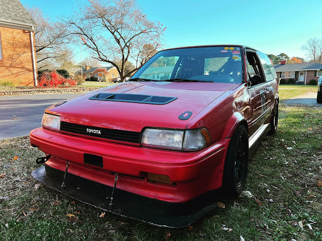

                    I love how this thing looks now! There are a few more things to do this winter but I'm hoping to hit 2022 pretty hard (at some places other than VIR and Dominion). I'm really going to shoot for Summit Point Main and Shenandoah, NCCAR, and hopefully travelling a little farther than usual to attend Grid Life at NJMP. Lets freaking go!

                                1. Coolshirt (large, left exit) 2. Primer bulb 3. Male 1/4" dry break connectors (included with shirt)
                                4. Female 1/4" dry break connectors (5923K43) 5. Tube insulation/cover kit
                                6. Male 1/4" dry break connectors (5912K85) 7. 1/4" tube (5233K57)
                                8. Bulkhead dry break connectors (5012K79) 9. Engel 13qt Dry Box Cooler (UC13)
                                10 and 11. 3/8" tube (6516T27) 12. 3/4" x 3/8" reducer (5463K648) 13. 3/4" tube (6516T33)
                                14. Attwood T500 Pump (4606-7) 15. Deutsch connector kit 16. Littelfuse add-a-circuit
                                17. 4-pin relay 18. Toggle switch (90012E)
