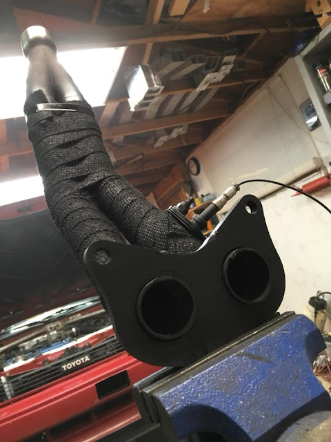

      On one of the last runs of the day the car suddenly became 100x louder. I limped the car back to the paddock, ears ringing, and found a broken downpipe. The slice/bent/re-weld method had bitten me in the ass. Fortunately a good friend of mine towed me home and then the car sat while I accumulated parts to fix it.
      After getting the right wire to weld stainless I was finally ready to start creating a new downpipe.
      It's not pretty but it should be stronger and flow better than the old one.
      Can't forget the wrap! Heat is the enemy.

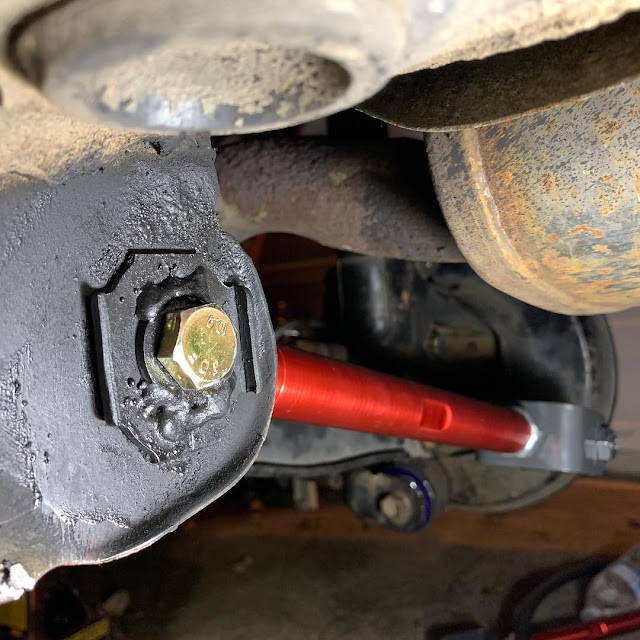

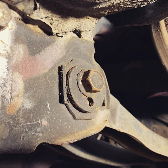

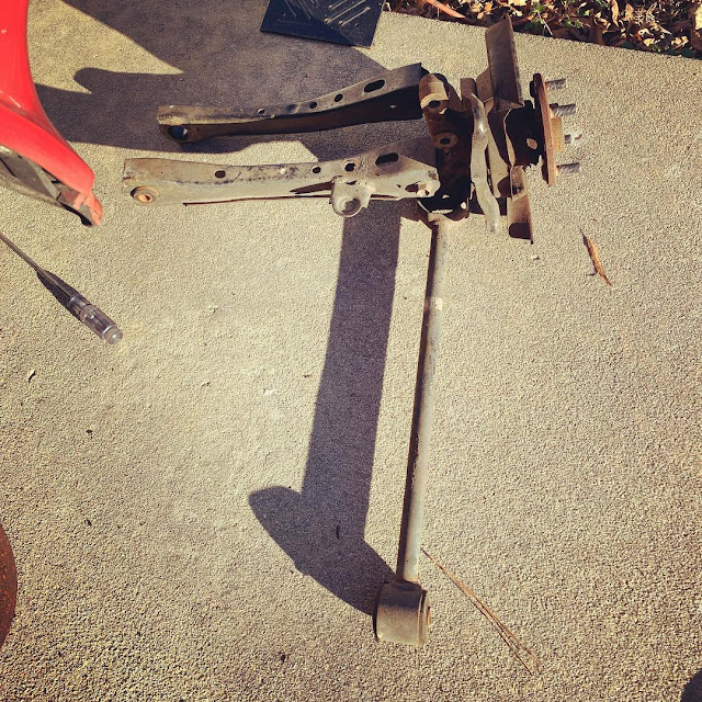

        Last time I tried to align the car I just could not get the rear toe right. This is because of the eccentric cam sleeve design of the adjuster. What often happens on these is the bolt, cam, and inner sleeve of the arm bushing all seize together. I already planned on replacing all the rear bushings, and really wanted to get rid of this stupid system at the same time.
        Yep, the cam was definitely seized to the bushing sleeve. The only way to remove the arm from the car was to cut the cam out.
        That thing was not budging. Even a sawzall wouldn't go though, I had to use an angle grinder.
        This is where the cams allow the bolt to slide back and forth to adjust rear toe. The goal is to eliminate this as a point of adjustment, and instead use an arm that has an adjustable length.
        Theoretically you are supposed to be able to turn the round part independently, but rust and time have eliminated that possibility.

        Once you remove the brakes and sway bar the whole assembly can just drop down. Easy peasy. Well, after you cut through the stupid cam sleeves.
        A combination of propane torch, hammer, and various size sockets in the vice will get the old bushings out. This makes a huge mess and lots of very toxic smoke so definitely wear a respirator, glasses, gloves, etc.
        After a few very messy hours you'll end up with this!
        I contacted TechnoToyTuning about making some custom arms, giving them the measurements from the stock arm for reference. They did a great job, except that I had totally mis-measured somehow and ended up with arms that were 2 inches too long! Once I realized my mistake we swapped out the center sections with ones of the appropriate length.
        Since these arms are using off-the-shelf components for other cars, there was a little shimming necessary at the knuckle end, but T3 included most of the washers I needed.
        I did have to special order some bolts and nuts to replace the sleeves that were cut out. These are the part numbers I ordered from Fastenal:

        Not only do these look great, but they will make adjusting the toe much easier.
        Pardon the ugly welds, as my welder was running out of gas. I do think I may end up changing this, as I'm not sure the washers are up to the task of keeping the bolts securely located. I may end up cutting/drilling plates to fit in the little tabs where the cam used to ride. But this works for now.
        And here's the progression of how I eliminated the stock adjuster. No more seized sleeves for me!

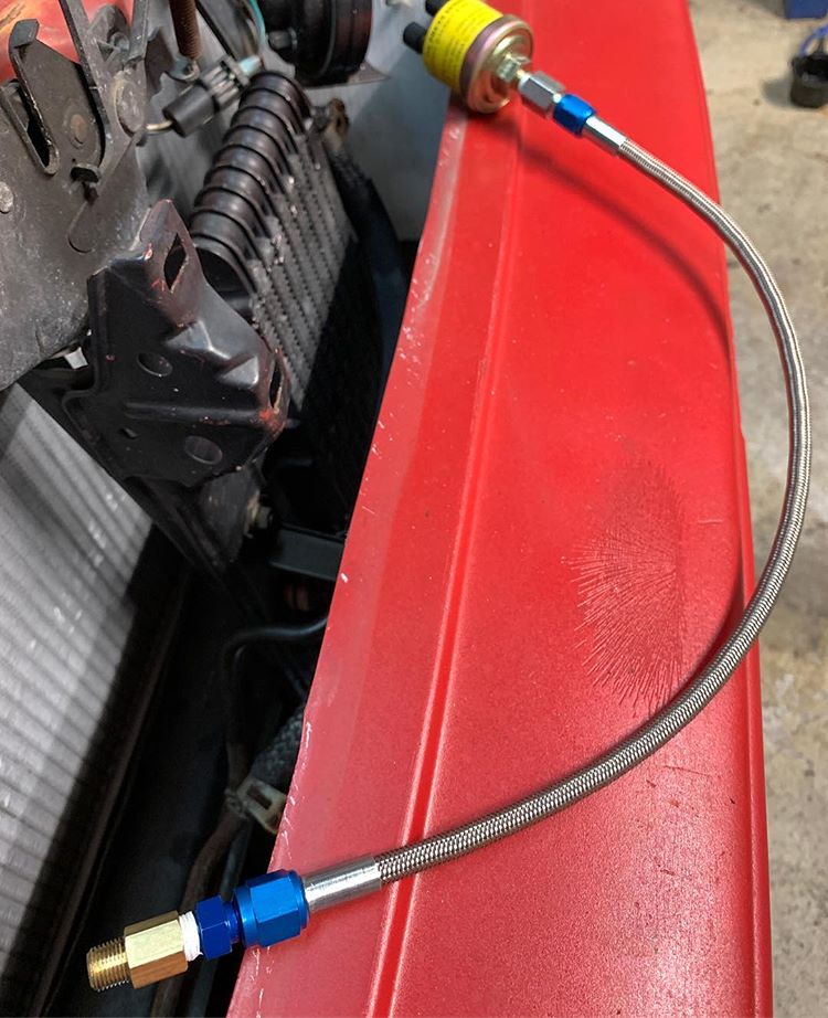

                    Something that's been in the back of my mind for a while with this car is the need for some auxiliary gauges. I was fortunate enough to pick up lightly used oil pressure and oil temperature gauges for a good deal.
                    The oil pressure sender is surprisingly heavy, and hanging off the block can fatigue and crack the fittings over time. Solution: remote mount sender to chassis and run a -4AN line to the port on the block. The block is actually threaded for 1/8 BSPT, so some adapter daisy-chaining is needed.
                    The sender is mounted to an aluminum bracket, surrounded by some foam insulation from an old radiator hose for extra protection.

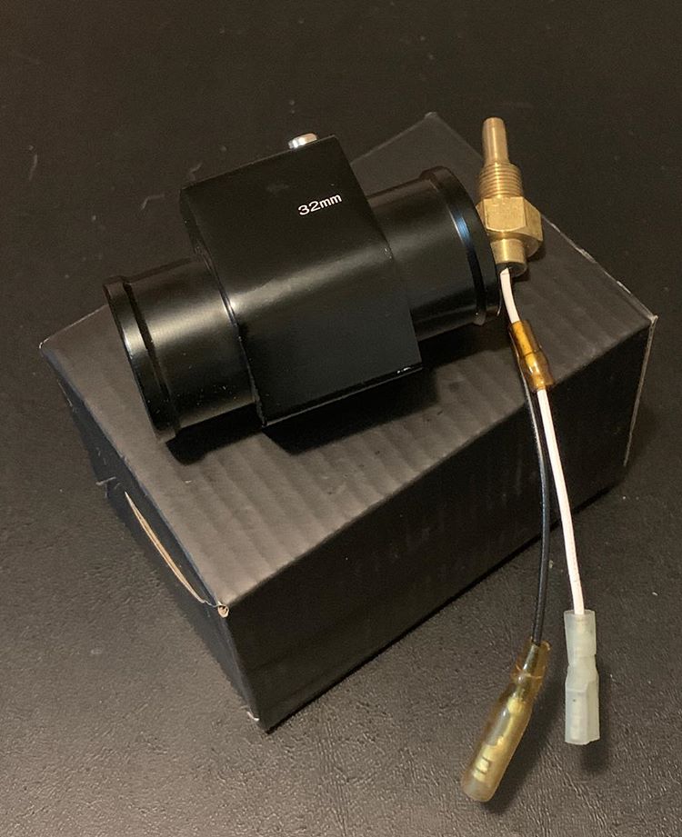

                    For water temperature, this will go in the upper radiator hose. It has a 1/8 NPT thread for the sender, and makes for a simple, clean install.
                    This was probably the easiest of the senders to install. After this picture was taken, all the wiring was covered with a corrugated sleeve and secured.
                    For the oil temperature sender, I got an m12x1.25 to 1/8 NPT adapter that will thread into the oil pan. I used a two-wire plug from a spare scrap harness I had laying around, in case I ever need to disconnect it. Due to proximity to the exhaust, I put a sleeve of insulation around the wires for protection.
                    The old location where the stock oil cooler return line bolted up is going to be my first try, but it looks like it may be too high up to get a reliable reading. If not, I'll put it in the drain plug location.
                    Here's the sensor installed. Hopefully this location gets a good reading, and that this is even the right sensor. It was included with the used gauge so it may or may not even be the right one for this application.

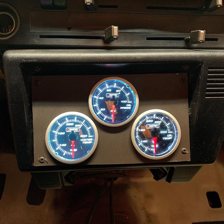

                    I made a mounting plate where the factory radio went, and all three gauges are easy to read from the driver's seat.

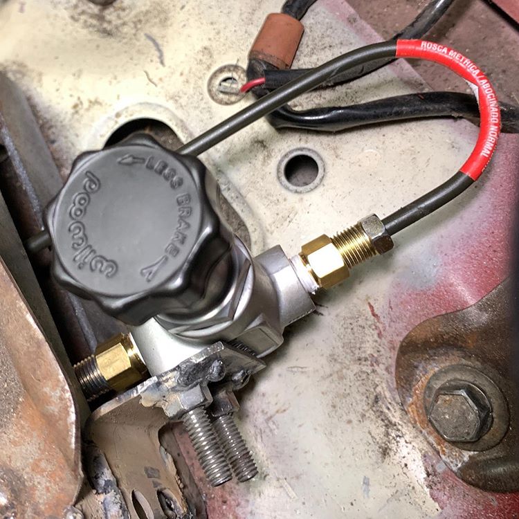

                              The biggest takeaway from HPDE was how much I was under-using the brakes, and needed to brake harder. By the end of the day the front brakes were pretty toasty, with the pads starting to glaze and the rotors starting to warp after the last session's cooldown. The rear brakes were basically like-new though.
                              Solution: remove the stock proportioning valve and install an adjustable valve for the rear brakes. This will accomplish two things: allow me to fine tune how much force goes to the rear brakes, and split the front and rear circuits for safety/redundancy.
                              I wanted to be able to reach the adjuster knob from the driver's seat so I made a little mounting bracket and welded it to the shifter riser.
                              A couple adapters and two 4-foot sections of steel brake tubing complete this end of the circuit.
                              The lines run under the shifter and through a pre-existing grommet in the firewall.
                              Without much room to hand-bend the lines, it's not the prettiest install ever, but so far nothing leaks or rattles and it seems to work as intended. Fortunately all of this is hidden behind the engine so you don't have to look at it.
