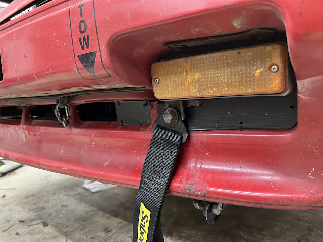

            While the car was on jackstands I decided to make little block-off plates out of coro-plast to keep air from going in places it shouldn't. Not sure if it will make a difference, but it was one of those "bugging you in the back of your head" things.

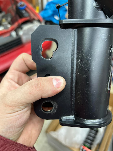

              The Fortunes do not include camber plates for the rear. Instead they use an angled static mount. I think this will be ok, as I don't run a ton of camber in the back (usually around 2* - 2.5*).
              Speaking of rear upper mounts, I think the inner two bolt holes will be fairly close and just require a little bit of slotting in the strut tower, maybe tilted a hair in to aid in camber gain. AE92 inner bolt spacing is 3-5/16" center to center. The third stud will just be a simple matter of drilling the hole.
              AE82 inner bolt spacing is 3-1/8" center to center. Not too far off. Yes the camber plates say "AW11" on them, as the AE82 Corolla and AW11 MR2 use the same part.
              To make up for the lack of camber adjustment in the rear, these cam bolts will be used to fine-tune the alignment.
              The other big concern was over-all shock body length. With the Fortunes extended out a bit, they should be spot-on. Check out the improvement in travel too!
              Up front, the AE82 coilover mounts up to the AE82 knuckle perfectly. However I may lock out the upper slotted bolt hole, as the factory cam bolt and camber plate allow for plenty of adjustment as-is.
              Up top we run into a little bit of an issue. The AE92 camber plates just don't have good bolt locations to accommodate the factory strut tower brace. There are ways around this, but I think I can get away with a different solution.
              The Fortune Auto camber plates are slightly wider compared to the T3's in the middle around the bearing housing, yet thinner in the adjustment bolt channels. However the adjustment channels are equally spaced. Very slight clearancing of the Fortune's upper bearing housing would allow the T3 plates to work and be a direct bolt-in solution. Though that may compromise the integrity of that bearing housing which is technically taking the weight of the car. However if I clearance the T3 plate that makes those slots awfully thin. And if I try to make the Fortune upper hats work, not much of the plate actually contacts the strut tower as the opening is fairly large. I'll have to think on this one.

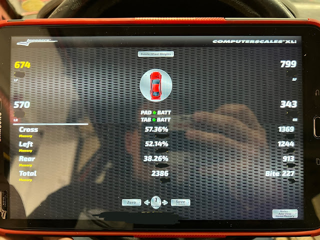

                    Here's how the car was set up on the old suspension. I was told to think of it like a table with uneven legs. Find the short leg and lengthen it, or the long leg and shorten it, to keep the table from wobbling.
                    This video by Flyin' Miata is super helpful showing how to approach corner-balance.
                    Here it is after corner-balancing: a massive improvement in cross weight with nearly perfect 50-50. These weights are with me sitting in the driver's seat. After that, I did my first DIY alignment and was ready to take on Summit Point Shenandoah Circuit!
