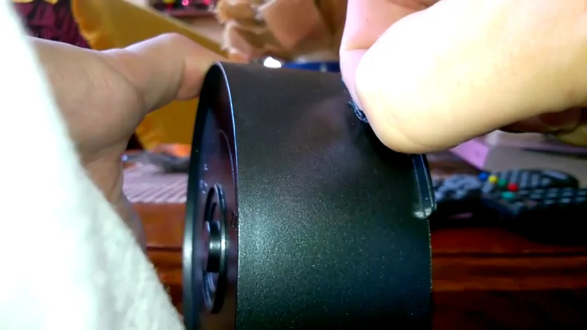

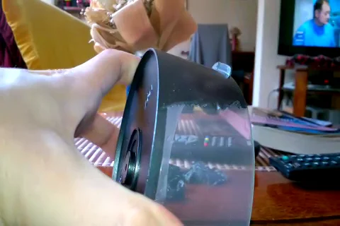

Wanted to try some PlastiDip paint on the front sign and in the interior...Tried on this peace of plastic first to see how it feels and peels
This is "Rubber paint" by Igor Simovic on Vimeo, the home for high quality videos and the people who love them.
This is "Rubber paint 2" by Igor Simovic on Vimeo, the home for high quality videos and the people who love them.
