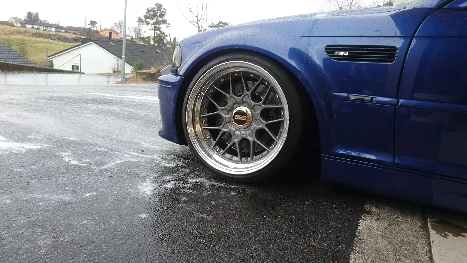

Front struts arrived. Longer piston than stock with 16k springs and helper springs. Air cups are from stanceparts.com. This gives me 50mm lift on the fly.
With Electronic Damper Control installed
The result
First test
Broadway Static 500S with air cups from Frode Dale on Vimeo.

I haven't bought rear springs yet. I think I will stick with these 5" springs and just remove the lock ring if I want it a little lower. The reinforced subframe and spring perch reinforcements are probably the reason it is this "high" at the lowest setting. They probably add 1-2cm in total. If that doesn't do the trick I'll buy 4" springs.'18 BMW F80 M3 San Marino blue / Amaro brown
instagram.com/frodedale
Originally posted by The Simps View PostSo did you end up with a 50mm helper spring and 50mm longer piston basically? What length is the 16kg spring?
I ordered new front struts that are 20mm longer than standard BWS for E46. (60mm longer than E9x setup). This gives me 100mm piston above the shock body.
I have 5" 16k springs and 60mm helper springs (compresses to 22mm). The combined compression with these are adjusted to 50mm when applied the weight of the car. The cups are 18mm thick. This leaves me with 32mm of suspension travel, which is not a lot, but hopefully enough.'18 BMW F80 M3 San Marino blue / Amaro brown
