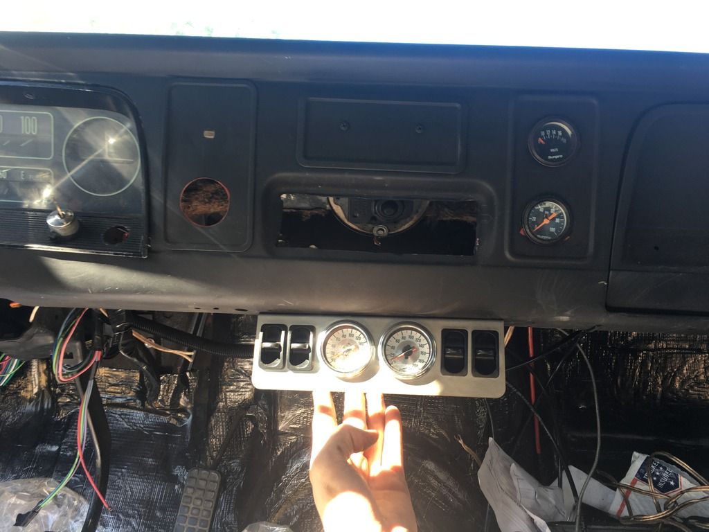

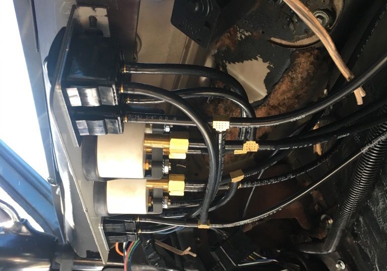

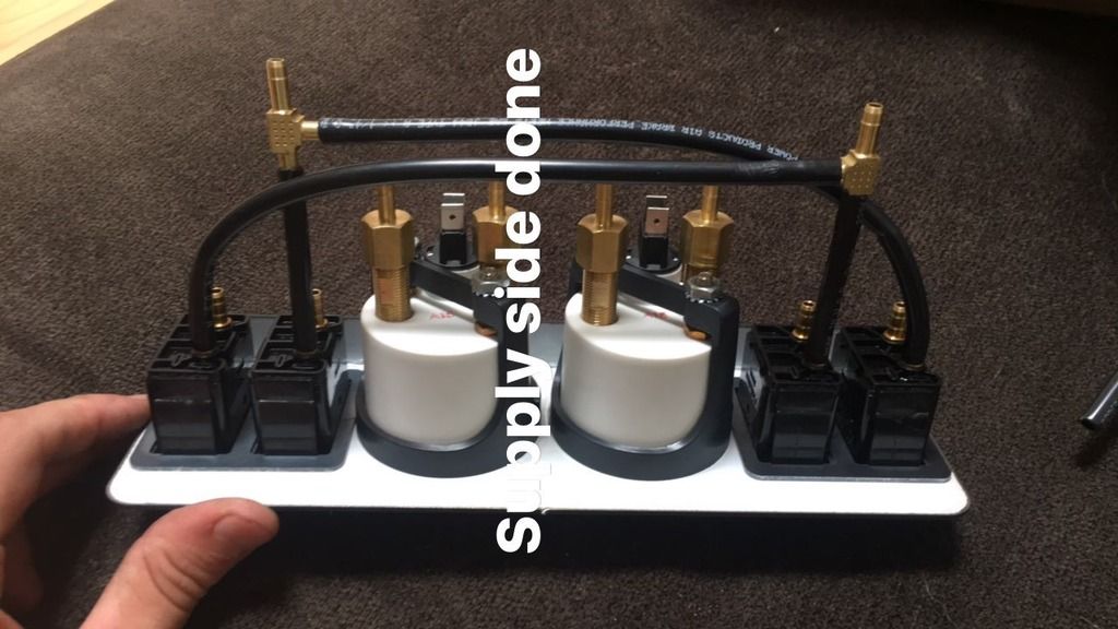

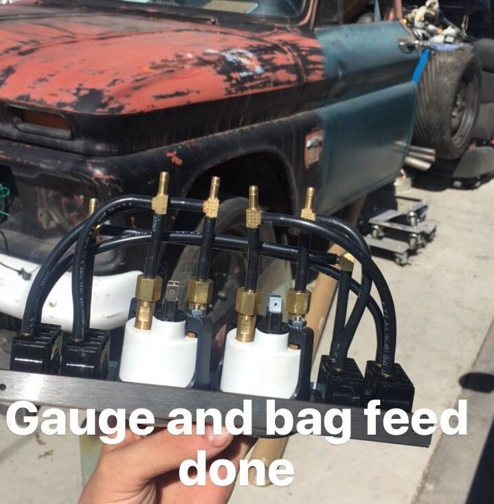

    so this weekend i worked a half day friday so i could work on my truck so i worked on it from 1pm-1am and worked on it today from 8 am- 4. All you guys know how good it is to be able to work on your car all day and get a steady groove going. so i was stoked and got a lot done.
    i started plumbing all my airride by starting with the gauges.
