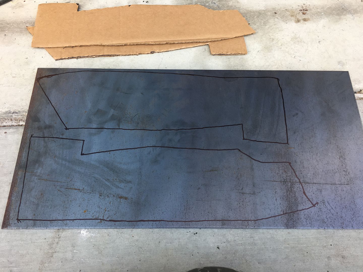

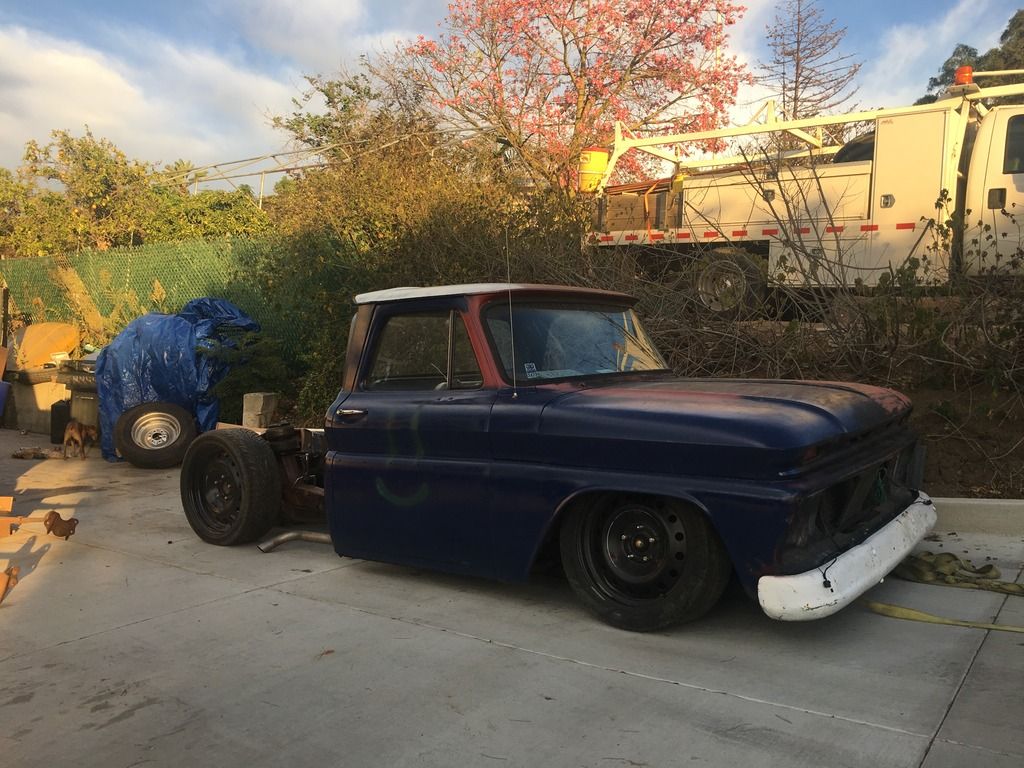

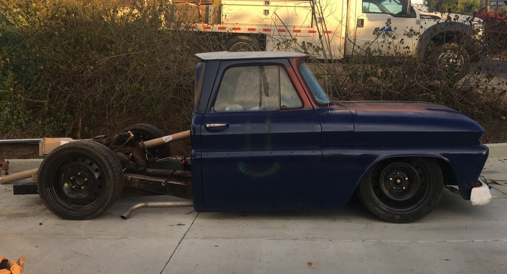

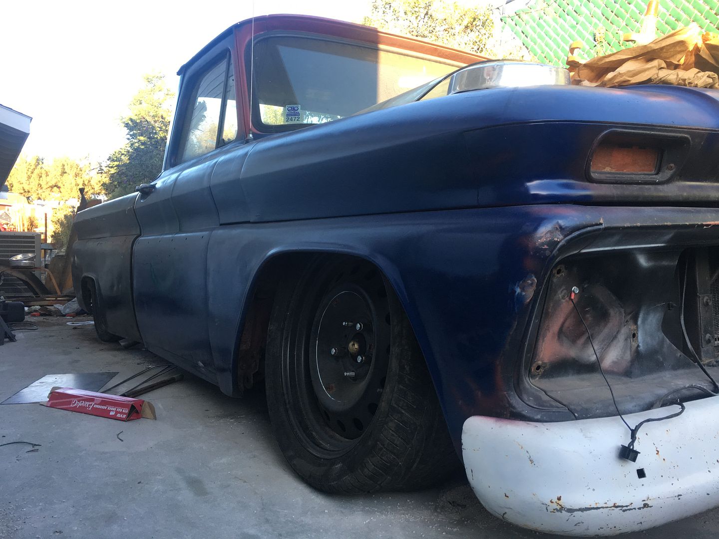

    and this morning i line up the bed a little better and took pictures in the light:

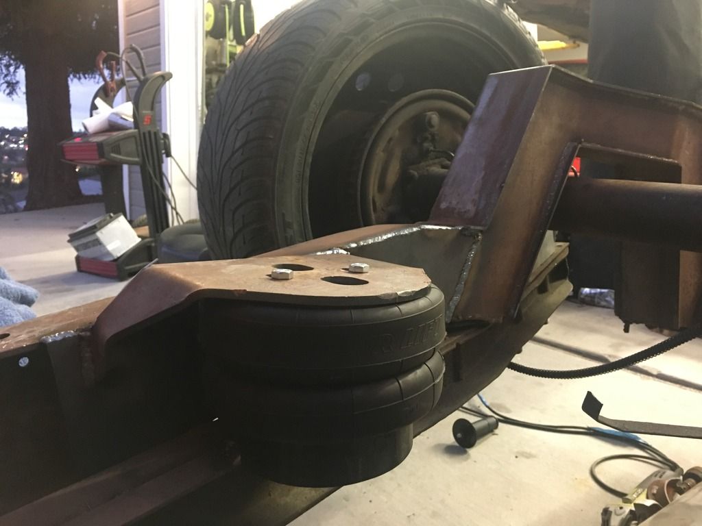

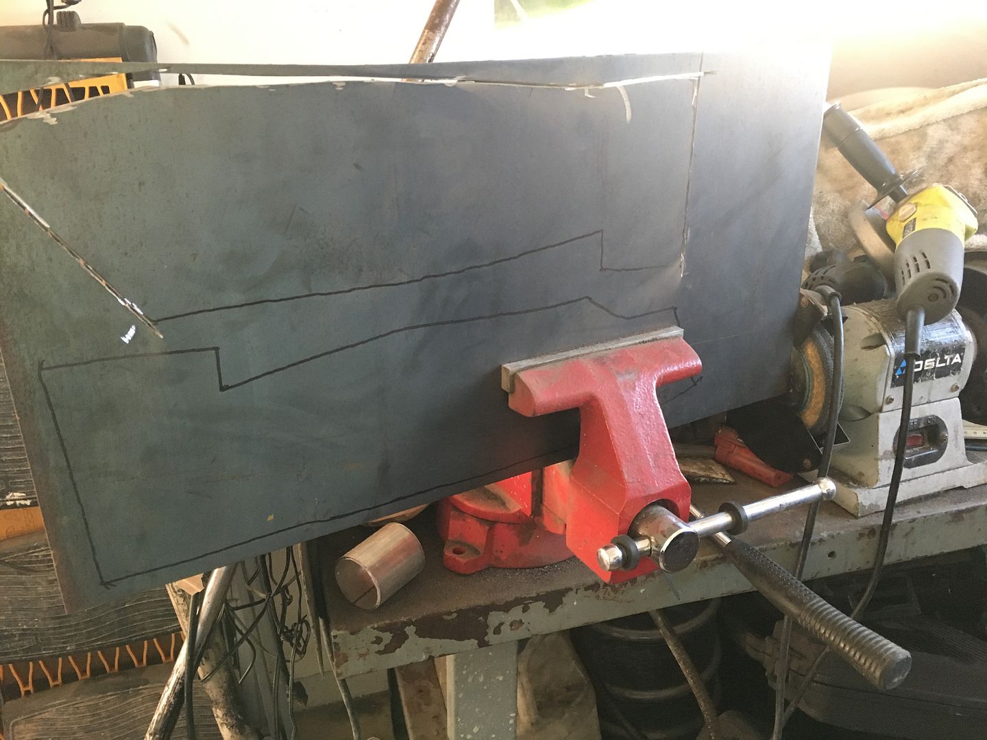

      I've haven't been able to do a ton on my truck because I've been working with my dad on one of his c10's and various other random crap that needs to be done.

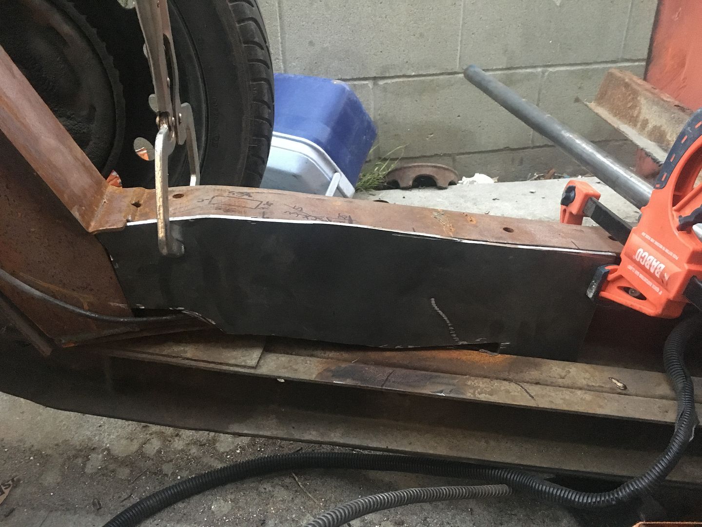

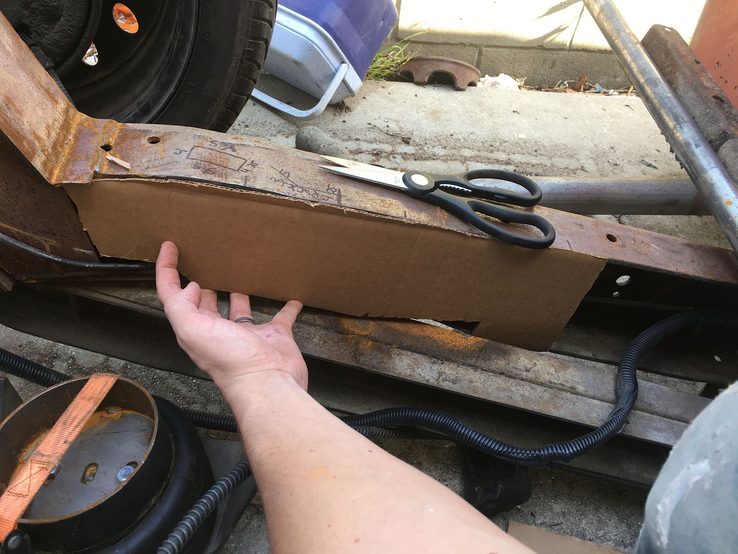

      but i did start on boxing the frame where the bag mounts are going to end up.

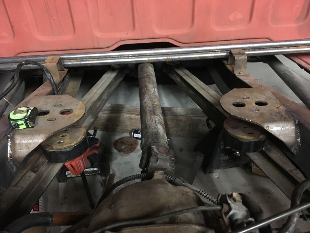

      • #33
        i have some more trimming to do but I'm not doing it until i get it tacked up

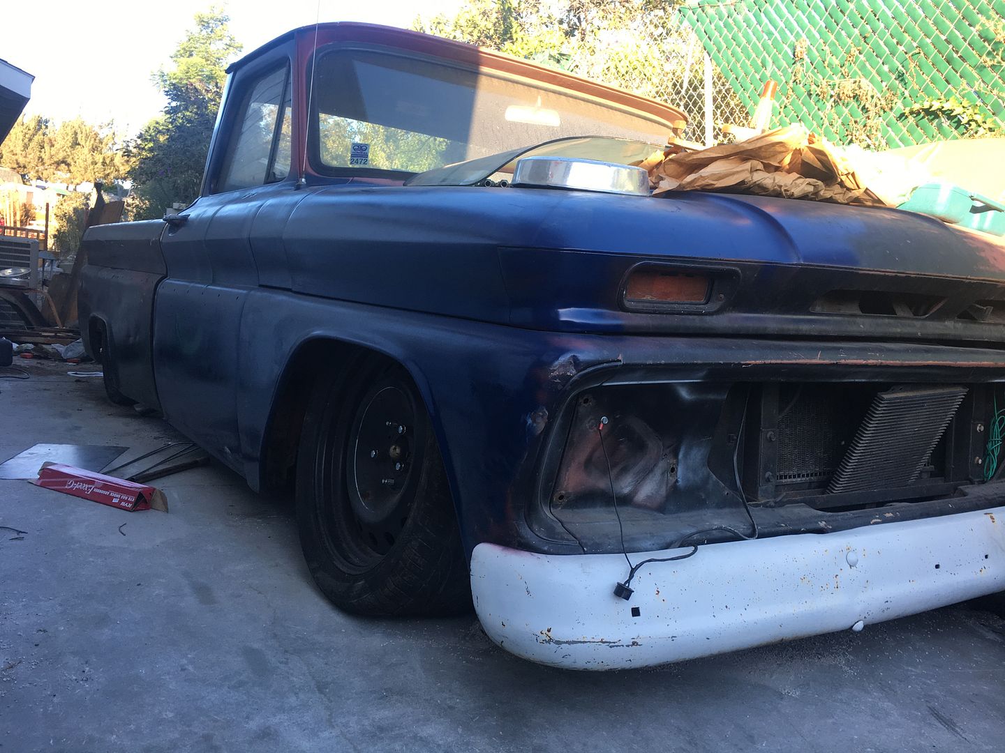

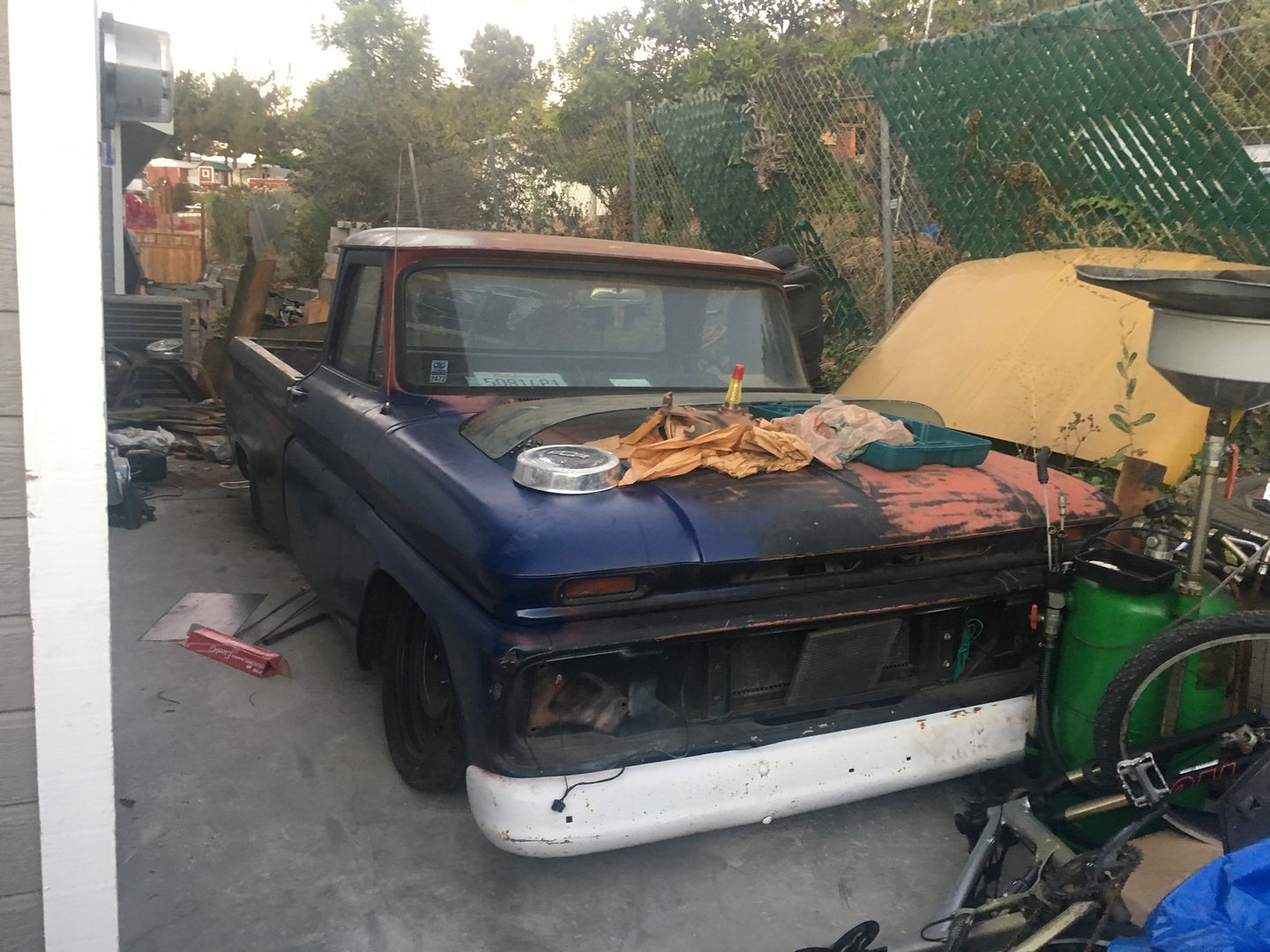

              • #37
                my dad wanted to put his C10 on the side of the house so i pulled mine out and i was able to see a lot better on how its looking on the ground

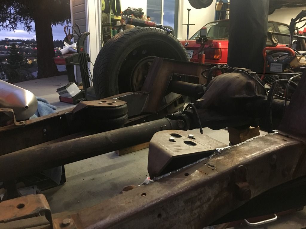

                • #38

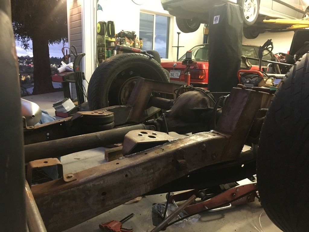

                  today i also got the truck up on jack stands so we can finish welding the from bag mounts and the rear bag mounts and various other things. i also got the metal i am boxing the frame in the rear with all trimmed up and ready for final welding.

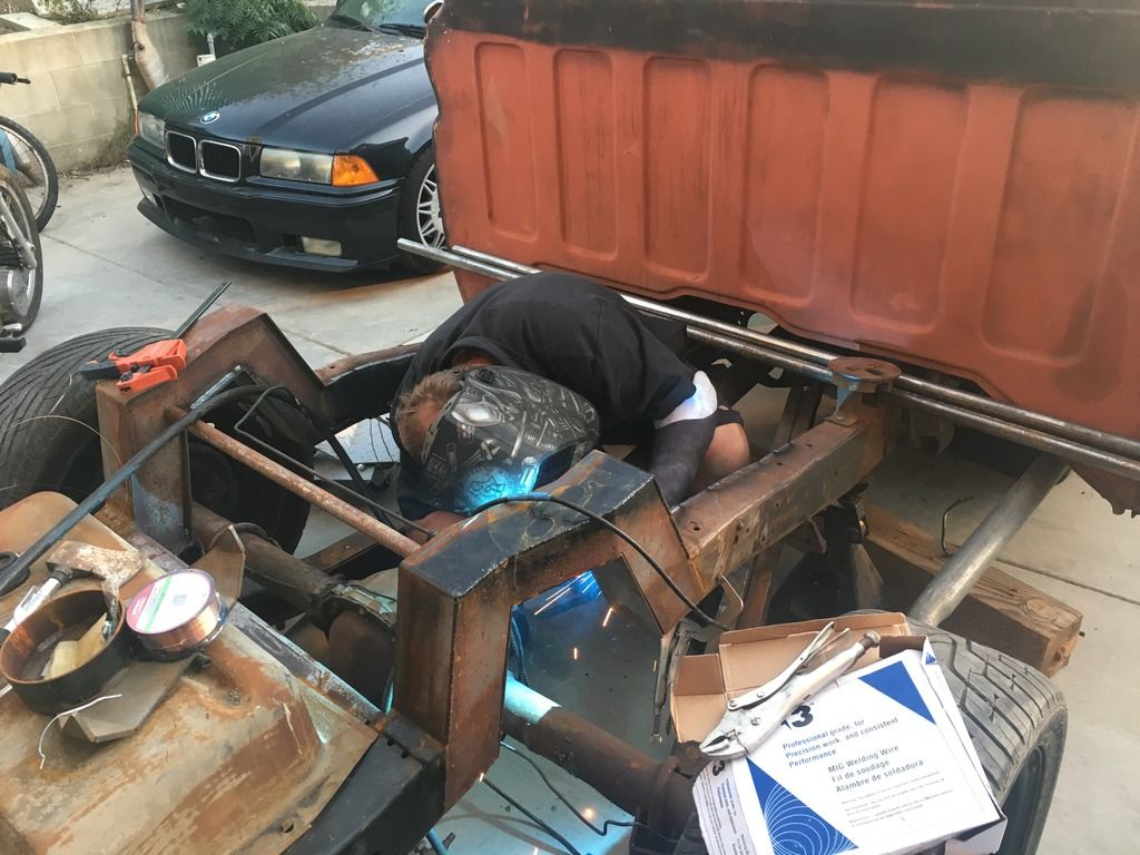

                      • #41

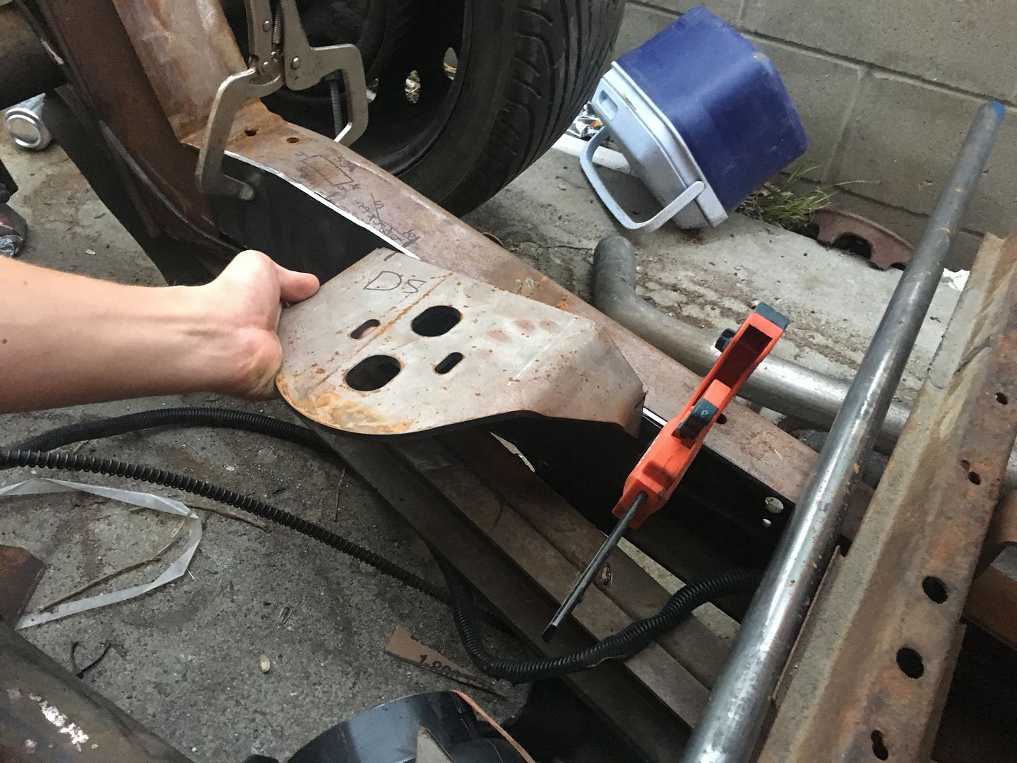

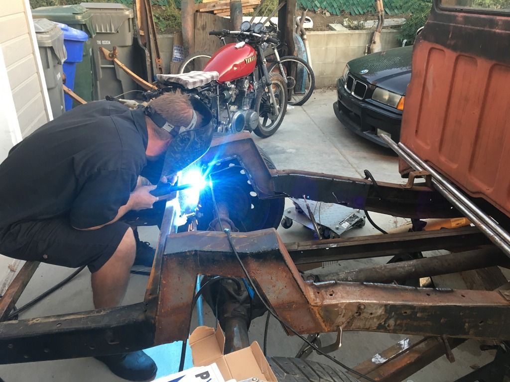

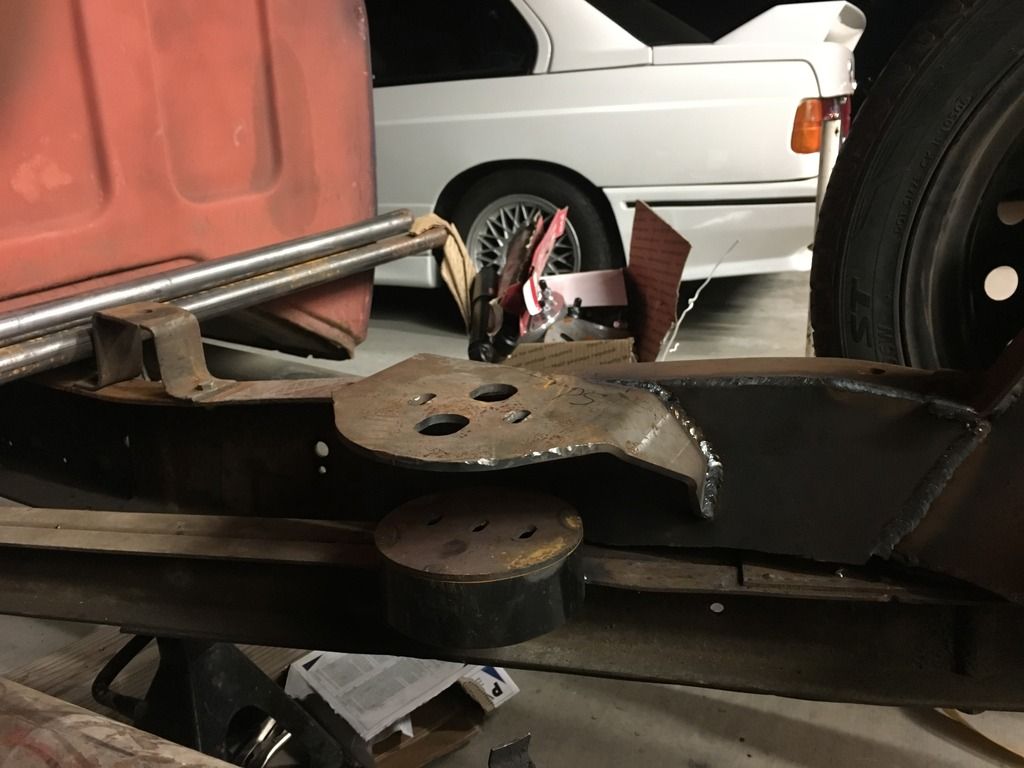

                        more updates. after measuring everything and getting everything clamp down my dad went through and welding everything that can be welded at this time. i need to get my watts link and get that all mocked up before i can completely finish welding everything in place.

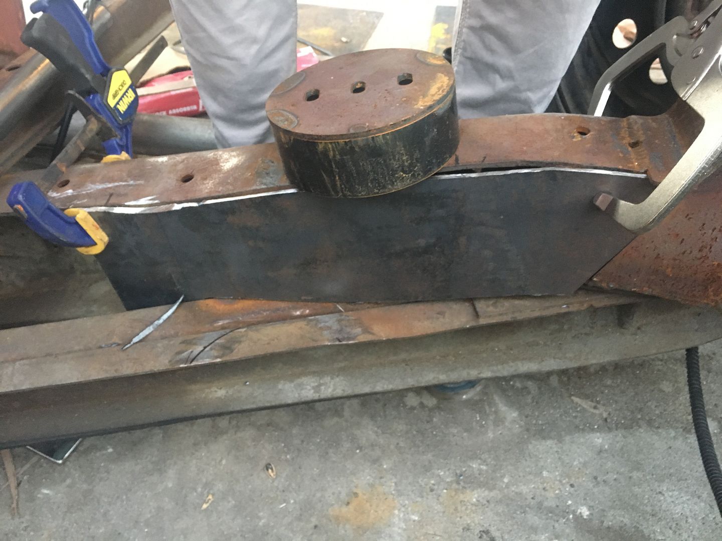

                            then i put the bags in to see what it looks like aired out. i really like where i ended up mounting the bags. i think it will end up being a super clean look

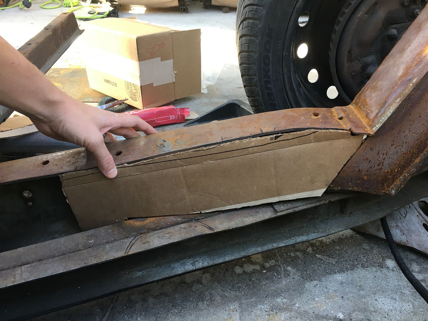

                            • #44
                              also cool think when i first put my truck on jack stands the way it is now i could push the back end of my frame down a few inches with my hand now since i just put the notches in and boxed that small section i can stand and bounce on the back of the frame and it hardly moves at all
