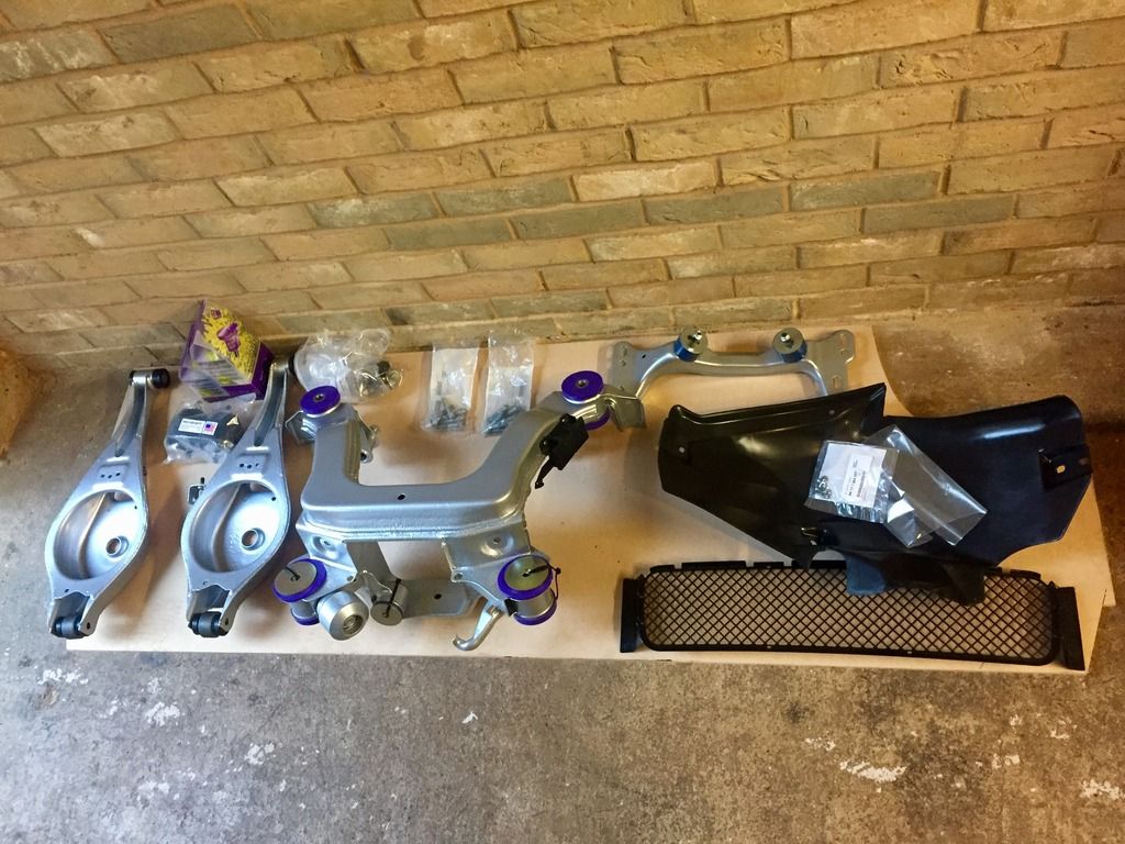

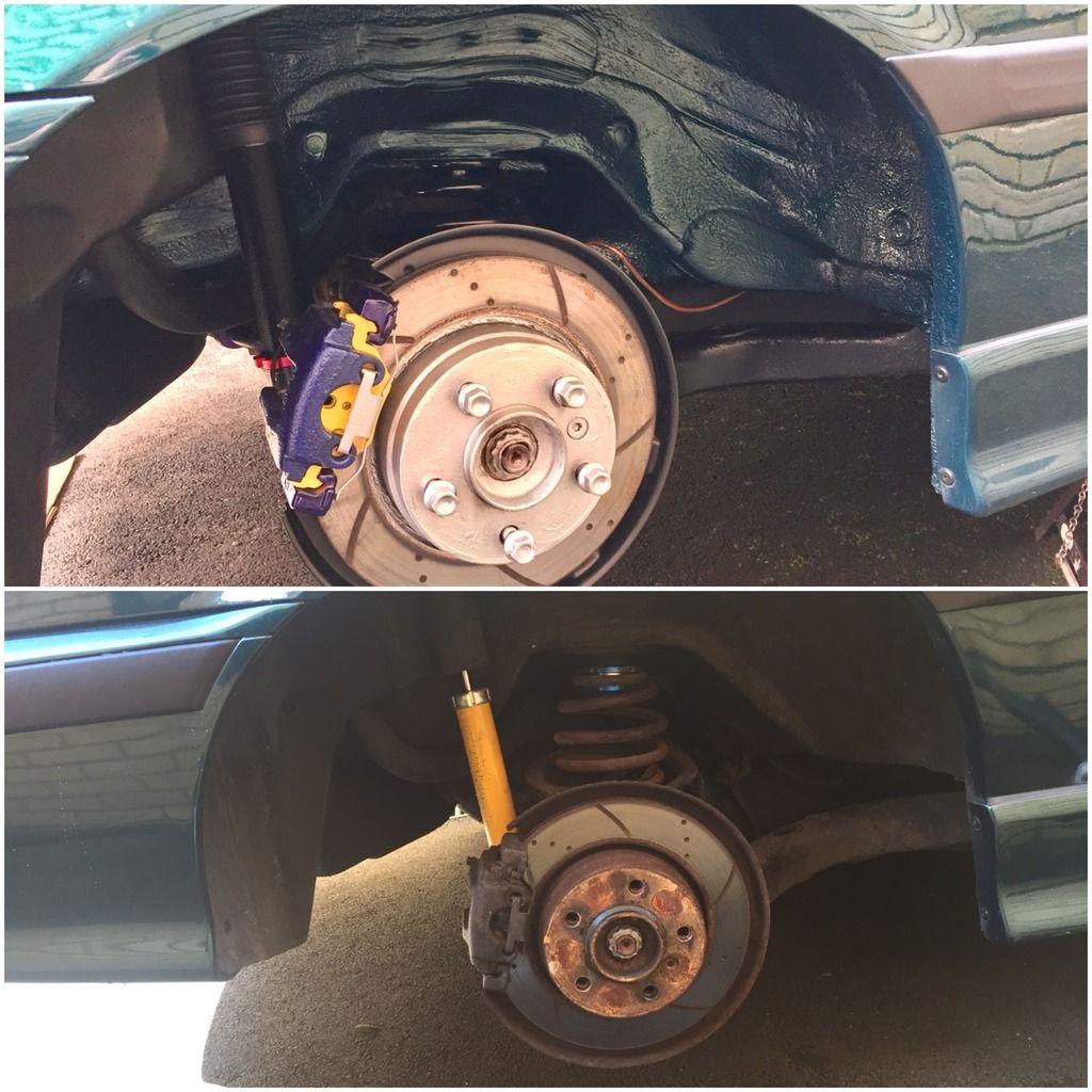

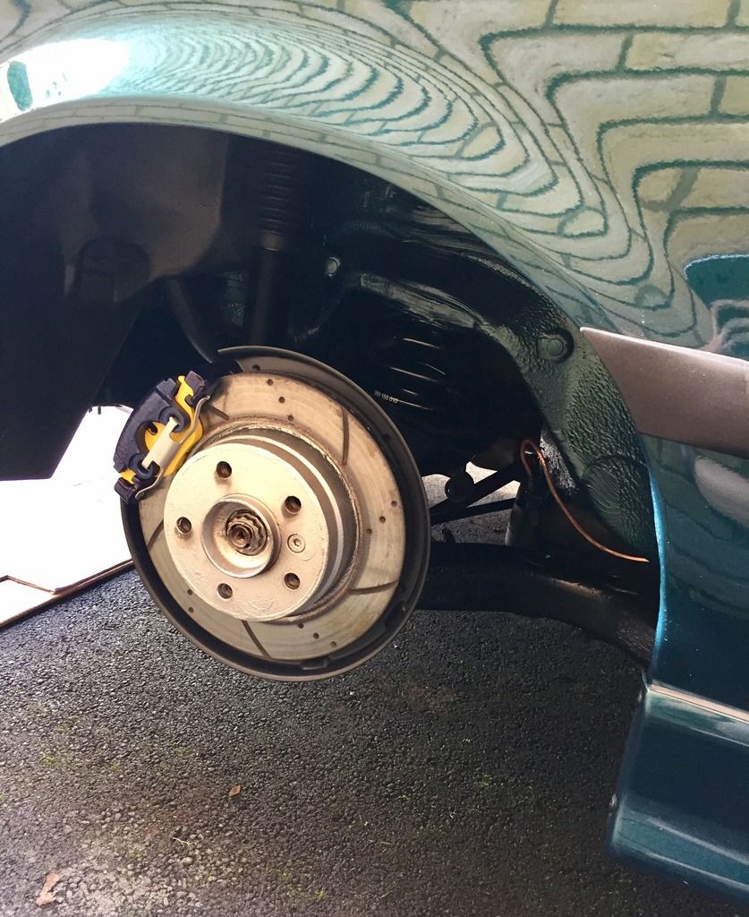

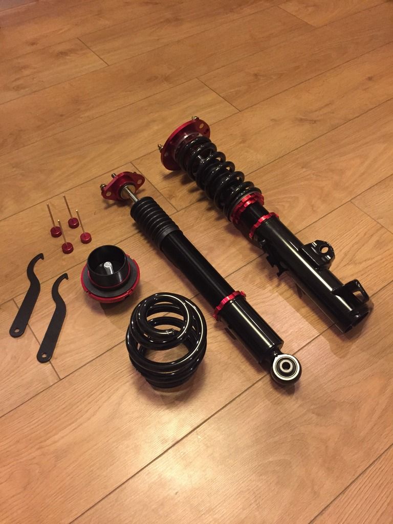

                  Rear inner arches are almost finished now. Re painted, new liners. Brake guards, Huns, brakes, rear arms on, all polybushed, flu catuned coilovers setup on and its mega. Really is perfect.
                  Majority of plastics are now new and sealed ready for winter

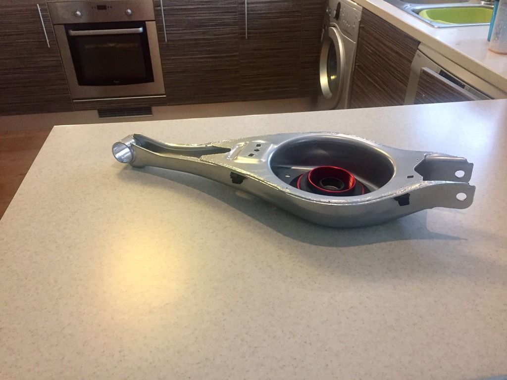

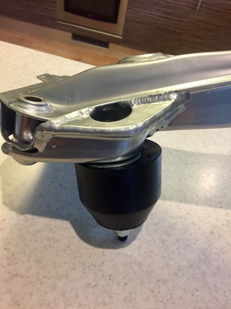

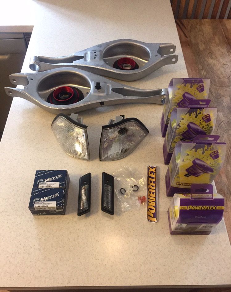

                  Rear arms powdercoated with new clips and new base spring pads, new polybuss will be fitted also

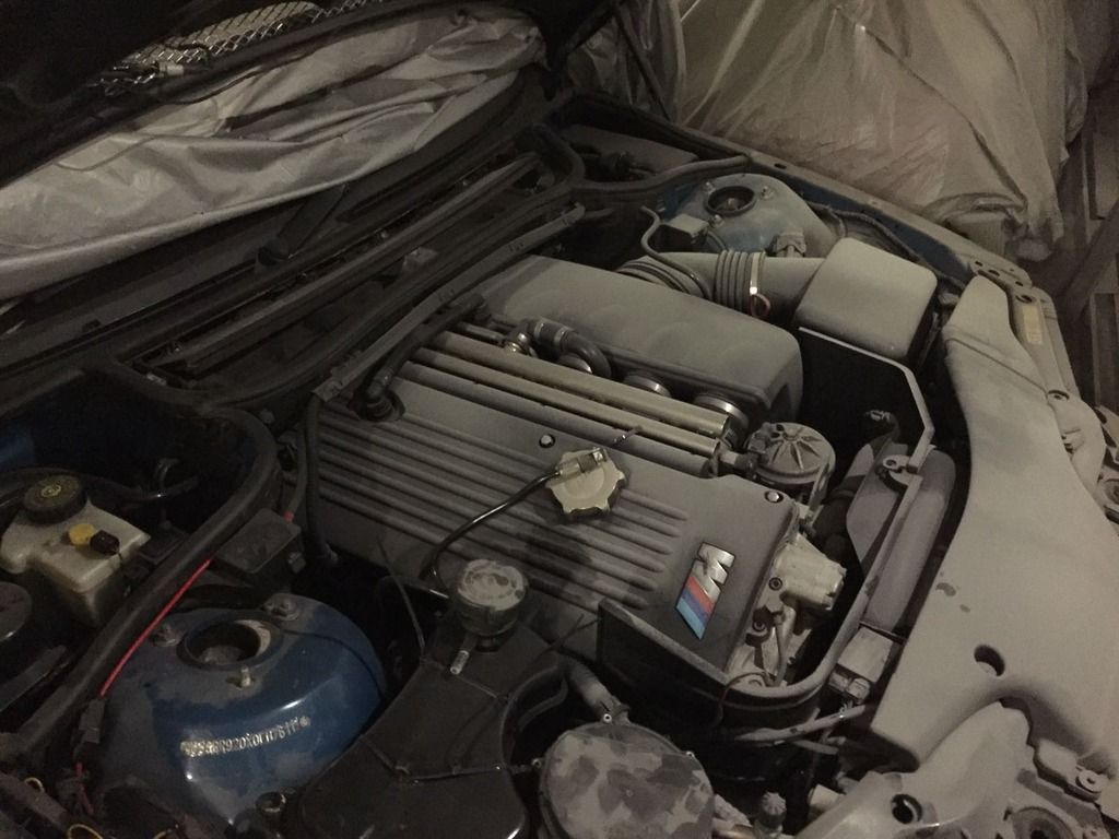

                  S54 full engine and box has been sourced, this will be pulled then straight to hack engineering for some motorsport love and vanos treatment

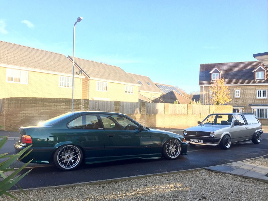

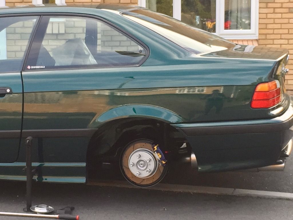

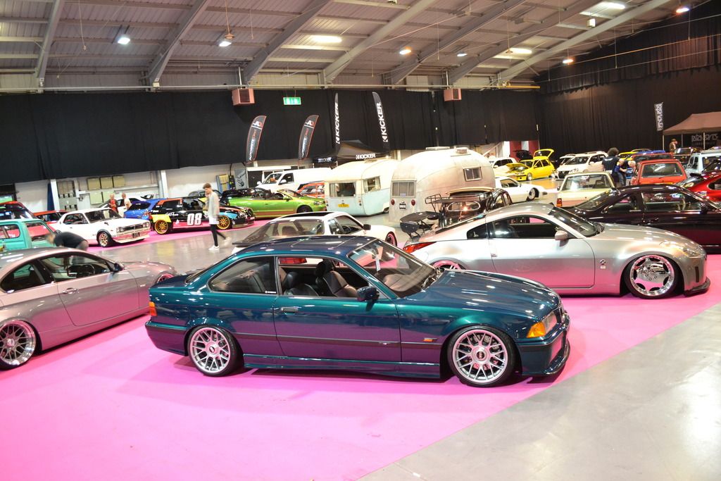

                  Few local pics and 1 from ultimate stance the other weekend

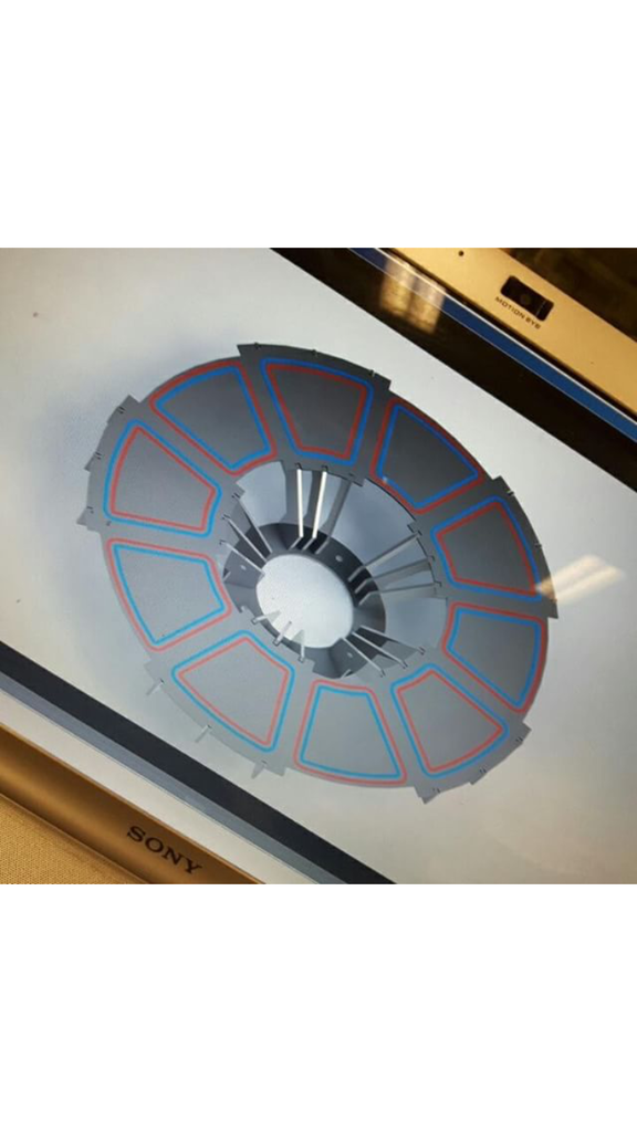

                  Something I'm working on for the rc's....

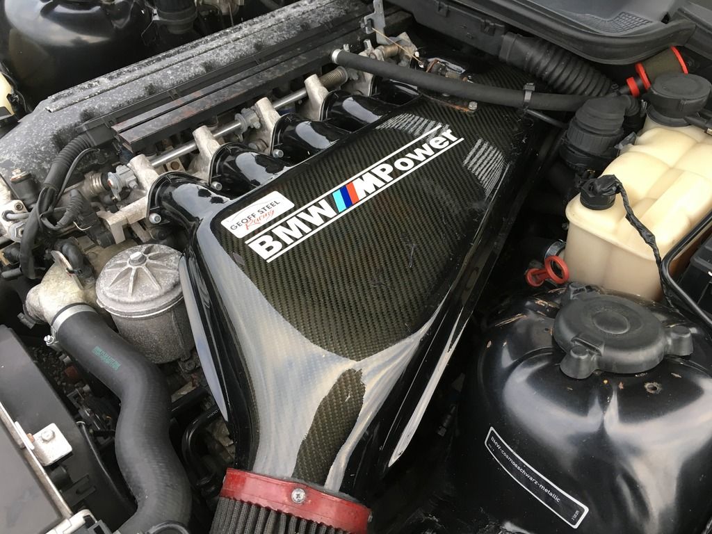

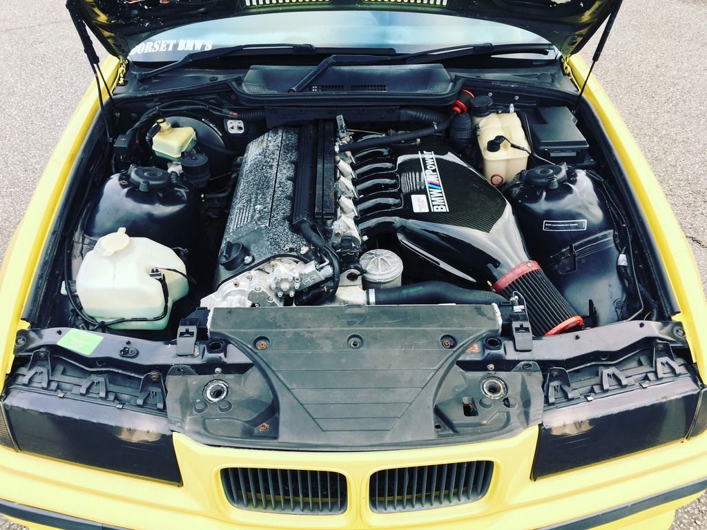

                      Few updates. Not goin s54 now due to buying a full Geoff steeling built s50b32 race engine, crazy spec with a £12000 build receipt. Will list spec in next post.
                      This has been bought and is goin in the first wrk of april. Myself, joey and ben from hack engineering will be fitting it.

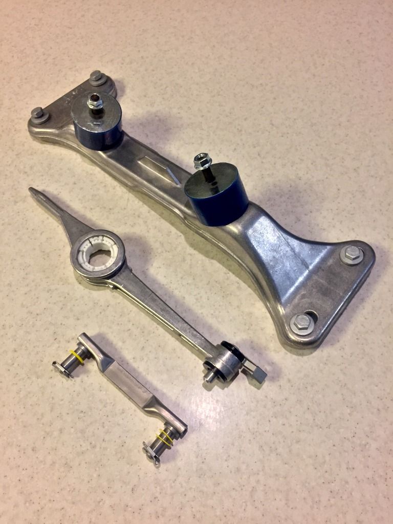

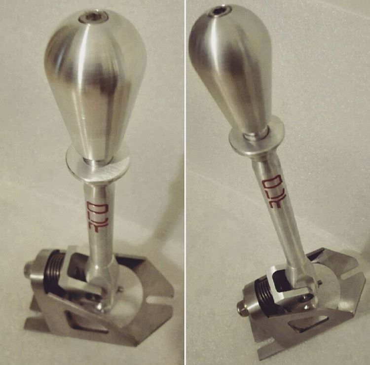

                      Gone with an RTD non lock out 300mm shifter kit, all brandnew linkage parts from Bmw,

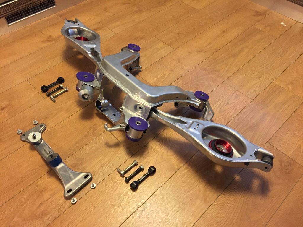

                      Next on the list was to find all the parts to build another axle and then restore it back to better than factory, fully powdercoated and fitted with powerflex ploy bush kit, every bush was upgraded

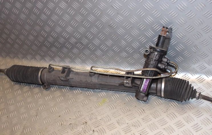

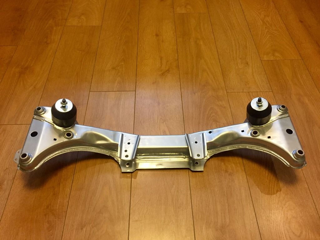

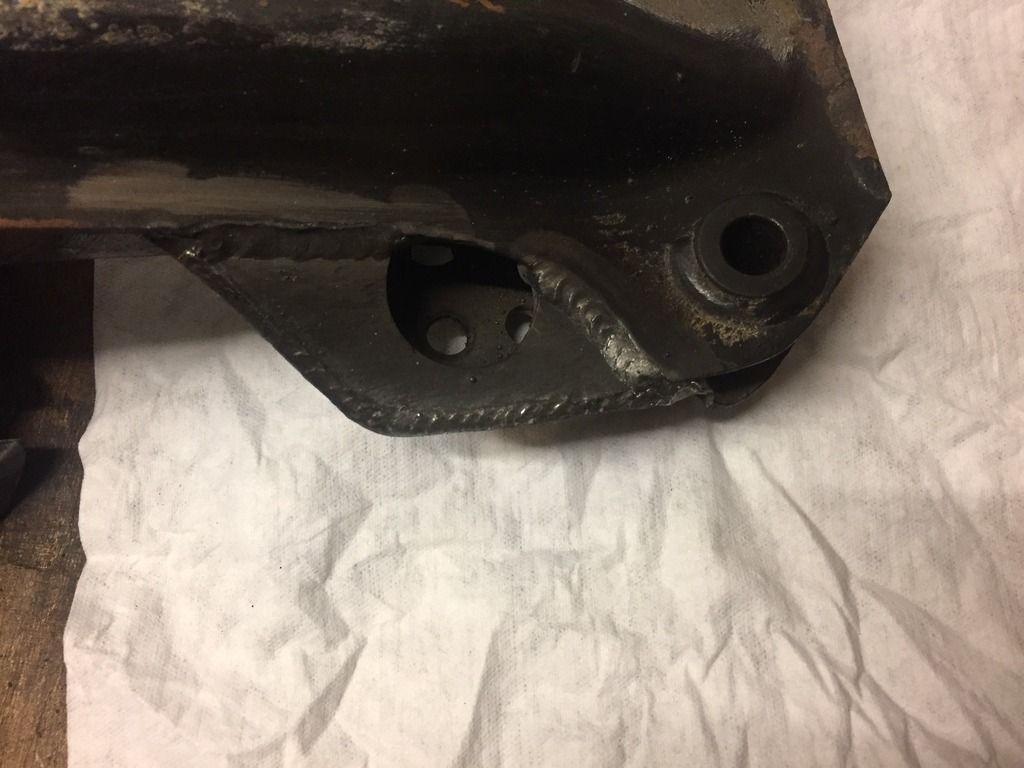

                      Front subframe was next , bought the plate strengthening kit, had that welded in place, then powdercoated then new revoshift enginemounts fitted. Also bought a e46 m3 purple tag quick rack which will be freshened up to match the rest. Im having braided power steering lines custom made to eliminate the shit oem lines

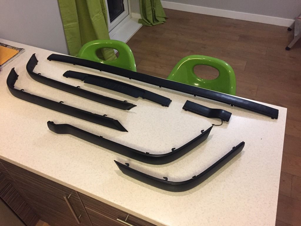

                      Fresh lenses and side repeaters bought

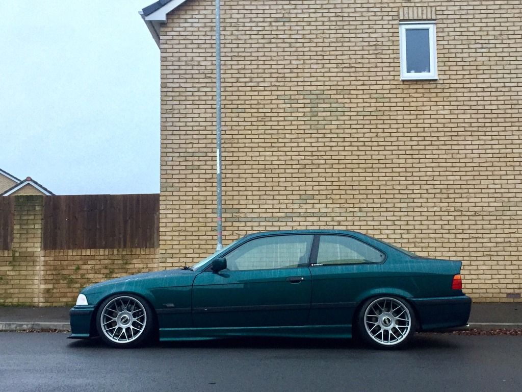

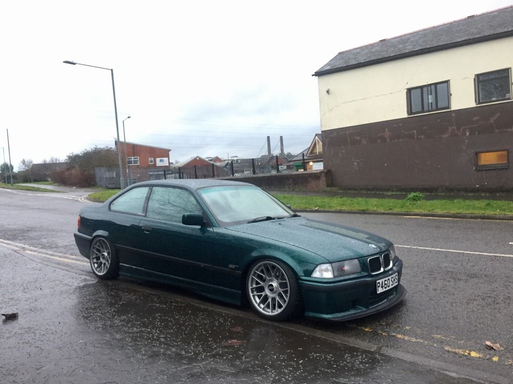

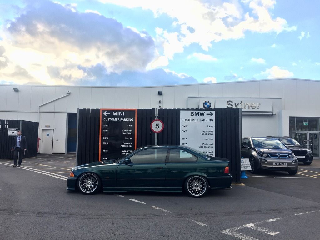

                      Few pics of it out and about

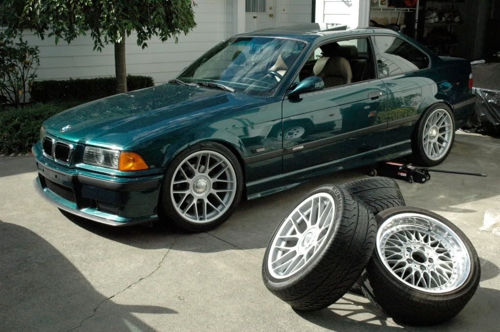

                            Your build reminds me of my old car:
                            Same car, different stages. I wish I still had it.
