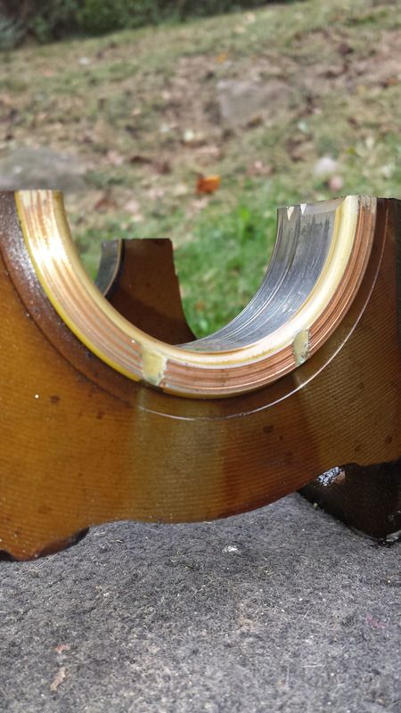

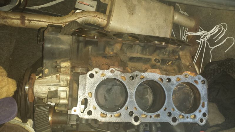

    Finally got to see where that metalic material came from.... 1 of 6 of the rods bearings had
    play by hand.

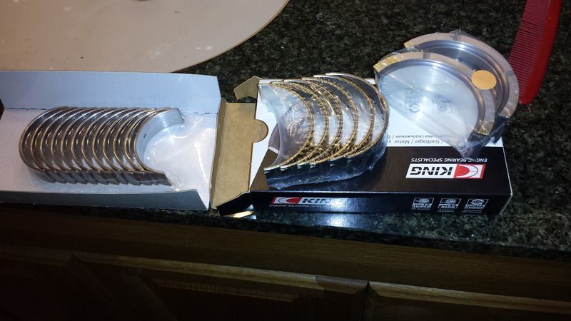

    the crank still looked pretty good so i ordered some new bearing and checked clearances
    20160629_082959.jpg by coreymunion on 500px.com
    20160629_115814.jpg by coreymunion on 500px.com
    20160629_143910.jpg by coreymunion on 500px.com
    After 3 weeks of shipping i got this dirt cheap magnetic drain plug...
    20160630_182102.jpg by coreymunion on 500px.com
    BOOM it was fixed no more rod noise above 3k.

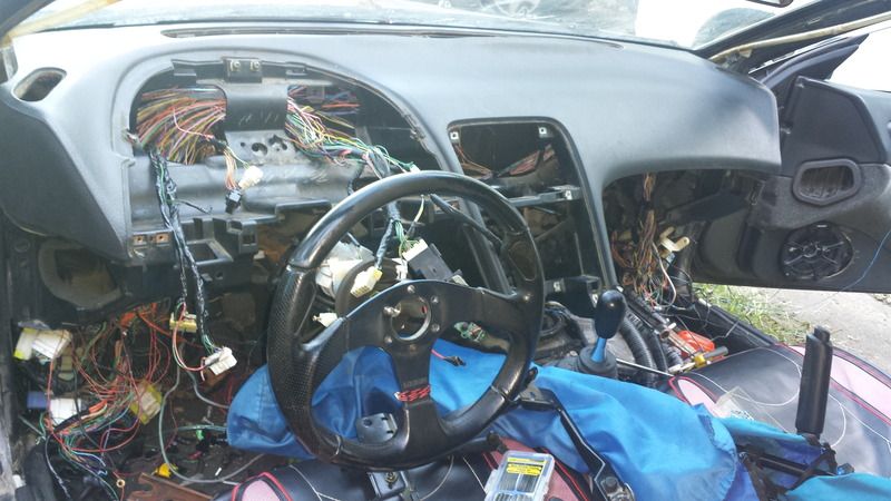

        • #34

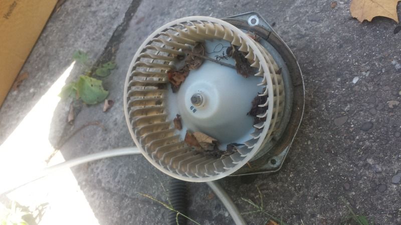

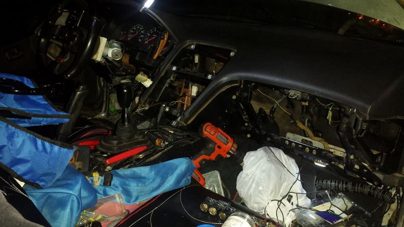

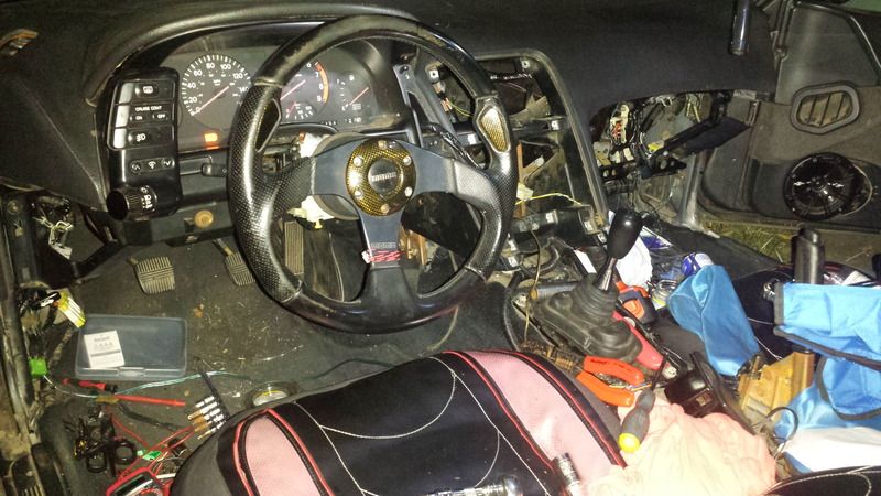

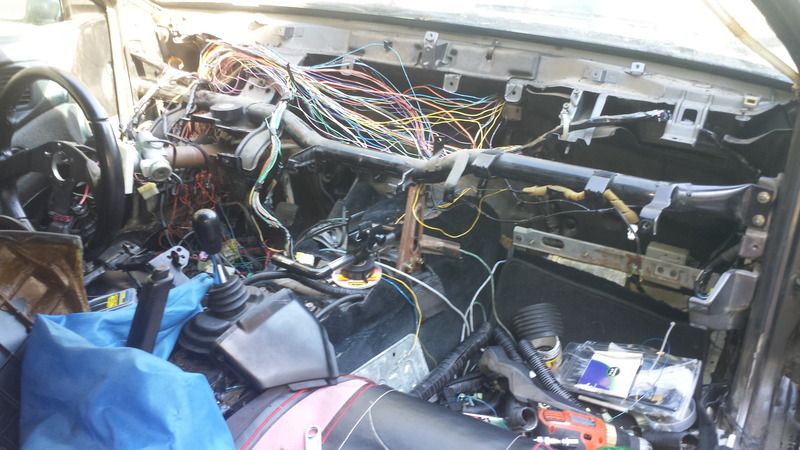

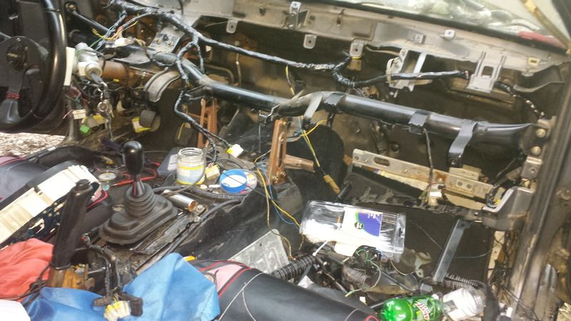

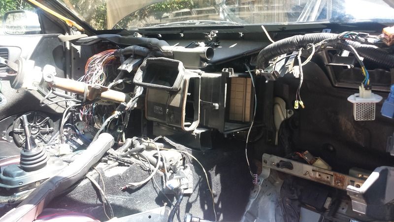

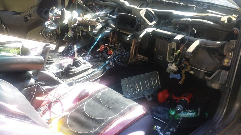

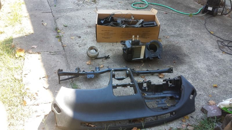

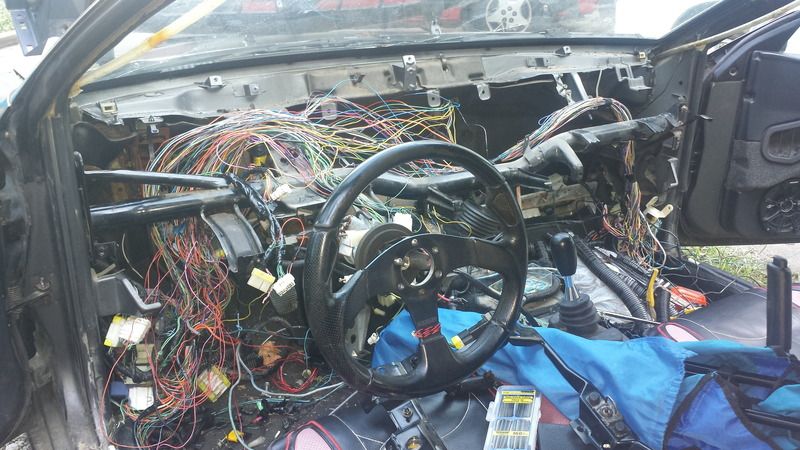

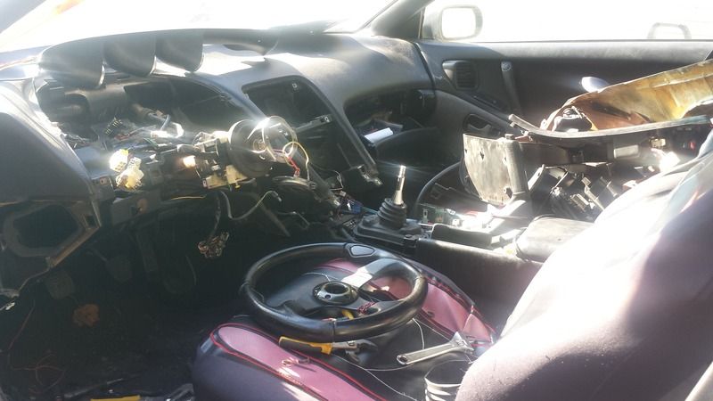

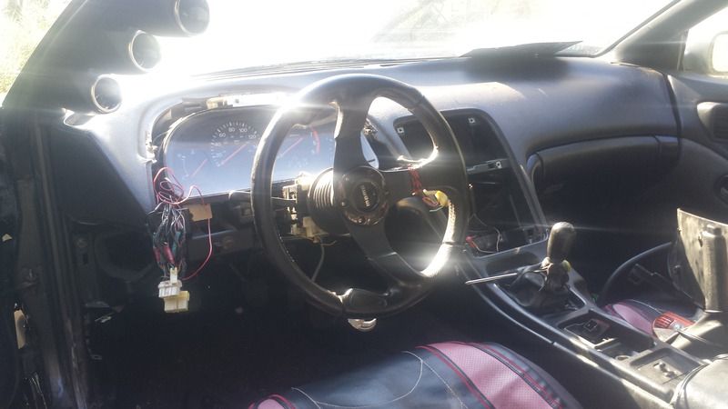

          Had some motivation to pull the dash today. Now i just need to finish revoing the a/c and extra vents i wont be using. oh, and pull out all the unused wiring and controllers.
          found some garbage in the fan
          At this point i realized this was going to be a lot of tracing and wiring diagrams

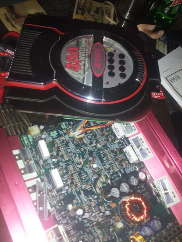

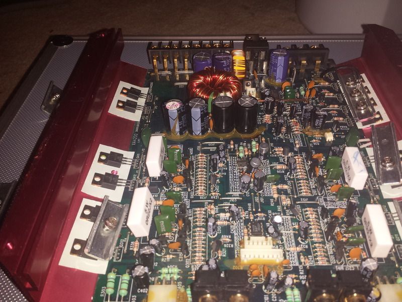

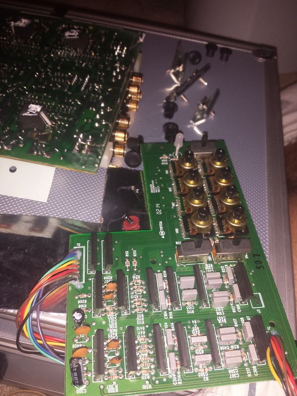

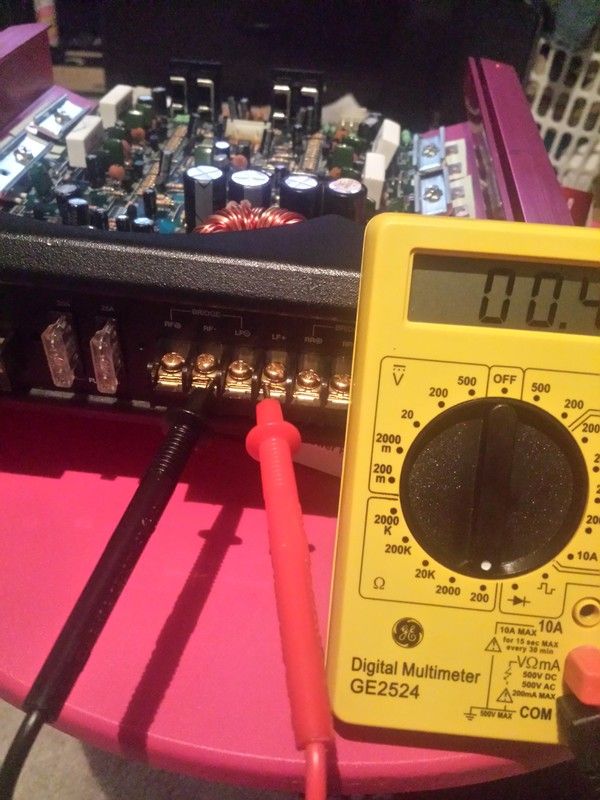

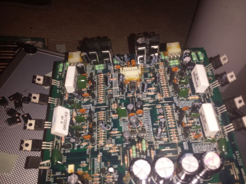

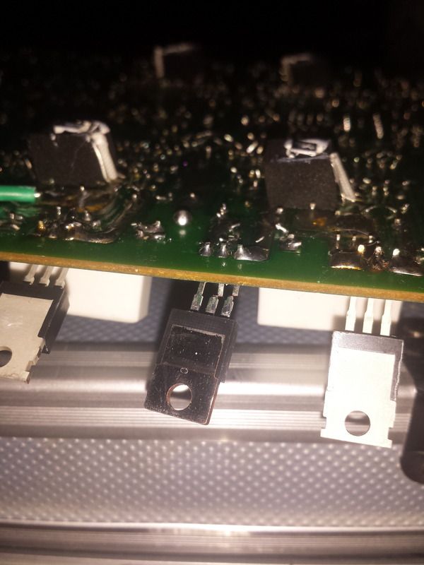

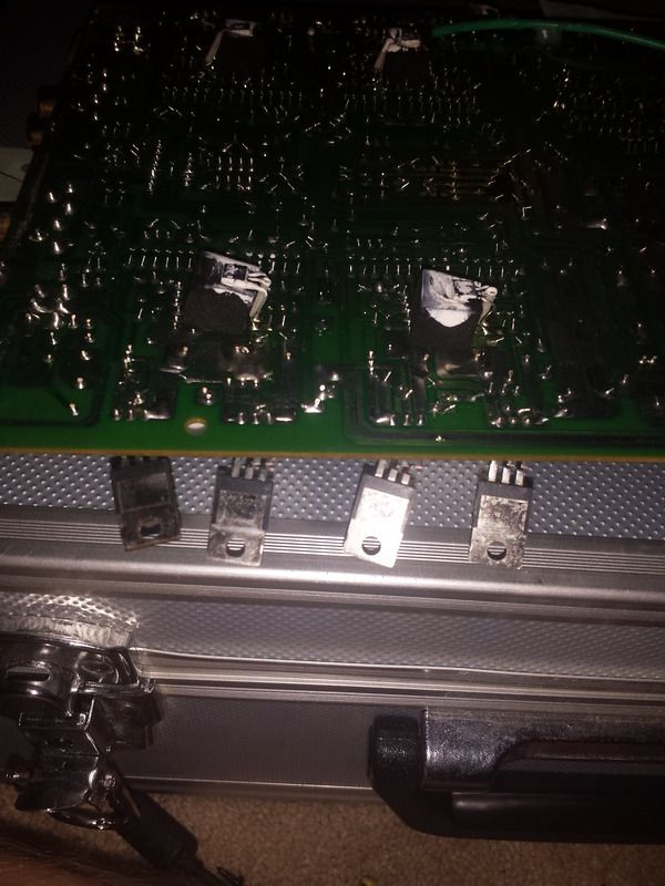

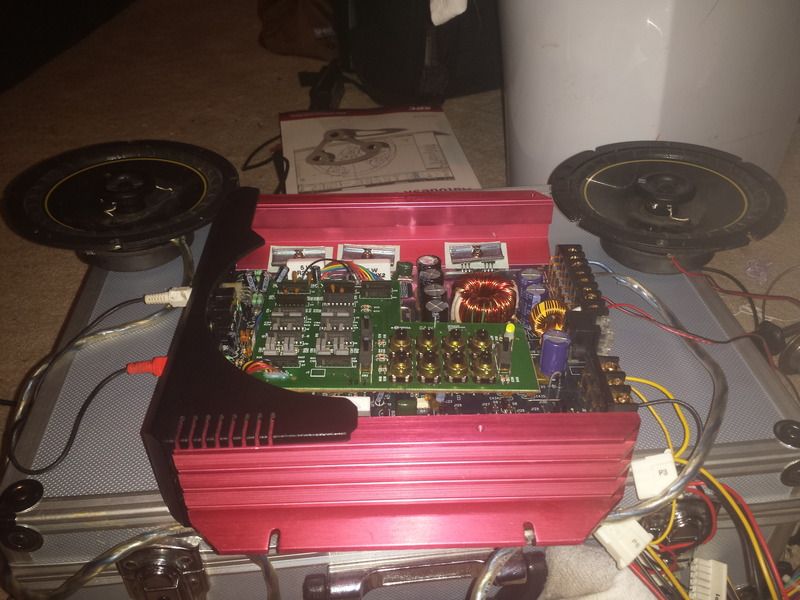

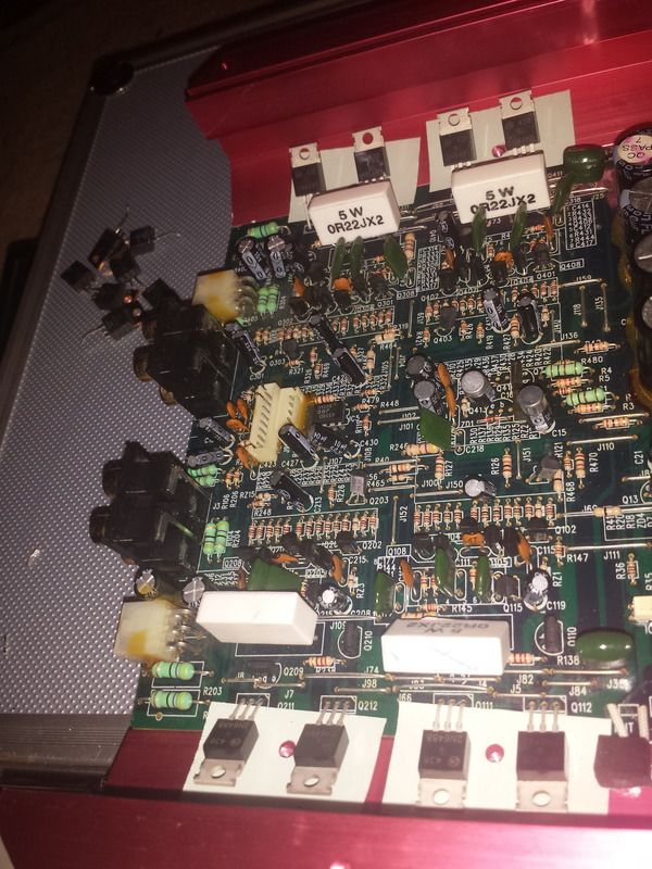

              Ive decided to use a broken 4 channel amp with a cheap ebay Aux cable and some craigslist speakers for the stereo.... all of this is under $50 and works pretty well

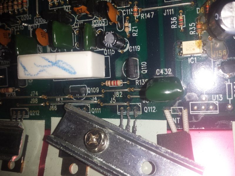

              amp repair
              the amp was back to life!
              Ordered some replacements and tore it apart.
              Replacements came in and were soldered into place
              Passed the bench testing

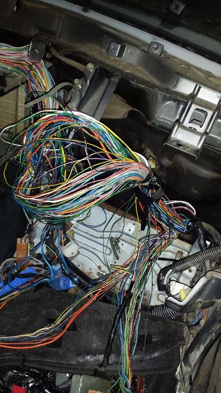

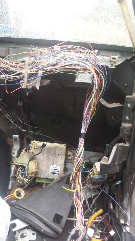

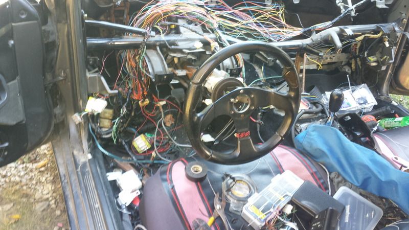

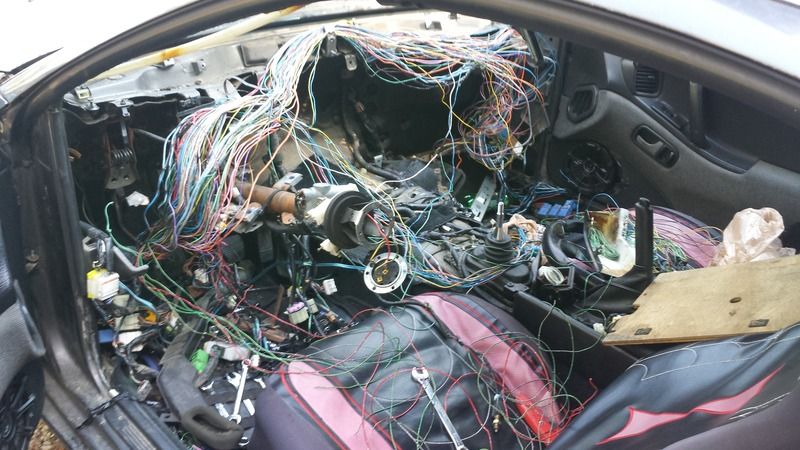

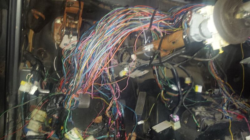

                    Just a reminder of the original harness (note only one connector, no headlight or rear defrost connector)

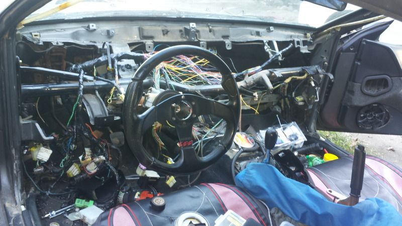

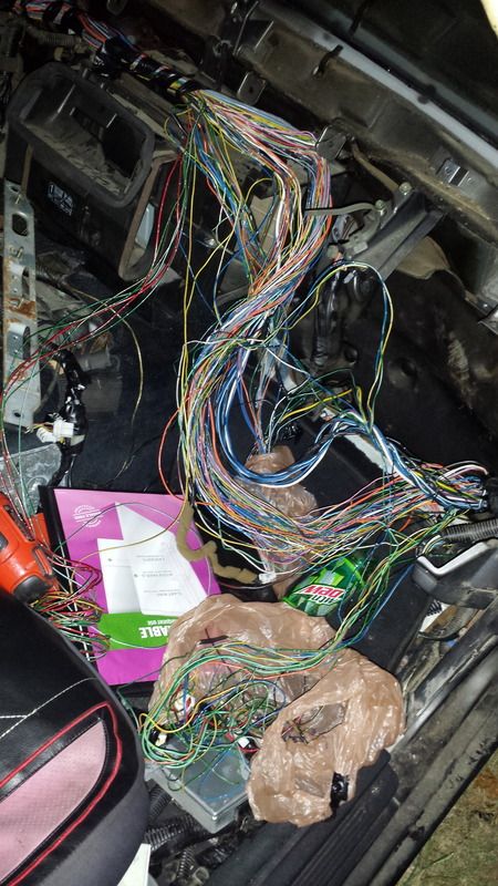

                    So the dash was out and it was time to say Goodbye to some "JUNK"
                    Cruise control never worked JUNK
                    Power steering controller JUNK
                    Seat belt Warning/Control JUNK

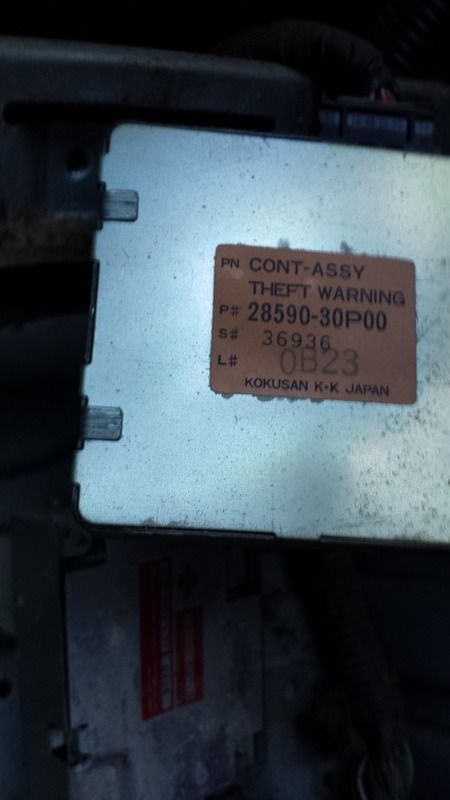

                    OEM theft system KEEP
                    ECU sub harness KEEP

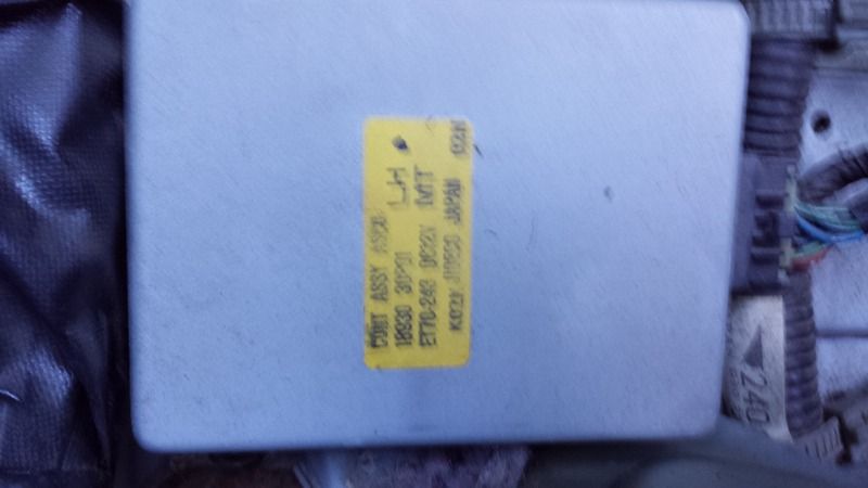

                    HVAC controler and relay JUNK
                    A/C on ECU trigger wire KEEP

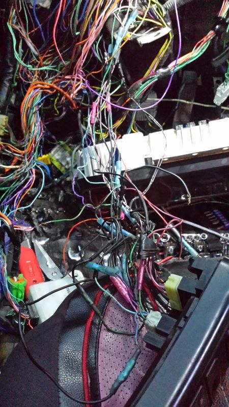

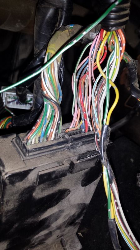

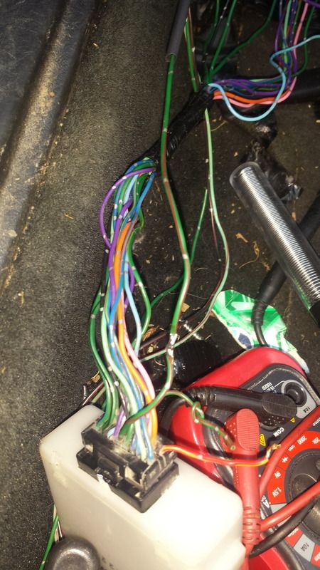

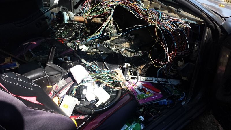

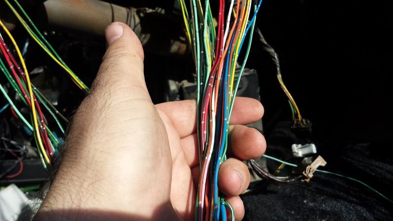

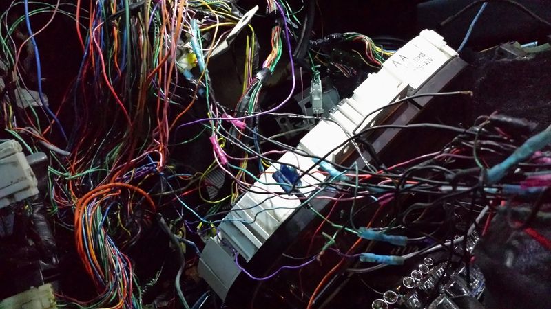

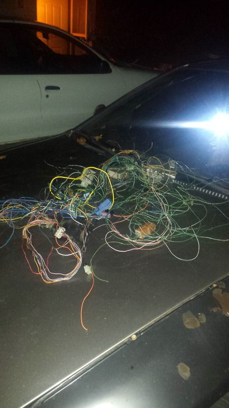

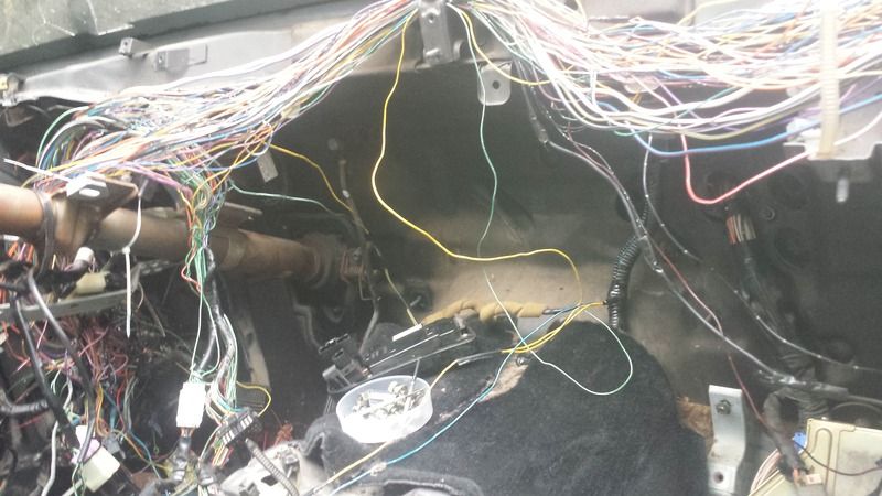

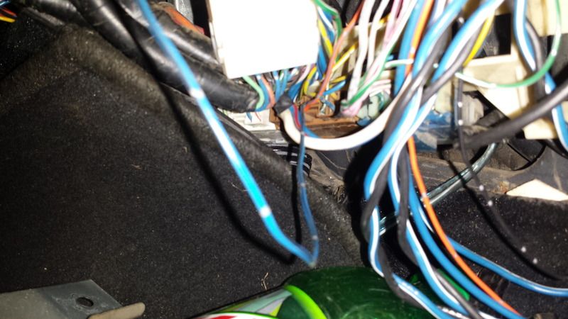

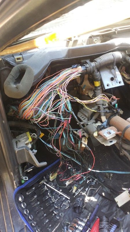

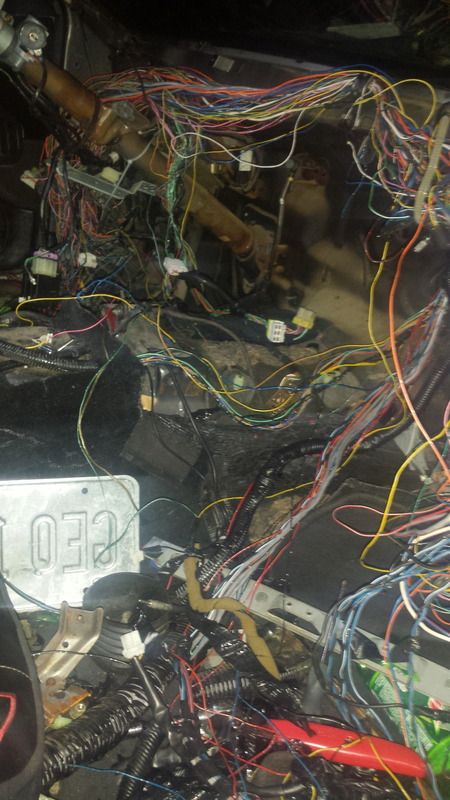

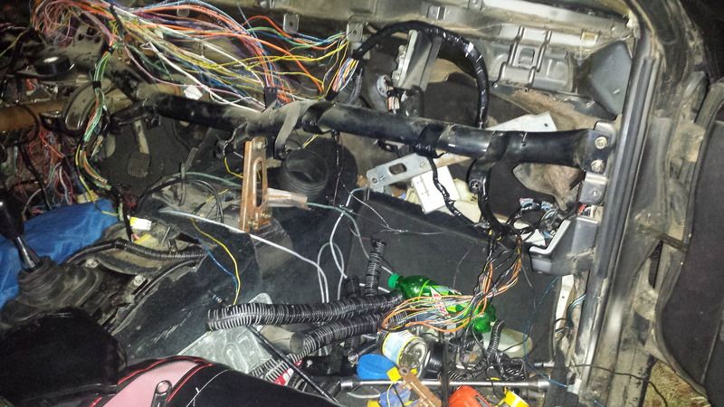

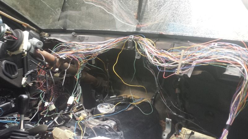

                    Wires that needed traced back (multiple splits in the factory harness)

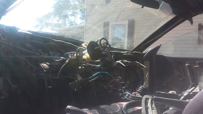

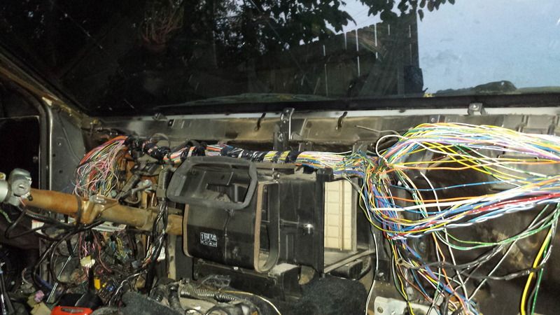

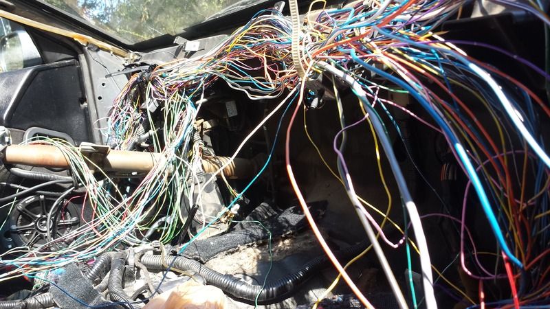

                    Couple of random shots showing the state of things
                    had to clean out the car so it was a good point to snap the JUNK pile thus far
                    More randoms
                    WOW a glimpse of what looks life progress....
                    And this is where it started getting messy....

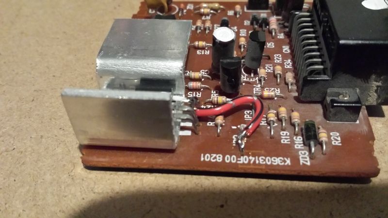

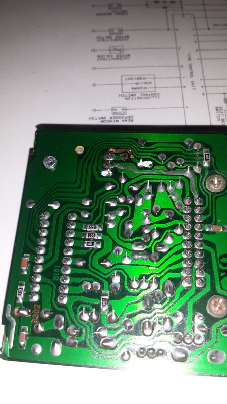

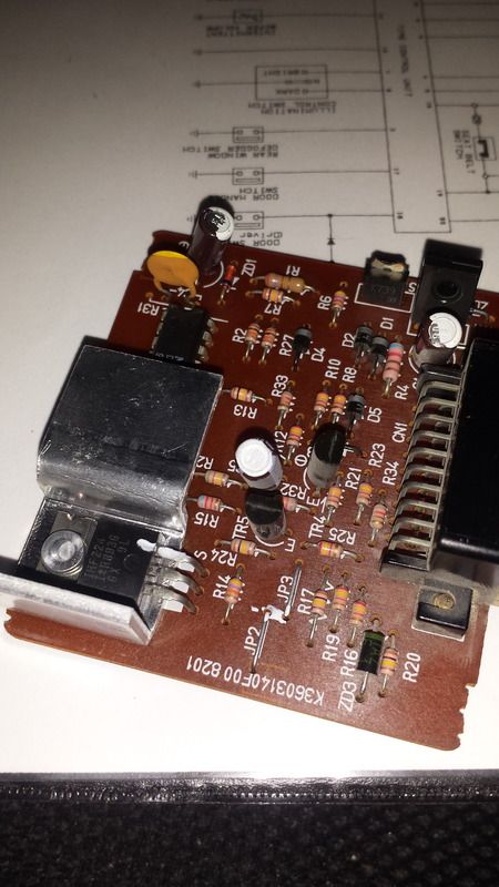

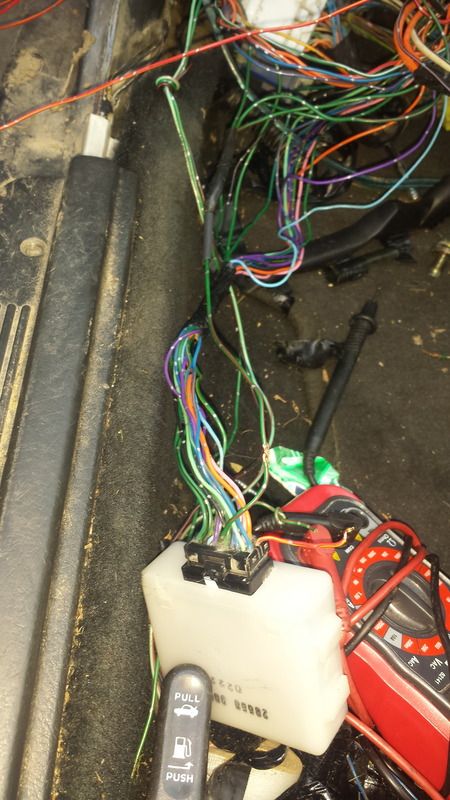

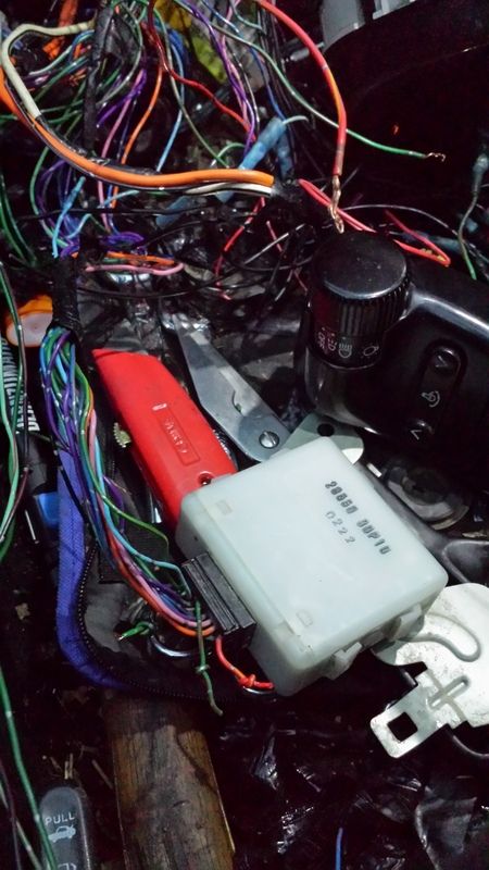

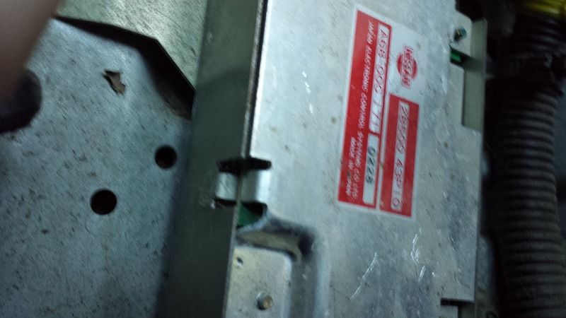

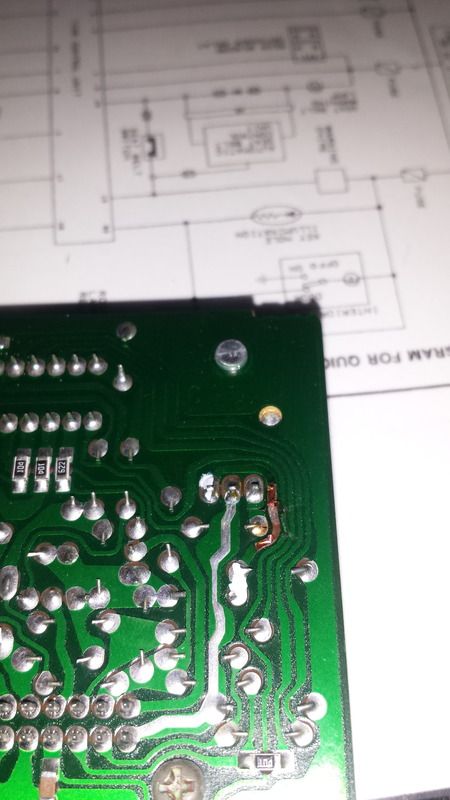

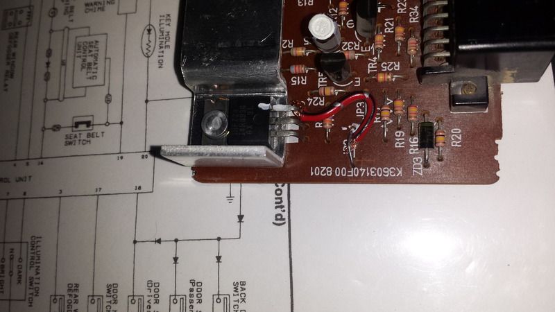

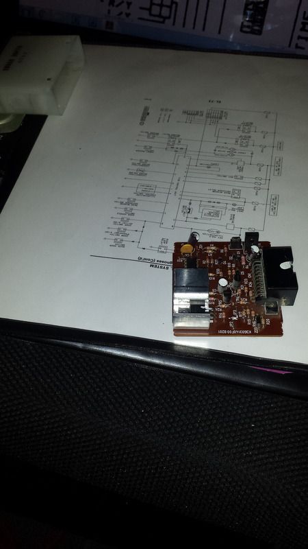

                    Finally found the big problem i was looking for. This is the time control unit(basically a body control modular)
                    Board trace folded back instantly upon touch
                    My test fix setup
                    Permanent fix after testing

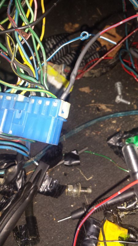

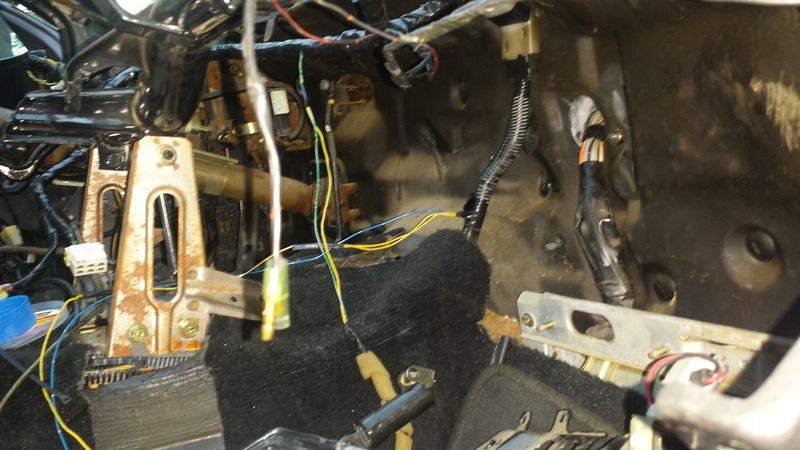

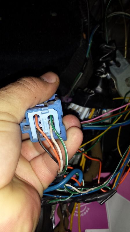

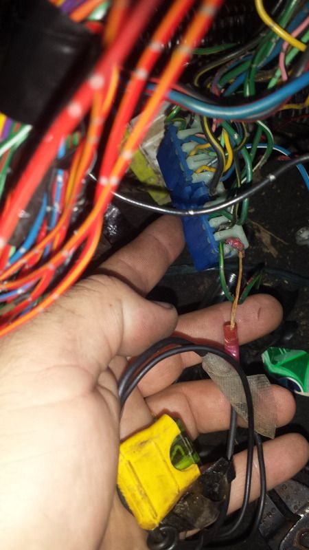

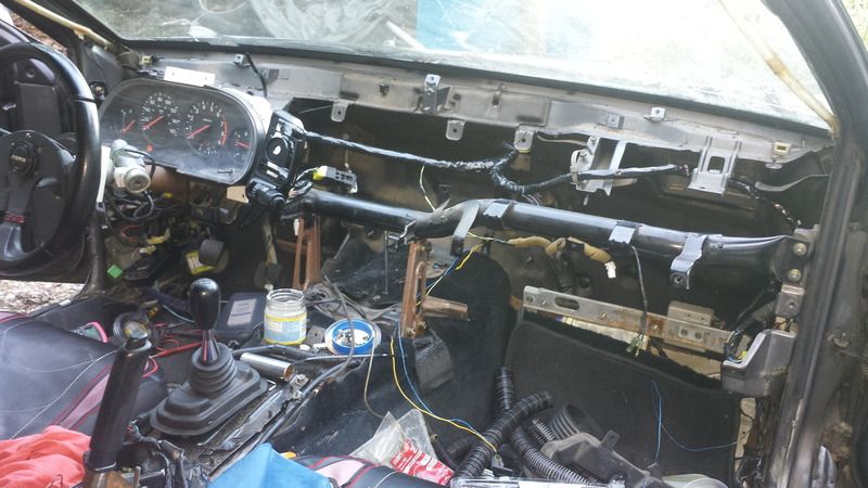

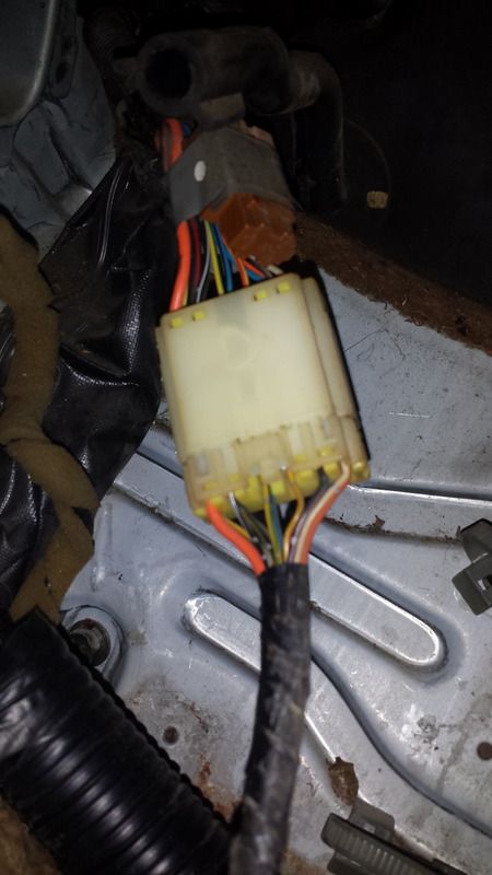

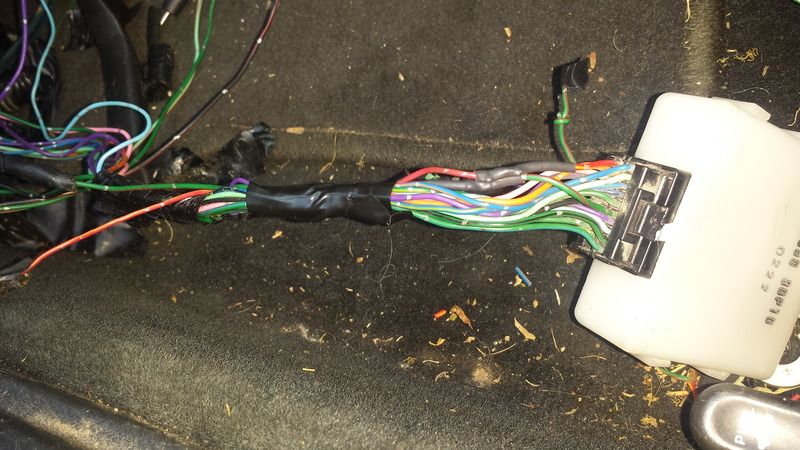

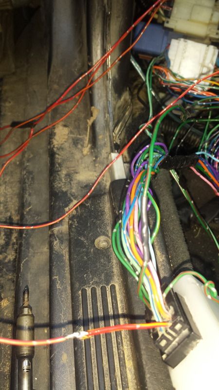

                          Ive continued to stay at it on the wiring
                          Ive made repairs to the harness using solder and heat shrink. took a few pics of my process.
                          Found a PO repair...
                          Fixed that with correct colored wire

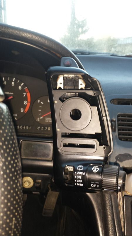

                          also gutted my now barren wiper switch...I need to fill the space at a later time
                          so it was time to test fit the dash to shape the harness
                          it fit as it should, so i continued on to clean up the harness and tape it up well with 3M Supper88

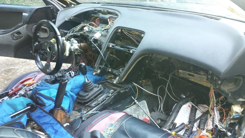

                          tested everything one more time once it was all ready for the dash
                          a veiw of the new void
                          dash on

                          Also got my next bit of work in the mail decided to go back in and replace the mains as well.

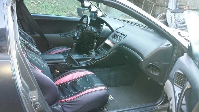

                              i had the interior back together but forgot to upload the pics

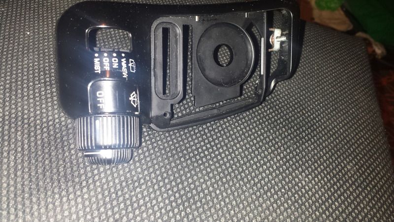

                              also had to modify this pod due to it missing all the mounting tabs now you pull the switch outward to activate flashers.

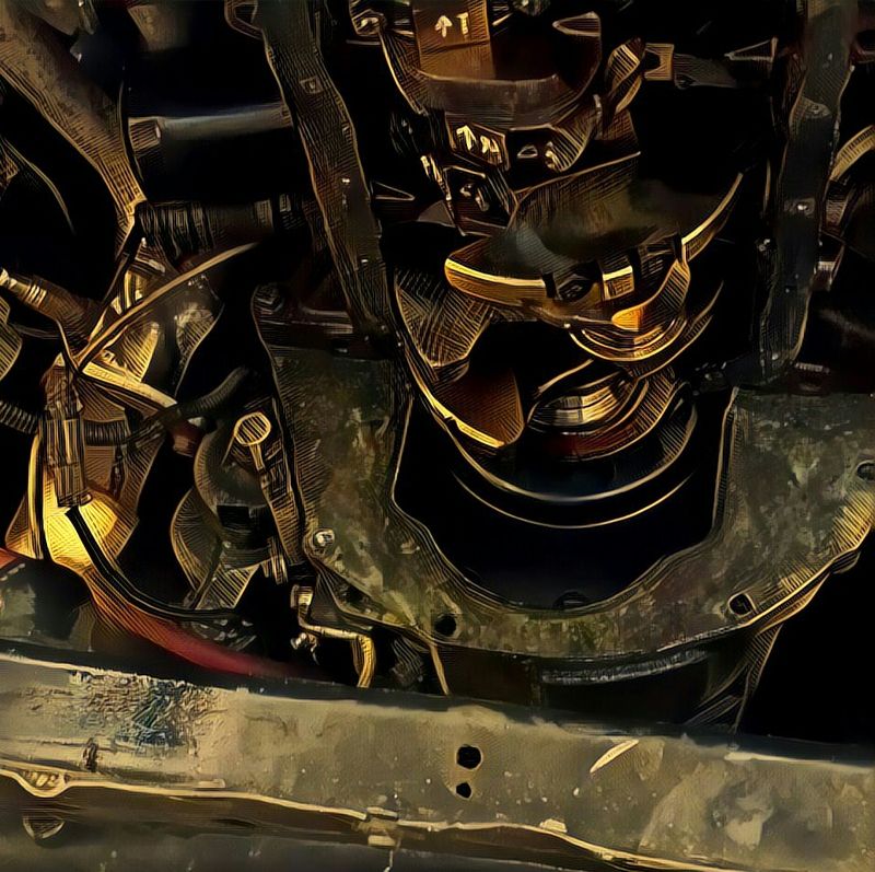

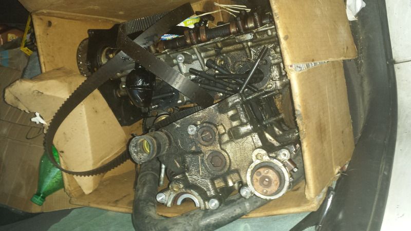

                              i lost alot of motivation when doing the tear down once i found my cranks thrust suface looked like this bearing.
                              but then i got this twin turbo engine in peices ready for me to revive
