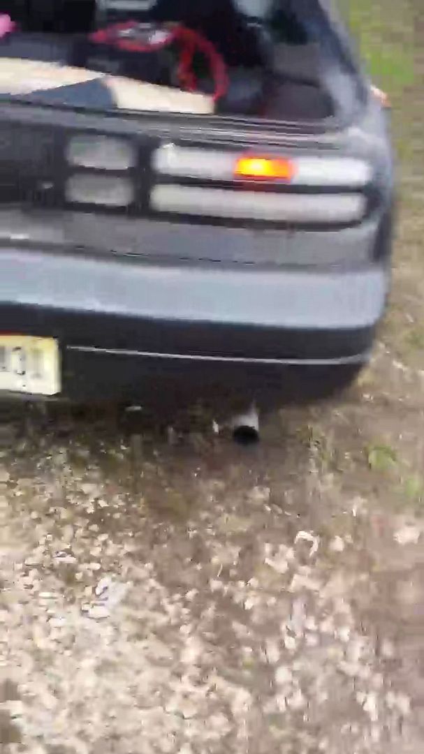

                      Continuing onward, as stated in the last post, the pin that syncs the cam pulley to the cam had sheared off and would occasionally catch and move the cam as well....
                      it sounded like this
                      got a few new things : Megan STS, Gates belt (since i was there again), and early style tt heads.

                            and then it ran again....

                              You gotta work on your photos man. Way too big, a lot I can't see what you're going for and little explanation doesn't help either.
                              You replaced the #6 runner without grinding down the welds after? Doesn't that defeat the purpose?
                              • #30
                                I apologize for the awful photos as I really have no idea what I'm doing with a camera. They are also taken on a galaxy s4. I am very new at build threads so any pointers are appreciated. These pictures were taken mainly for my reference, but I took so many I figured I would share them for anyone else going down this road as well. Posting these pictures has also given me insight on things I have overlooked while working on this car.
                                I replaced the #6 runner to even out air flow and give the runner the same square port shape. I did not do it for cosmetic reasons alone. I will be taking it off again and further modifying it in the future. I did leave the inside welds alone to attempt to even the up airflow as the other side of the intake does not run straight into the runner. The car is currently apart again so I will be trying to flow match the runners very soon.
                                The current goal is to budget build a 300zx, make it easier to work on, and to make the engine bay more appealing. Im currently under $3k including the purchase price of the car. My target power is 250whp NA. If I fail to hit that number, I will turbo the car and it will no longer be a budget build.
