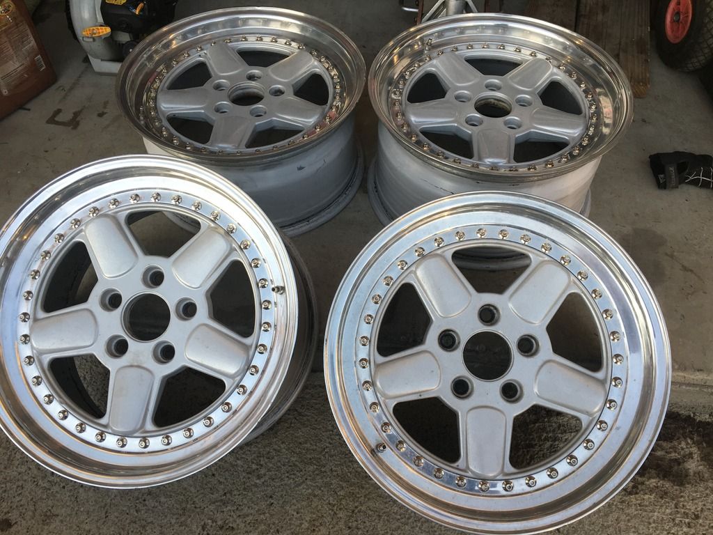

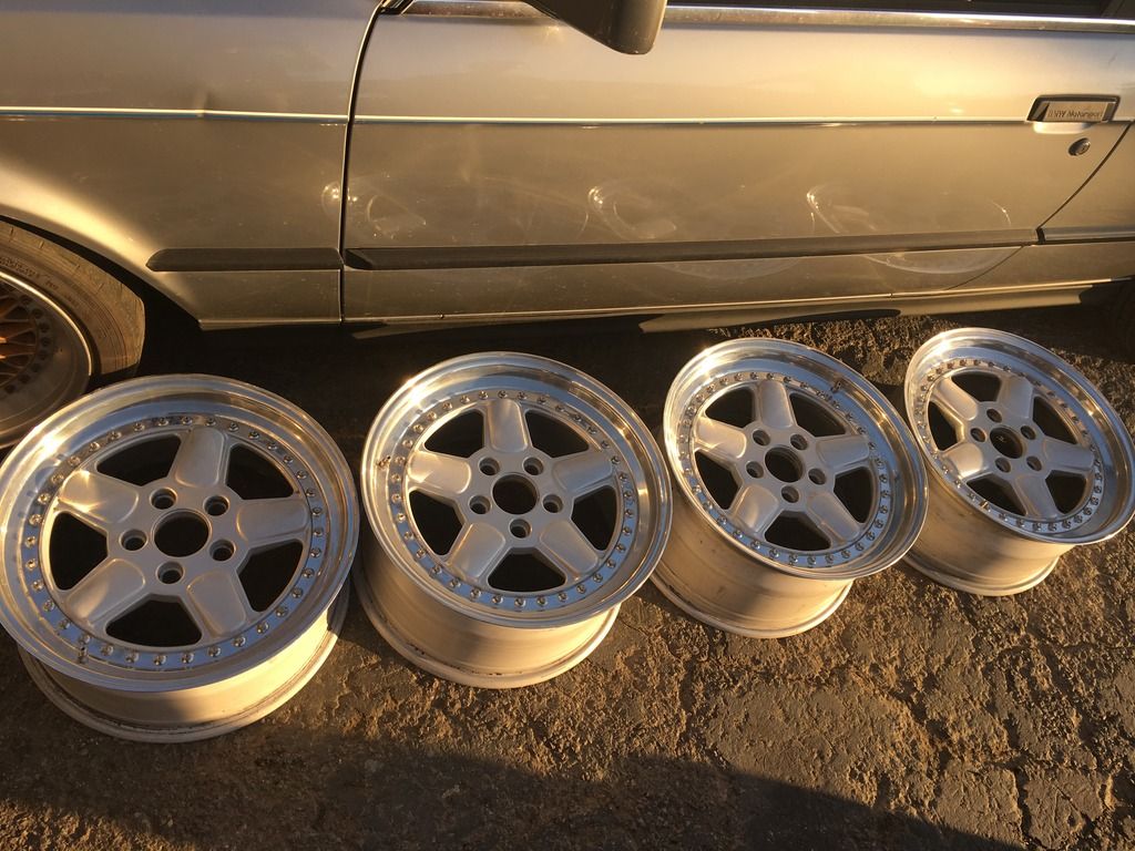

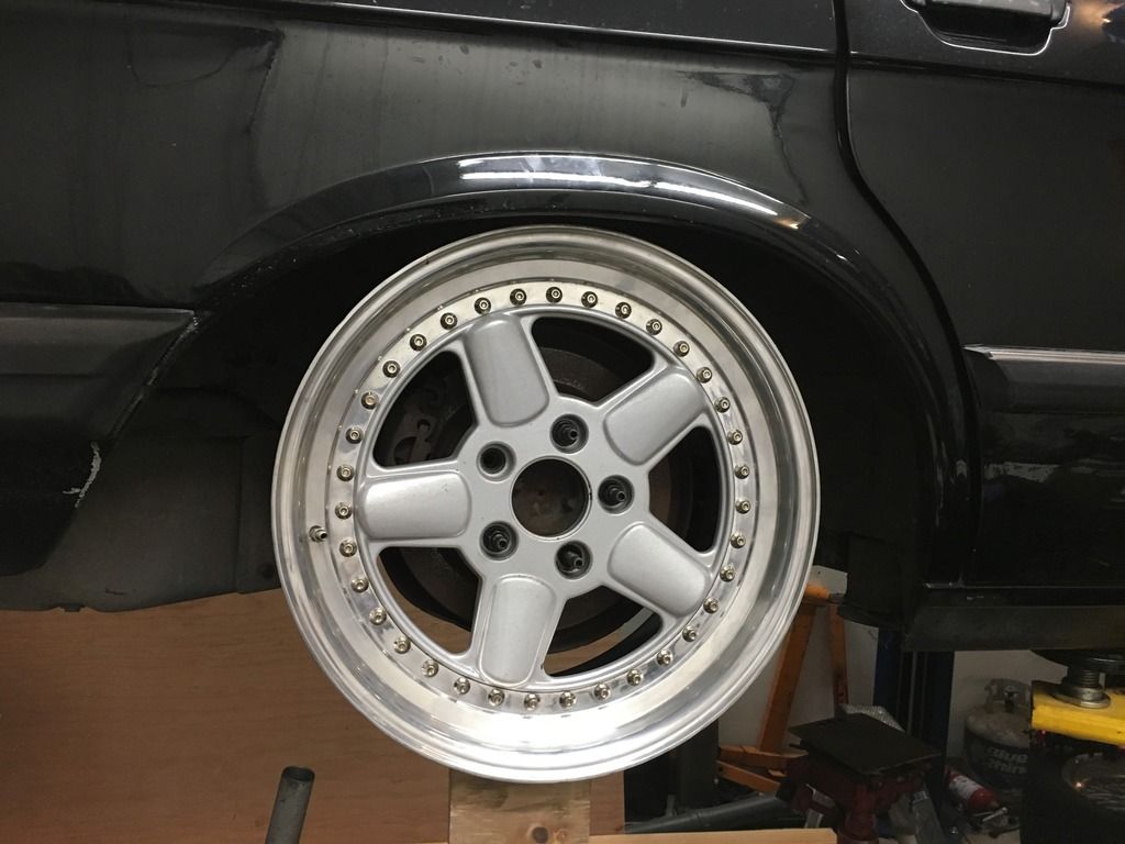

    my AC Schnitzer type 1's came in the mail today. They are 17x8/9 et33 and 45. so they have 1.5" lips front and rear. I will have to run probably 13mm spacers and i will be getting either 2.5 or 3" lips for them.

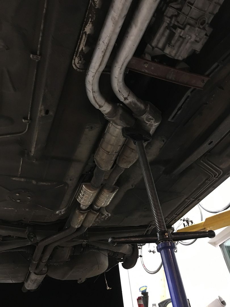

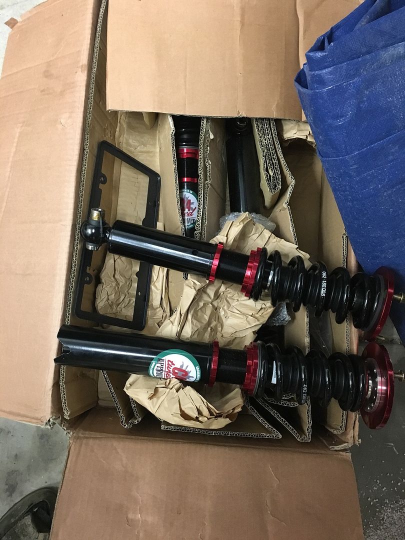

          my dad has been working on the exhaust for me and he finished it tonight but tomorrow we have to get exhaust gaskets for the headers. i also got my coilovers but i need to adjust the height for sure. i am super busy this week and i will probably get it all done next week
          my exhaust is the following:
          replica turner motorsport shorty headers
          1995 m3 cats/mid pipe
          and a Billy Boat tri flow catback

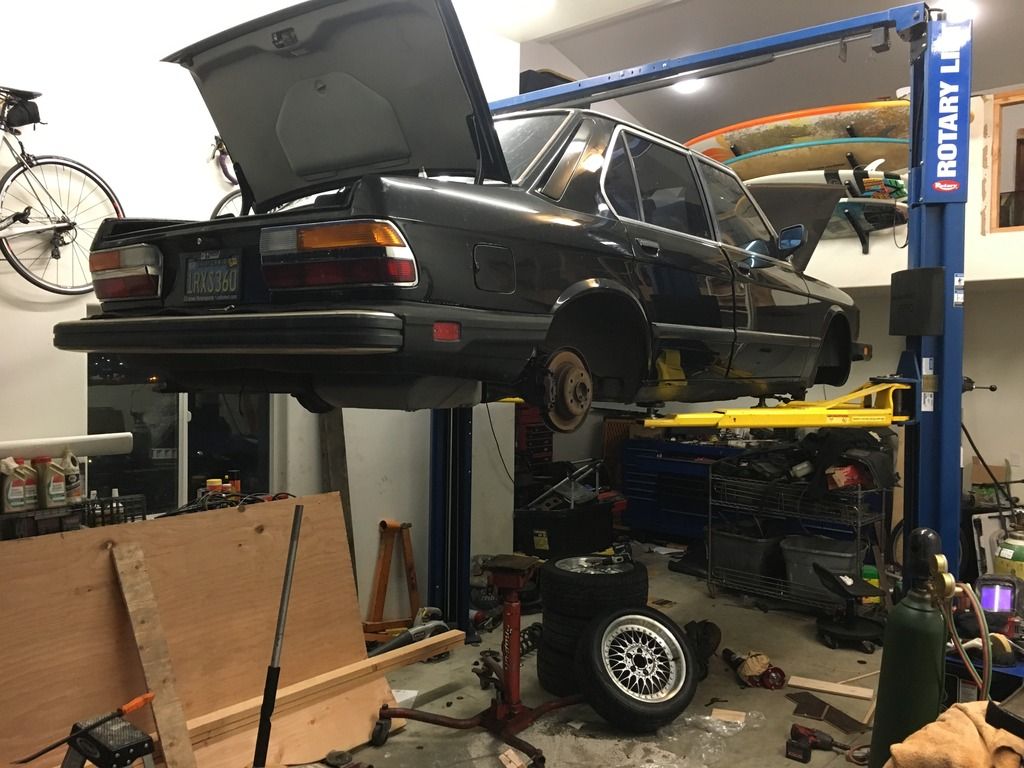

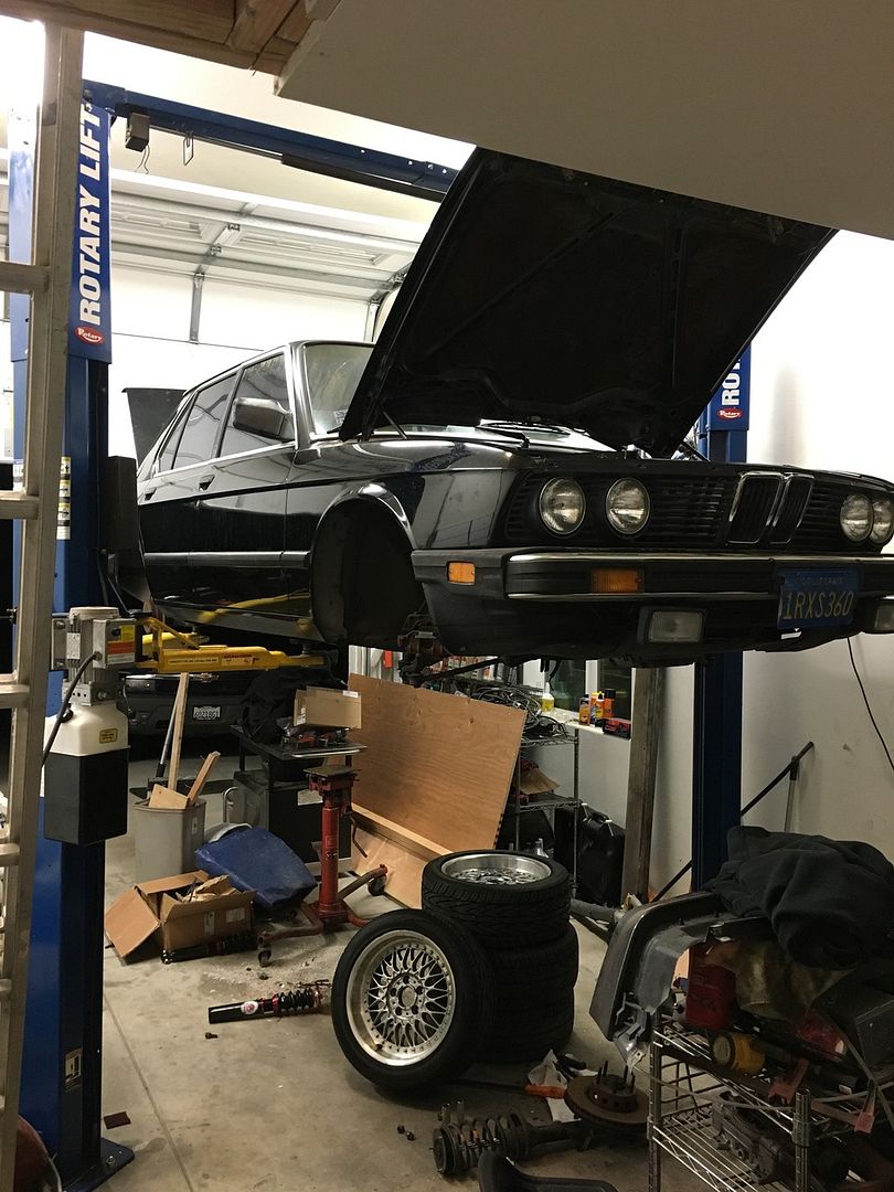

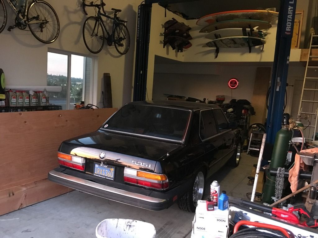

                i realized i didn't update prior to finishing the exhaust.

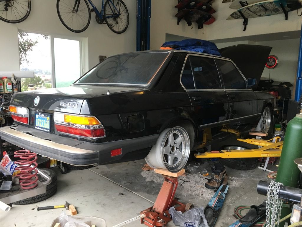

                i spray the car off and brought it to my dads because he has a lift so i was able to get my pedal assembly, coilers, ChaseBays stuff and all the rest of the car done.

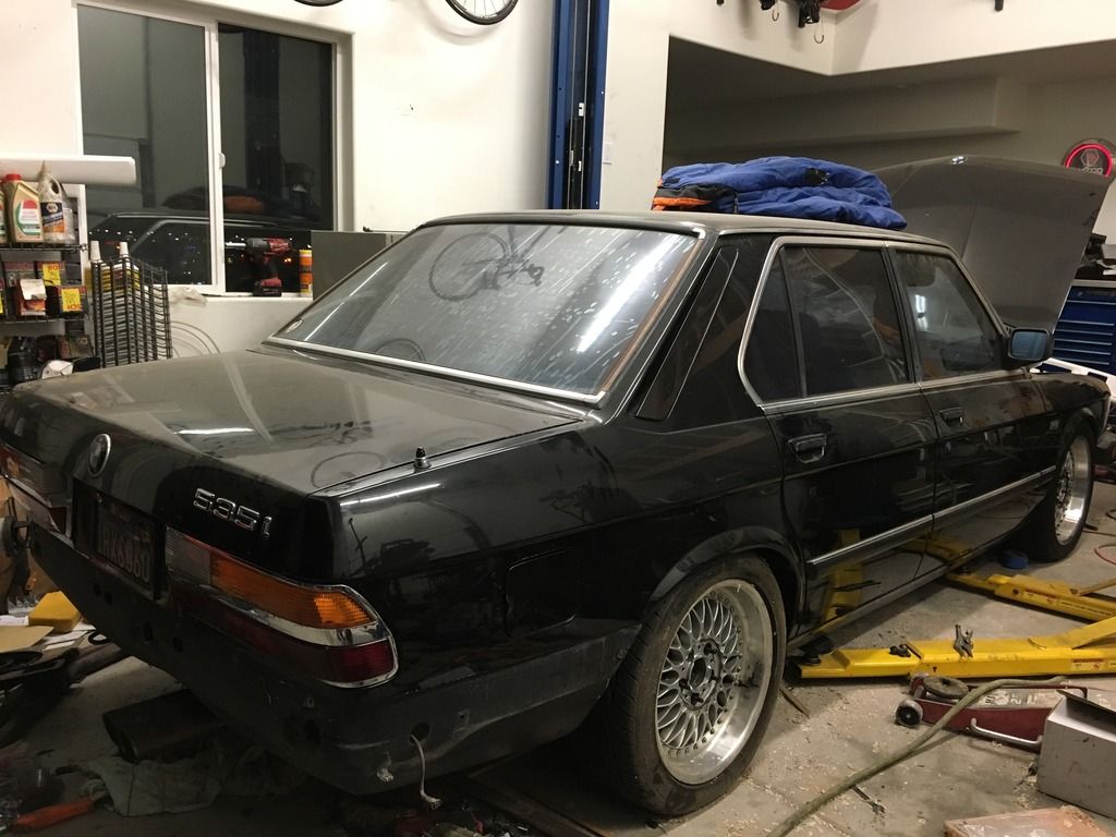

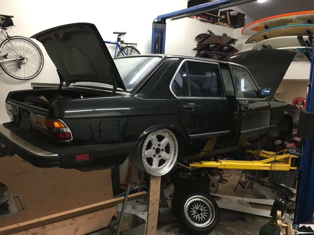

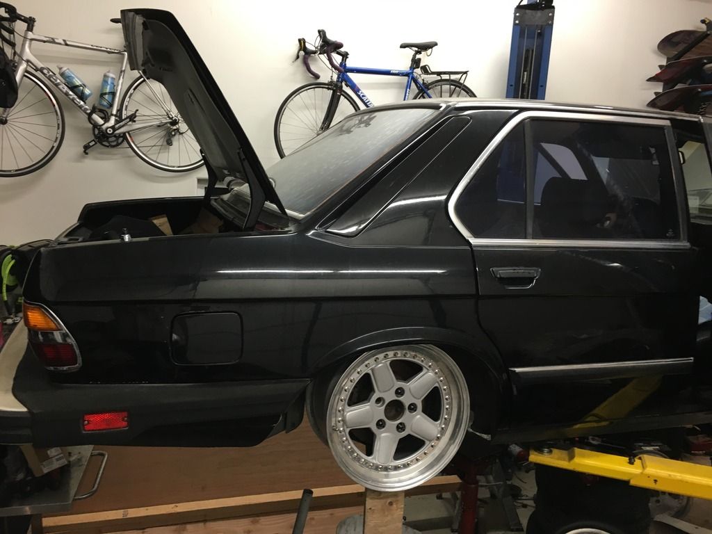

                  tried on my AC Schnitzers

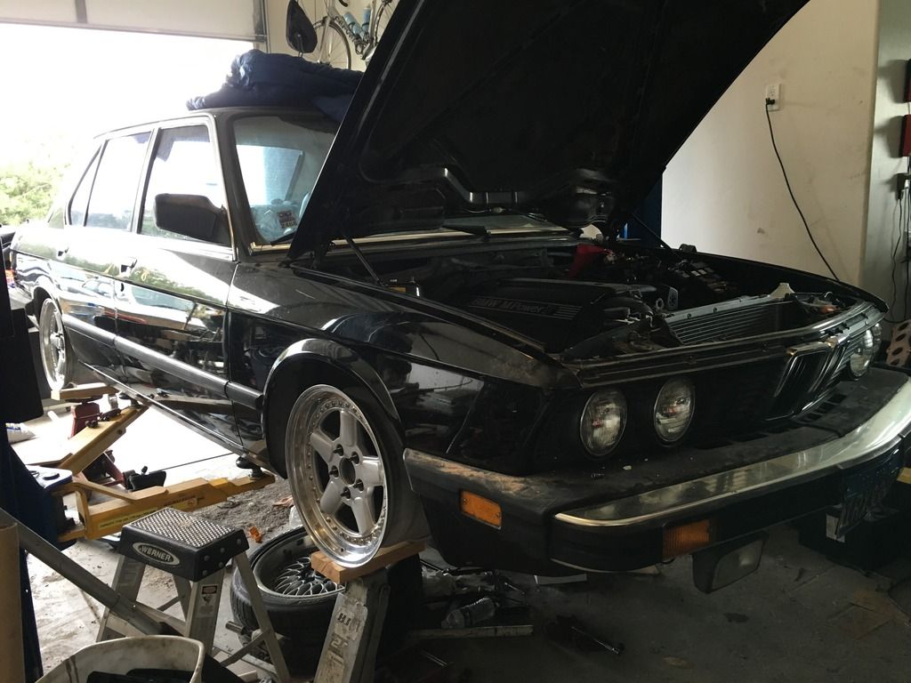

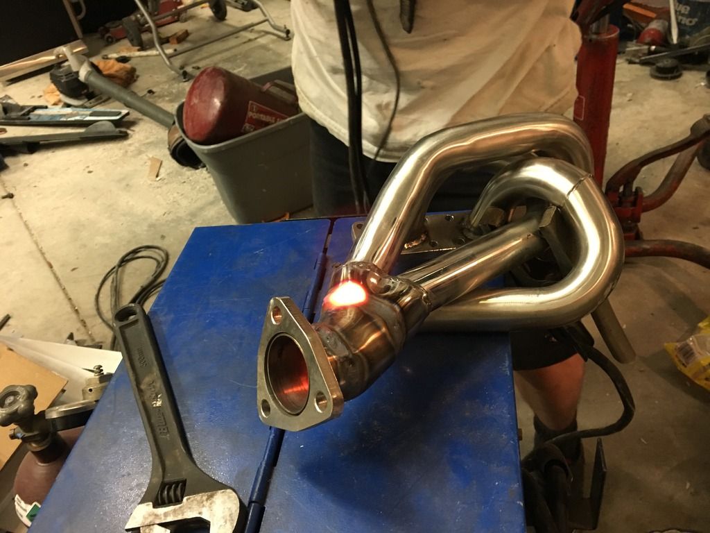

                    the headers weren't going to work to clear some of the e28 stuff so we had to make them fit

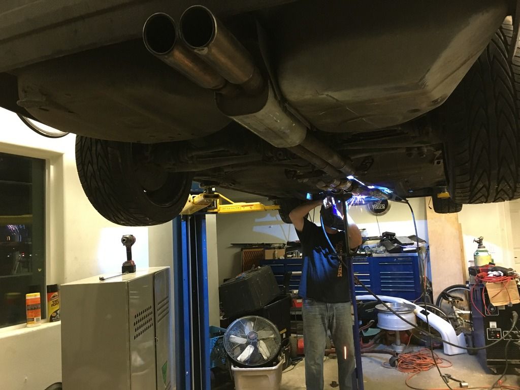

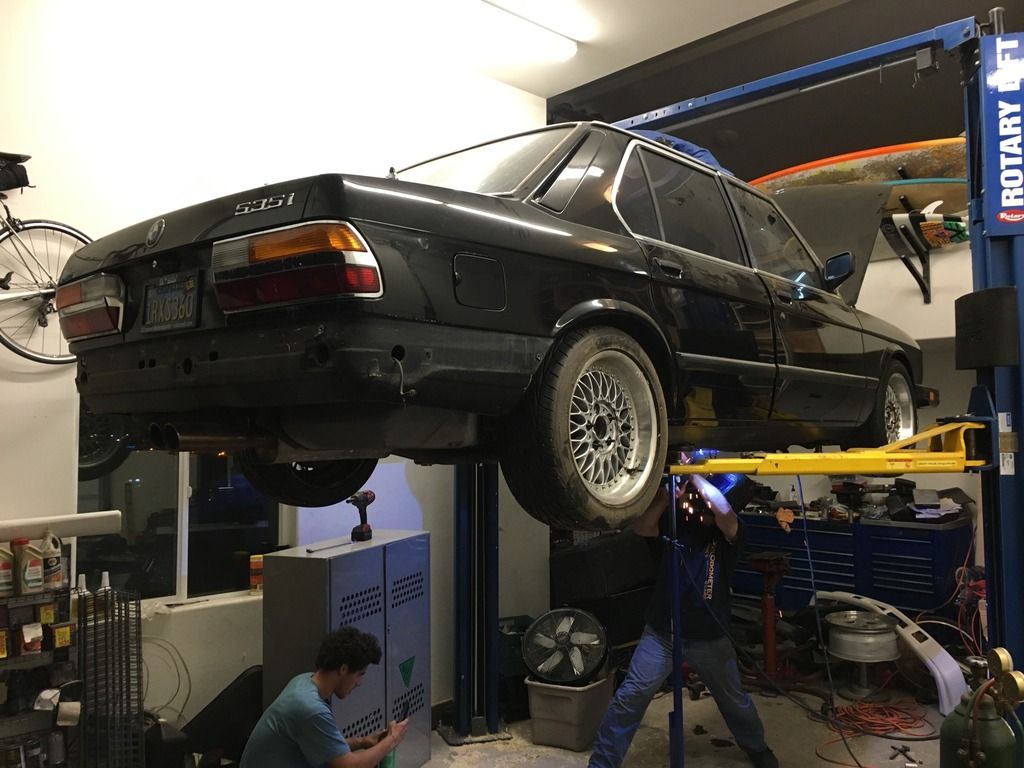

                              some exciting updates on my e28 this weekend. so i stayed the nights at my dads house on friday because i was helping him get a bunch of retaining wall bricks early in the morning so instead of getting some sleep for said activities or maybe finishing my online class that is do the next day i decided to stay up until 3 AM getting some stuff on the car sorted.

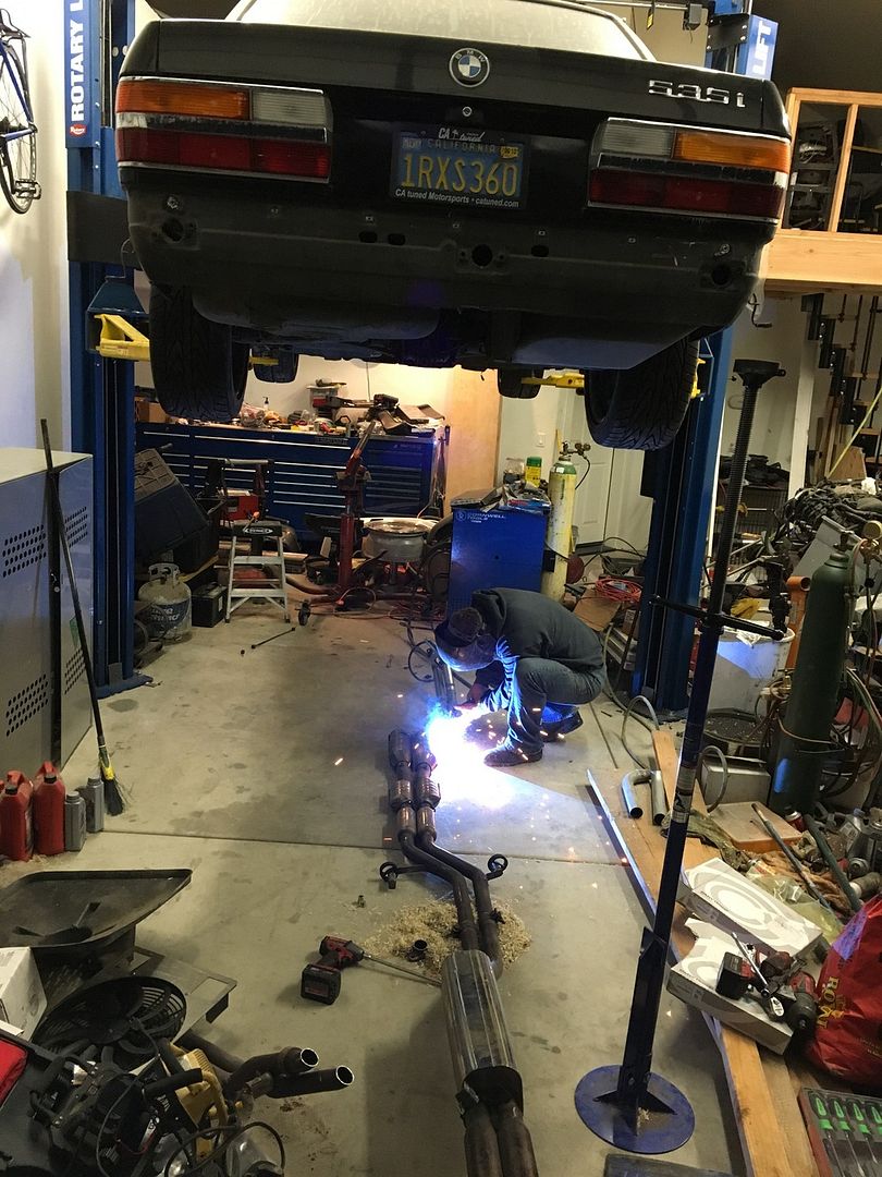

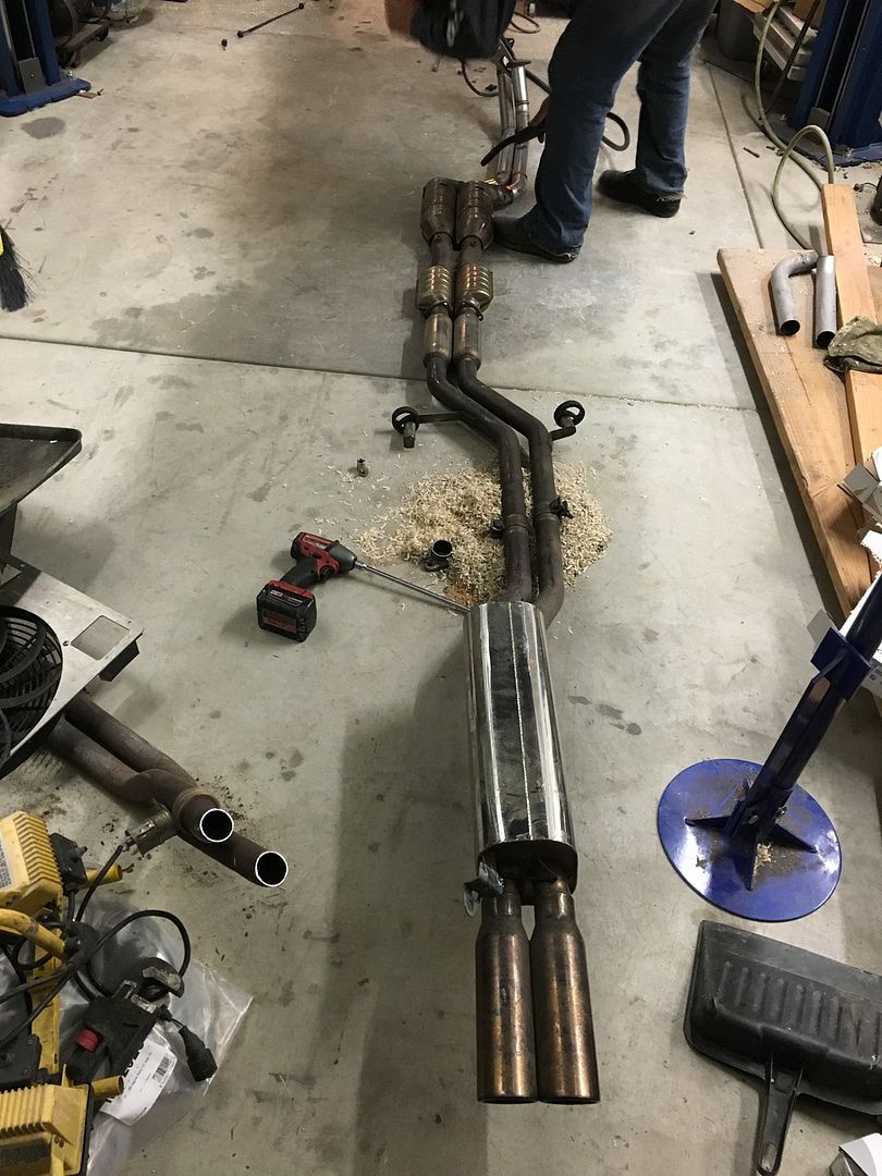

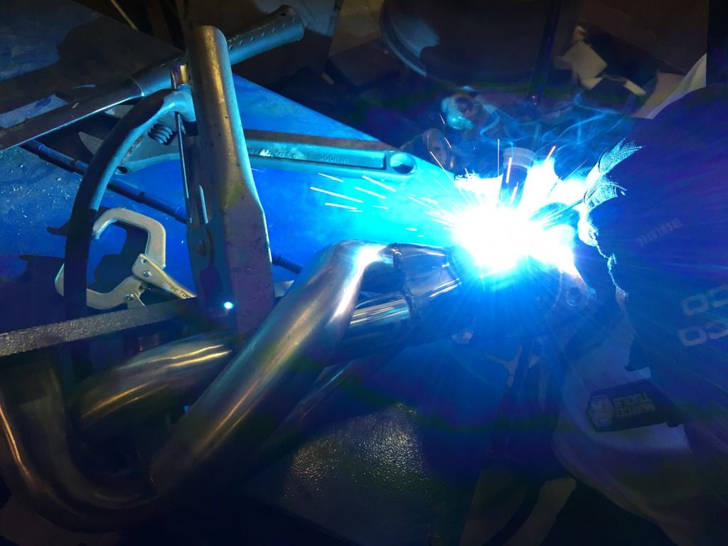

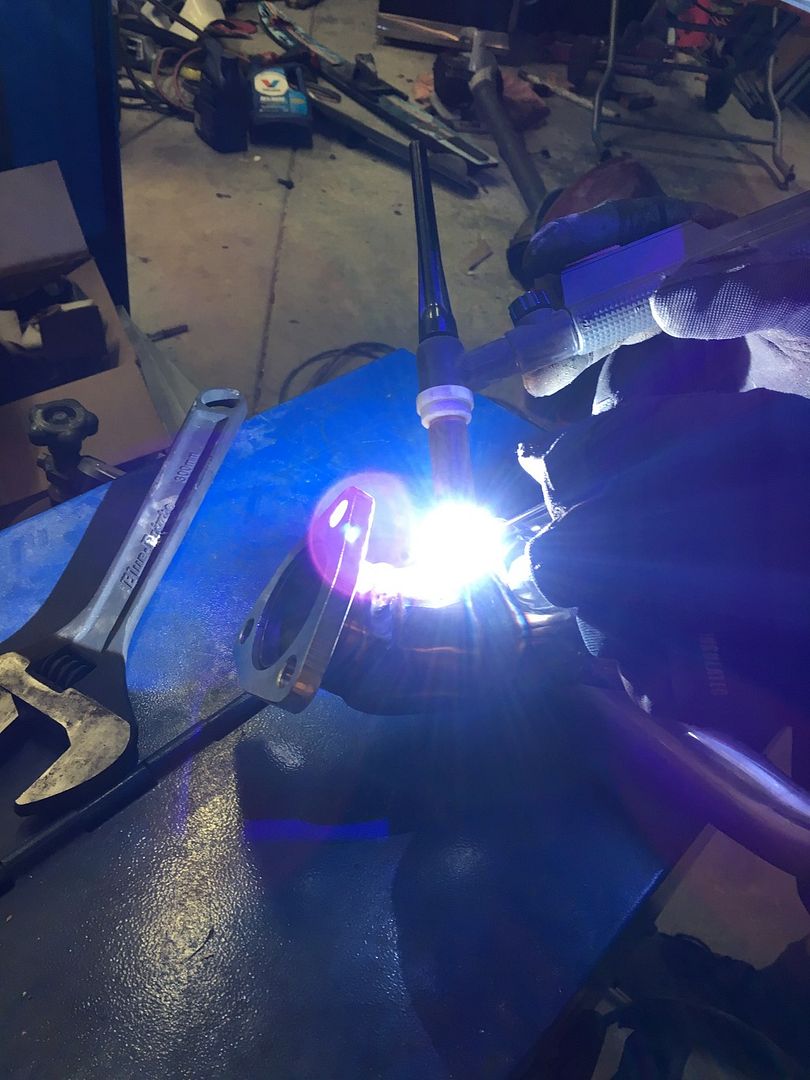

                              when testing the exhaust the other day we found a couple pin holes when it was tight to get the welder in so we dropped the exhaust and got those filled:

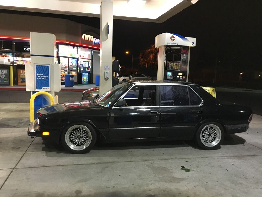

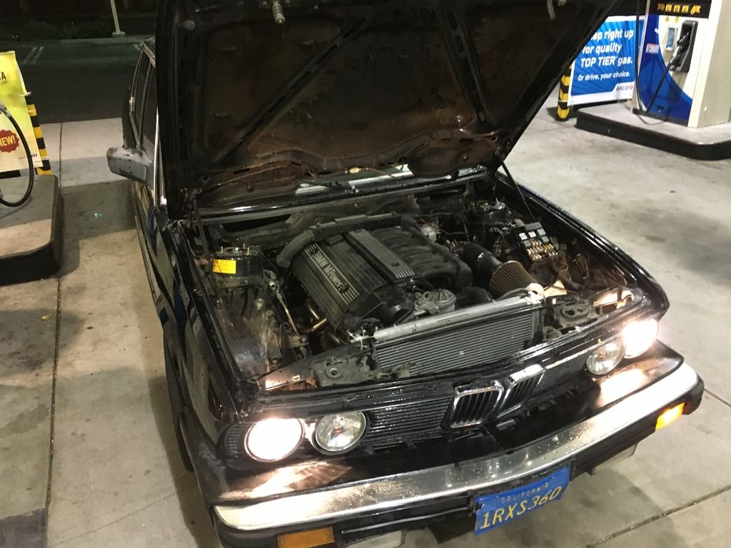

                                and then i took it on a quick first drive because there is a lot of finishing up to do:
