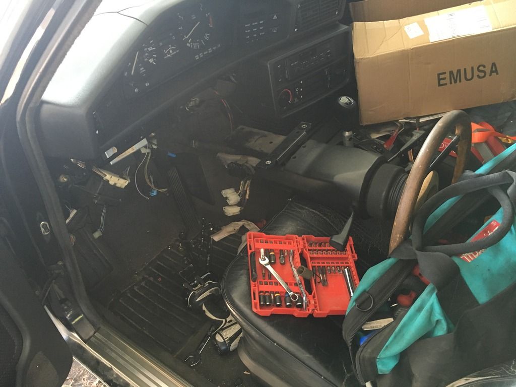

I started it tonight
E28 S50 build

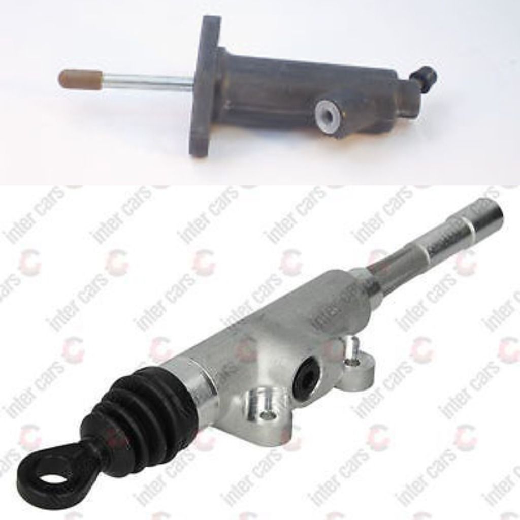

i don't really have any new pictures to post but i did order some parts so here are some stock images of what i got:
1: clutch feed adapter for my Chase Bays brake booster delete. so i can have a working clutch

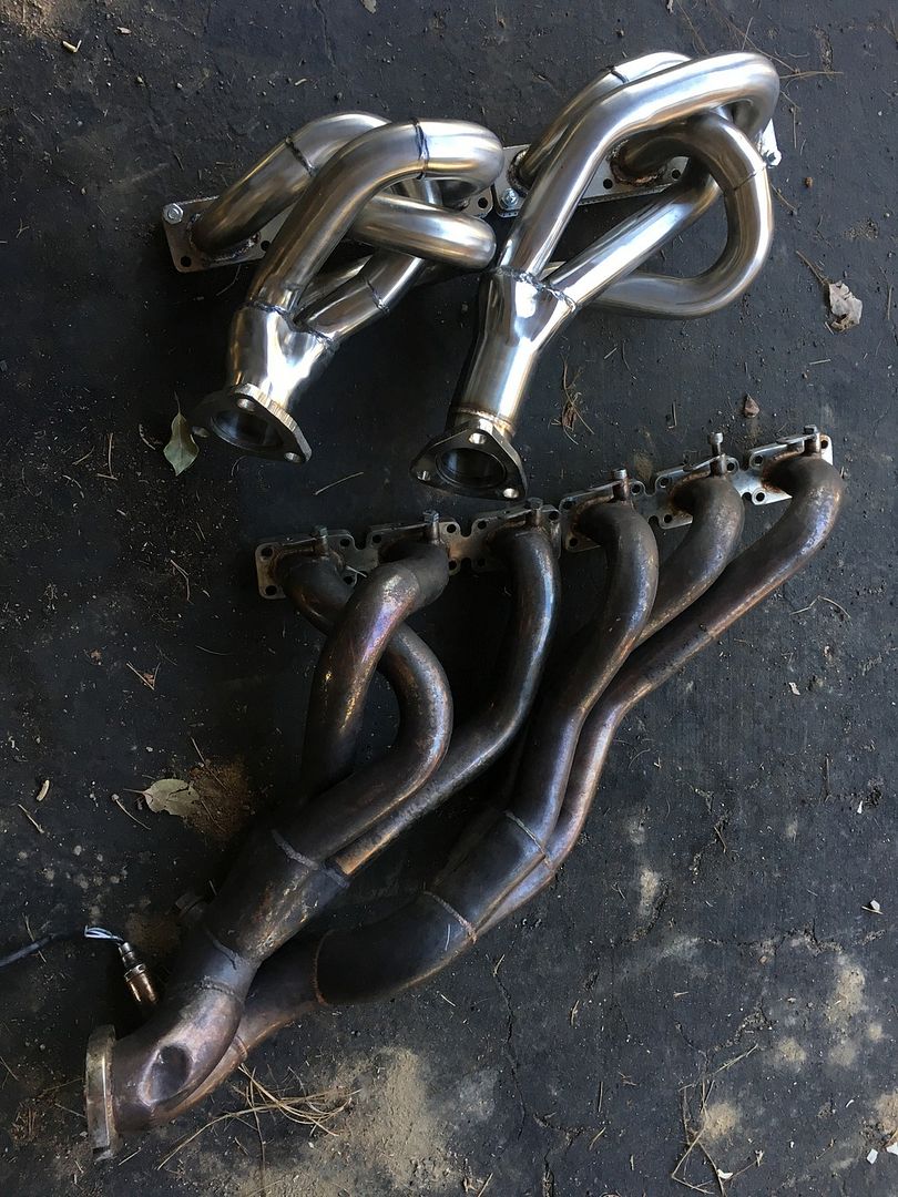

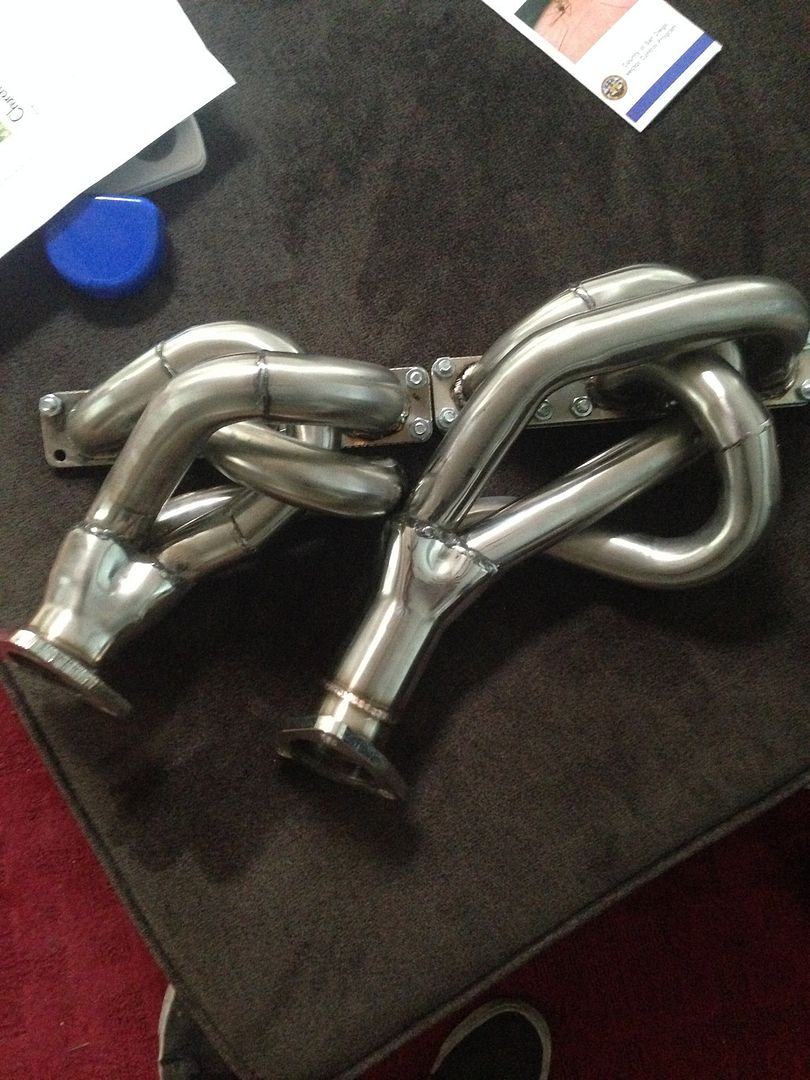

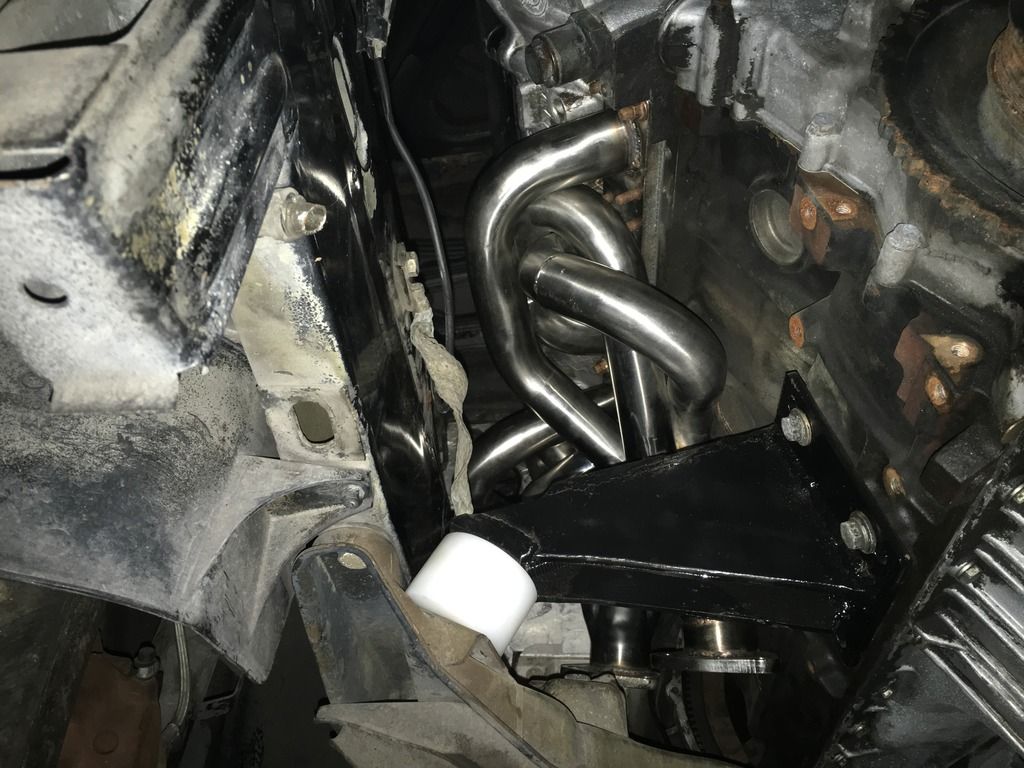

2: shorty headers because the long tube headers that i have will not fit. they hit my a piece of the steering system.so i can only turn left, which would be great and all but I'm not in nascar.
3. clutch slave and master cylinder because my master is blown out because like al e28/e24s my clutch bracket is broken and blew it out and i figure since I'm at it ill put in a new slave cylinder too.
