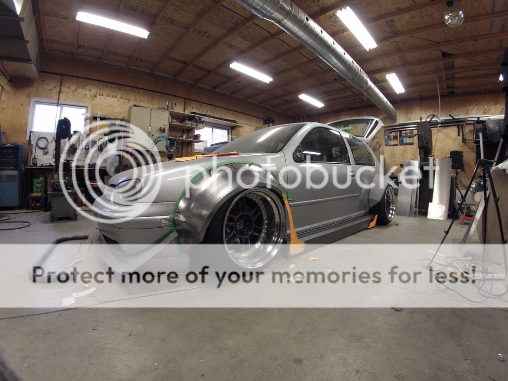

Progress report:
I basically completed the driver side fender tonight. I have it cleco'd to the car in it's final position so that when fully aired out the front fender to lip is the same as the rears. The front are flush to the lip like the rears, but more camber can be added to fix any issues. Currently no issues. No rubbing lock to lock and the tire tucks nicely when I air out. The transition piece took a while to make with several approaches finally choosing to make it out of 3 pieces instead on one complicated piece. I still have a wire edge on the outside for strength. It actually turned out better the back piece. I may chose to do the passenger side rear transition from 3 pieces.
