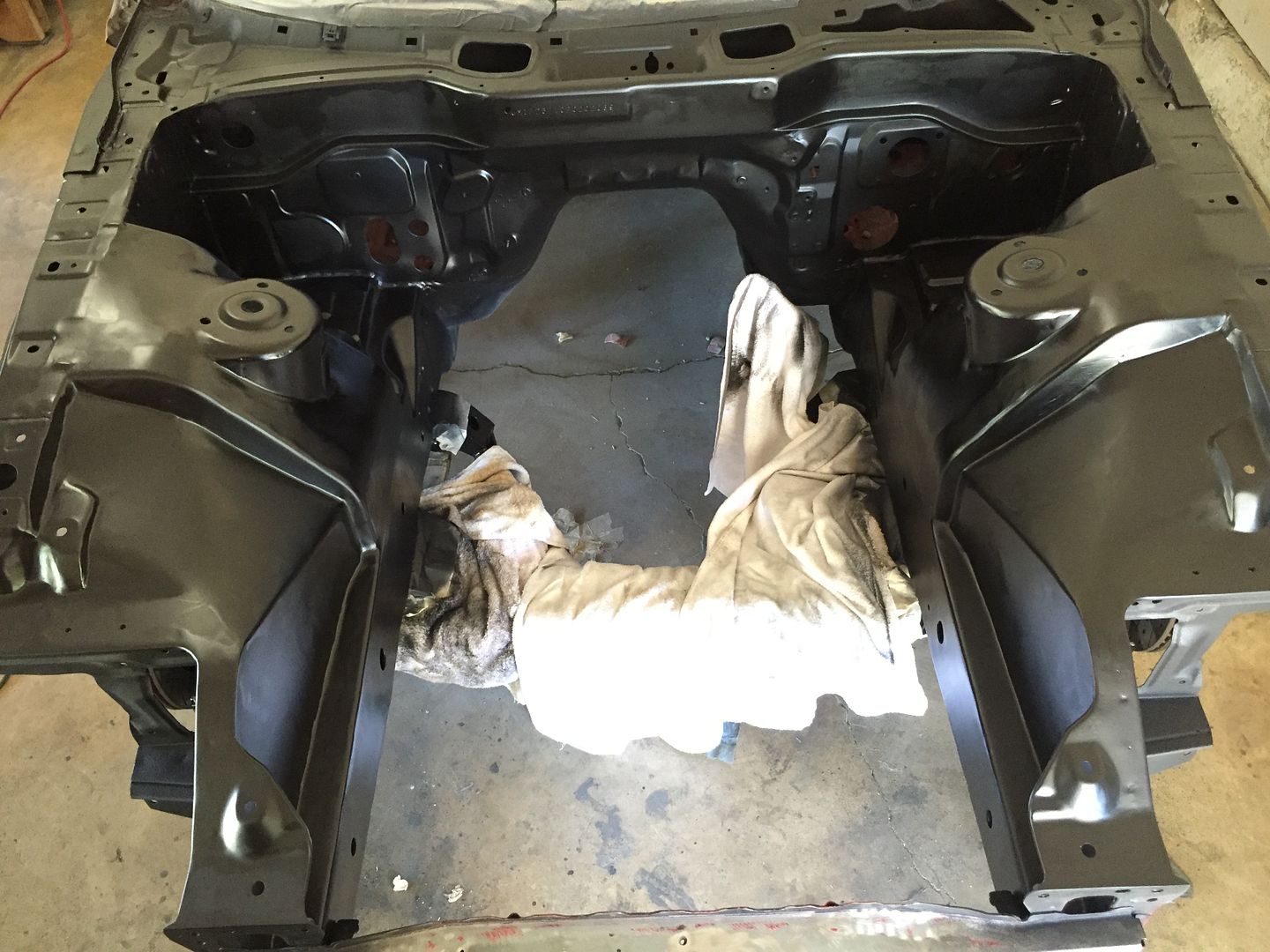

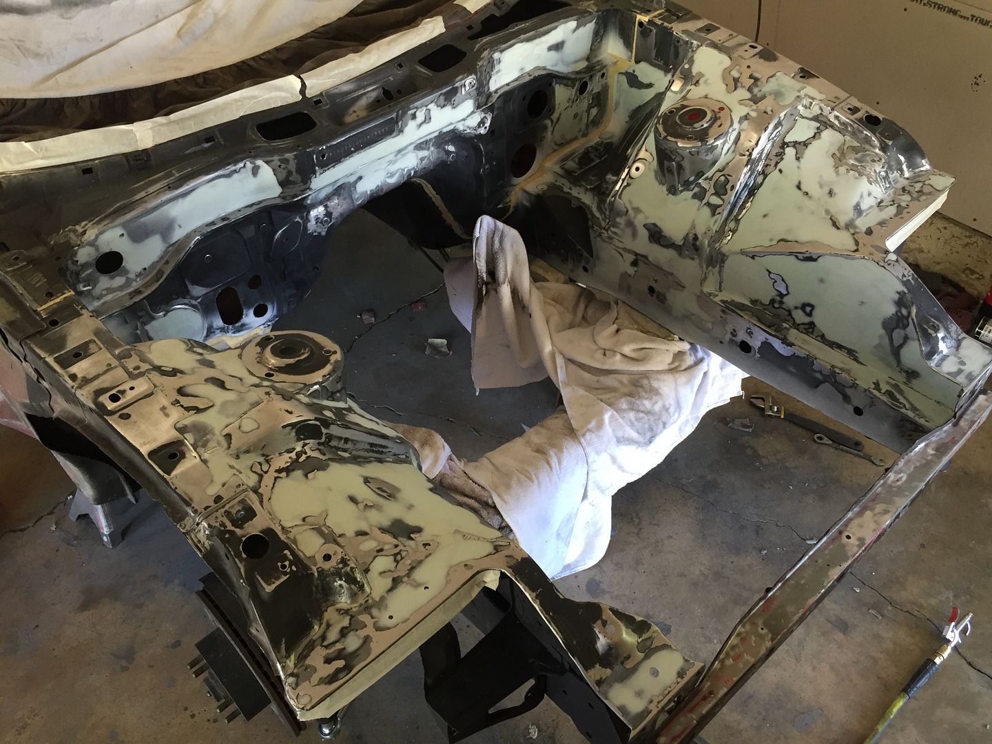

So I went ahead and laid down another two coats of epoxy since there were quite a few bare metal spots showing. After this I'll lay down some thin filler to smooth it out as much as I can and then I'll spray one final coat of epoxy primer and then two coats of high build. And theeeennn the end will be in sight lol.
Two coats down

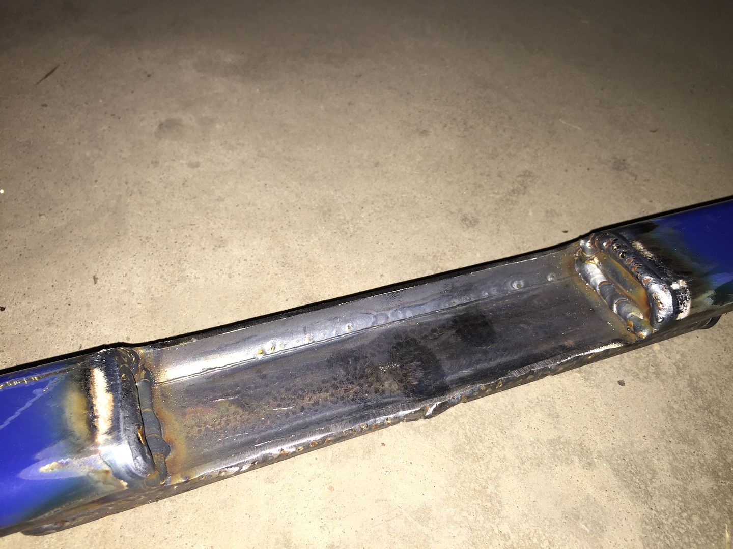

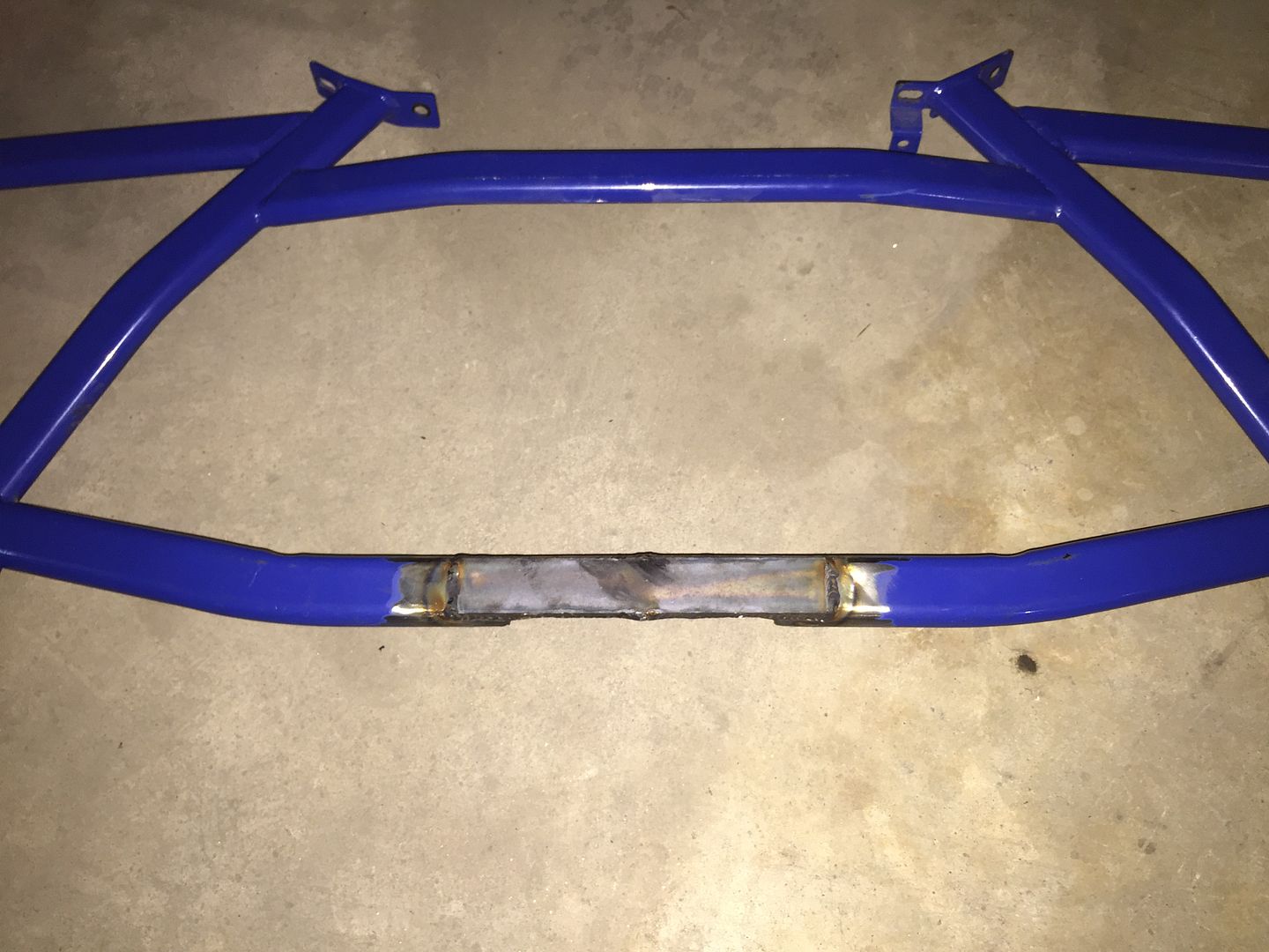

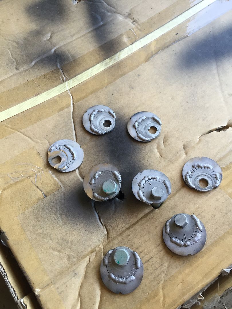

Another thing I tackled over the weekend (with the help of a friend) was to weld a few things up. I only have the crappy flux core welded so I took the strut bar and camber bolts over to his shop to weld them up. Made a plate to go over the part I cut out to fit the FAST intake, so it is pretty stout now (again).
I'm going to sand it all down and smooth it out and then send it out to be sandblasted
Also welded the camber bolts as mentioned above. I went ahead and welded these myself using his machine. I didn't see the need to do a full bead all the way around...and also the welds look like poop. I'm still learning, but they are solid at least

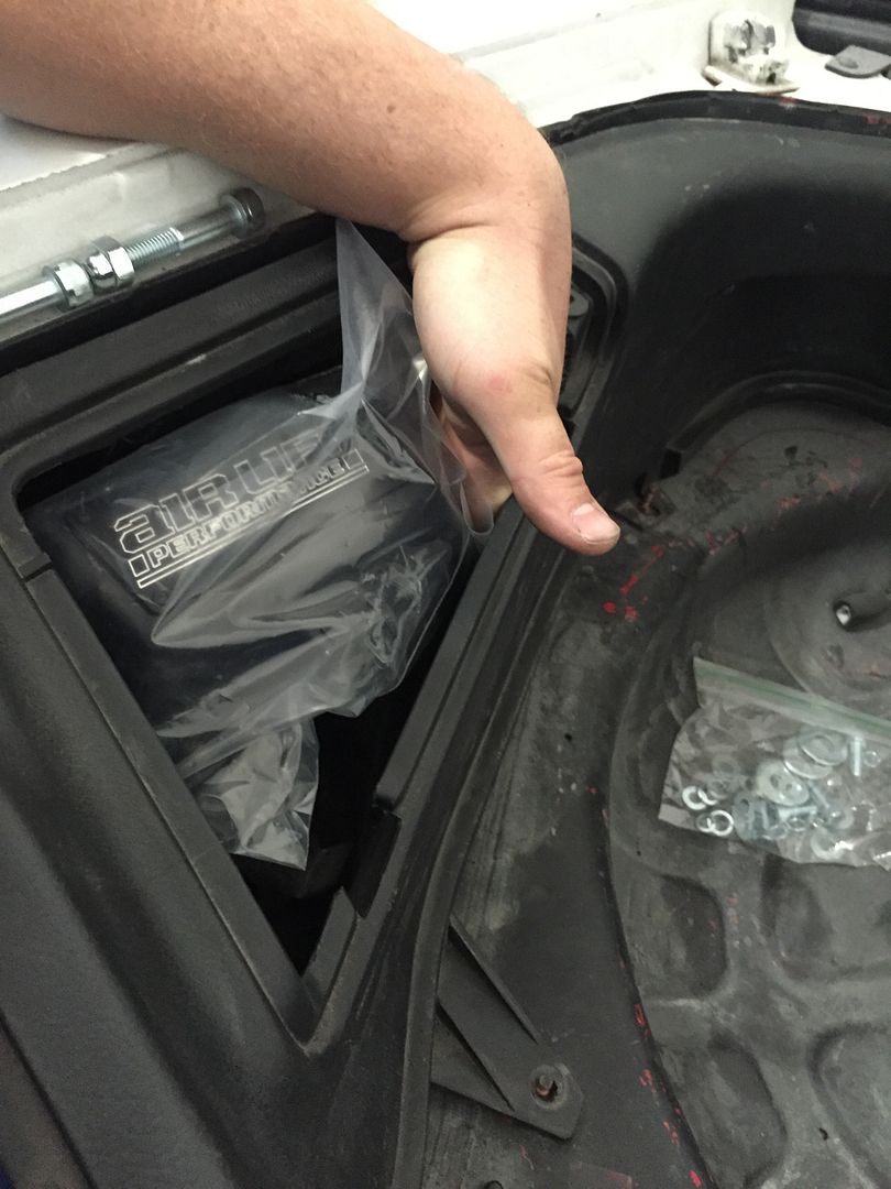

Oh, and lastly. I've been doing mockup of where I want to mount all of my air components and think I have locations for everything. The manifold will be mounted right behind the passenger strut tower in the rear. Should fit perfectly after I make a bracket
