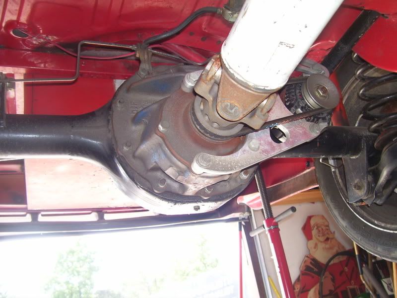

                  Your alternator issue could also be solved by relocating it under the car, and running it off of the driveshaft. There's quite a few types of racecars that do this, and there's even kits for certain street cars.
                  • #54
                    this is looking great man. keep it up
                    instagram: @keenanhaye
                    • #55
                      that's a good idea I would never have thought of that? its good to have options! thanks

                        at idle the alternator wouldn't do anything though?
                        • #57
                          That's true. However, depending on the type of car/alternator you have, it doesn't do anything at idle anyway. I know the popular GM 1-wire alternators do not charge at idle, and actually don't start charging until somewhere north of 1,200 RPM. If you have an old car that uses a generator, those don't charge at idle either.
                          It really depends on your application. You can run a heavier-duty battery with the driveshaft-driven alternator, and never experience a problem. I know guys with Fox-Body Mustangs, hot rods, and trucks that run this setup with zero issues.
                          Now, if you plan on running high-amp lighting, sound system, and a bunch of other accessories, then this setup may not be the best.
