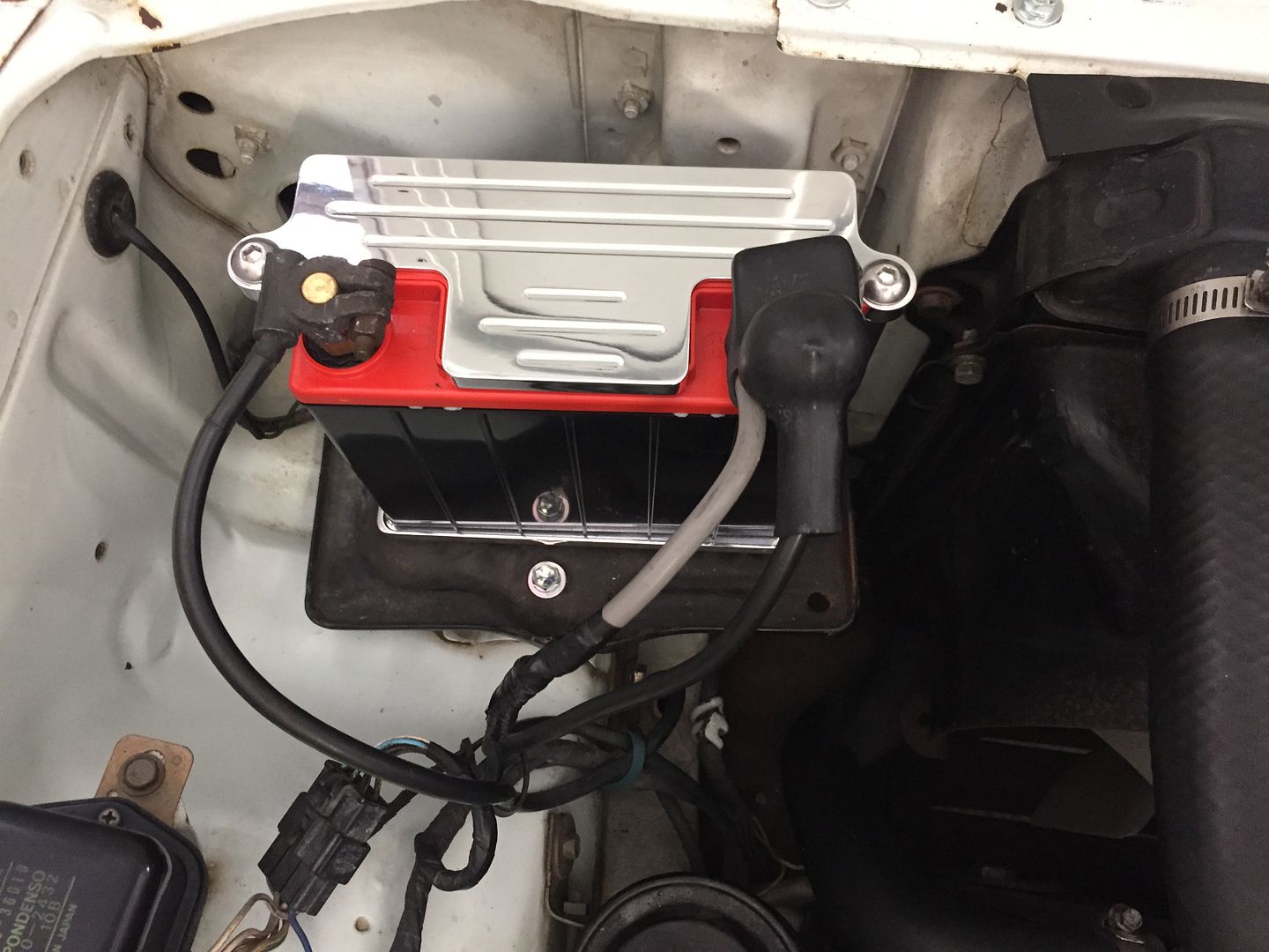

        I did do a few things last week. First the OEM battery was shot. Wouldnt hold a charge. Since it has JIS terminals i wanted to keep it that way. After some research i found that Odyssey offers JIS terminal for its batteries so i adapted a PC680 to the stock tray and hooked it all up.

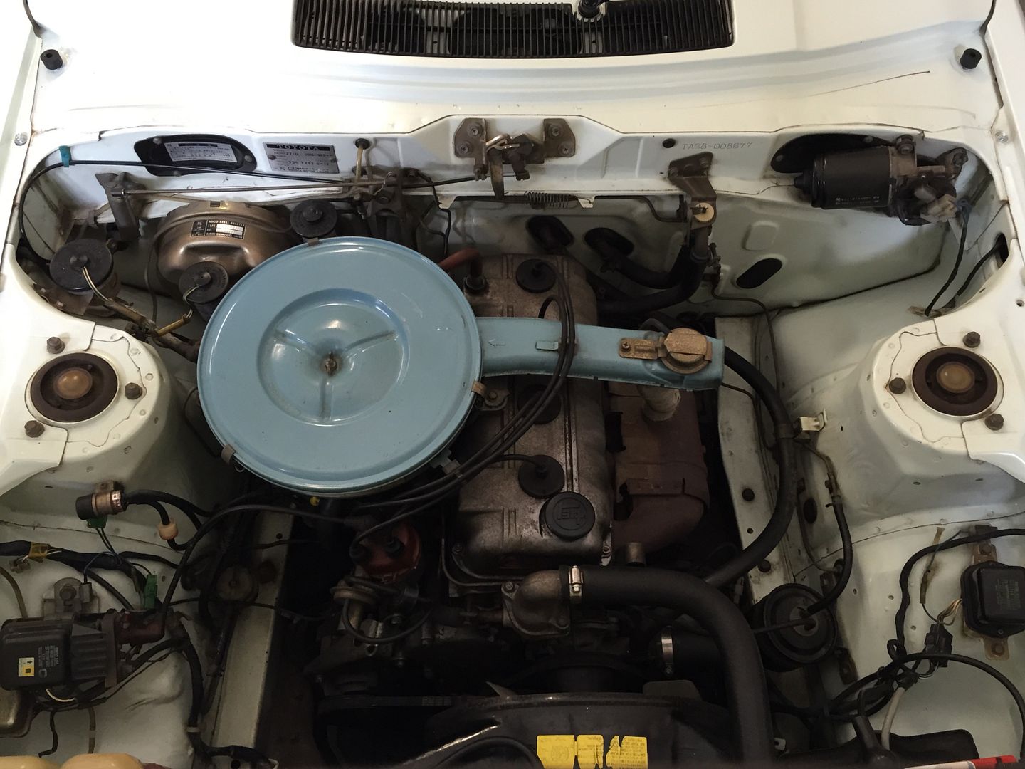

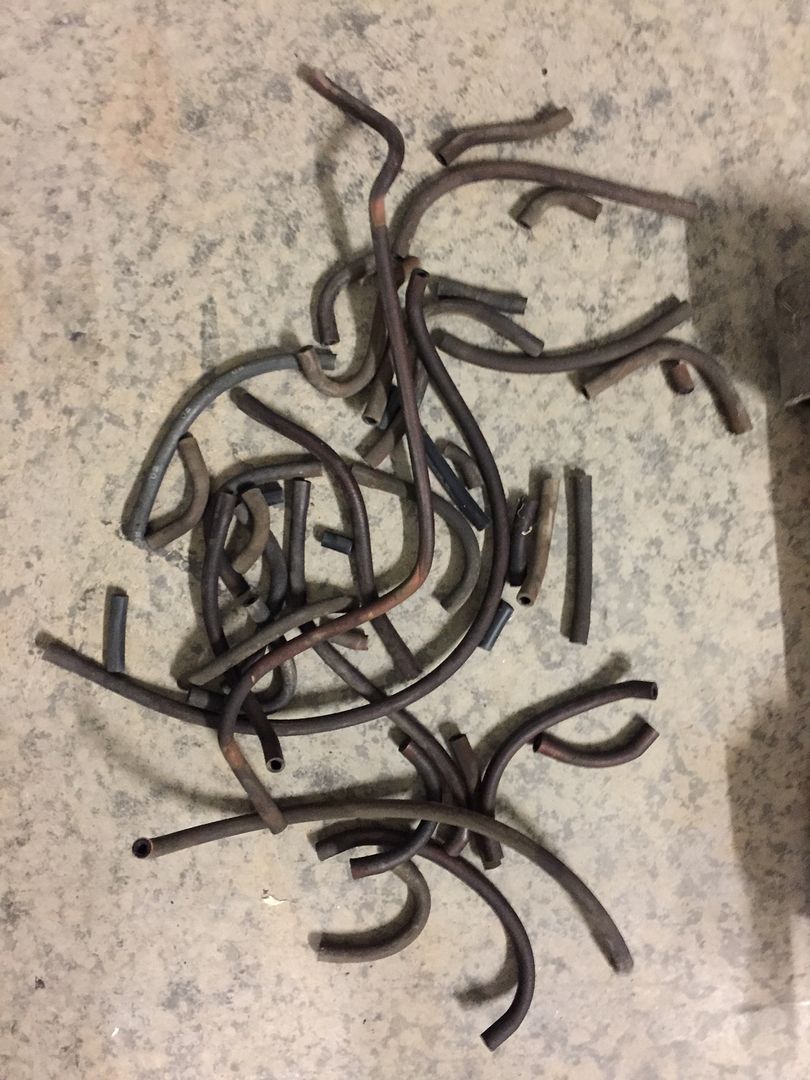

        Next i replaced all the 40 year old dry rotted rubber hood rests, hardware, and vacuum hoses in the engine bay.

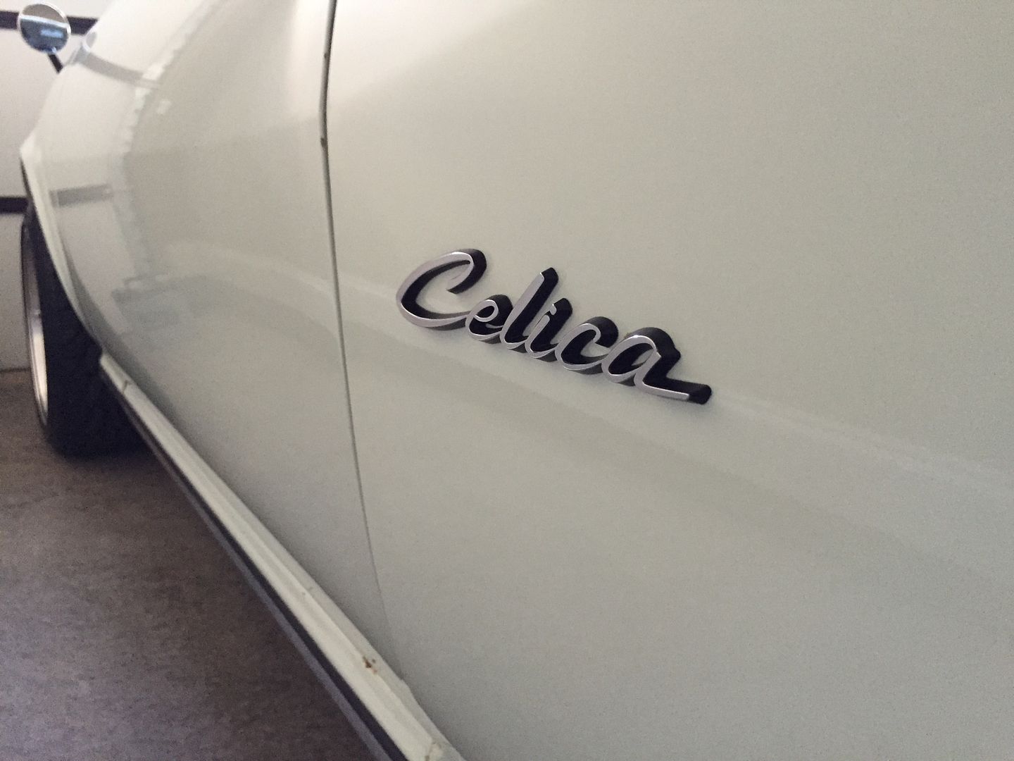

        I also took the time to add the early Celica script badges. I like them better than the later block style.

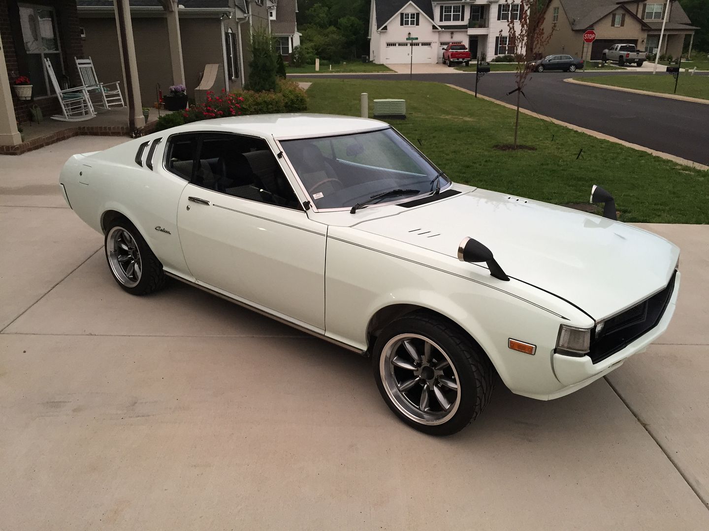

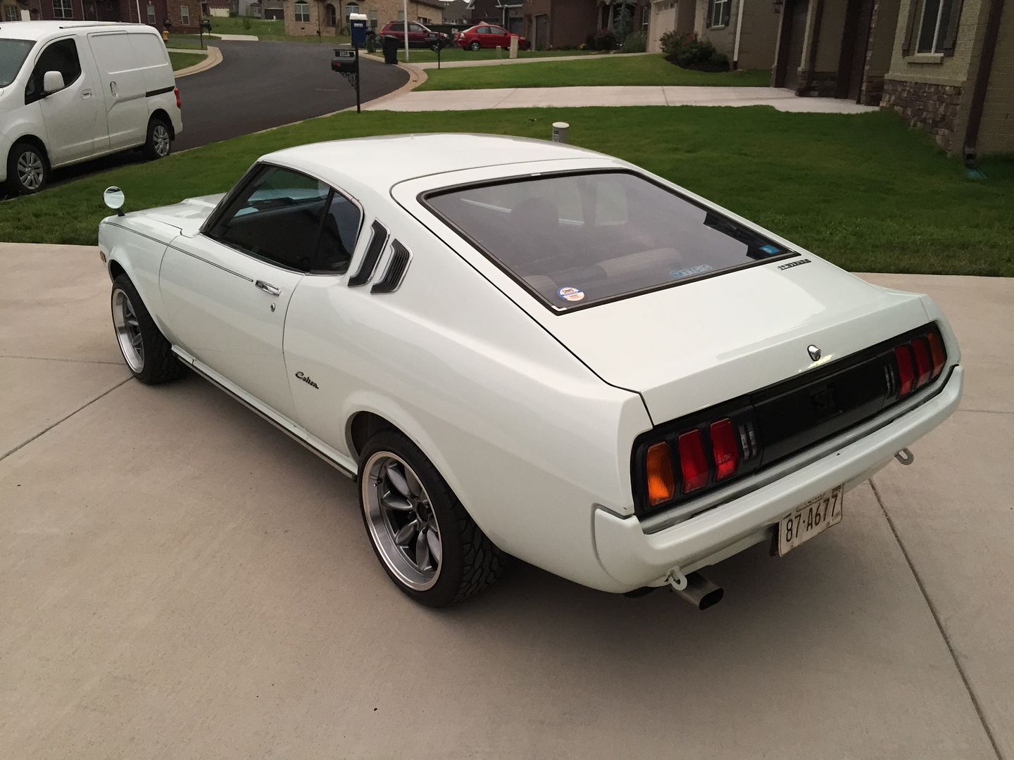

        Pulled it out of the garage and got a few better exterior pics

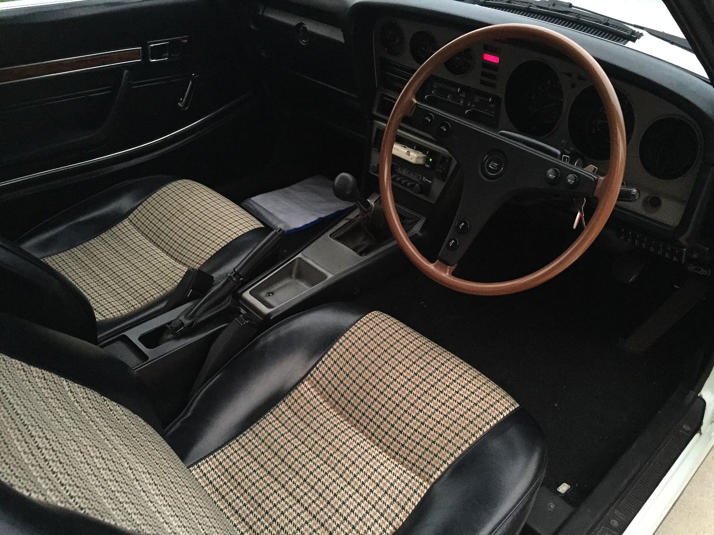

          Just so clean...strange wheel, why are there six horn buttons?
            Thanks. I think it was Toyota's way of ensuring you make a turn with two hands. One handed turns I always end up hitting a button. lol
            I will be getting a Nardi soon

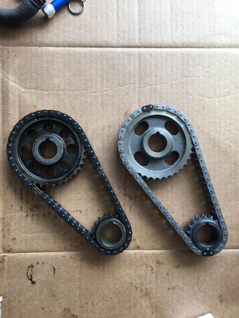

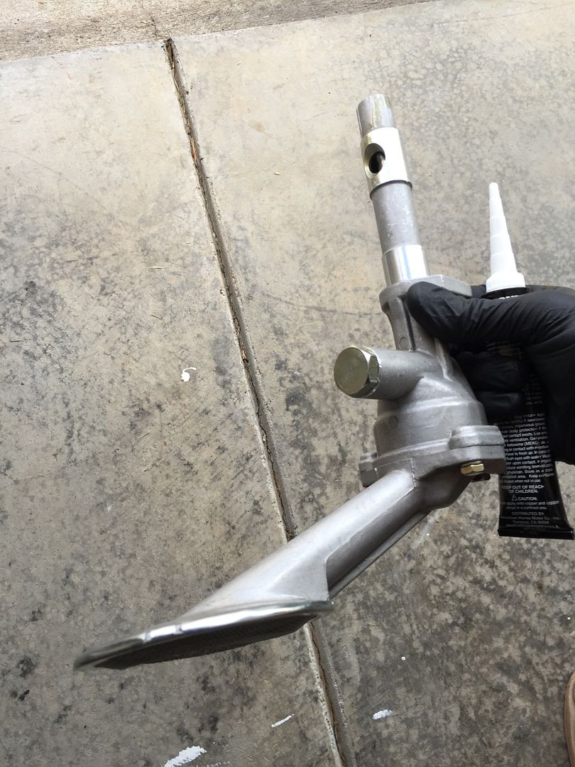

                      Did some maintenance on the newly rebuilt motor this week. Things they did not change to new. Preventative maintenance for the future pretty much. New water pump, oil pump, timing gears, timing chain, tensioner, full gasket set from top to bottom.
                      Was hoping the cam was off a tooth on the timing chain but was not. Would explain me having to run about 25° of negative timing. Finally found out the cam was replaced during the rebuild and was not degreed. Adjustable cam gears are a pain with these motors since it a pushrod with the cam in the shortblock so i have decided to just keep the timing retarded.
                      Also upgraded to a Pertronix electronic ignition and flamethrower coil. Runs fantastic now!
                      Old vs new timing gears and chain

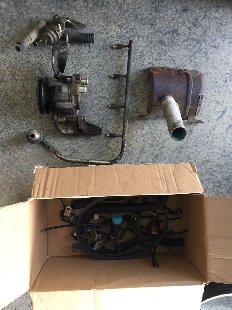

                      Also removed all of the factory smog equipment. Crazy how much useless stuff is on a motor.
