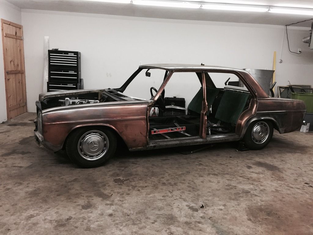

    Originally posted by CubbyChowder View Post
    Is the copper starting to kind of wear off, or am I just seeing things? I'm still very interested in this process
    I actually had to sand the parts off that look "worn" because I hadn't cleaned the steel well enough in those spots. The plating won't rub off once it's on there good. I've even taken a buffing wheel and 2000 grit to it in spots that were solid and it held up great.

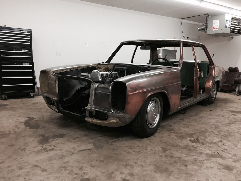

    Finally got the car on the ground and moved it off the wall. Now I can actually see the neglected side lol. Been doing some hardcore long overdue spring cleaning around the shop too. It's starting to look organized again. More pics of the new setup to follow.

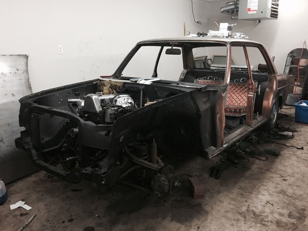

    Finally got the motor back in. Had to go at it solo tonight, but still got it in and bolted up in under 30 minutes. Maybe the only thing that has been a breeze with this car.
