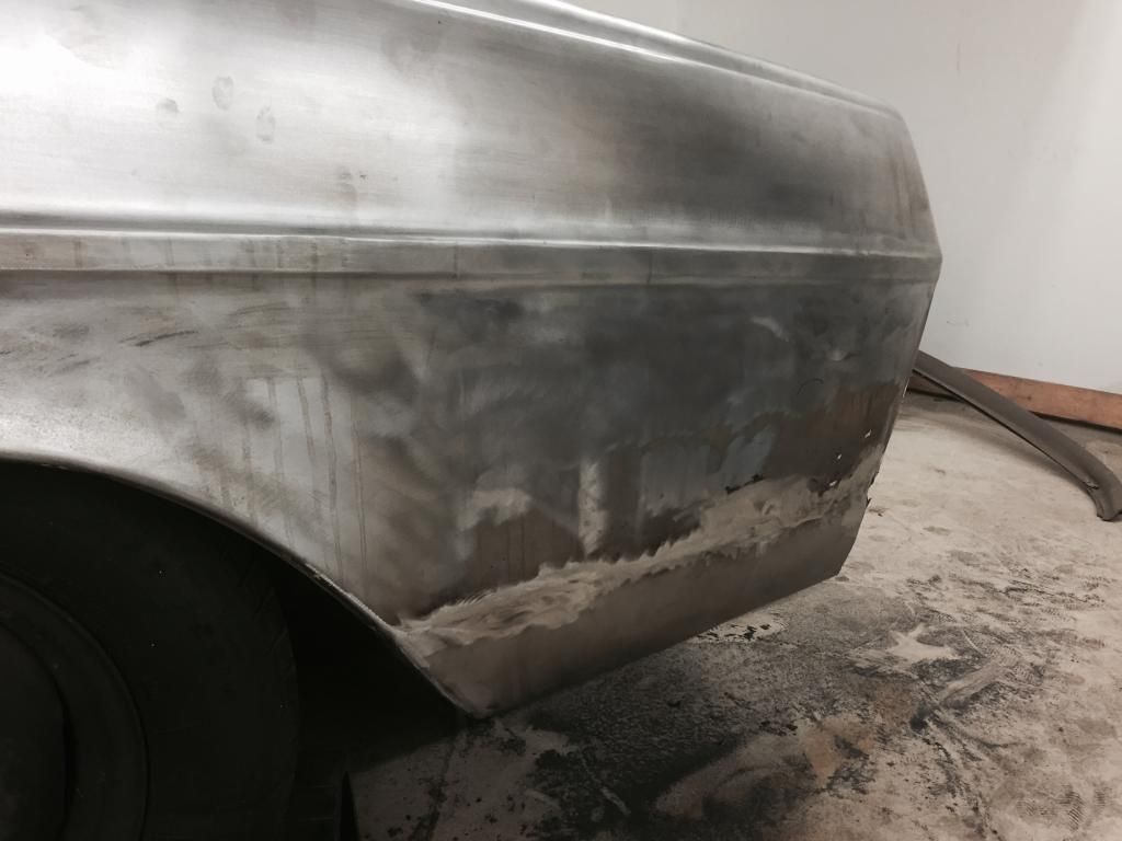

  • dineno
    replied
    Here's a little sneak preview of how the rear end is going to be done.
