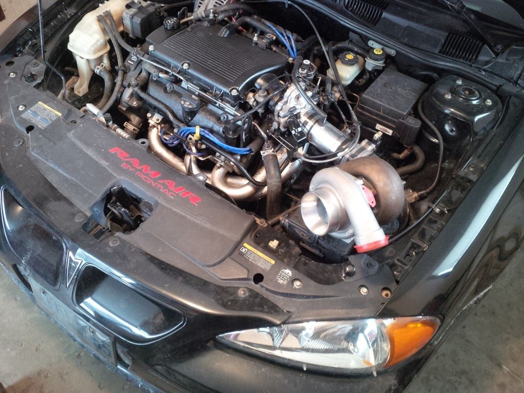

            turbo plans in the future...
