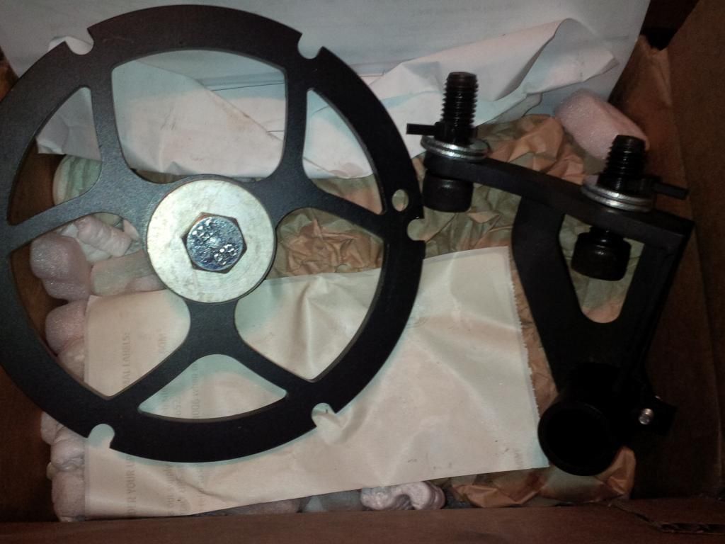

          with this external crank trigger I can run the stock 3400 PCM, it would run/drive on the stock tune but I have a HP tuned PCM already that was setup for a slightly modified LX9/5spd combo.... a couple small wiring changes but for the most part plug and play
          not much to update but a buddy swung by on his way to the track to drop off a LX5 TB and adapter he made, also got my CAI the other day

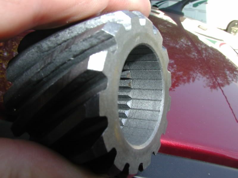

          got most of the wiring hooked up as well, having a issue with the axle stubs that were left in the trans... can't get them out lol buddy said they are really tight with the LSD installed but they aren't budging for me

              so might be ripping the drivetrain back out to swap transmissions OBX LSD installed by previous owner and I can NOT get the axle stubs to budge which is a common issue with the OBX if some slight modifications weren't made before install.... I thought he left these pieces in to help with spillage but now I think he couldn't get them out and just disassembled the shafts

                            well tried the pickle fork some more and was just doing damage to my new fork and transmission casing, bought a slide hammer kit and not 1 thing with it helped lol

                            and the reasoning behind all this BS, guess people don't run c-clips with the OBX or choose to chamfer the gears properly
                            no chamfer
                            chamfer
