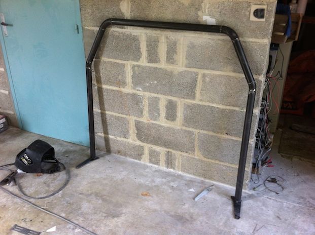

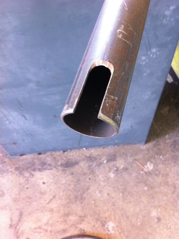

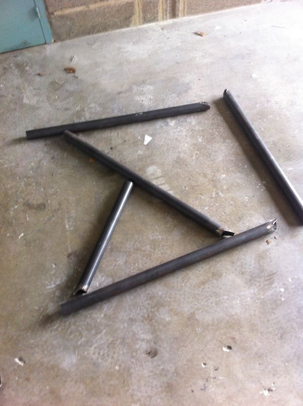

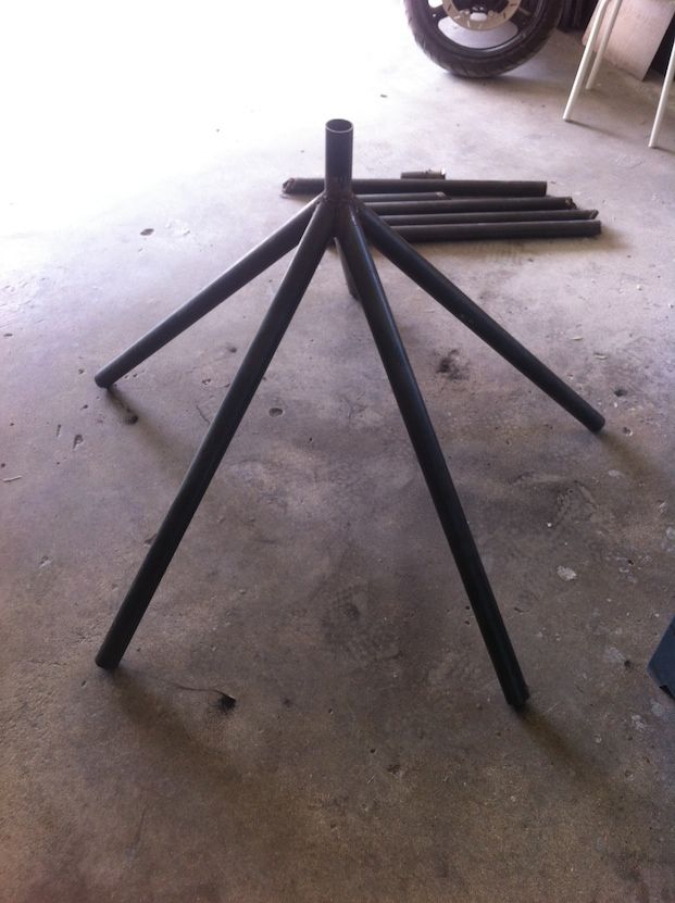

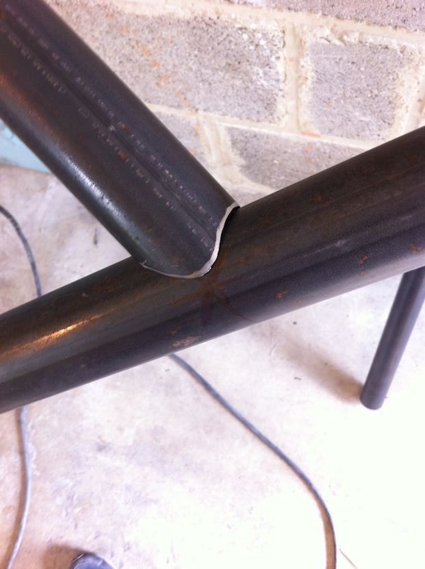

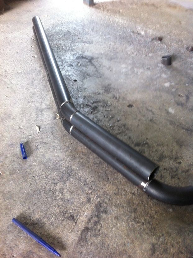

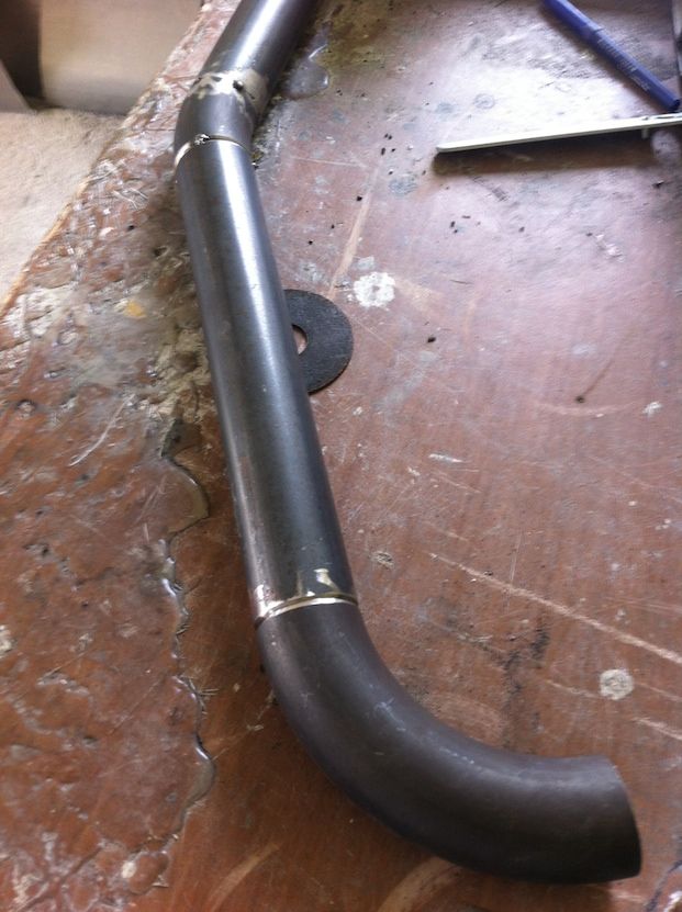

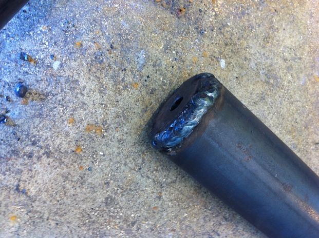

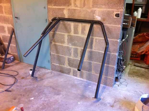

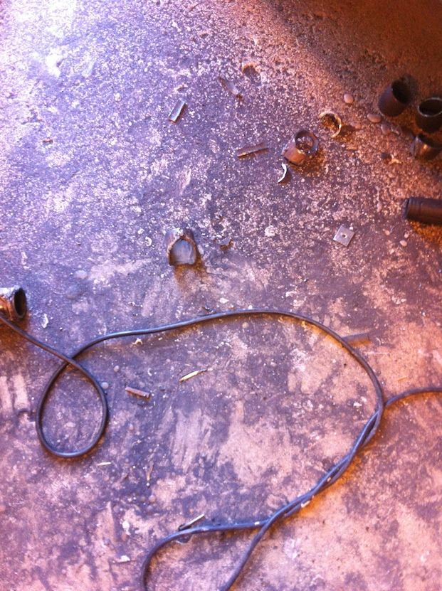

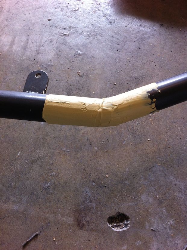

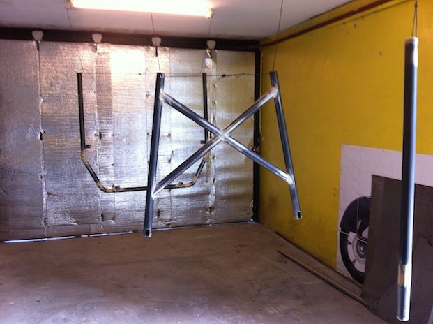

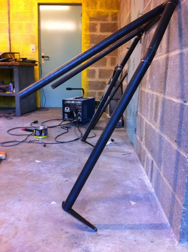

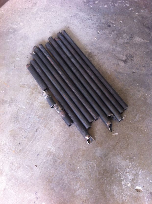

I decided to get a roll cage for the 135 but the ones I found were not in my budget. Plus, I want to keep the back seats. So, I decided to build my own. I defined the diameter I wanted which is 42.4mm. Then I found this:

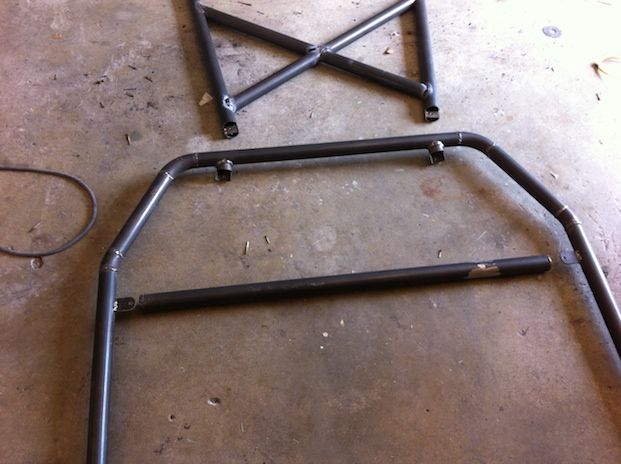

and made this:

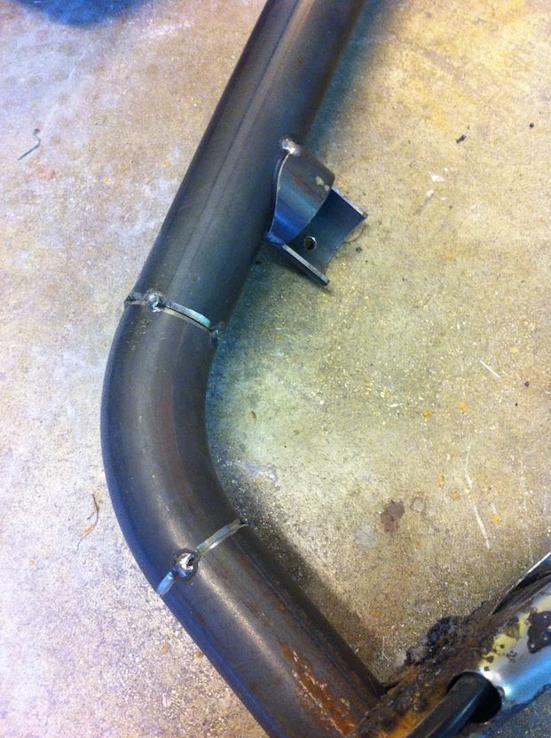

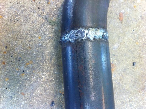

Welding is not my thing at allbut it went ok

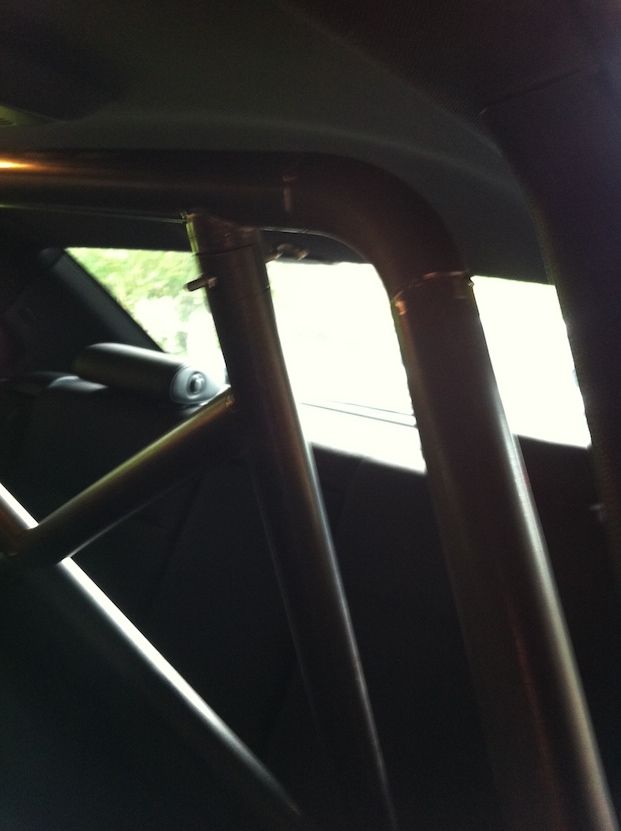

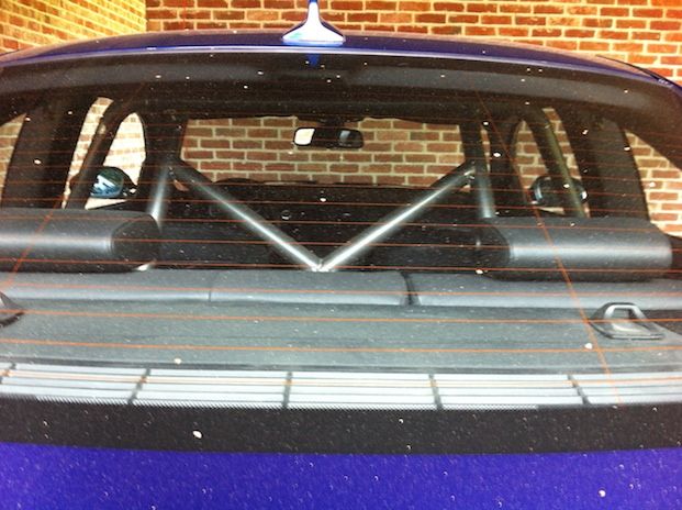

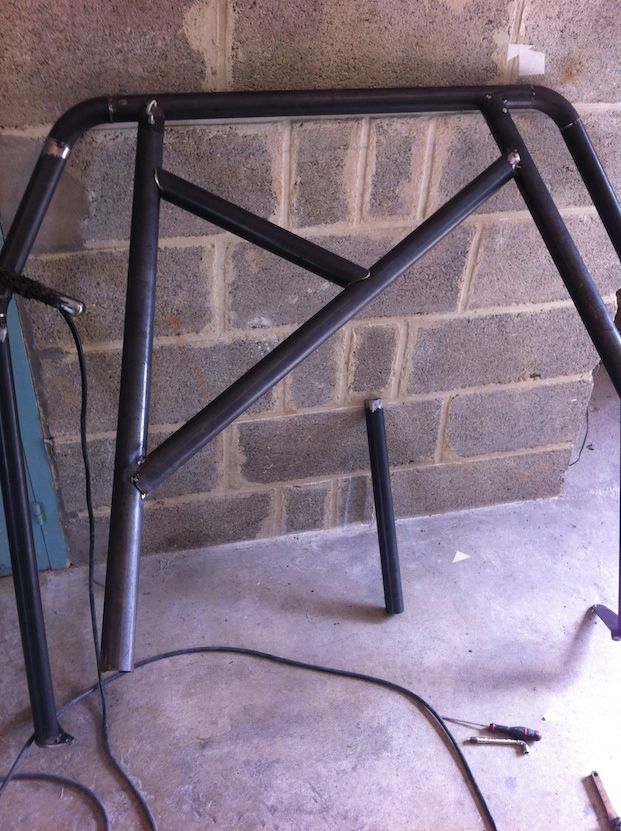

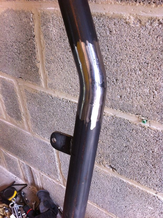

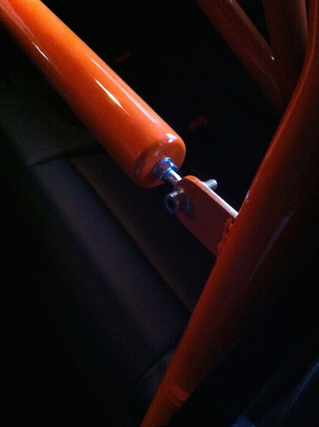

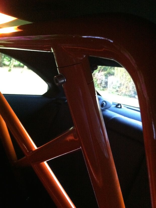

I wanted to be able to remove it in 5 minutes if needed so I made it bolt on. The front is fixed onto the belt support and the rear is in the Isofix system.

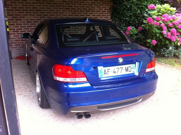

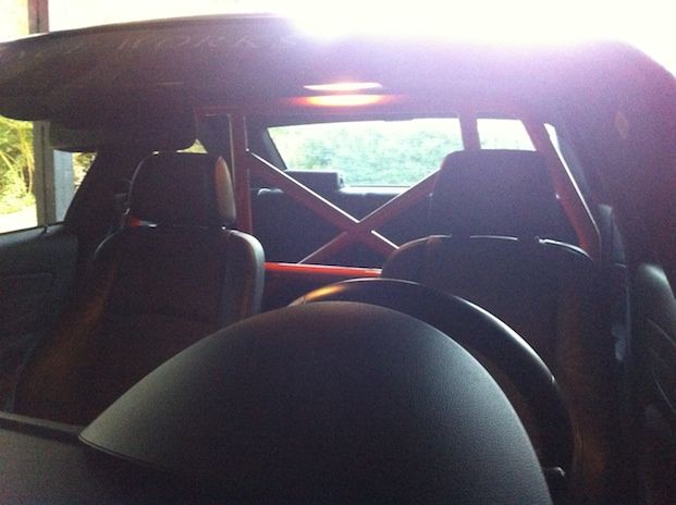

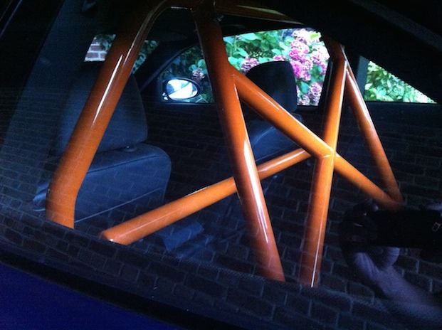

Checking if everything's OK.

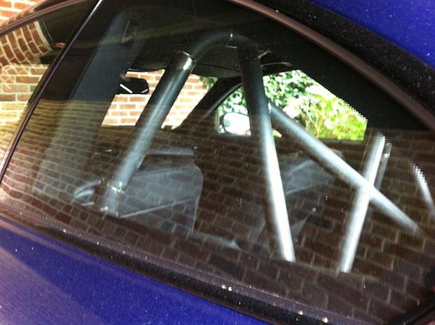

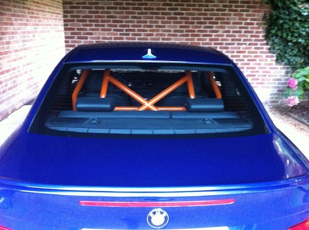

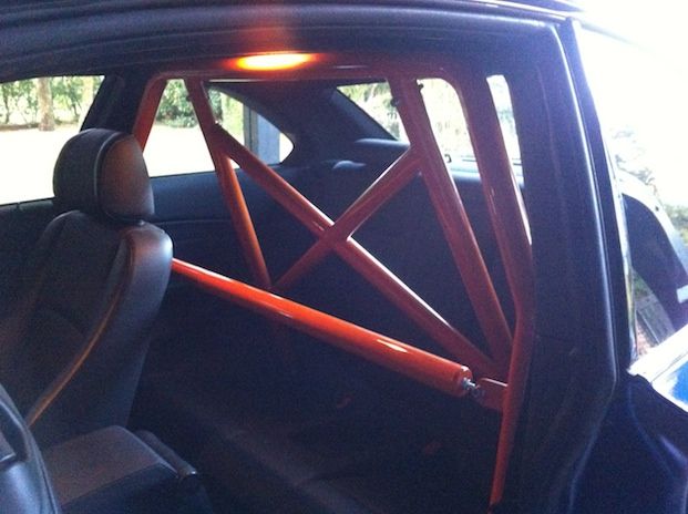

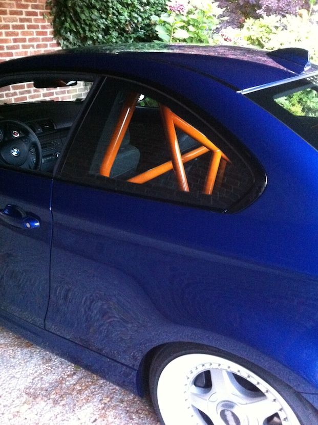

Made a photoshop to define the color. I went Orange Fire from the BMW GTS to fit the 1M trims I have.

Wow, car really good, great work on the cage as well!My 2011 Toyota Vitz build thread.
http://www.stanceworks.com/forums/sh...ad.php?t=56411
Originally posted by fire730 View PostAwesome work on the cage. Car looks bada$$.
thanks!
Any pics of how it attaches to the isofix?
Originally posted by thuggie View Postvery nice 1 series i really must stop looking at it because it reminds me so much of my old one serieOriginally posted by TerenceJCruz View PostWow, car really good, great work on the cage as well!Originally posted by lowrider View PostGood job, Sam, i'm gonna leave you my e30 for "cage-ing" :POriginally posted by electricalbox View PostVery nice 135

Not into the cage personally, regardless of the safety issues you kept a back seat that is rendered completely useless now because of the cage. Just my .02. Gut the car and build a real cage or keep it in it's OEM+ stage and it's perfect. Again, just my .02! Love the fitmentInstagram : @SHMVNY_GVNG
