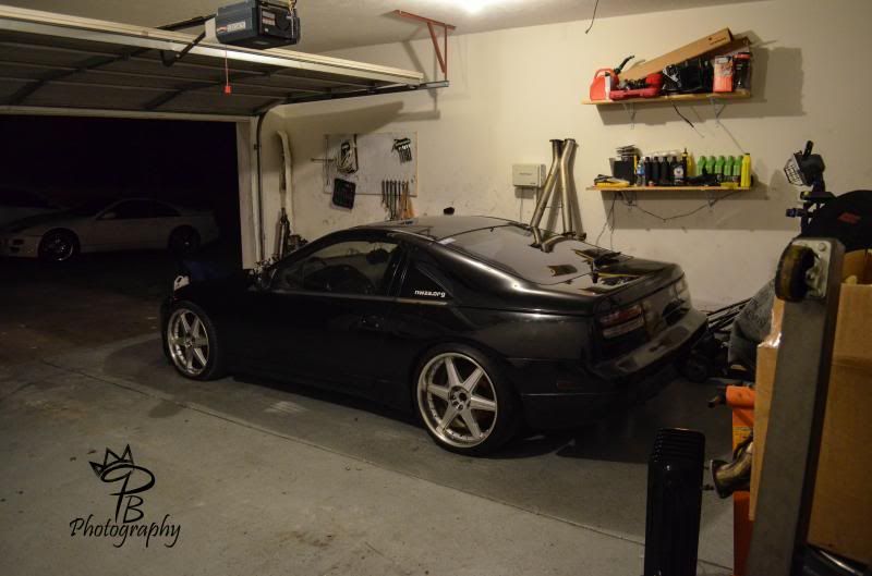

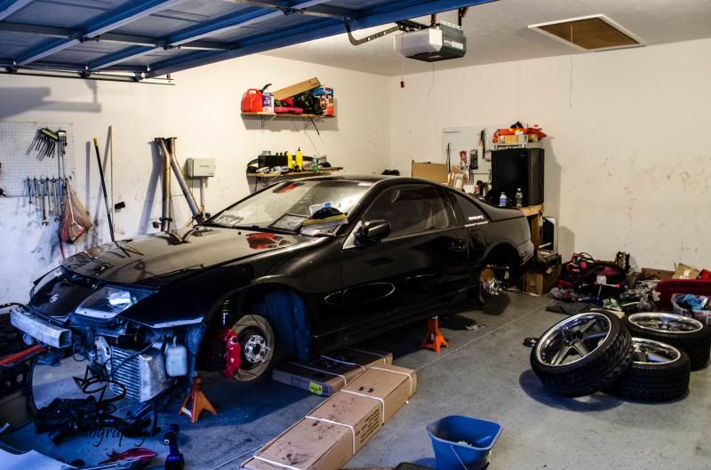

    Well I finally picked up a slicktop to have fun with. As some of you know I spun a rode bearing in my red twin turbo due to oil lost from improper built short block from the last shop. So it's time to start it fresh and get it all done right.

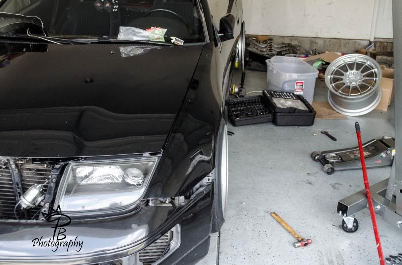

    Thus far I have installed Power Trix Ultra Light Racing Coilovers with swift springs in a 8/8K spring rate, SPL Rear Camber arms, and Jspec tails. Car did not have AC so I removed my old lines from a Twin turbo before selling it and installing a replacement AC Evap system thanks to Scott.(RB26Z32). Car will need a paint job but overall a very clean shell and at a great price. can you say 800bucks for a Slicktop 93 with no wrecks!!! Very happen to start on this build, I will miss my T-Top days but then again I'll have a AC.

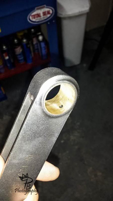

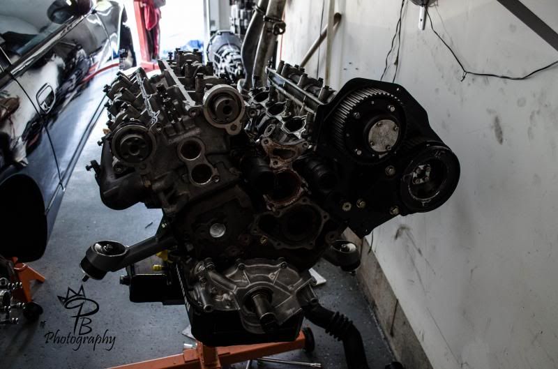

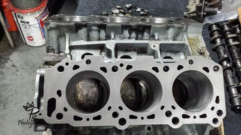

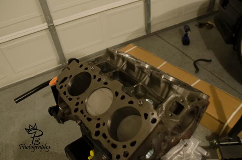

    Pics of the motor damage that was found upon tear down. Aside from improper torqued head studs (pulled them all out with my fingers no tools).

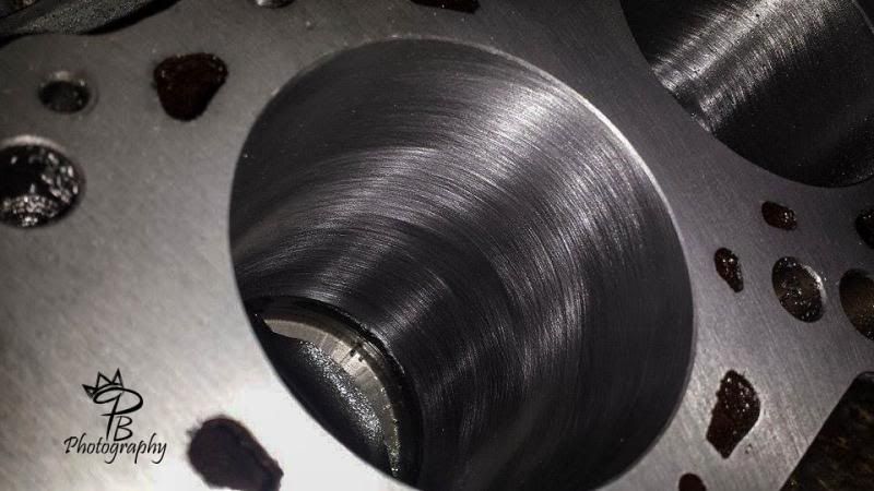

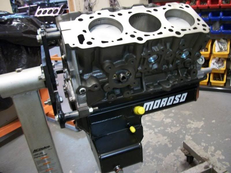

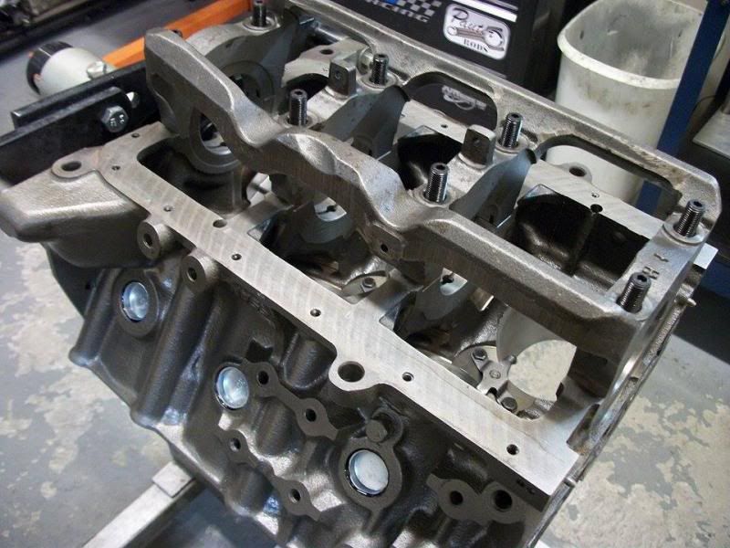

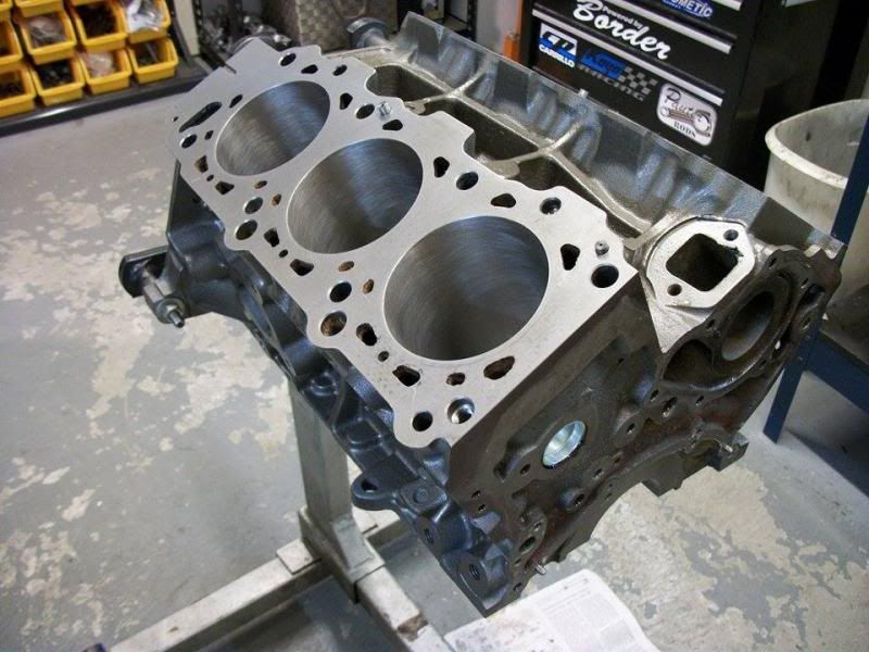

    block honed out and ready for the good,

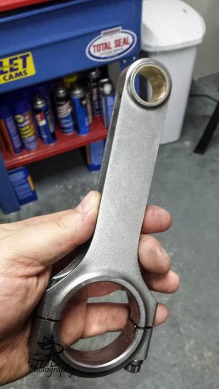

    replacement rod

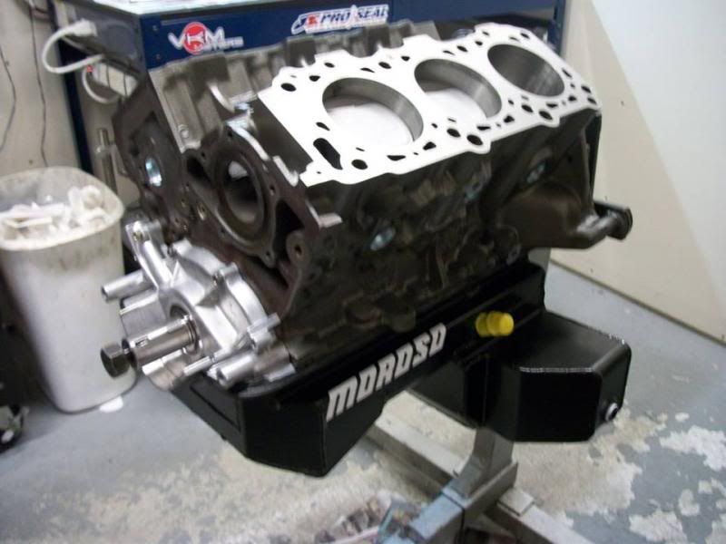

    Moroso 8qt pan
    more to come can't wait to get this thing up and running

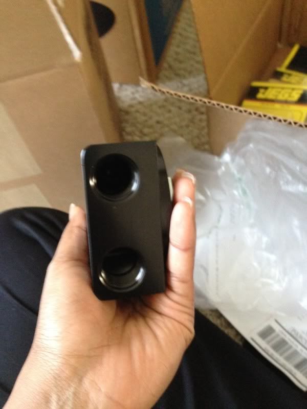

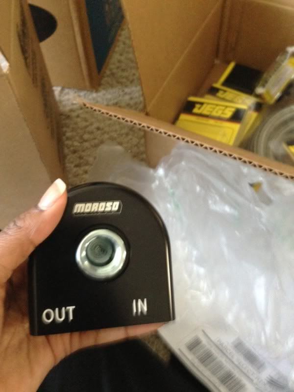

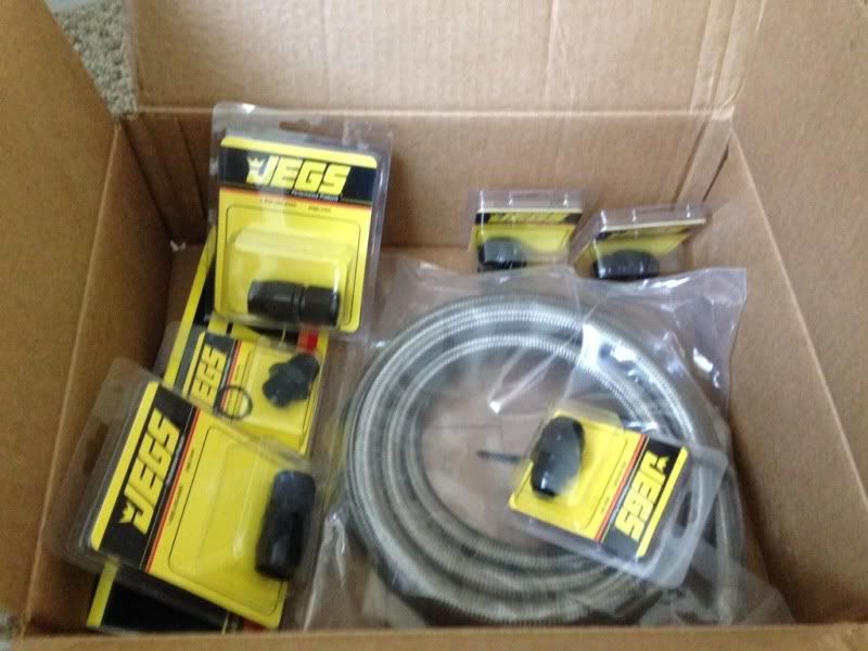

        Parts finally arriving form jegs thanks again Bigwils
        Wife took photos of the parts
        Adapter Bracket

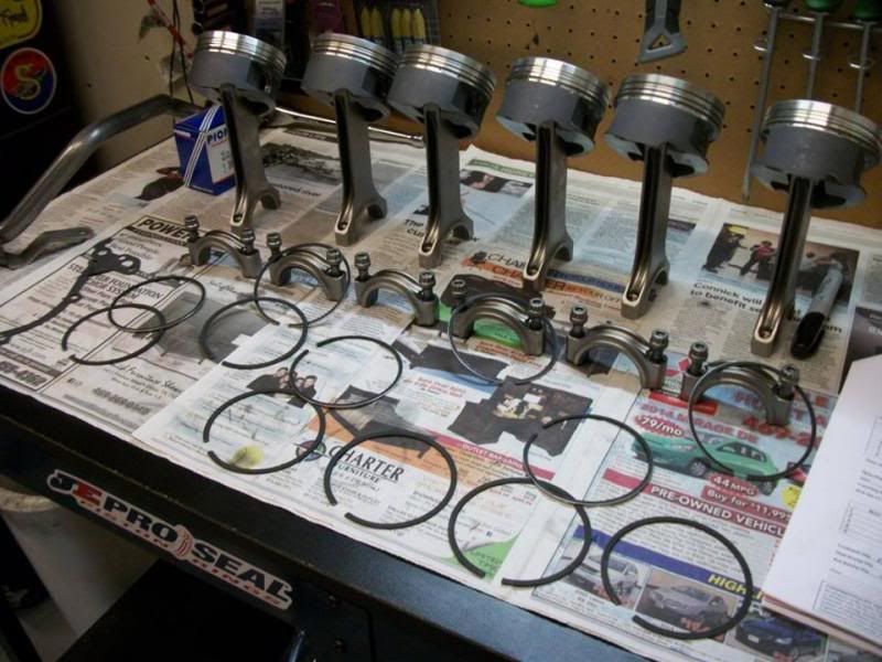

          Block should be fully assembled this weekend.

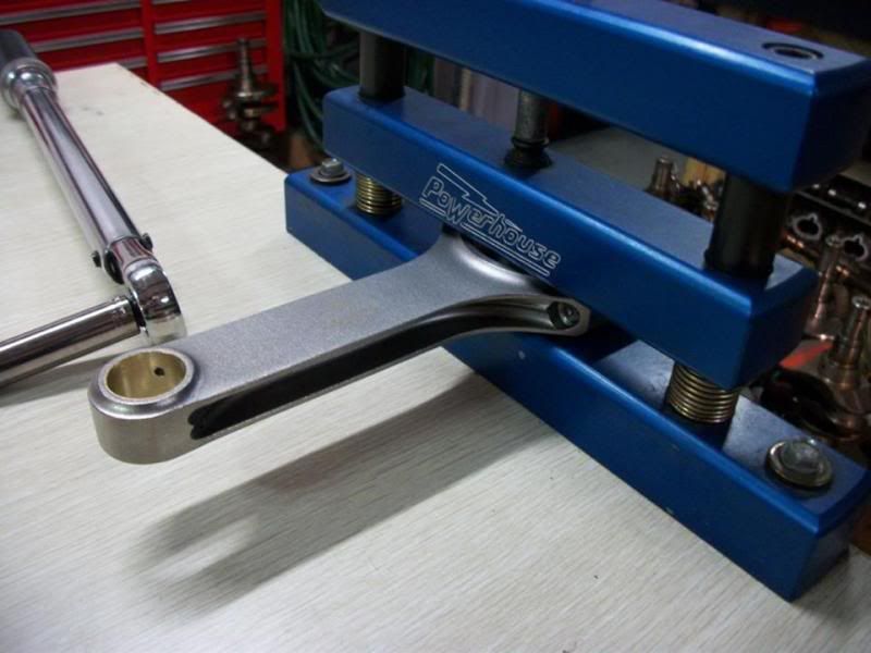

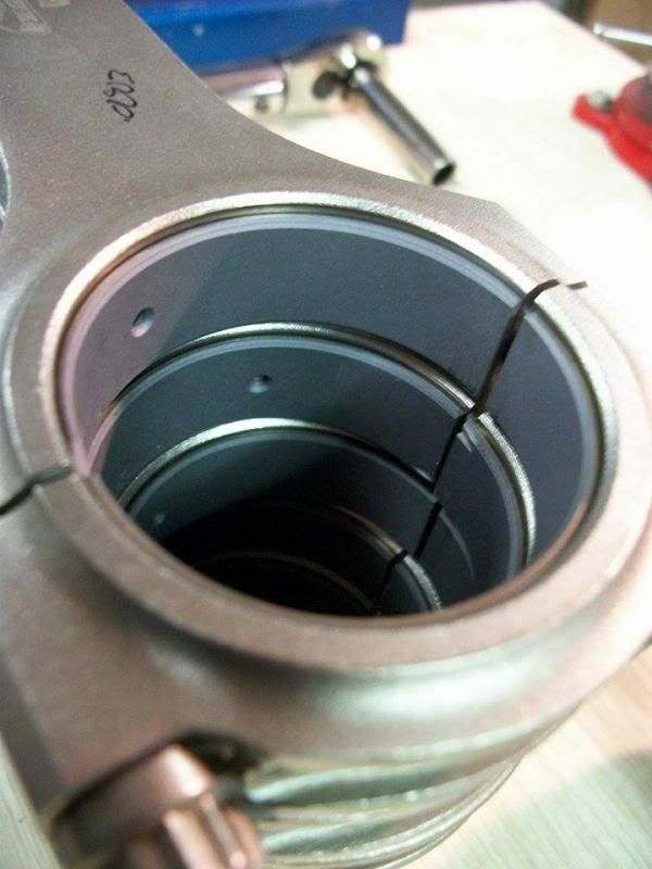

          fresh new coated bearings

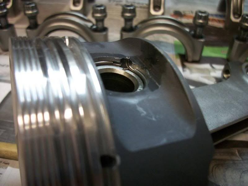

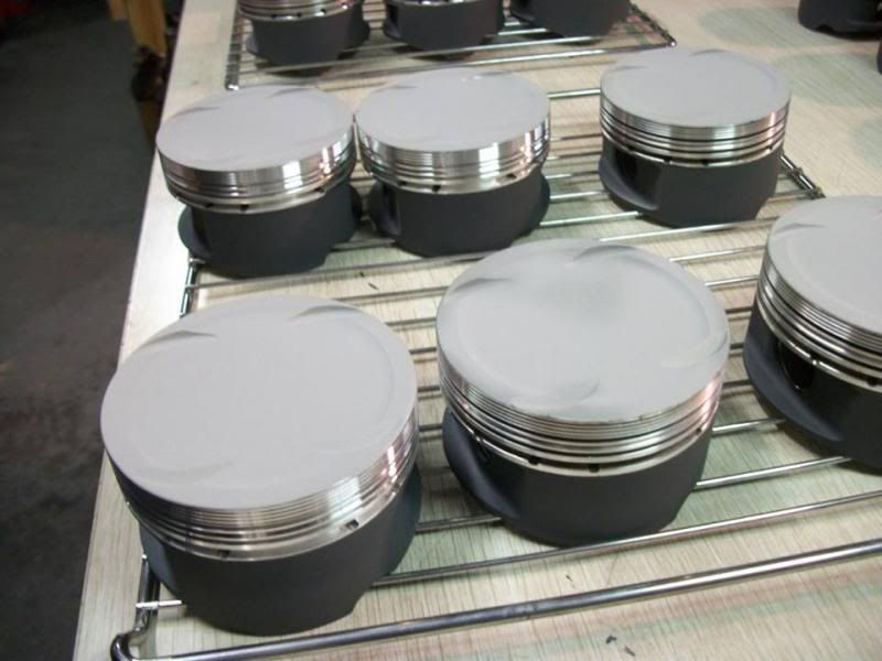

          Pistons coated

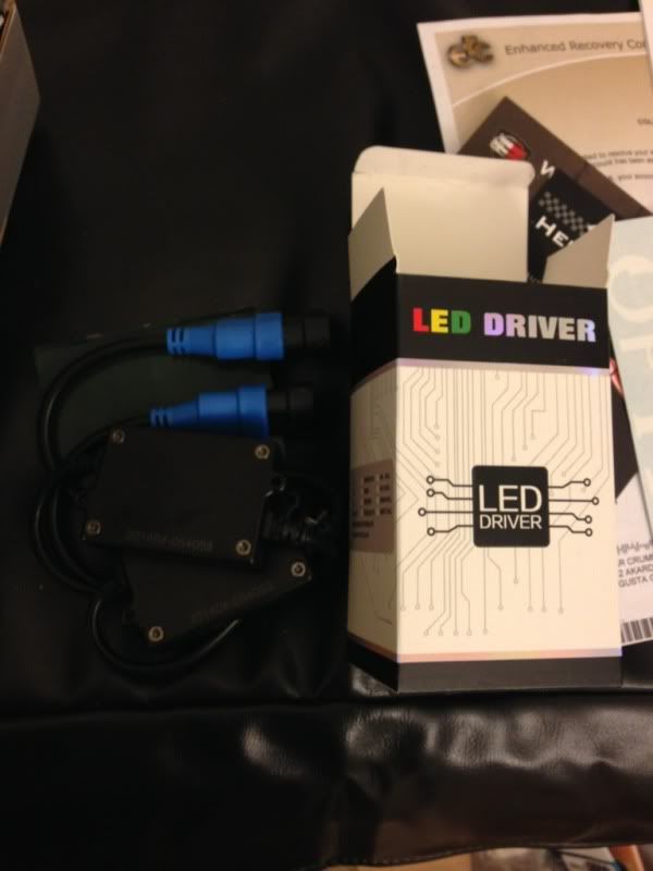

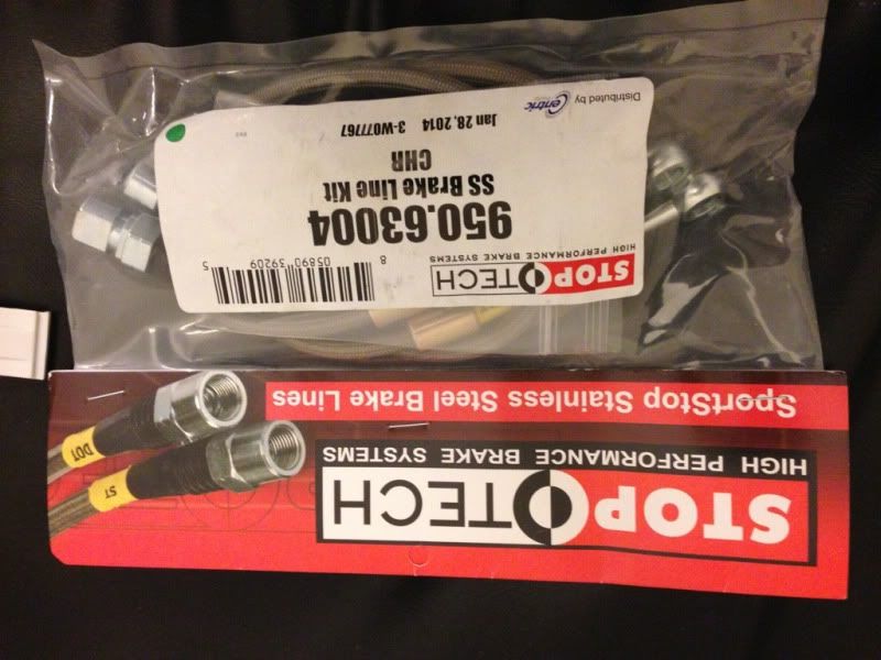

          New brake lines in for the SRT8s

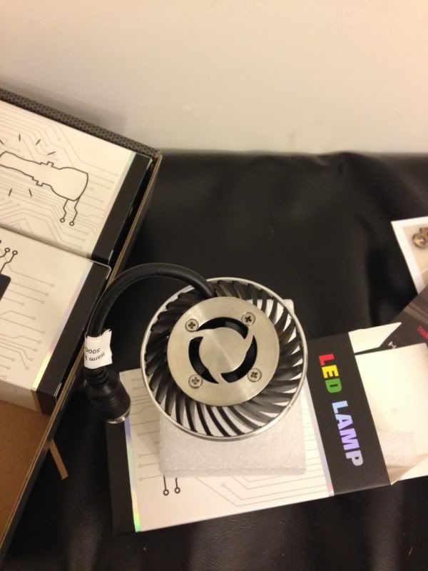

          LED Conversion

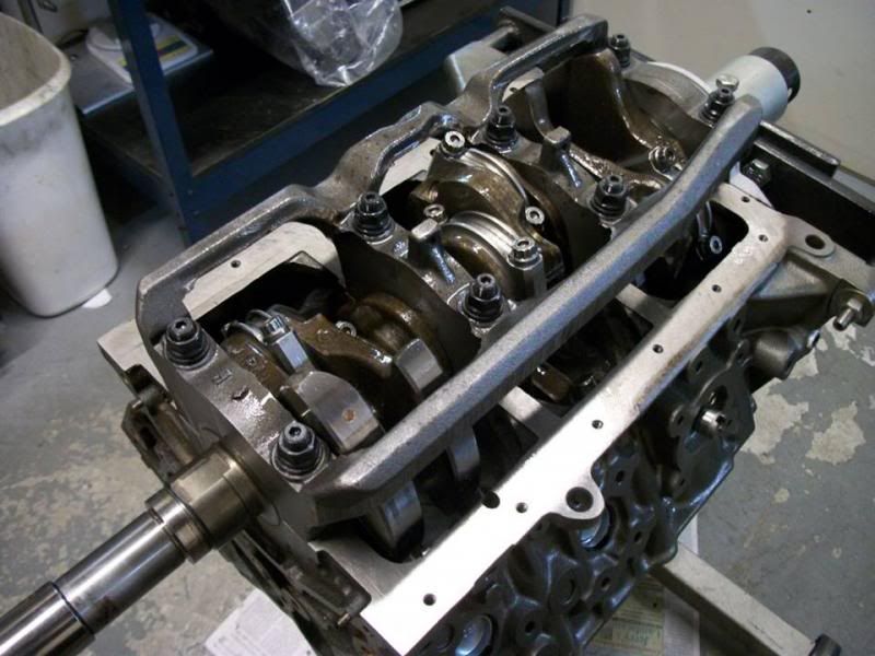

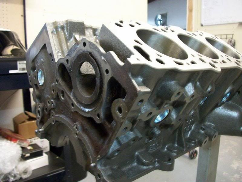

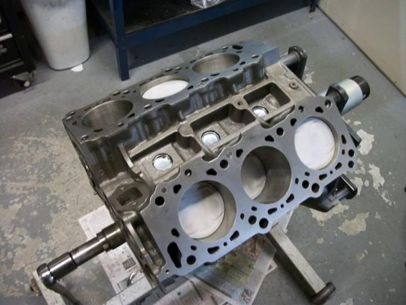

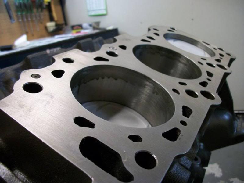

            Block coated charcoal grey and ready for the goods.
            Clearances checked one more time.
            Rings rings rings
            The locks of greatness

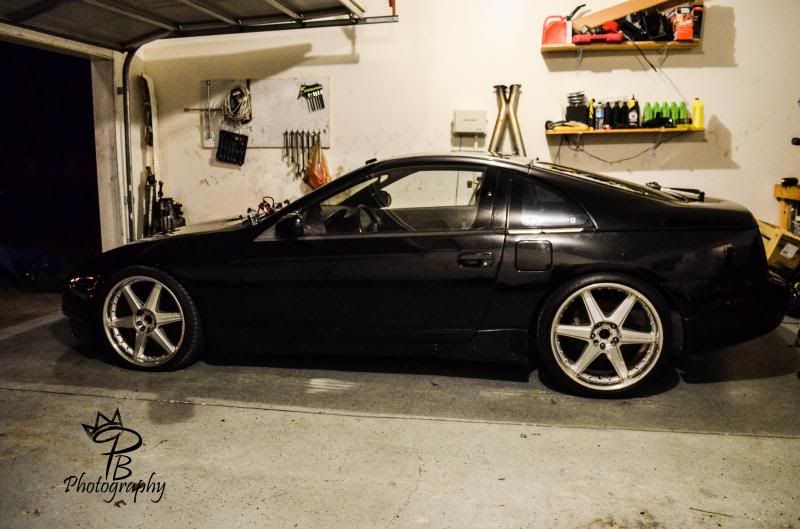

                On to the good stuff. I made it back from AZ ready to get down to business. Laid all my parts out for the build and started a list of what I need for the most part. Want this all done right the first time.
                More up todate pick of the car> last time with these wheel. Sold my 19s today and picked up a set of Enkei NT-03s in 18x10.5 et 30 all around.

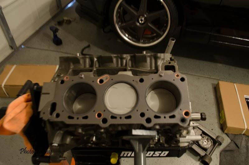

                  And were back to getting it in.
                  Whoops it skipped a step lol...
                  need to clean this mess.

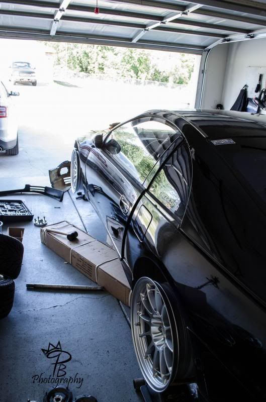

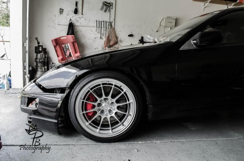

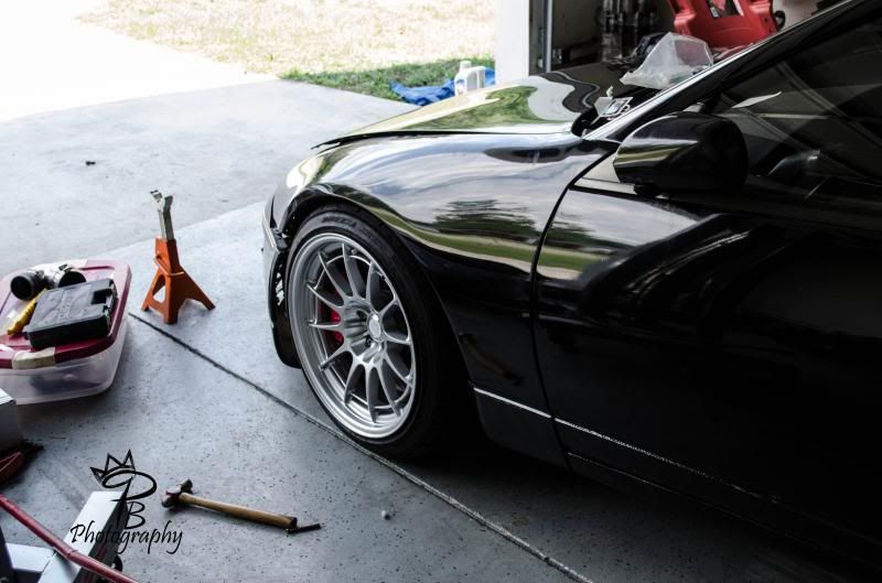

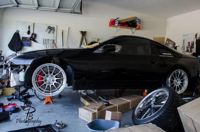

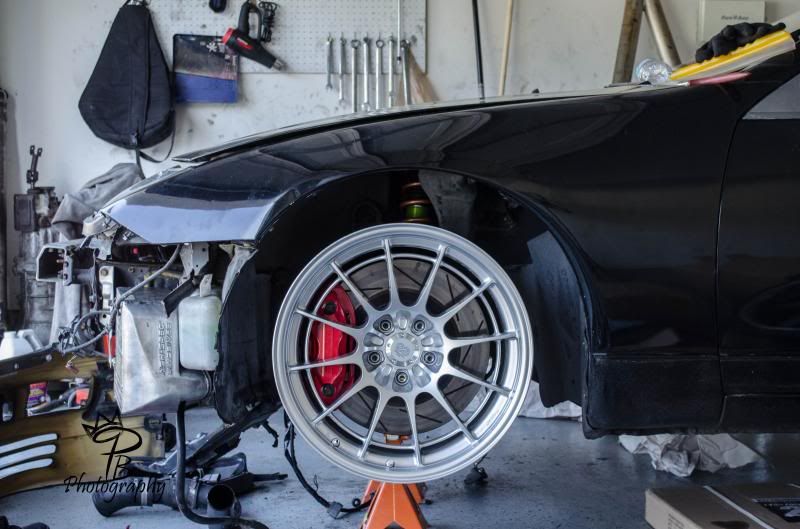

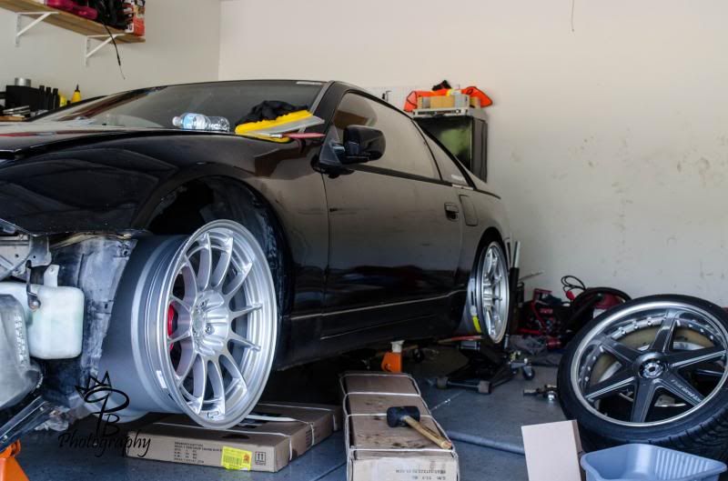

                    Thank you sir.
                    Daddy got some new shoes in
                    Enkei NT-03s
                    18x10.5 ET 30mm Square setup

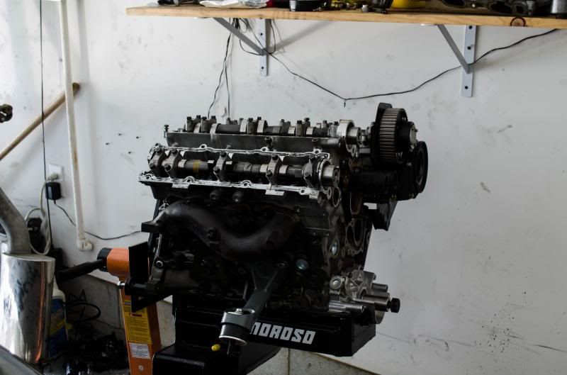

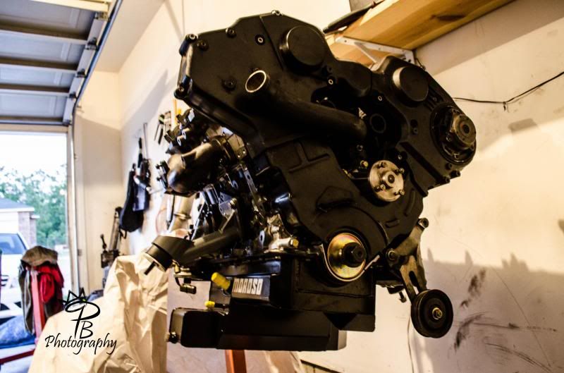

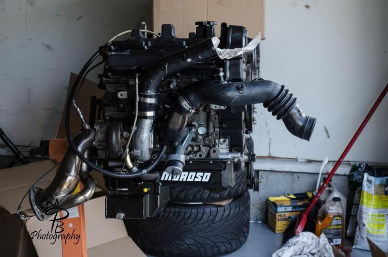

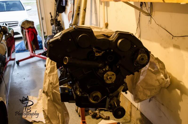

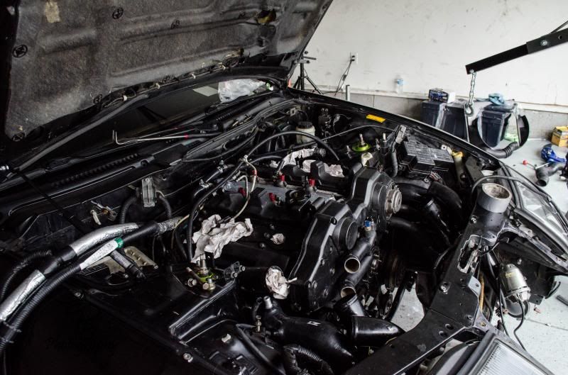

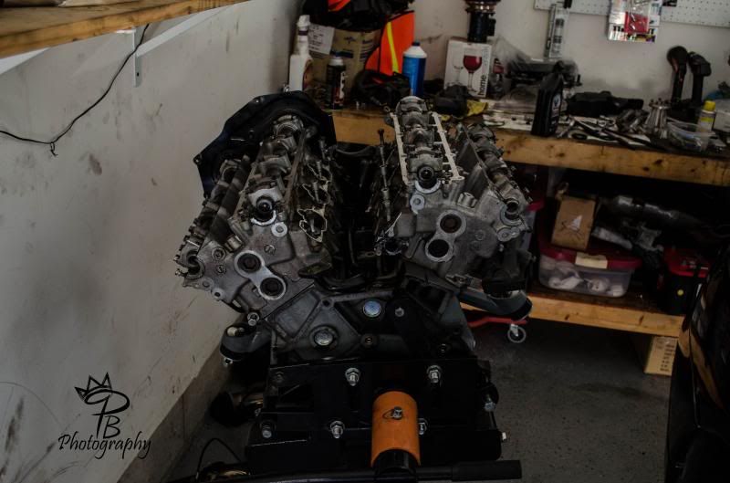

                    More completed on the motor.
                    Turbos on, valve covers on, injectors in, and moroso remote filter adapter installed.

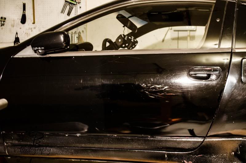

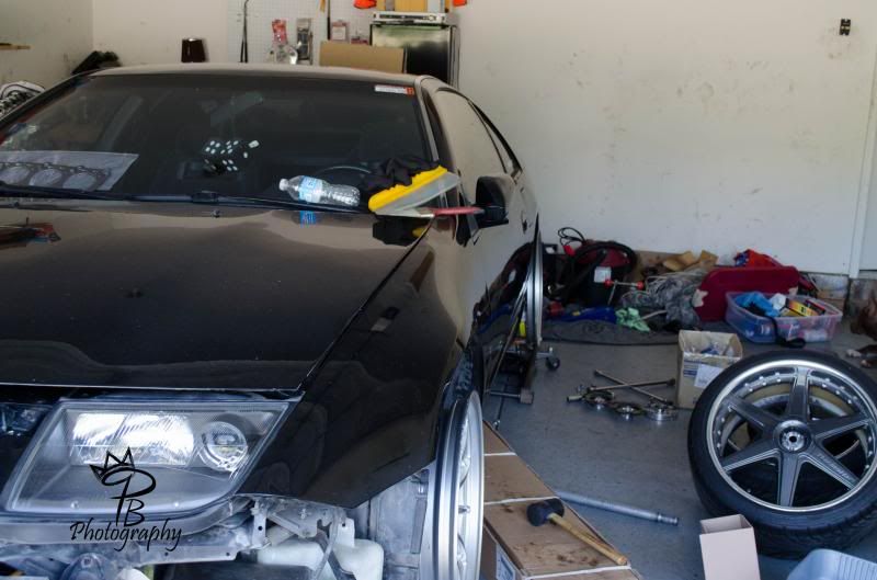

                      Well since I was stuck waiting on parts to ship, I figured I would start on the paint restro. I knew the paint was bad, but good lord, this wasn't even two stage swirl remover. Will go back and reclay bar and hit the car again.

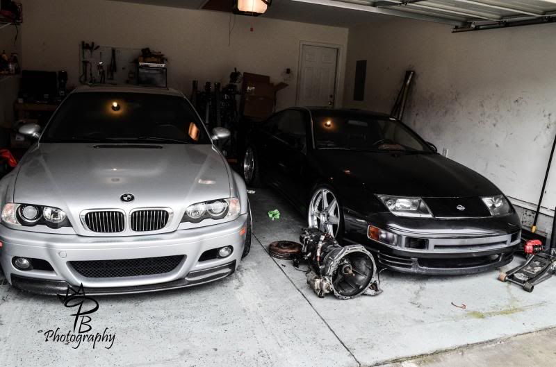

                        wait, wat? So you have two totally bad-ass Z's and an M3?? This can't be legal - it's too much awesome for one man!!
                          i agree with you,This can't be legal - it's too much awesome for one man!! thank you
                            Thanks guys.

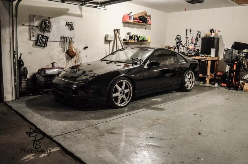

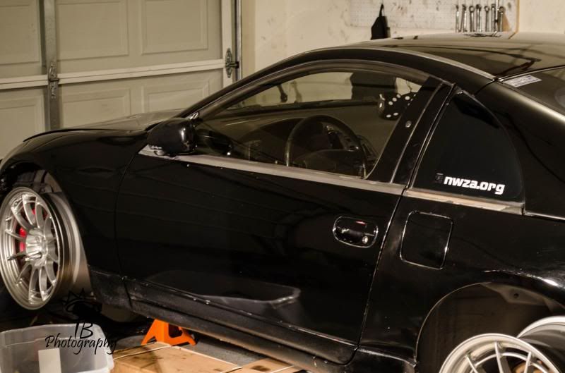

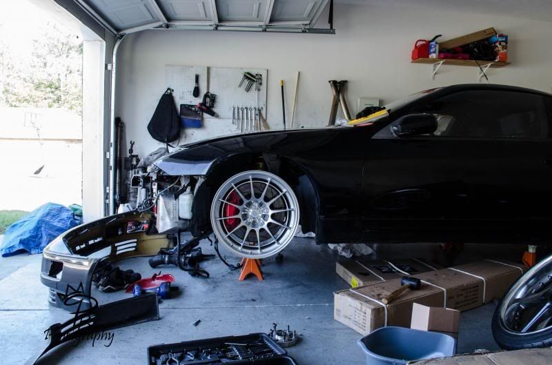

                            Wheels don't seem too appealing in pictures but in person I am all smiles, especially after noticing the drop in weight at all four corners.

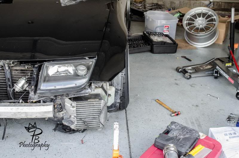

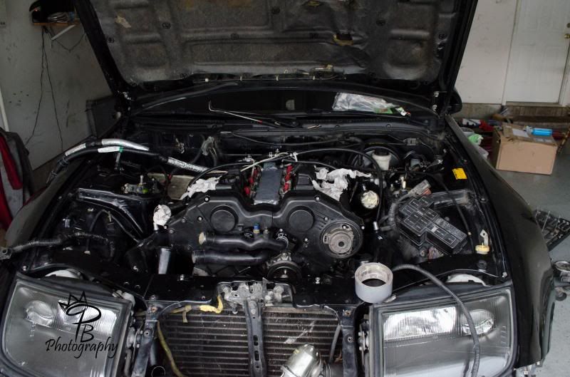

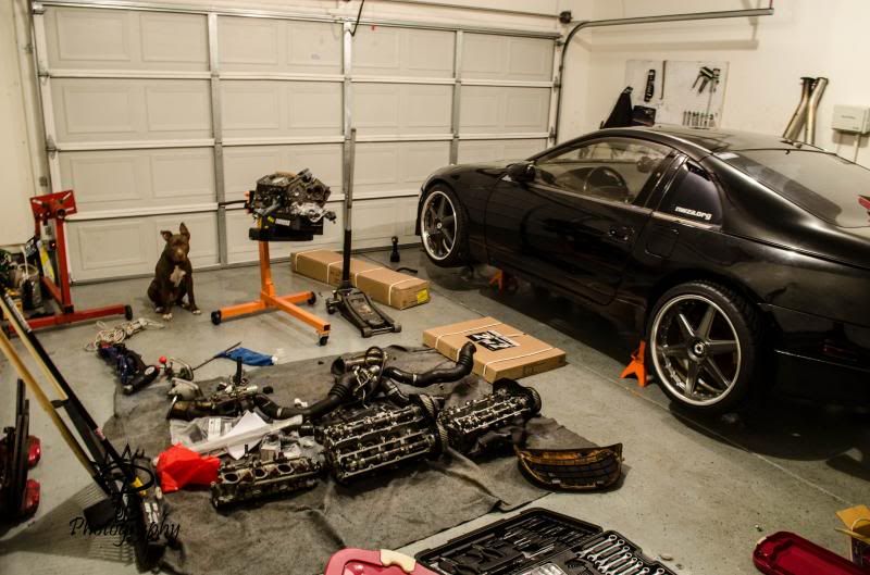

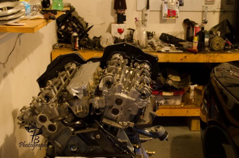

                            Well she is in after redoing timing again, doing a once over all the bolts and clamps. Tomorrow I will get the clutch and the transmission, then I can focus on wrapping up the interior and intercooler piping.
