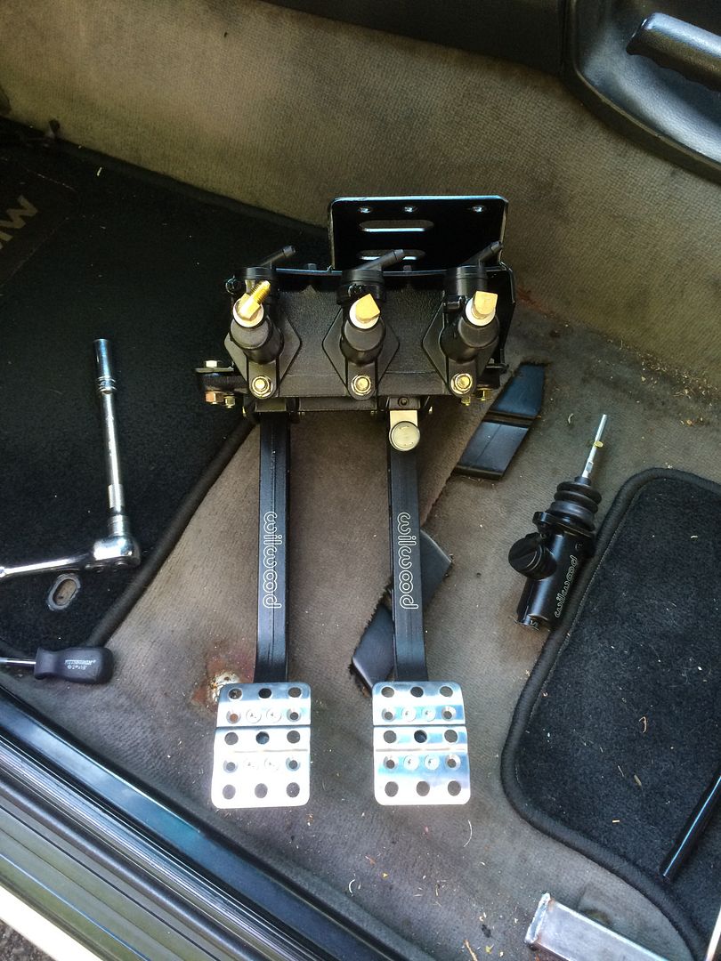

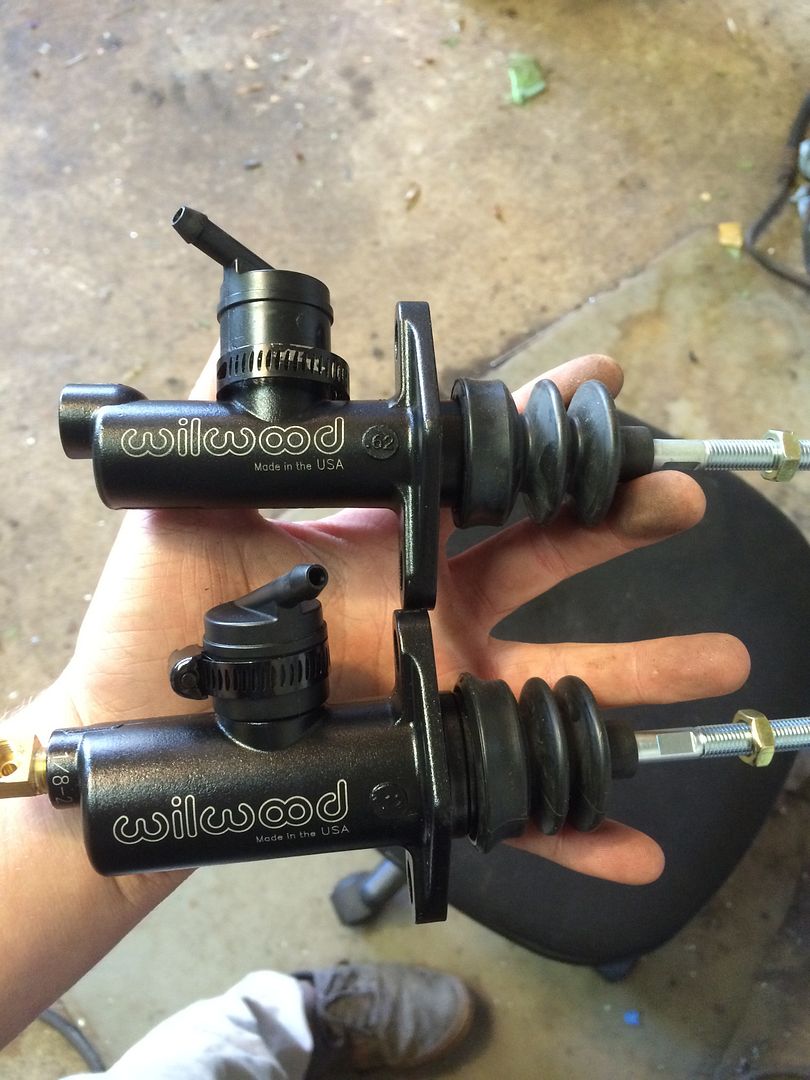

    Pulled the pedals back out this morning to swap I the big ass 1-1/8" master for the front calipers. Waiting on a wilwood proportioning valve from my buddy to finish up the brake system.
