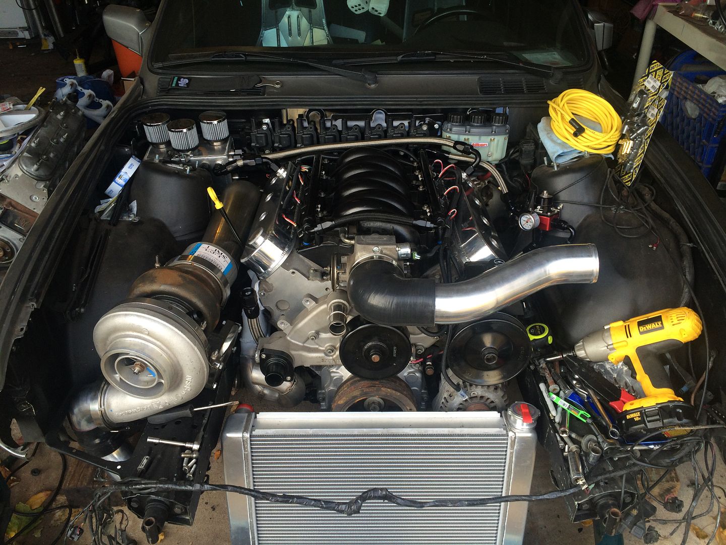

    Originally posted by baluzy36 View Post
    Absolutely amazing so far. definitely in for more. Also, does the exhaust manifold go behind the engine?? having trouble picturing the v8 single turbo manifold lol
    Thanks, the manifolds are flipped side to side so the exhaust comes forward, the drivers side comes down and across the front and back up.

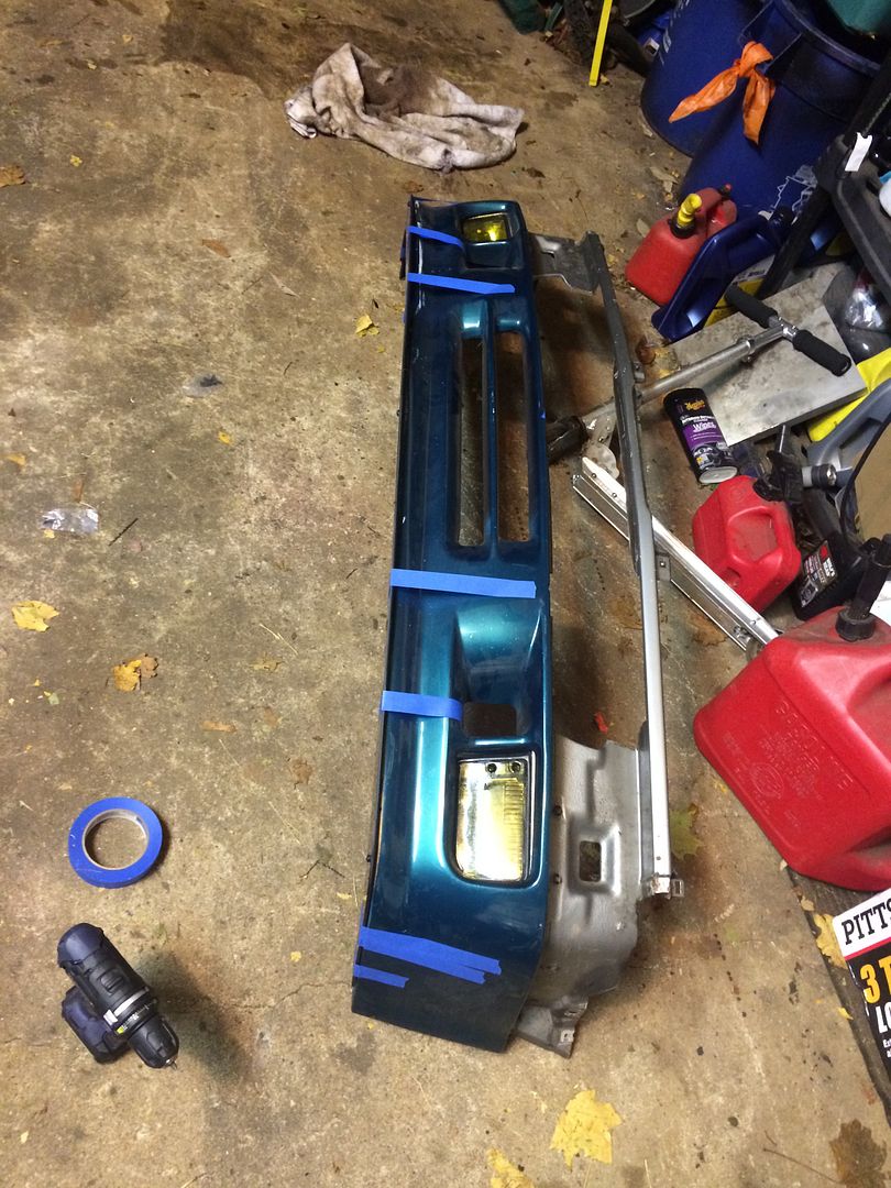

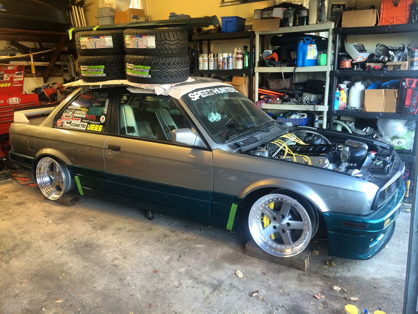

    Wired up some strobe led fogs, they can be solid on or hotboi strobes.
    Ordered new glass lenses to do yellow of course.

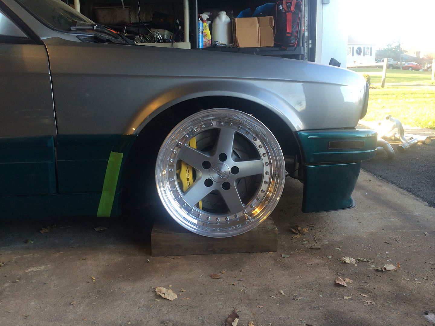

    Put on my Slightlystanced splitter tonight.
    Still sitting around waiting for my plug wire ends from summit and the equips from Espo's...
    Lots of waiting

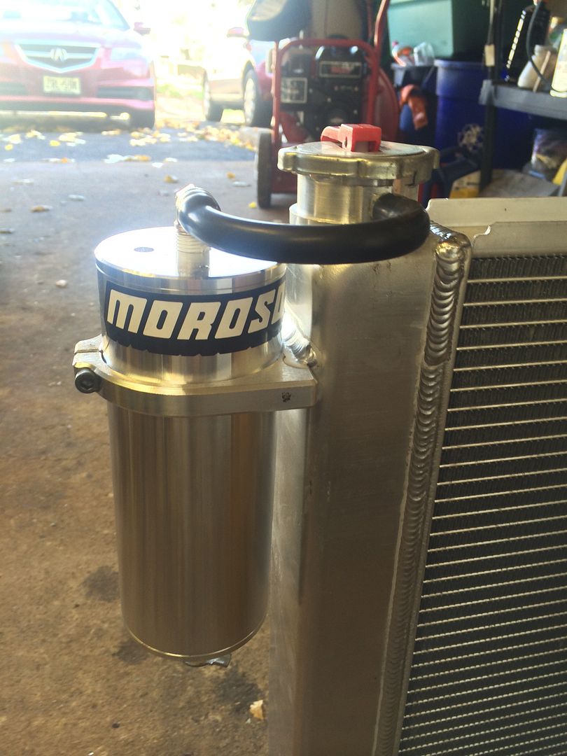

    Thanks. Put the motor in for now to make all the AN lines for the breathers and power steering. Planned to make my plug wires too but I bought the wrong ends. Welded the overflow tank to the side of the radiator too.

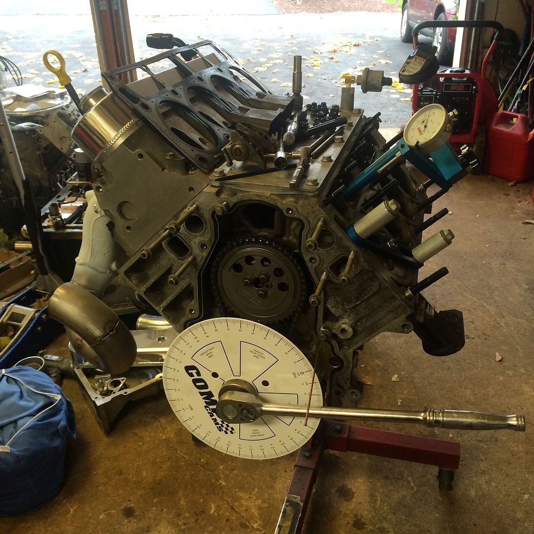

    this is insane... i love every aspect of it! ive owned many e30's and seen a ton of builds but this honestly surpasses everyone elses ive seen! so awesome! keep it up brother!
    Thanks! Degree'd the cam, since it's a gen 3 cam in a gen 4 block that had vvt/dod.
    Should be putting everything in for good this week and firing it up.
