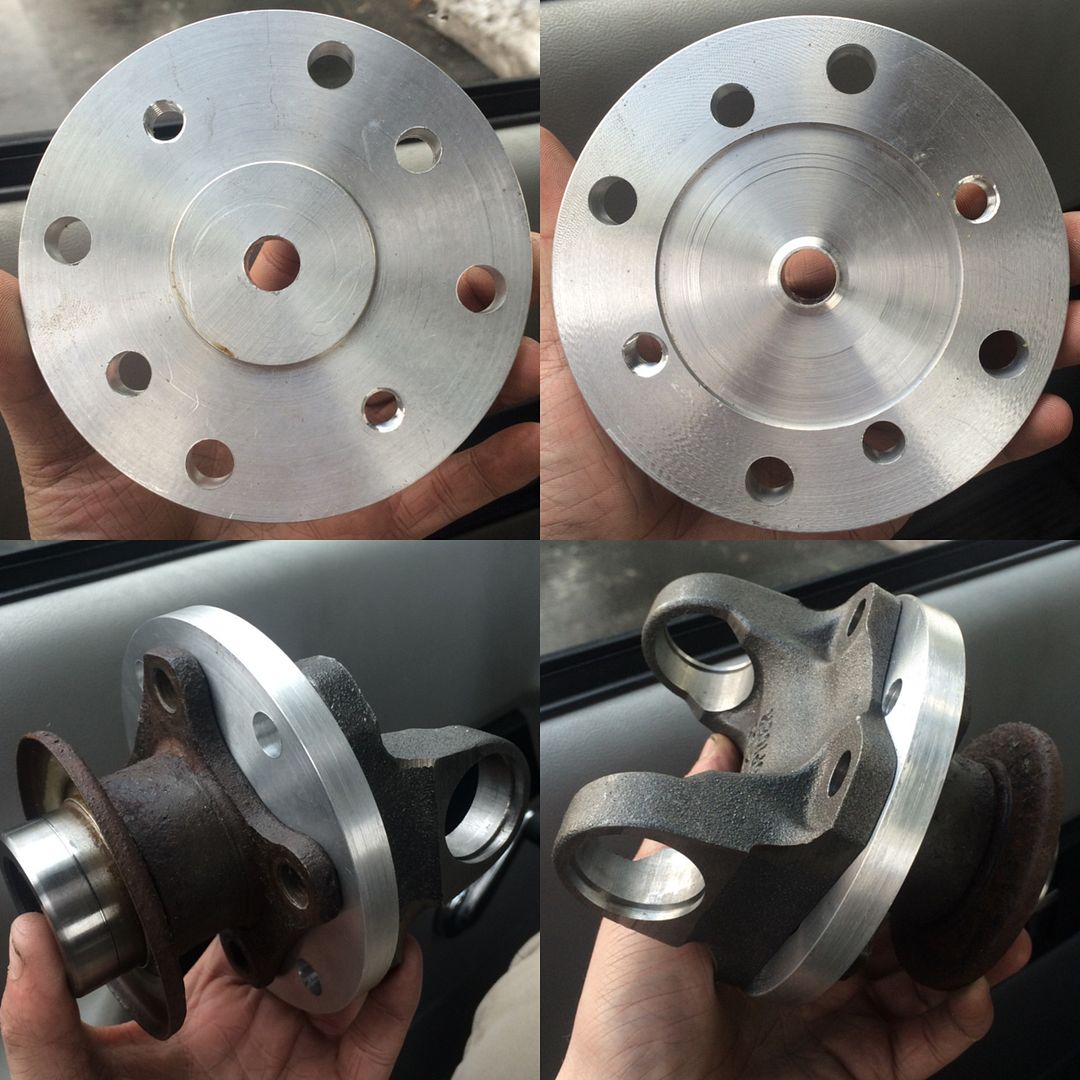

Finished up the diff rebuild and flange adapter plate.

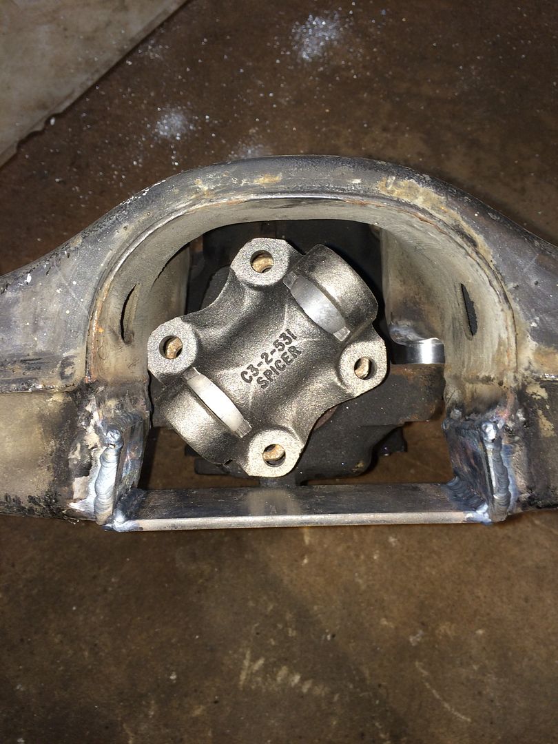

I will clearance the subframe some and weld another plate across the bottom.

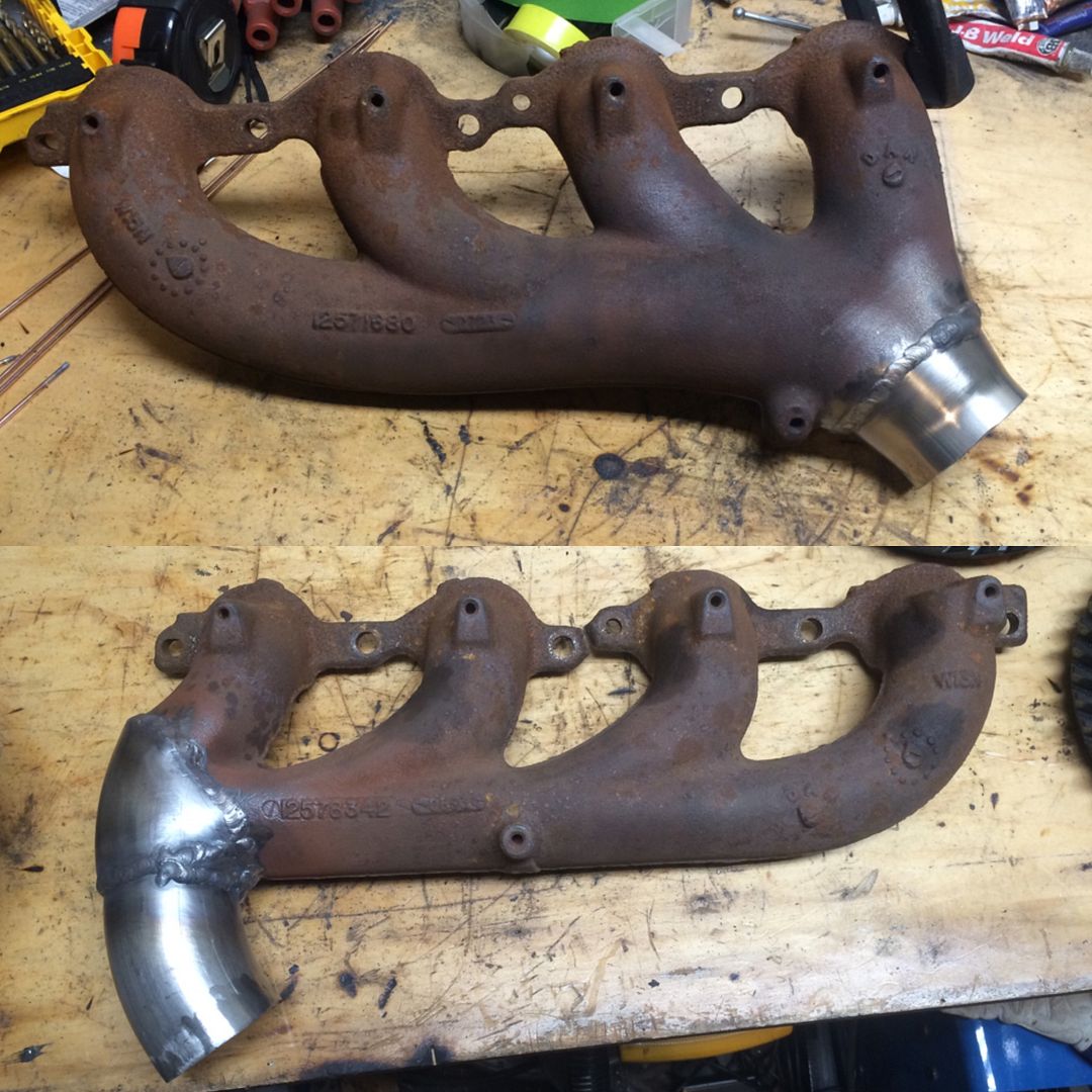

Here's the 5" exhaust vs my old 3" hahaha

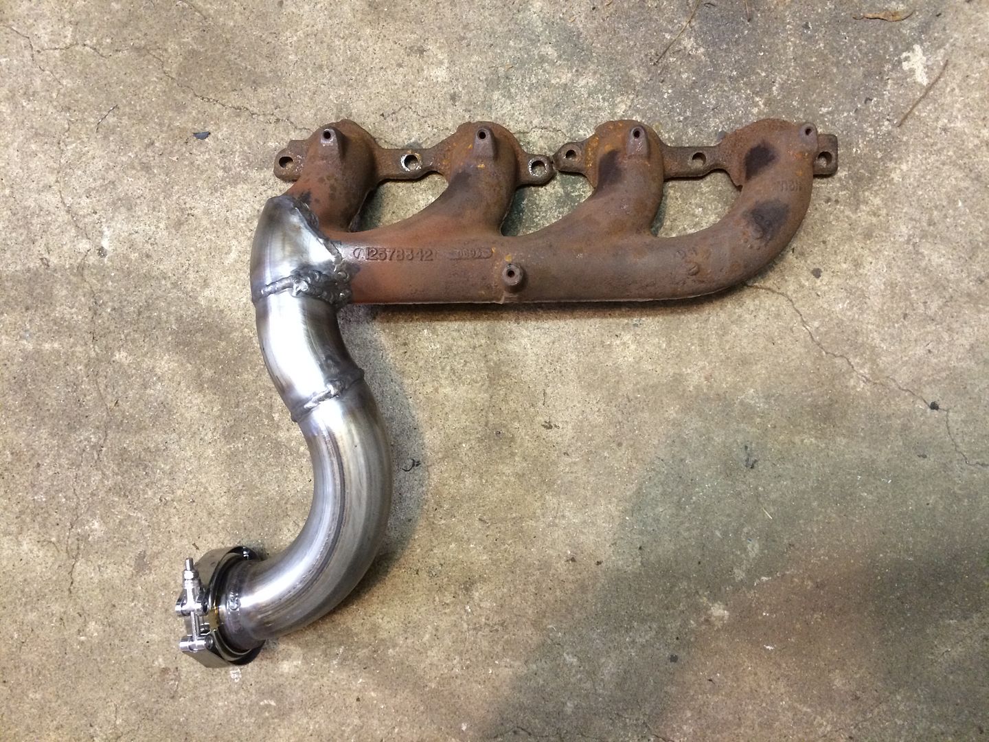

Worked some on my crossover setup too

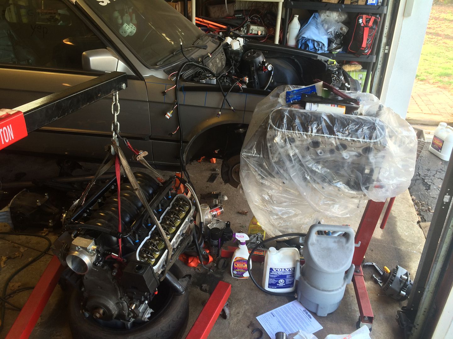

I saw this picture online comparing gen 4 bottom end to gen 3 and I quickly decided to swap in the aluminum 5.3 I have.
Here's how it looks so far with the catch can in the corner too.
Next up I'm building the trans and setting up a trans pump to keep the gears cool. Still need to order a driveshaft, front hubs/rotors, and small things.

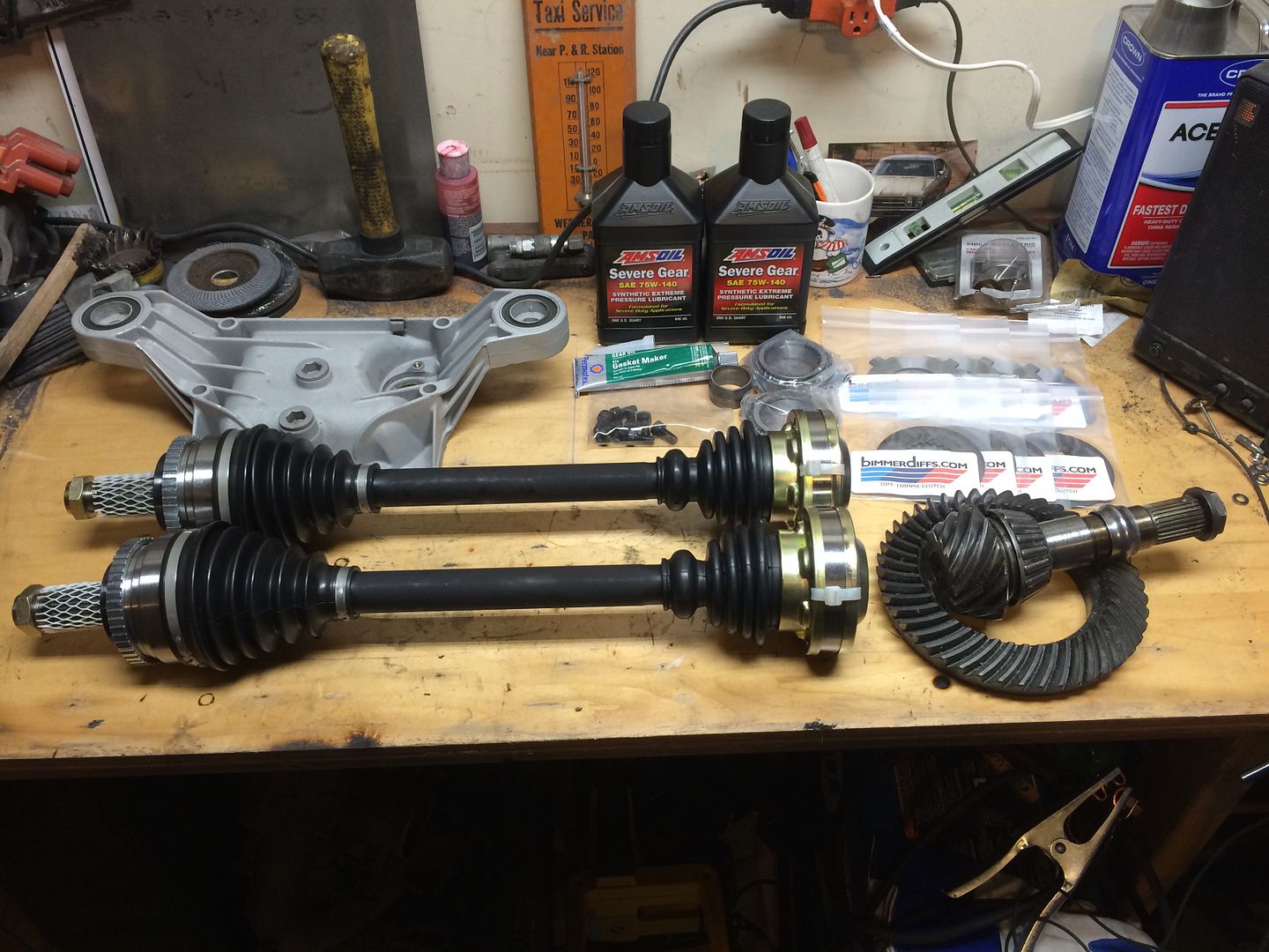

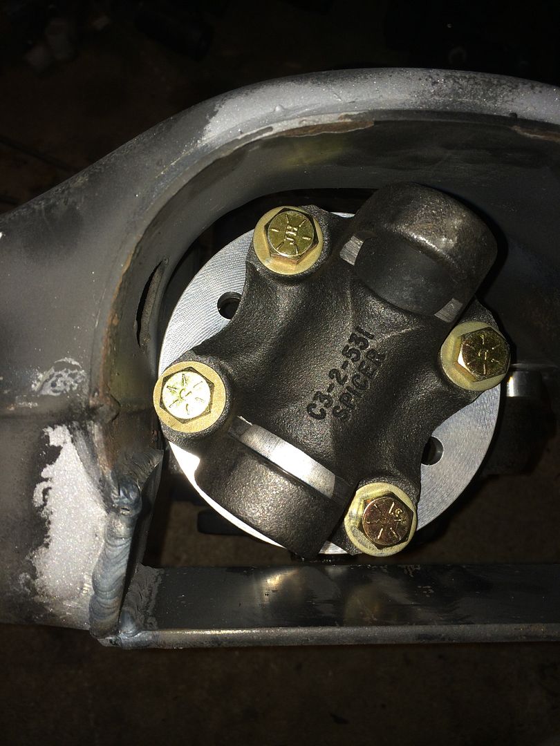

Rear end is all sorted now.

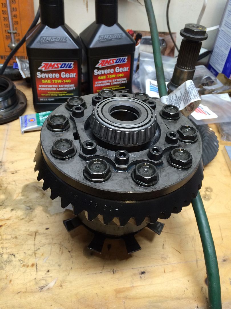

E36 diff with a 4 clutch rebuild and 3.46 gears, CAtuned chromoly axles, z3 hubs, e46 brakes, camber/toe adjustment tabs welded in, raised subframe 12mm, cut and boxed/reinforced subframe to clear 1350 u joint.

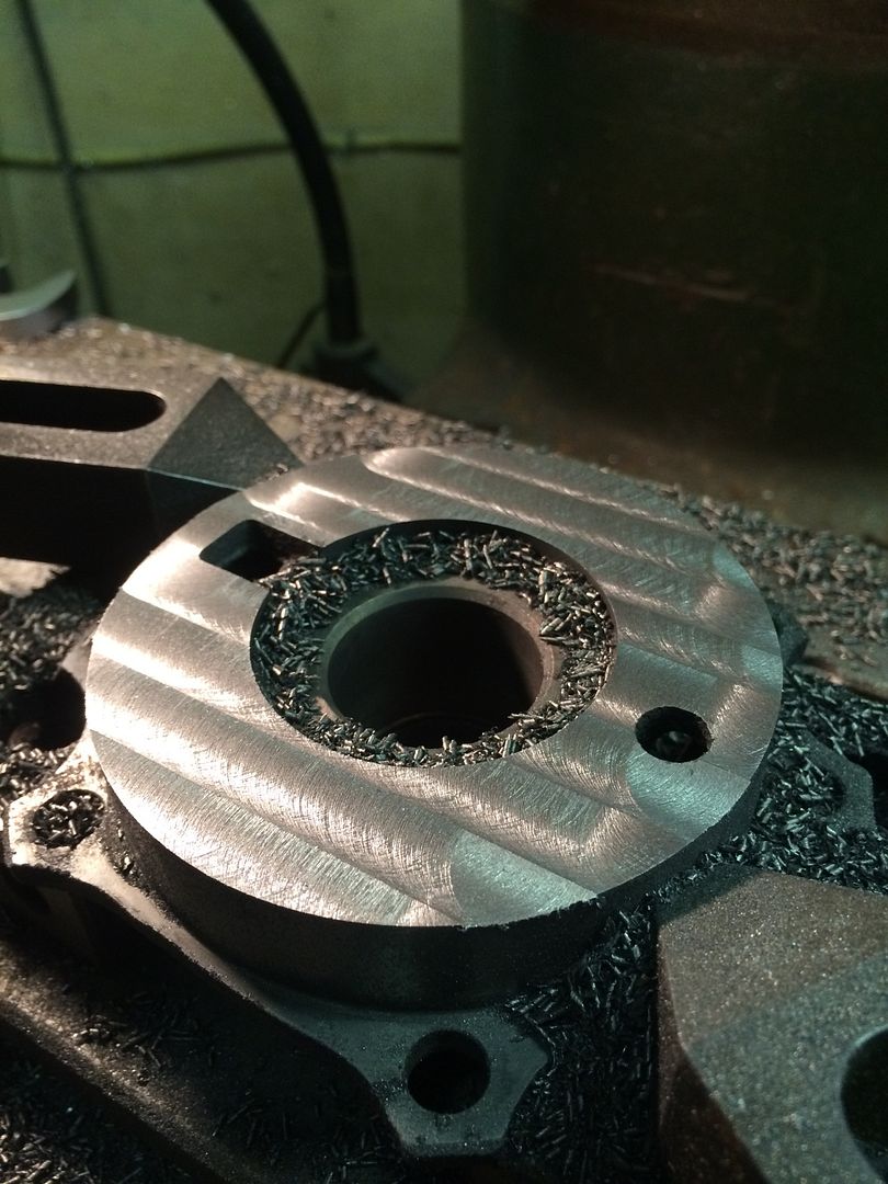

Had to mill part of my diff to accept the 2 extra clutches.
New bolts, bearings, and clutches
It's going to be a tight fit, I still plan on reinforcing the subframe a little bit more just for peace of mind.
Next step is to machine an adapter to bolt the 1350 u joint flange to my diff input flange.

-Make crossover and exhaust
