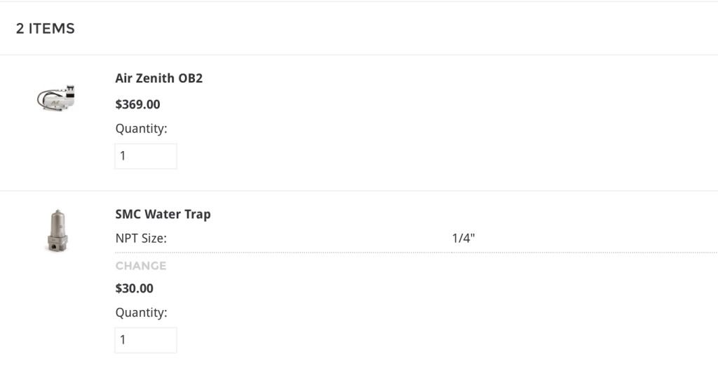

  • Oh Damn, it's Sam
    replied
    You'll need a pressure switch so the compressor knows when to turn on and off. You'll need a 40A relay (minimum) to feed an OB2, and a power wire of sufficient gauge to run it. The power wire will have to be fused with a 40A fuse somewhere near the battery, before the wire goes through any bulkheads. You'll also need a 200 psi safety valve somewhere in the system to vent excess pressure if the compressor fails to shut down at the pressure switch's off point.
    EDIT: Just to make it easy, you want this, this, this, and this. Other brands are available. Don't hesitate to bump that power supply cable to something bigger if you think you're going to run any additional electrical in the rear at any point.

  • Huynh
    replied
    About to order a couple of things. Anything else I would need?
    Basically I want to have on board air for the time being. I have plugs for all the other openings. I just need to run power to the battery. Not sure what I need to buy for that. Or some sort of relay switch?
