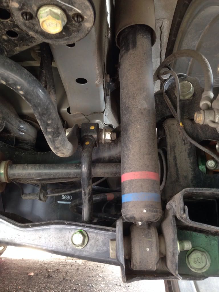

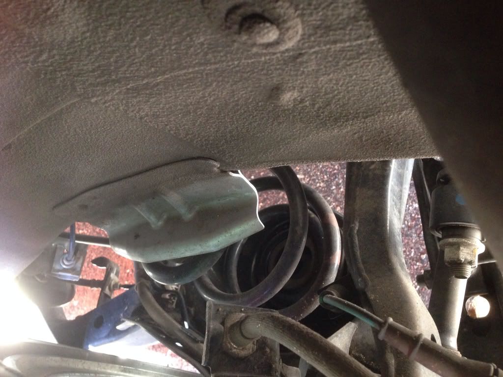

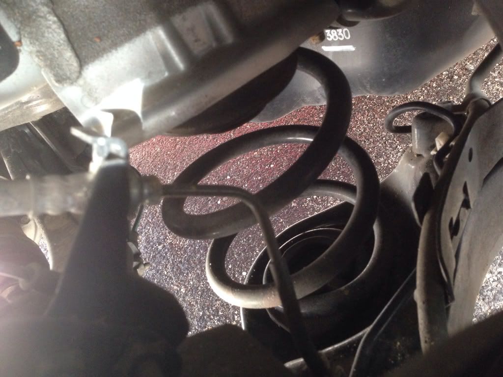

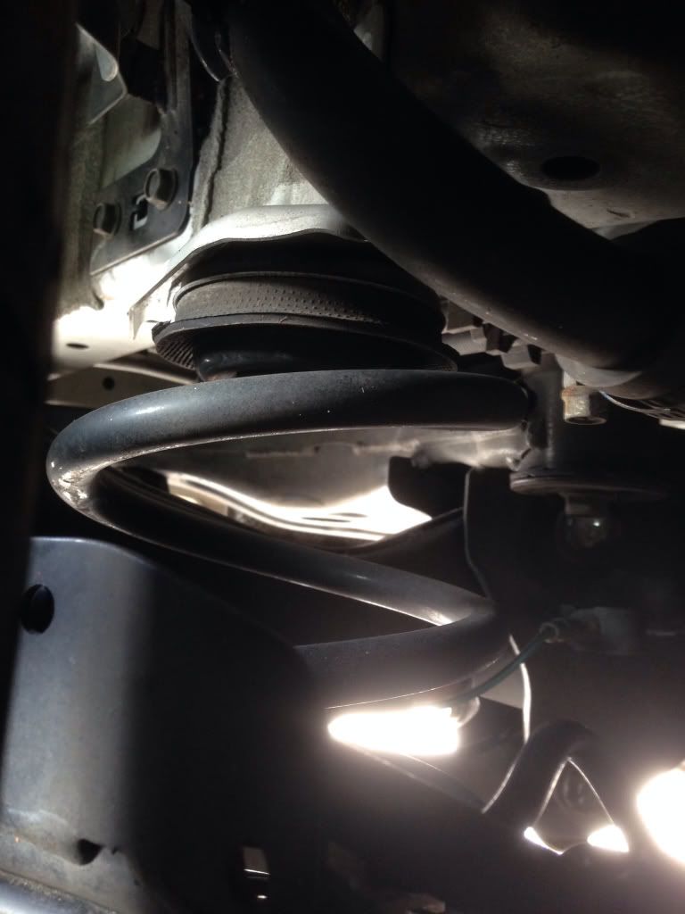

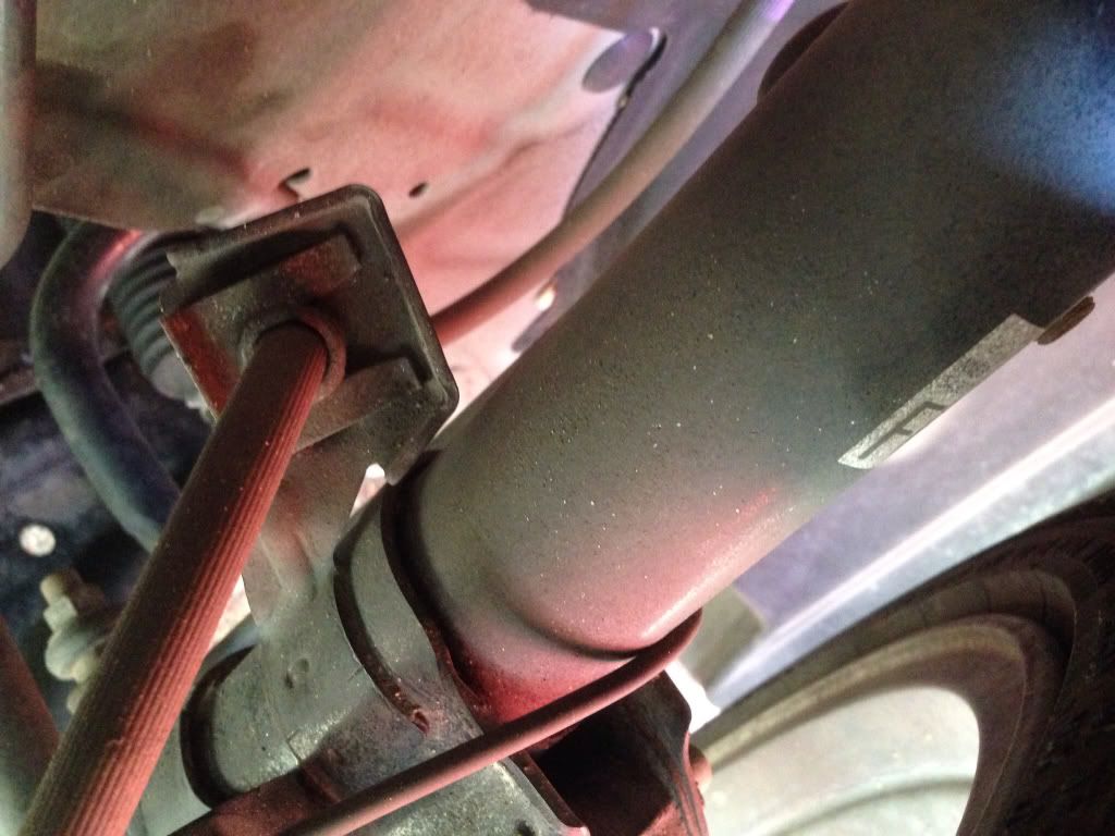

    Looks like it would be relatively trivial to fab up some bag mounts to replace the spring in the rear. Looks like a pretty wide diameter spring, so you might be able to fit something like SS-5s back there.

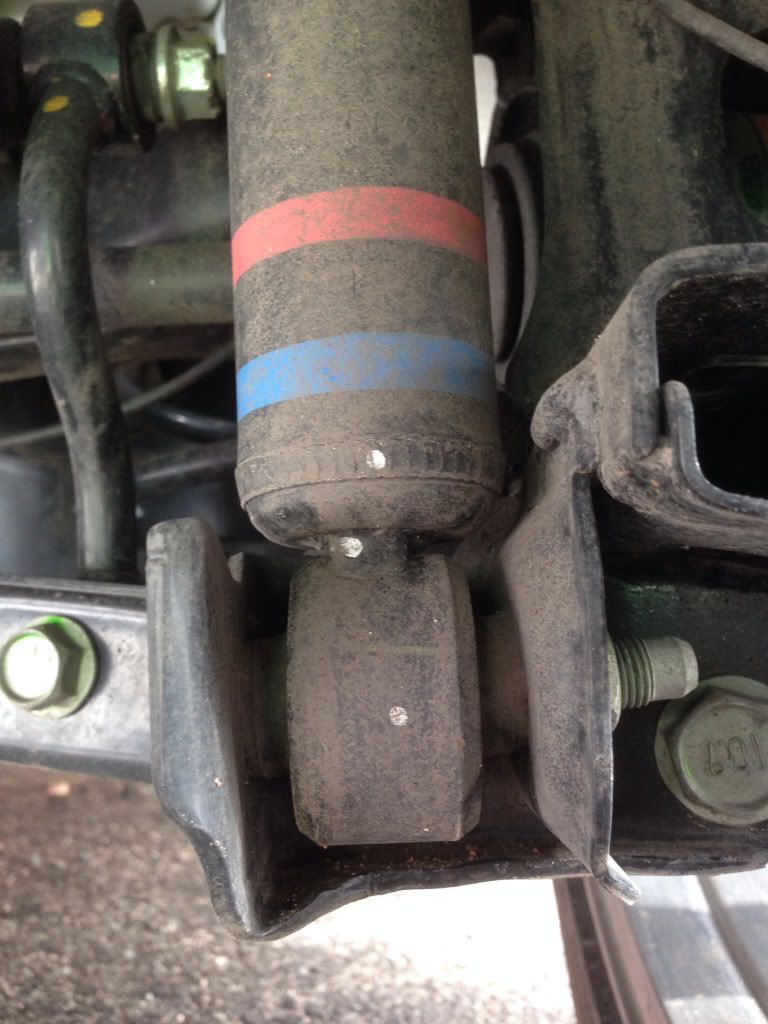

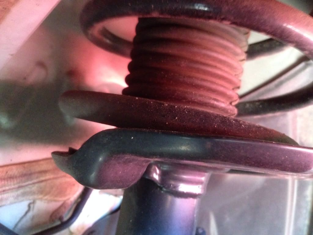

    Currently nobody makes a kit for the juke so looking into my options it seems like I would have to go with a universal setup. Or go bags over coilover setup. Still deciding which one to go with. I've been emailing a lot of companies and people about it and have got a lot of response and help from various sources. Any other feedback would be greatly appreciated on where to go from here. I tried to get some shots of what it looks like under there.

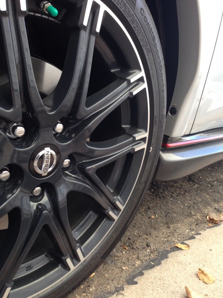

    This is the way she sits now.

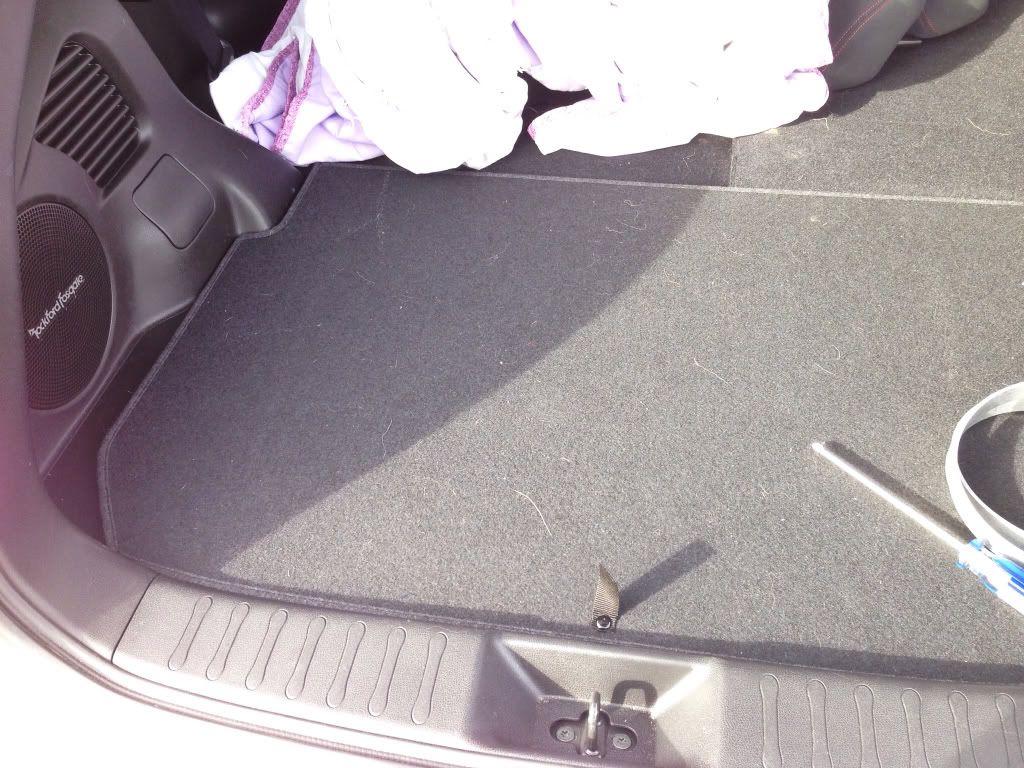

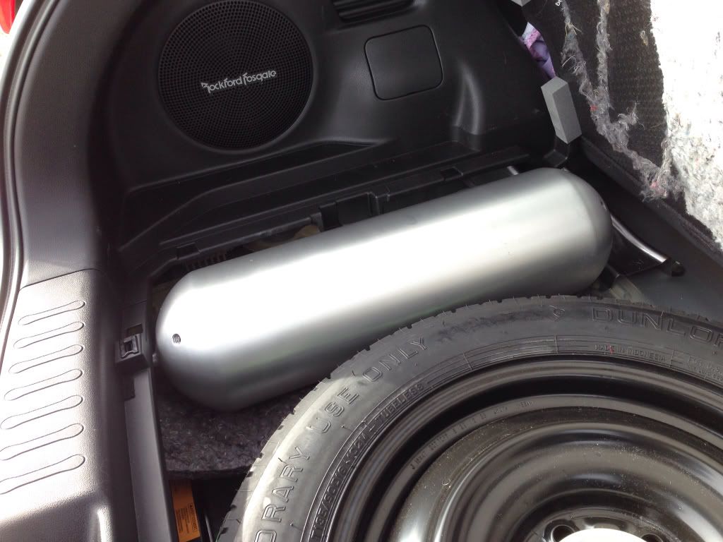

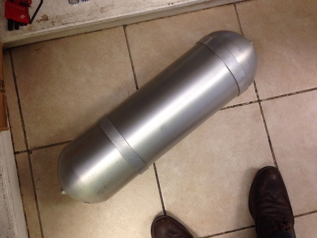

    First components purchased. Seamless air tank
    Sits perfect next to the spare.
    With the floor on, it is raised about half an inch. I wanted to go for a completely hidden setup.
    Next step is a compressor. I figured I would have on board air for the time being. Just for airing tires and whatnot. I might relocate the tank and compressor under the car though. The next components are gonna cost me more so this will give me some satisfaction on the project

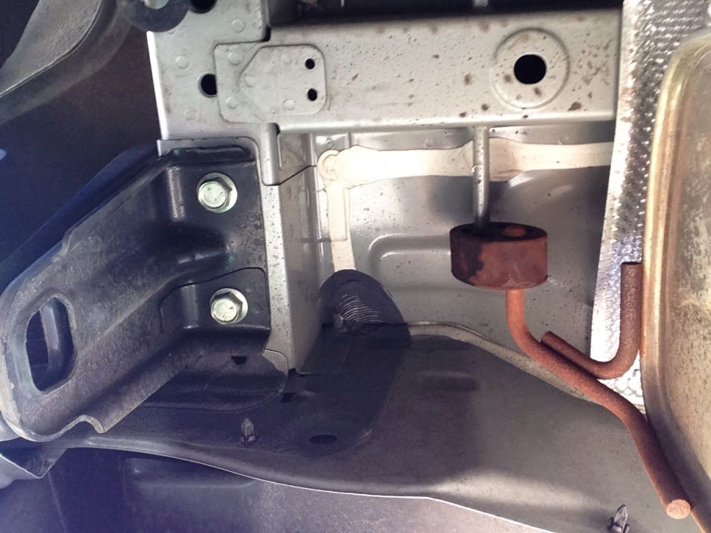

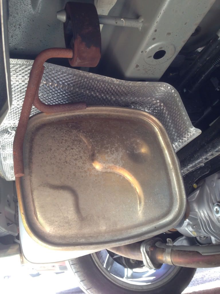

    This is the stock muffler. If I go with an aftermarket setup, this entire space is freed up. Perfect for a tank. I can mount it even higher and have it tucked more than the stock exhause would be.
    And if I remove my tow hook and custom fab a bracket I think I can squeeze a compressor to fit right next to it.
