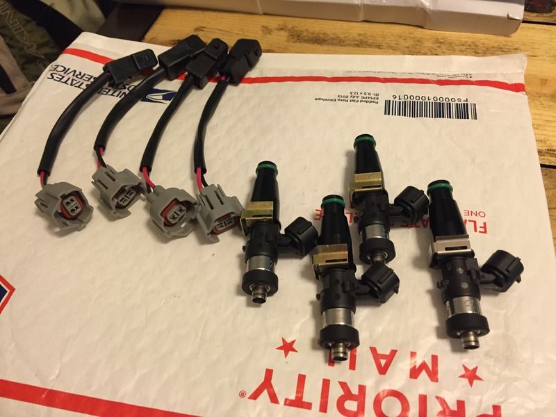

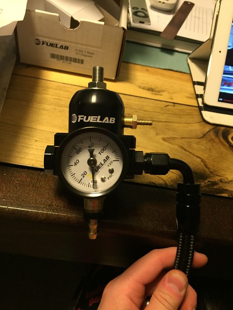

    DUCKBILL process

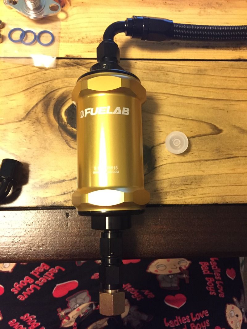

    Installed oil pressure gauge
    FUELAB fuel pressure regulator and fuel filter
    Little preview of FPR install
    RCI 2200cc
    Installed RCIs and started right up
    Still lots of work but this is where she sits at the moment

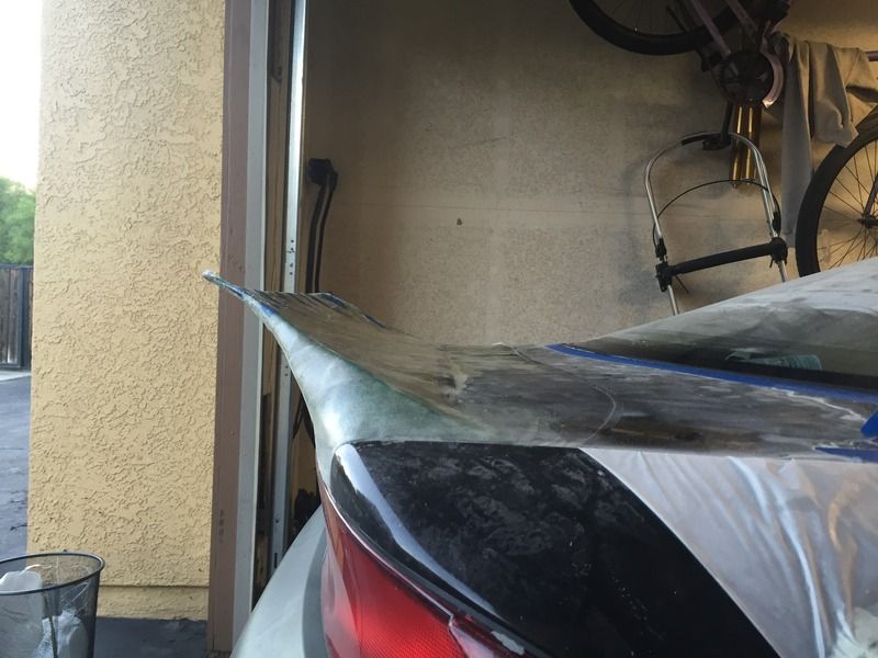

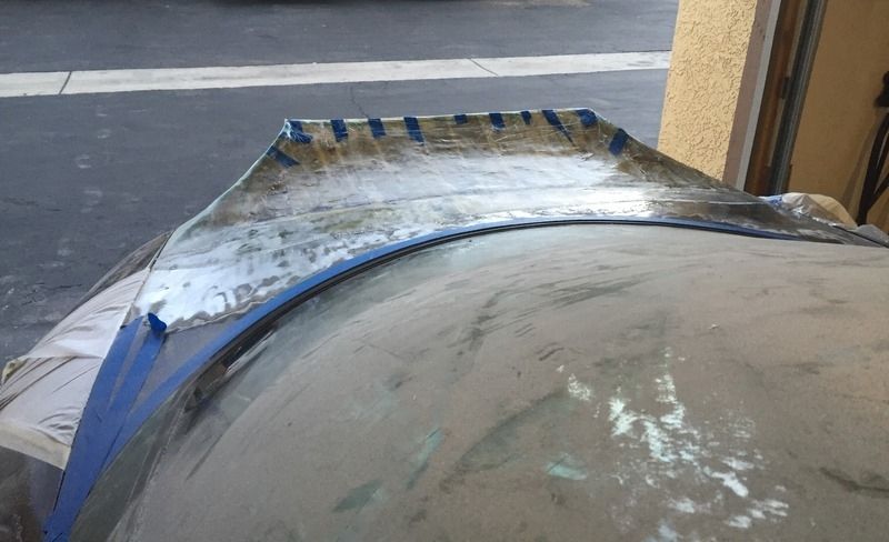

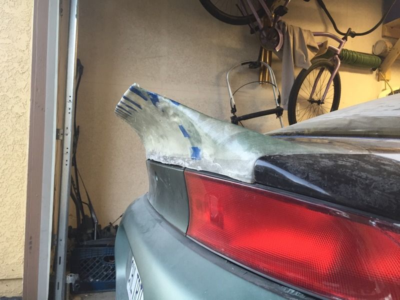

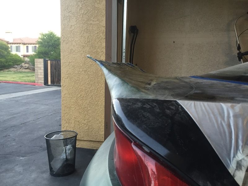

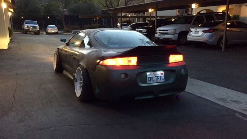

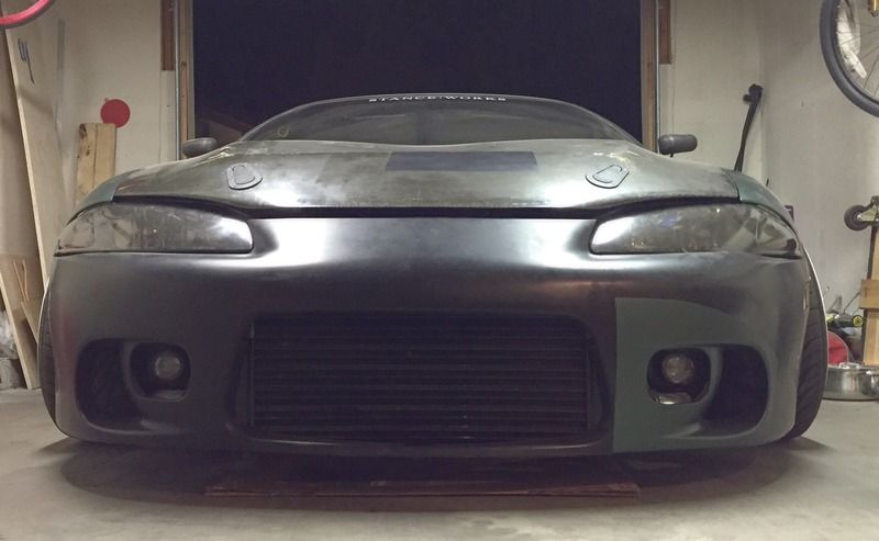

      Rad wing work, is it strong? It looks kind of thin but I can't really tell.
      I need the weed in advance i can't ride my bmx across the ocean unless im high
      • #78
        thanks, its pretty ridged, made it thin(5mm) on purpose to give it aggressive but delicate look

        • #79
          I really really like that you've gone and made your own wing, but it's a bit much for me. Draws too much attention to itself and not the car as a whole.
          • #80
            maybe you are right, but don't forget, the car is not done yet, still need to work on front fenders and quarter panels.Once everything is set and done it might tie everything together. I tried to make the spoiler to flow with the body of the car when you look at it from the side, and aggressive from the back, didn't want to make it all round and small. I built it with purpose

            • #81
              As an ex DSM addict, this is dope as hell. Duck bill is win.

                • #83
                  awsome build,look mean as f#ck. as for the duckbill, altough i admire your dedication and hard work, i dont think it goes with the rest of the car. the car is full or curves and the spoiler is hard edges. i think i bmw csl style duckbill would be perfect on this.
                  • #84
                    As a current DSM addict, I **** everything about this car. It amuses me though so I won't **** on it too much. It is nice to see something different. Just remember, different doesn't always mean it is good.

                      looking good
                      I hear you, I want something different from everyone's duckbills, I want to give it some sharp edge to this curvy body, but if you notice its only the top edges that are sharp every other line follows the curvature of the rear quarter panels, but non the less I might still curve the edges

                      • #86
                        The only changes I would do would be to take a couple inches off the end of the duck-tale. Otherwise you're killing it.

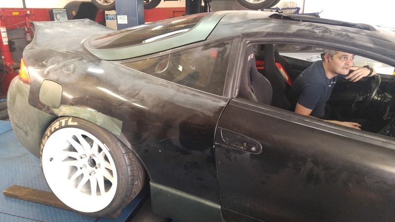

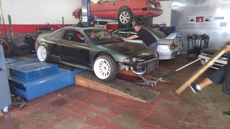

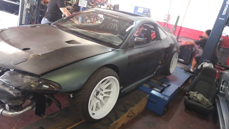

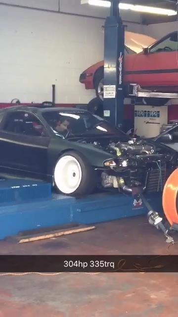

                          April 3rd, Sunday, was a great day. Was finally able to tune and dyno the car
                          It was adventure to get the car to the shop. First off all it took as about 40 minutes just to load the car on tow truck, just because driver didn’t know what the hell he was doing lol
                          Unload was less than 5 minutes.
                          But that is just half of the story.

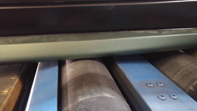

                          We get to the shop and mustang dyno is not in the ground but on top of the ground and the space between the ramp and the wall exactly 1 car length, explain that. It took us another 30-60 minutes just to get the car over the rollers and onto the dyno.

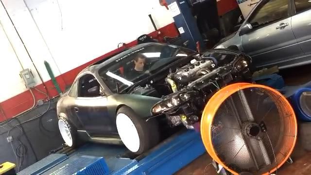

                          After everything was prepped and in place Beau aka BBR Tuning got to do his magic
                          Ran into couple small issues, nothing major, gapped spark plugs at 15,
                          As Beau began to dyno the car clutch started slipping and would not hold at higher speeds, so we were able only to get 304HP with 335TRQ on first pull, and then 308HP with 338TRQ. Not bad for shitty clutch.

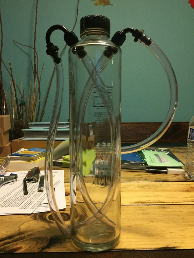

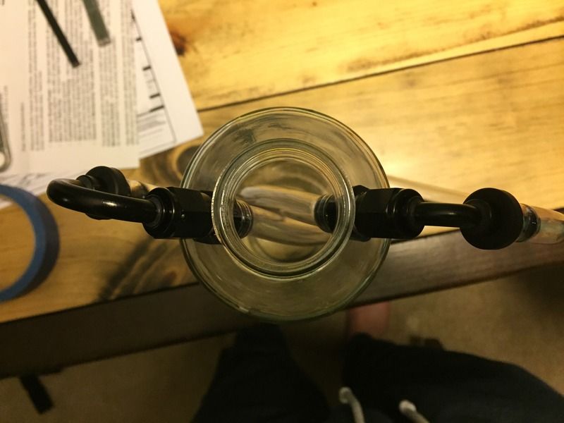

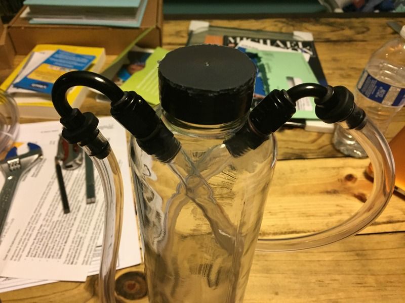

                            Decided to try something different and made coolant overflow tank out if VOSS bottle, came out pretty clean, it will be covered in aluminum enclosure with rubber layer in between. We will see how it all works out

                            • #89
                              Checking back in on this.... I'm reeling. I miss my 2G every time I see one.
                              also, here's another vote to round off that duckbill...
