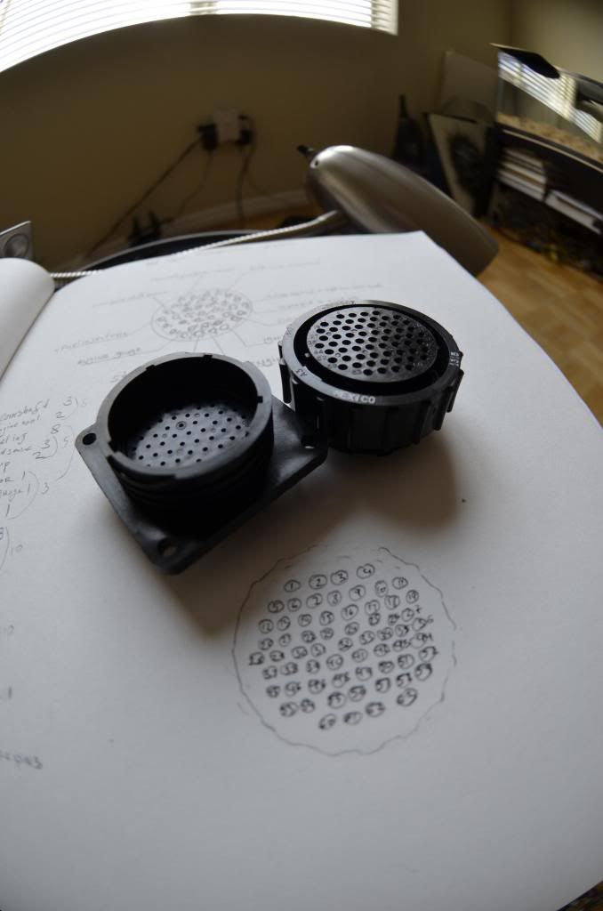

      Originally posted by LaMaR- View Post
      I gotta know man where did you get this??
      Here you go
      Allied electronics
      Alliedelec.com
      CHL TRTL DSM Zero Ground Resurection Build Thread http://www.stanceworks.com/forums/sh...ad.php?t=57509

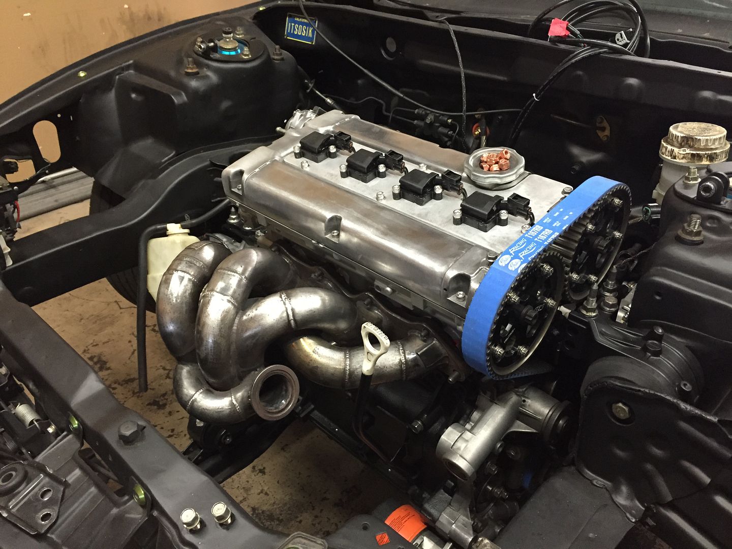

                  A little update on CHLTRTL progress
                  Took out sunroof assembly due to it wasting a lot of space, once the roof is open I am losing about 1in upfront, 1 ½in on the sides, and about 3-4in in the back, and without it’s much more open and makes the car a bit lighter, just need to come up with manual assembly that will let me slide the sunroof inside the car unlike stock way.
                  Mmmmmm best cup holder ever

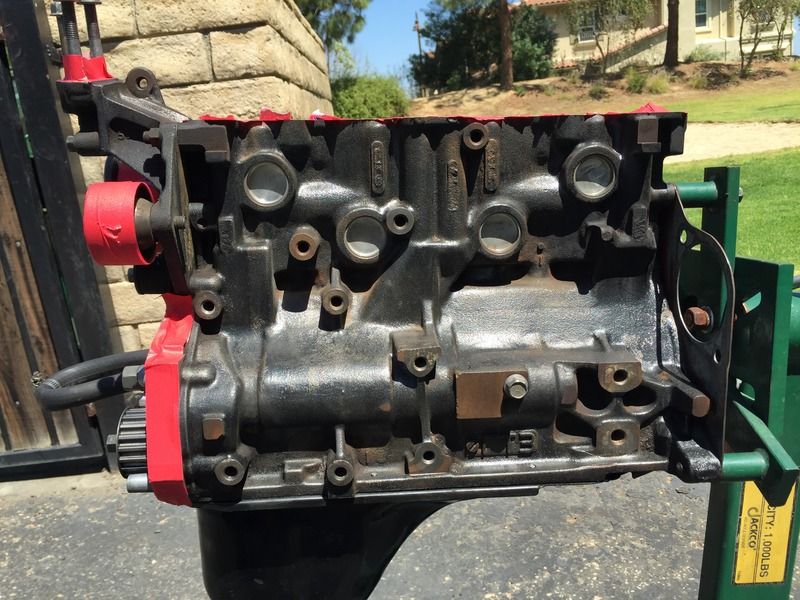

                  Pressure washed it, sanded it, cleaned it, and….
                  Gave it fresh coat of paint)

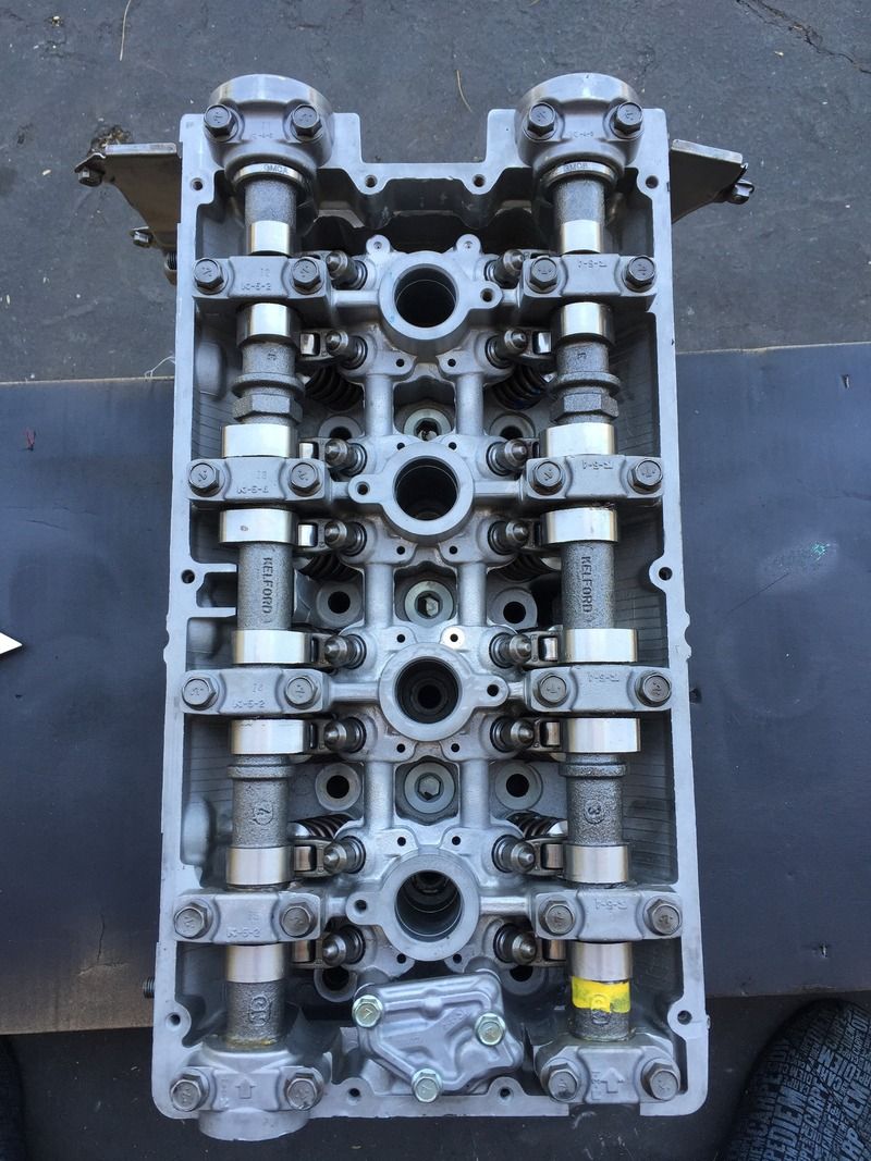

                  Threw head on, cams, Jays alt relocation kit

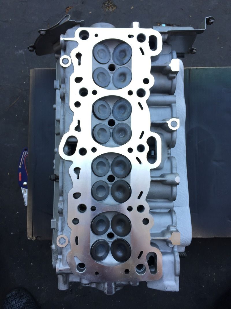

                  I am using 7bolt head on a 6bolt block, so had to drill out the holes to 12mm for head studs
                  p.s. Kelford 272/272, Super tech valves +1, BC springs, 3g revised lifters, aem cams
                  I know, timing belt is incorrect, I threw it on just to see how pretty it looks)

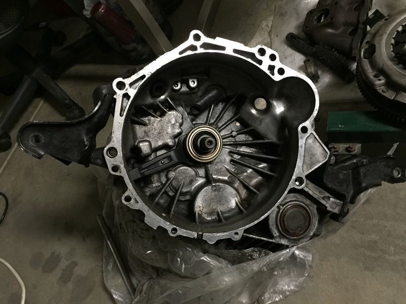

                  Tranny took a leak had to give it a bath and installed powder coated mounts with poly bushings
                  After pressure wash, sooo much better and pleasant to look at

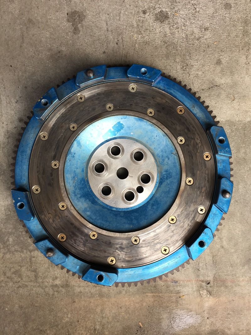

                  Aluminum flywheel

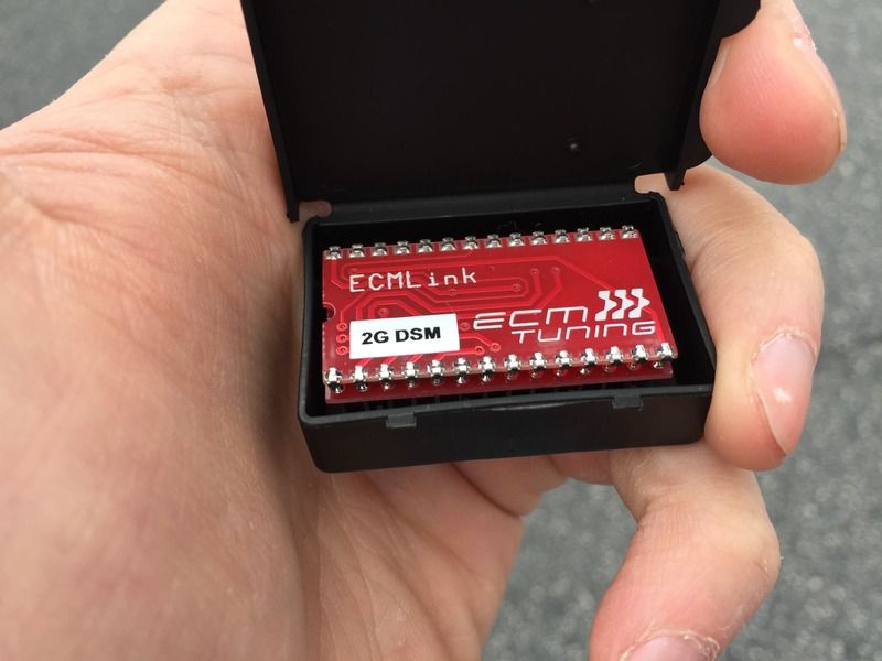

                  ECMlink

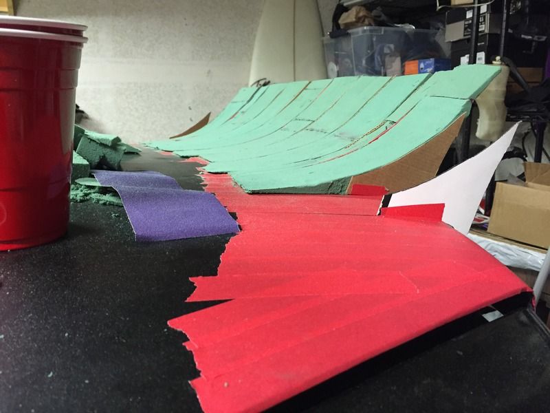

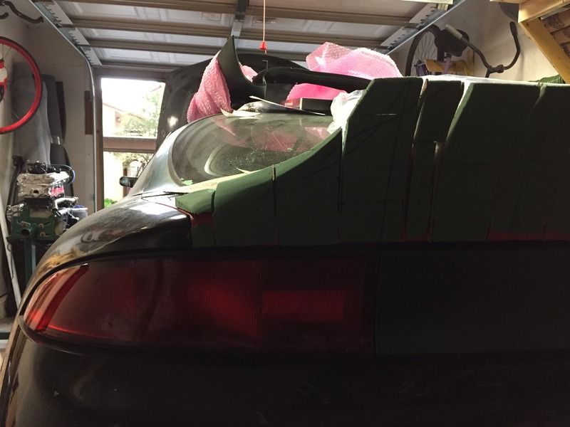

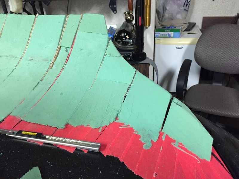

                  And last but not least, the trunk spoiler, cannot wait to finish it, should look sick
                  I tried to keep the car body lines and spoiler so it would flow together as much as possible and I think its getting there
                  Was contemplating for a while which way to have the spoiler
                  Option 1
                  Option 2
                  So I went with Opt 1, I think it has better line transition from spoiler to quarter panel, just a rough draft for now, needs more sanding, and then fiberglass
                  I like how it turns out so far
                  Till next time, should be much closer to finish this damn thing

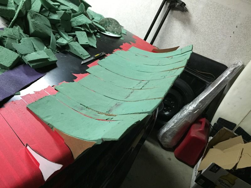

                    i'm loving these updates
                    Where did you get that foam from?
                    Sugar Mama Build - http://www.stanceworks.com/forums/sh...ad.php?t=73298
                        Got it from Michael's store, its floral block foam, very easy to work with, love it

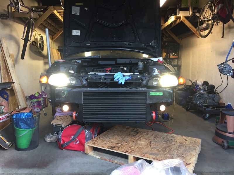

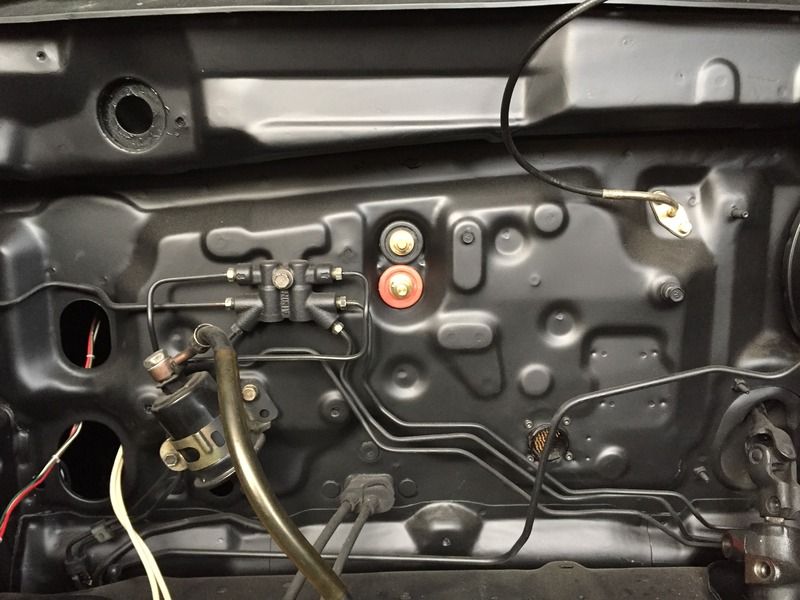

                            Before and after I redid my wiring, removed 5-6 feet of wires
                            Engine is in and wiring for headlights is on point, didn’t burn on me and works great

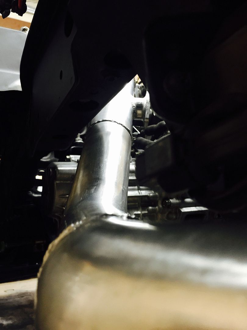

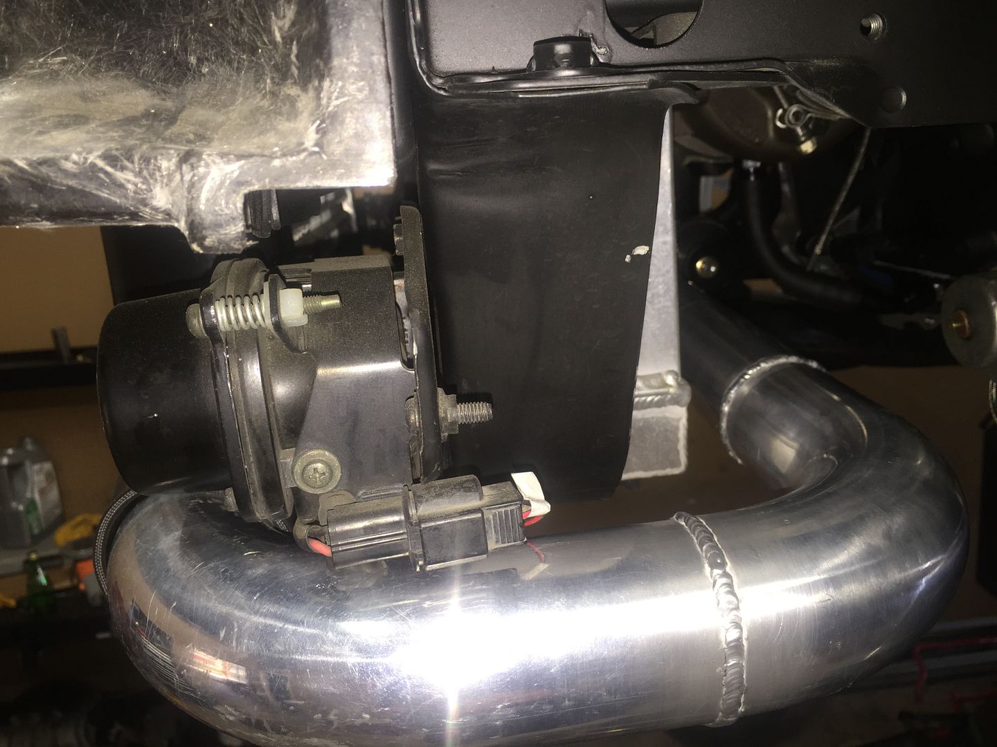

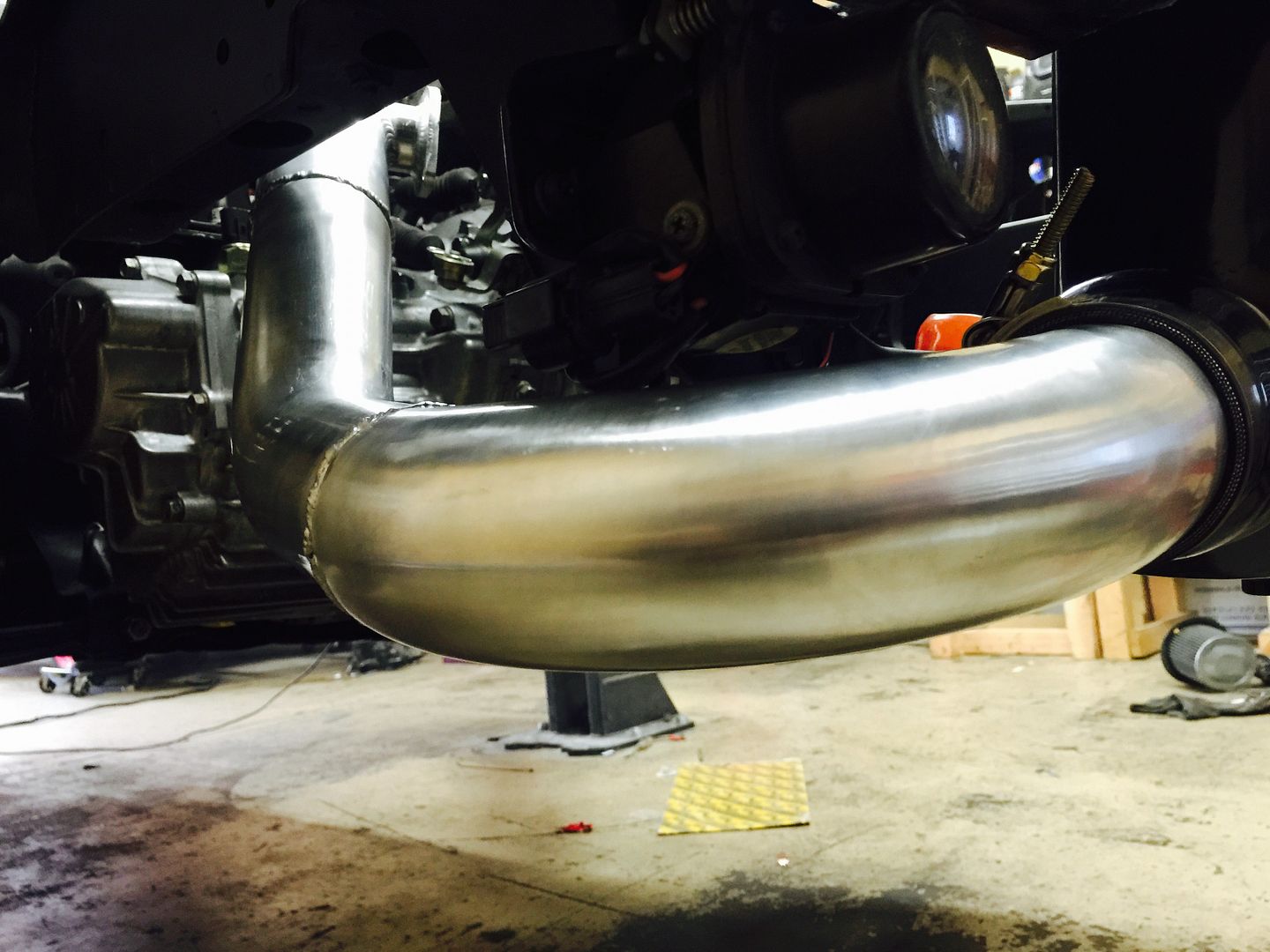

                            Custom hot side and cold side IC piping from @cmbuildz came out great, give him a follow on Instagram and hit him up for your car needs
                            MMmmmmsome holset sexiness

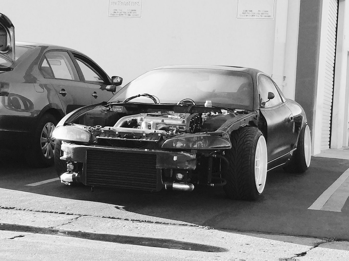

                            FIT THE CAR TO THE WHEELS, WHY NOT

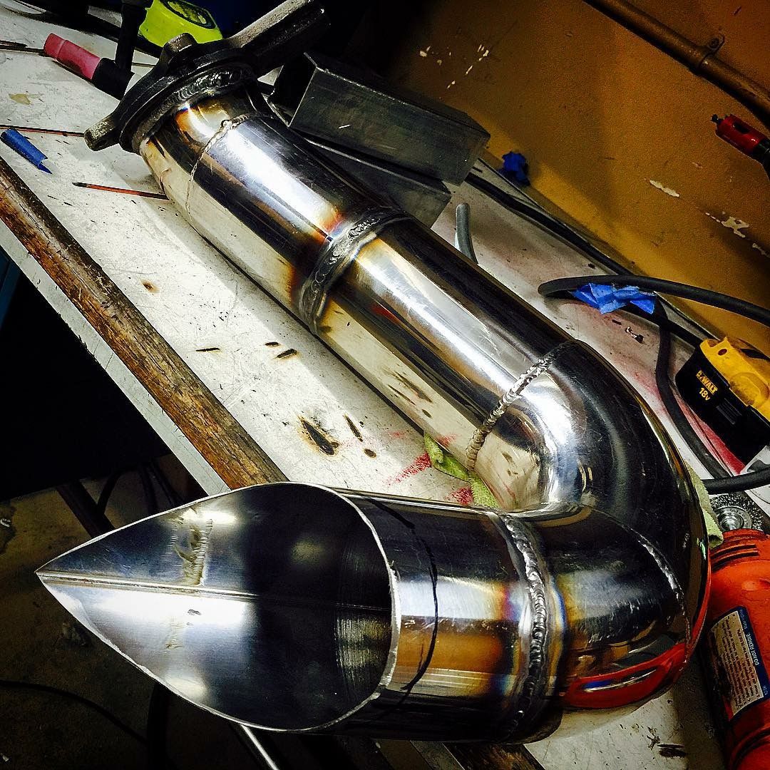

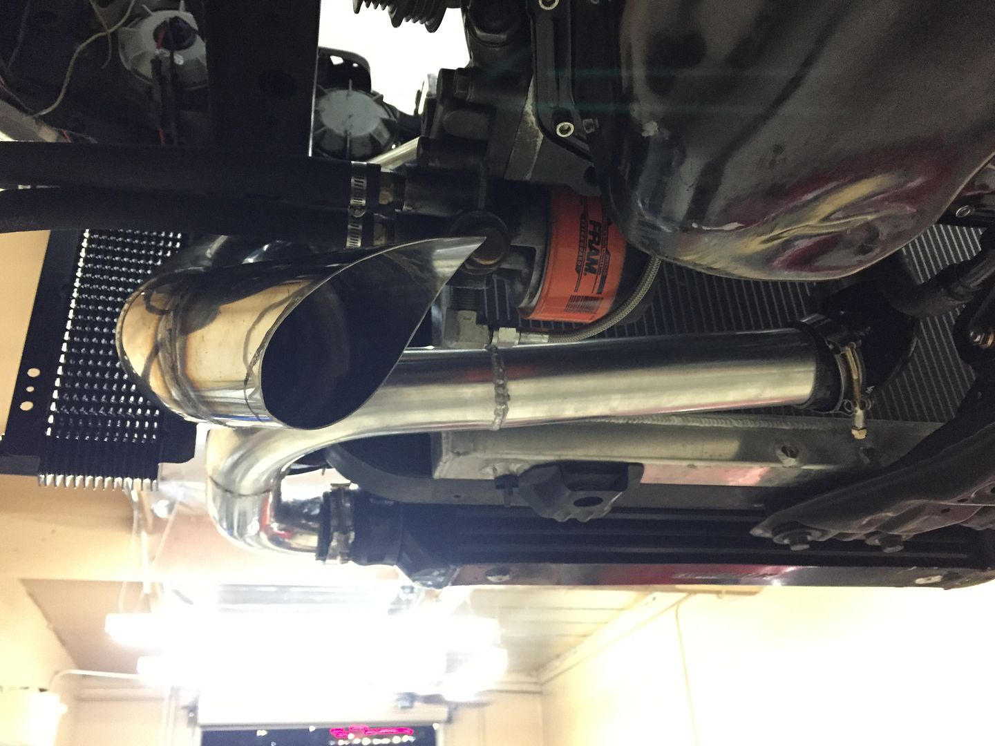

                            Sick looking Custom 4” exhaust
                            Started it last week on E85, ECU fried, waiting on it to be fixed. sounds Beastly cant wait to tune and dyno it
