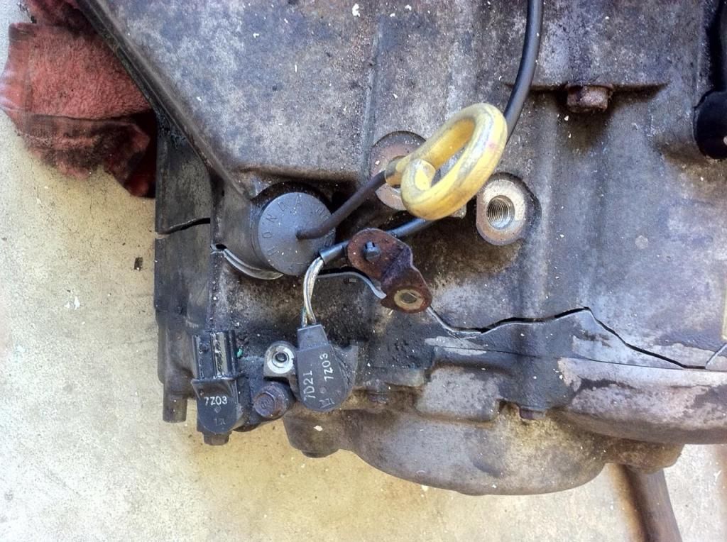

    I brought my other friend Chris over who is a really big Honda nut, and we got started on removing the B18 auto tranny from the LS motor and trying to mate it to the B20. In the process of that, this happened:
    Cracked the tranny housing. Turns out the torque converter wasn't seated properly, and the torque from the impact gun forced everything out the back end of the transmission. Chris was baffled and had never seen that happen. But he's a manual guy. I was beyond pissed.
    I'd already spent a good bit of money on parts, and I didn't feel like sourcing an auto tranny housing and having to swap it over. I spent a LONG time feeling really depressed and hopeless [my car and I are connected on another level, I swear].

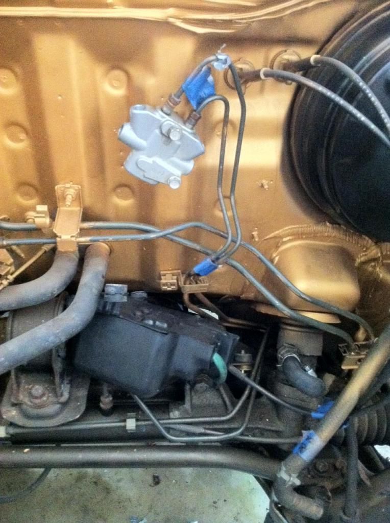

    So I had to source a non-ABS brake proportioning valve out of a 98 Integra RS [base model]. Apparently where I am, these sub models in the 98 year are hard as hell to find. Taking a trip to a local junkyard, I noticed a 98 Civic EX. The prop valve was identical to the RS Integra. Yanked that bitch off and headed home to test it.
    Bolted right into place. You can also see where I looped the PS rack to make it a manual rack. That random box is the cruise control, and will be deleted too.

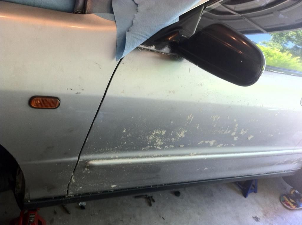

    Along with all the stuff above, I started prepping the body of the car and stripping off the horrible white paint. Some $8 cans of aircraft paint stripper from Ricerzone did the trick.

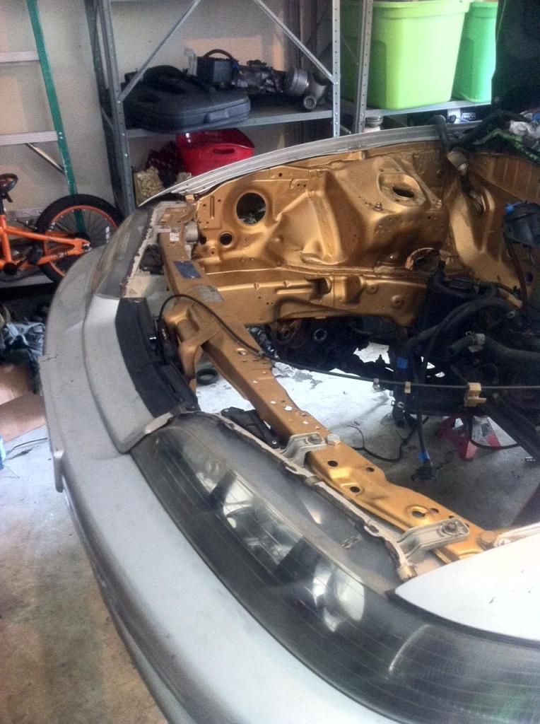

    In addition to all of the aforementioned stuff, I scored a few other good deals on parts. I got a pair of 7th gen black leather front seats from my job for $50, on top of some black leather rear RSX seats for $20. Combined with my leather-wrapped quick release and leather shift boot, it should look pretty good. I made a lot of progress on the engine bay. Got it fully painted and tucked. Just need to order new hardware to replace a few rusty nuts and bolts, then that'll be done.
    Gold all in my bay

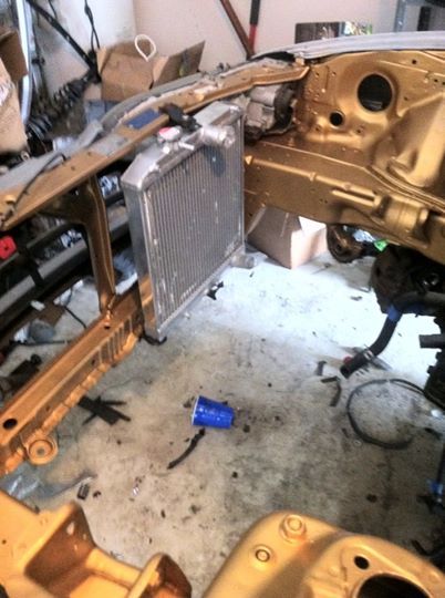

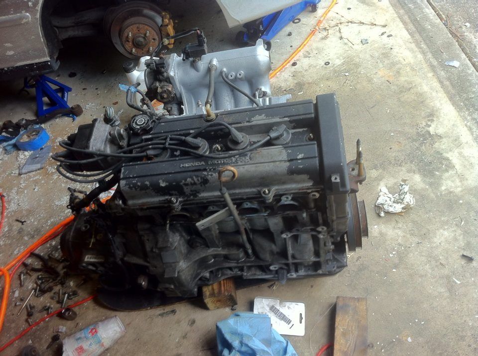

                    Finally got my motor fully assembled. Every single step had some sort of snag or complication, but I finally got it all together. Now lets pray to Zeus she runs when I turn the key...
                    JDM B20B with P8R head all stripped and cleaned, B16A tranny with Kaaz LSD, auto to manual conversion with brand new Exedy clutch, flywheel, starter, distributor, motor mounts, ECU, and a bunch of other shit that added up.
                    Bay prepped, rad installed
                    Motor going in tonight. I had a bunch of shit show up in the mail and more arriving this week. The updates will get progressively more better and stancier over the next 2 weeks. Stay tuned and lay off the Hatorade.
                    Edit, yes I know my garage is a mess, sue me

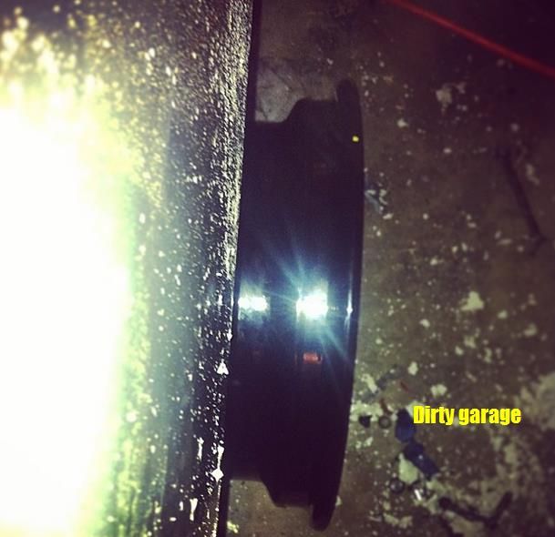

                                But the biggest update is that I finally decided on wheels, and they got here last night, and I fitted them to the car, and I lost my shit, and I'm kind of scared now.
                                15x8 -38
                                Pardon the peeling paint, I'm doing bodywork at the same time, and stripping off the old paint.
                                So yeah, I think I went a bit too aggressive, and my math might've been just a tiny bit way the fuck off.
                                I dunno what to do now.
                                I guess I'm going to have to do a gnarly pull and all the negative camber. I kinda wanted to avoid excess camber, but I guess yolo, I'm stuck with it now.
