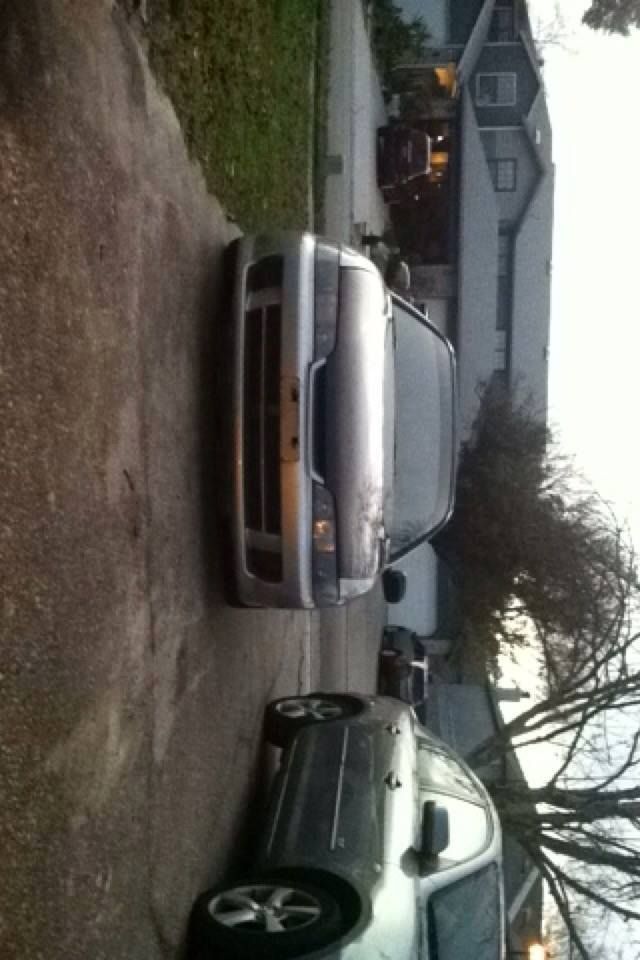

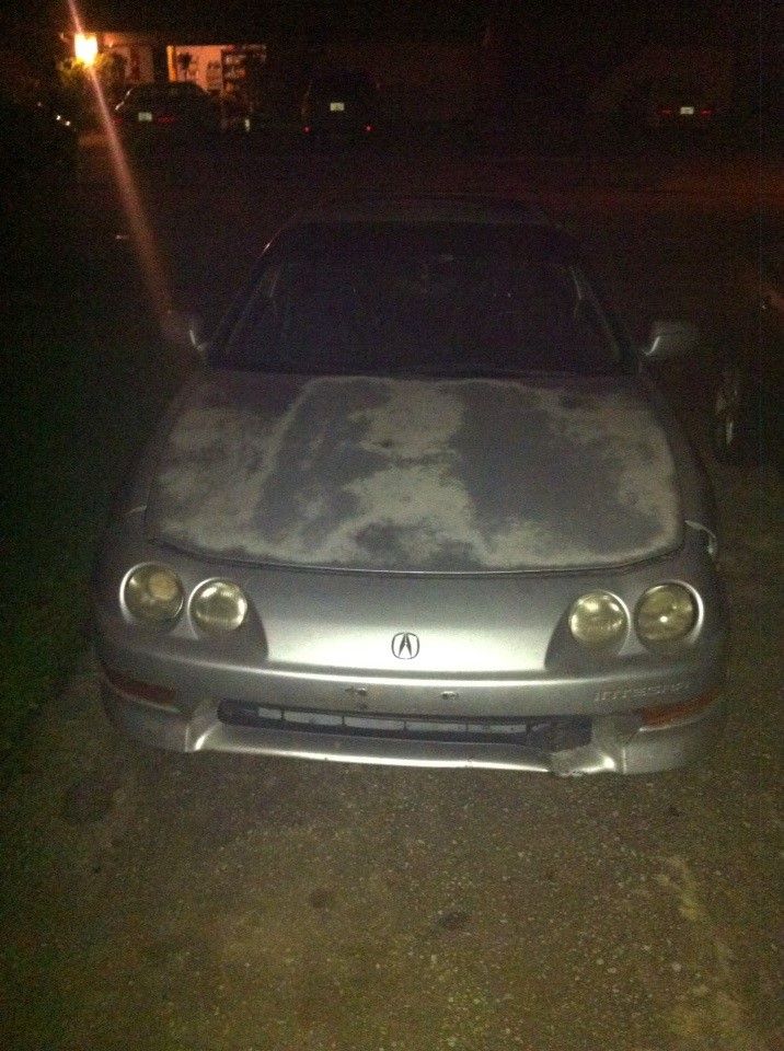

    So first, I bought the car a while ago. Got it for a grand as a new DD since my Aurora took a dump. Ran and drove fine, mechanically was very sound. Previous owner did a lot of dumb shit to it [discussed later] and slid it into a guard rail. So I bought it with the driver's side front end caved in. Very very minimal frame damage, which straightened out decently.

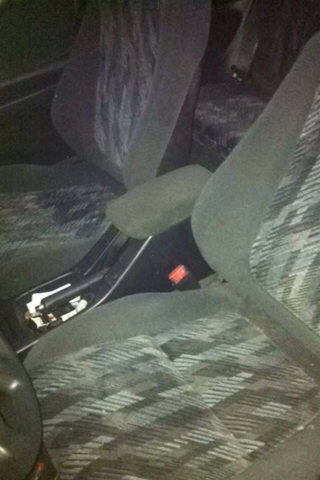

    The interior was clean as fuck too. All OEM, which I liked.

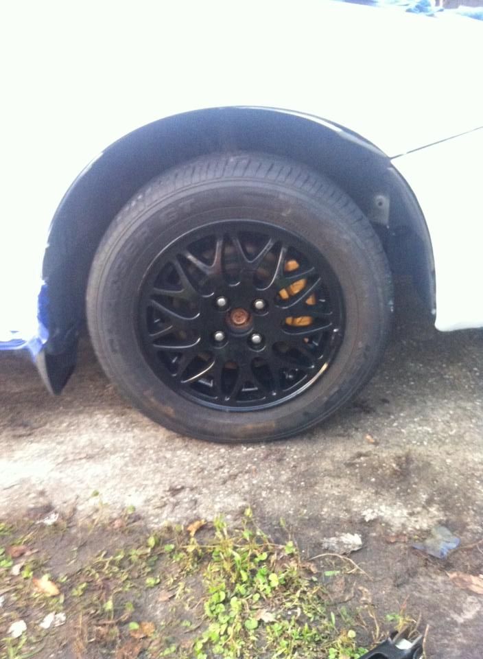

    So the first thing to do was remove the fugly Konig 15's that came on the car with tires balder than Vin Diesel. Replaced those with some OEM 14" 'sunflower' wheels from a 98 LS Integra. Promptly painted those black. Did my tiny-ass calipers in a color you'll see again soon.

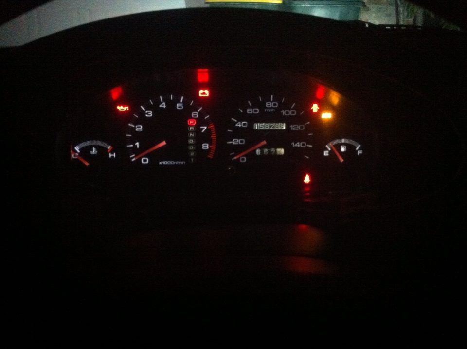

    Then I did a pure white LED gauge conversion to get rid of the ugly incandescent yellow on the dash. Very nice.

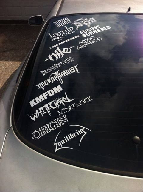

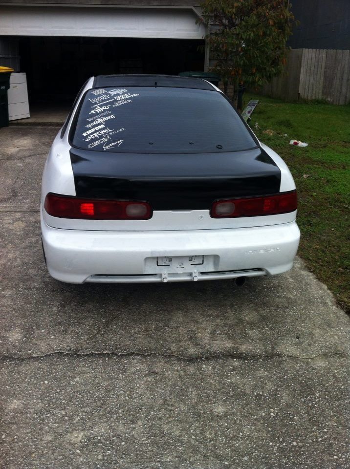

    After that, I decided to use a few metal band vinyl stickers I had and do my own take on the "JDM YO" "HONDAZ RULE" "2FAST4U" etc stickers commonly seen on the rear windshields of import cars. I like it.

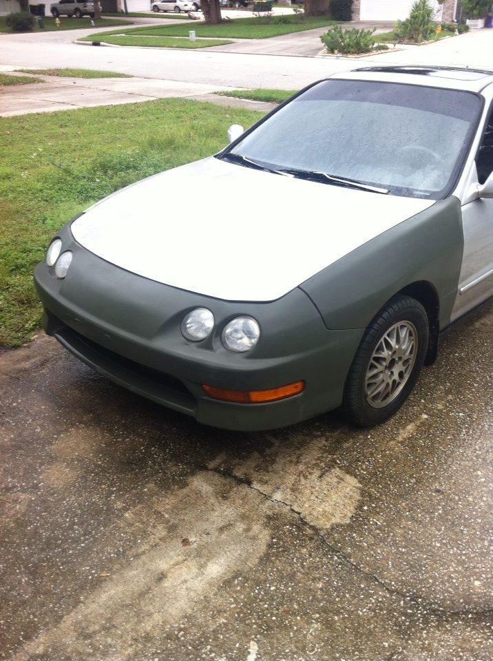

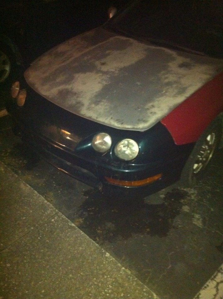

    Next was replacing the caved in bumper and fender. Got them from 2 different cars and the multicolor was killing me. Was testing a potential color for a bit, flat OD green, before I decided I ***** it.
    Painted those parts the OD green:

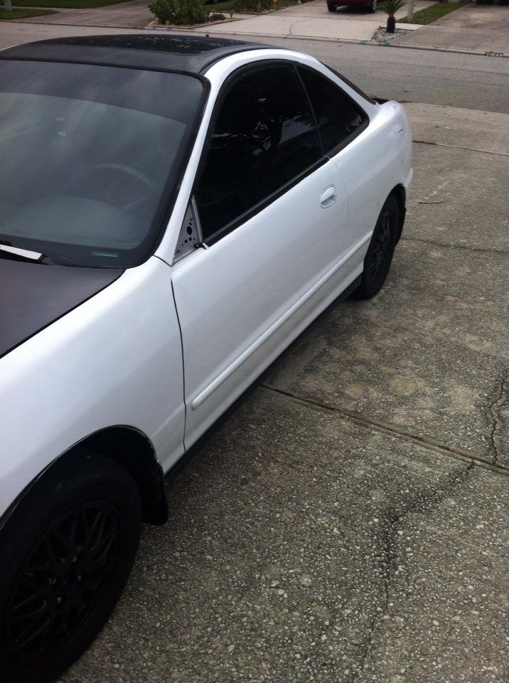

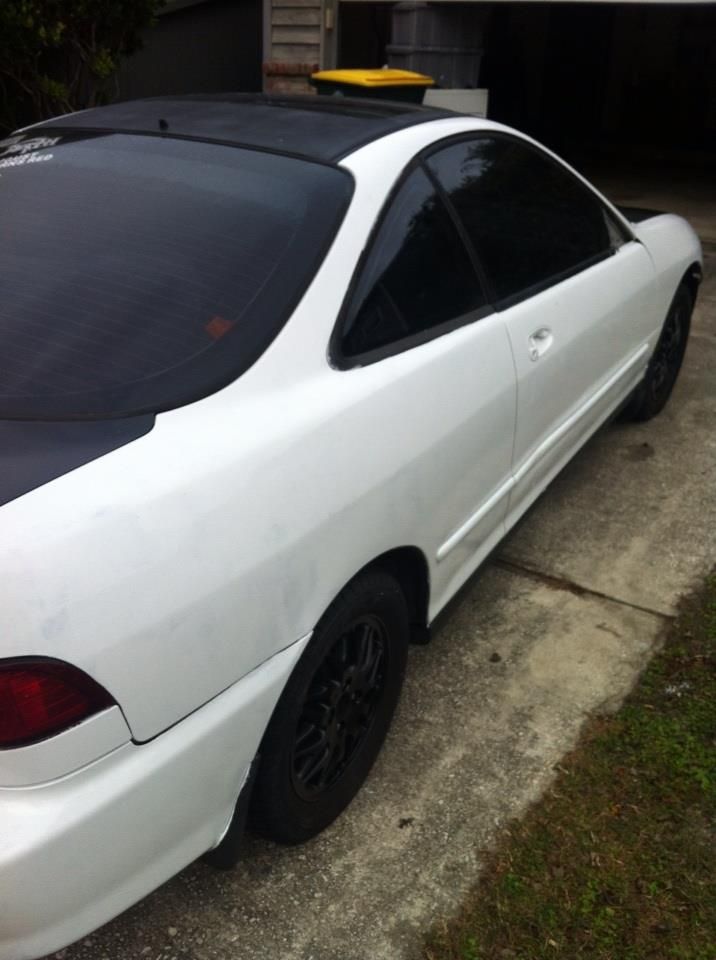

    So I painted it gloss white with a black overlay.
    That's me!
    Looks good in the pictures, but I very hastily painted it with cheap paint, and now I'm regretting it. New BC/CC is on the way, along with a nice gun, so she'll get a good job soon. She stayed like this for a bit before I decided that I really love this car and took a huge step forward.

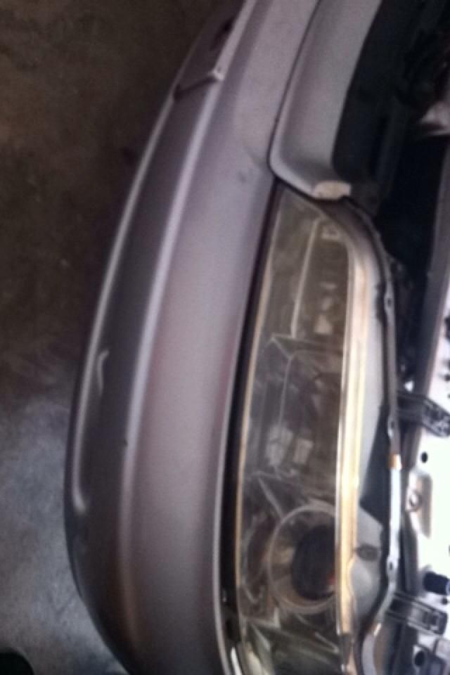

    Normally, these front end conversions with fenders, headlights, hood, bumper, and radiator support run upwards of 1k+, usually in the 1.2-1.4k range. Since this was before I landed my current job, I was working side jobs saving money for my car, and I didn't want to drop over a grand on just a front end.

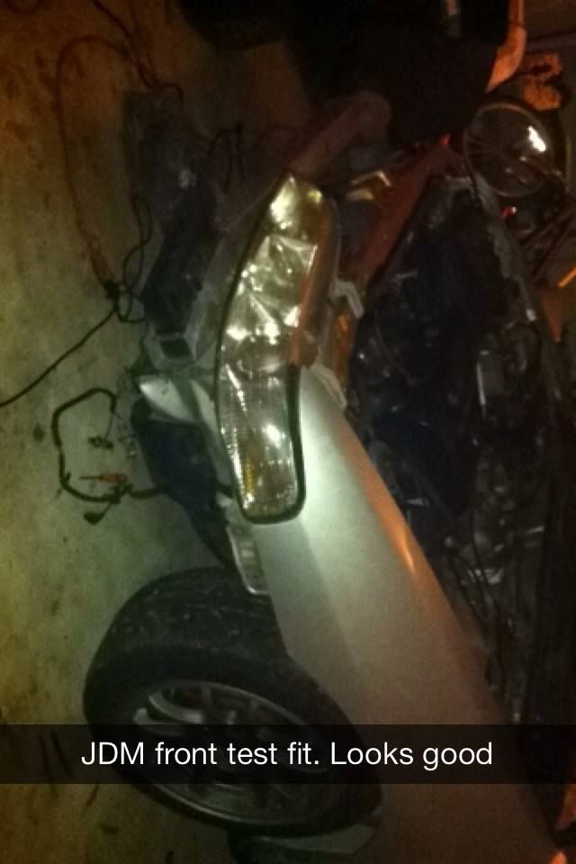

    As luck would have it, I stumbled across a JDM front end, sans hood for a WICKED deal. I immediately snapped it up, shoved as much of it as I could in my hatch, and took it home. I started tearing it down and testing fitment of the fenders and bumper on the USDM support. To do this conversion, one must drill out all the OEM spot welds [all 70+] and weld the entire JDM rad support on. After doing hours of research, I came across what's known as the "T-bar" method and the bolt on method. Basically, the only differences with the USDM rad support and JDM rad support is the bar for the headlight attachment, and the bumper support. Well the JDM bumper support bolts directly to the USDM rad support. That was easy. All I had to do was drill out the T-bar spot welds on the JDM radiator support and remove that assembly.
    Boom.

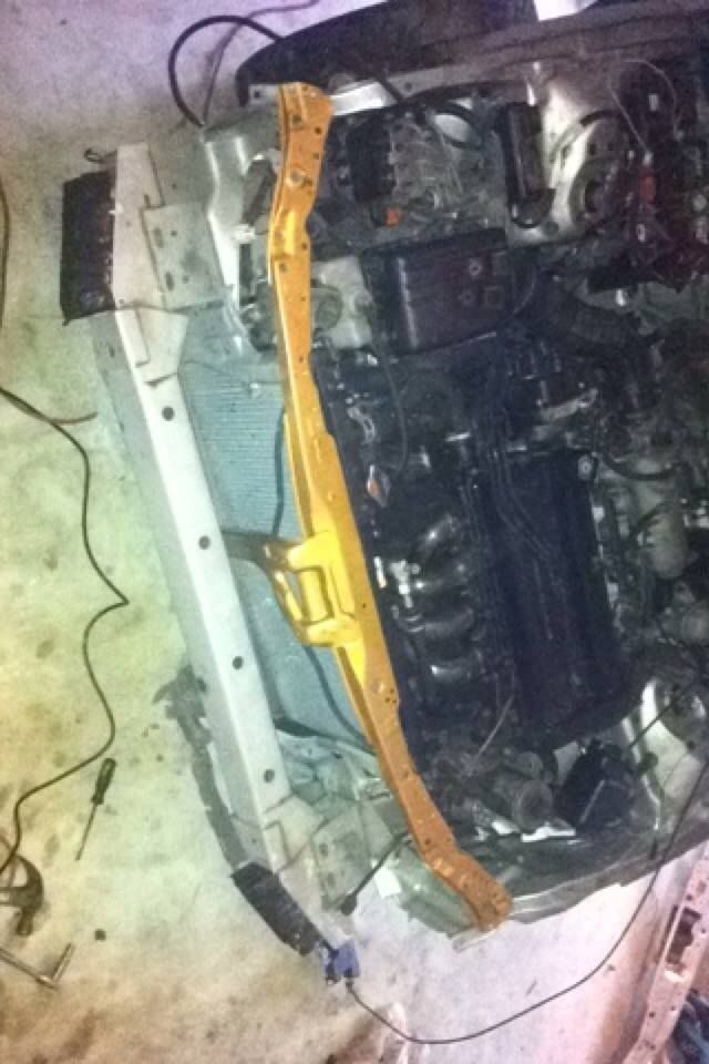

    After that, install was easy. Align to the USDM frame and rad support, mark, measure, realign, bolt down, tack welds for reassurance, and boom, done. It pays to do your research.
    Painted gold, just like my calipers and the rest of my bay in the future.
    Another plus for the T-bar method is the OEM spot welds are still in place for the rest of the radiator support, which means it's a lot stronger than new welds. I know of and have read about people who do this conversion and replace the entire radiator support, only to have the front of the car crumple up when jacked up from the front. Mine's just as sturdy, if not sturdier, than it was pre-conversion, tried and tested.
    Everything lined up real well with only a few minor issues, as to be expected.

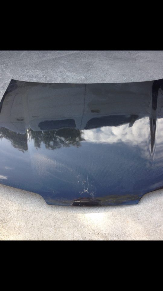

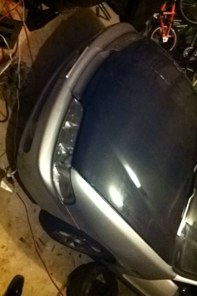

    While I was doing the front end, I was frantically searching for a hood. Found one locally for $200 AND it was carbon fiber. Had it delivered to my garage.
    Good deal, if you ask me.
    An afternoon of sweating, cussing, and ratcheting, and:
    Aw yiss.

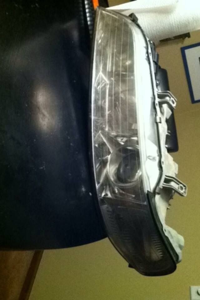

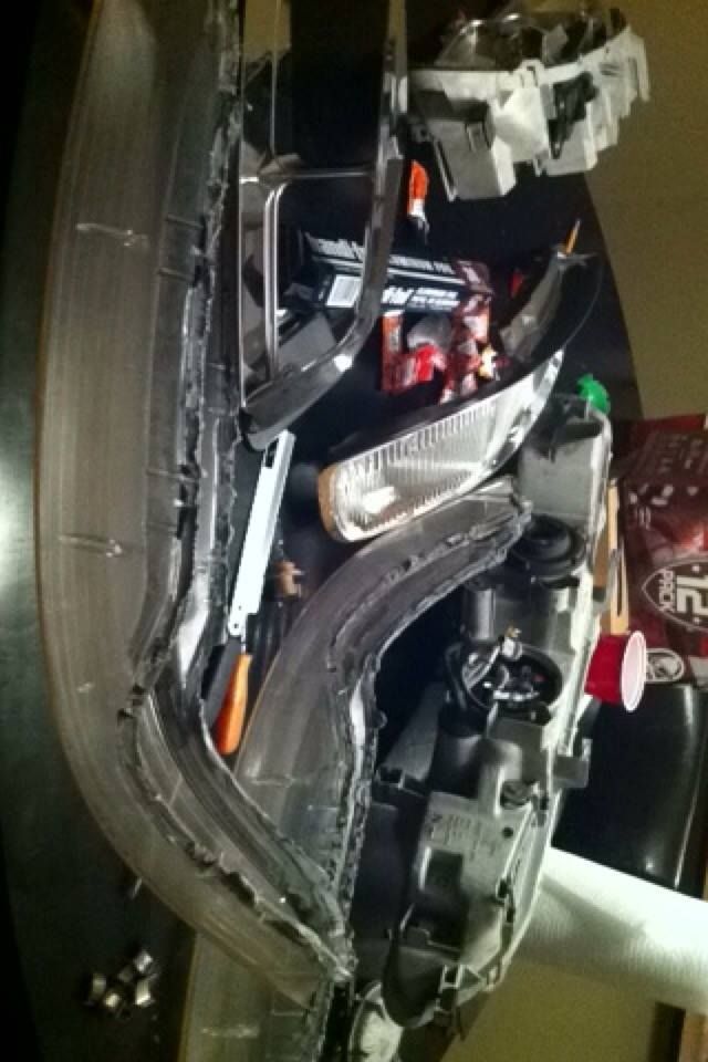

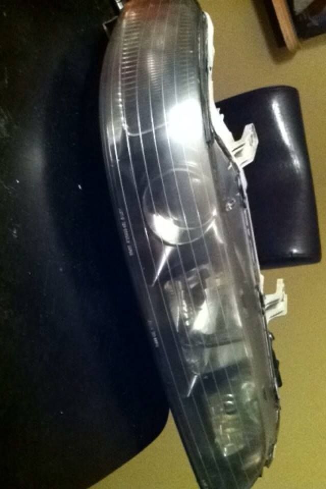

    In Japan, there are multiple trim levels of Integra [SiR, Sir-G, ITR, and some others I can't remember] just like in the US [RS, LS, GS, GS-R, ITR]. My conversion came off an SiR. That's basically the equivalent of the LS here. The distinctive feature is the all chrome housing projector headlights. Higher trim levels in Japan had black housing headlights, and even build in HID's! I decided I liked the look of the black housings, and did it myself.
    All chrome everything
    Whoops I broke them
    Erection.

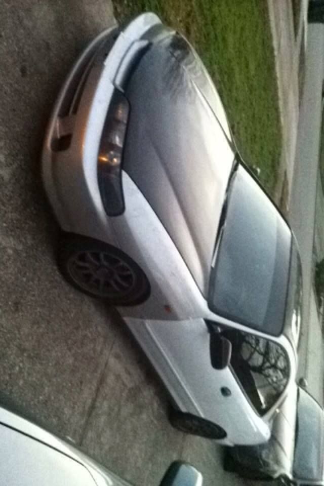

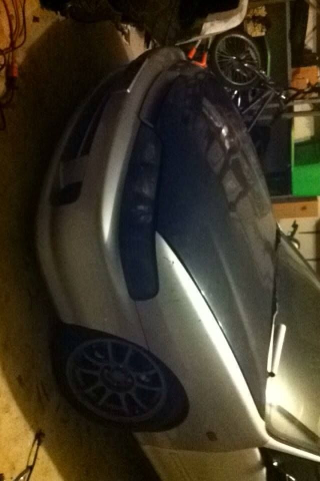

    Then I slapped them on the front end, bolted everything up, and she was lookin sexy!
    Before with chrome housings, then after with black housings:

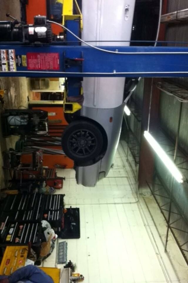

    Right before I started the JDM conversion, my buddy Chris and I took a trip to a local salvage yard during a 50% off everything sale, and we spotted a Miata with a bunch of Miata goodies for Chris, but I had my eye on the wheels. They were hella mad JDM tyte legit track wheels in 4x100, which is my bolt pattern. Picked them with with good tires on all 4 for $90 out the door. STEAL.
    15x7. No Fast & Furious 18" wheels here. I have plans for fancier wheels in the future, and more aggressive offsets, but these will tide me over more than enough until then.

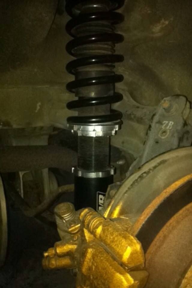

      After the front end conversion, I bought some nice adjustable coilovers for maximum lowz yo. But then, my horrible luck kicked in harder than VTEC.

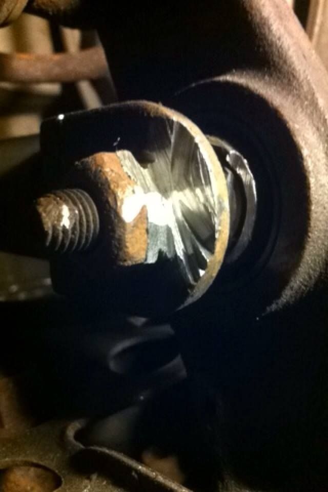

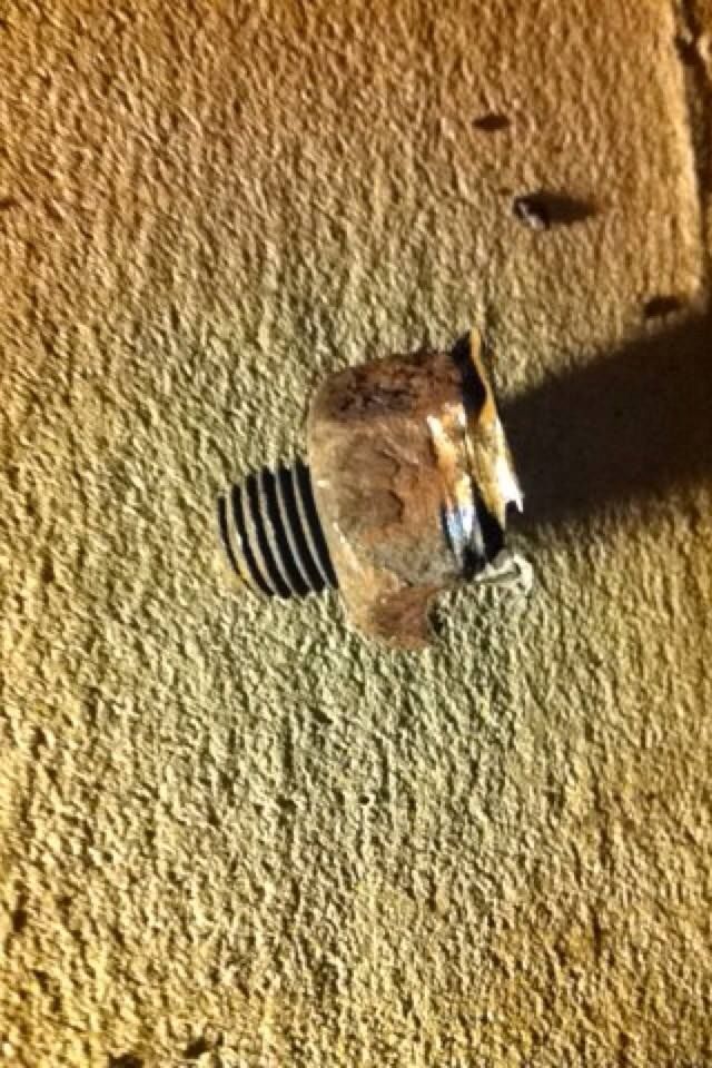

      My car came from the north. And the north = rust. And hot damn, did I have some rusty-ass bolts. Broke the heads off both rear lower control arm bolts trying to remove the stock struts.
      My friends/henchmen/slaves Chris and Eldin came over to take part in the nonsense and we ended up trying to grind the bolts out with my Dremel. But that can only do so much.
      This blows.
      Then I said "fuck it" as I always do, and bought an angle grinder.

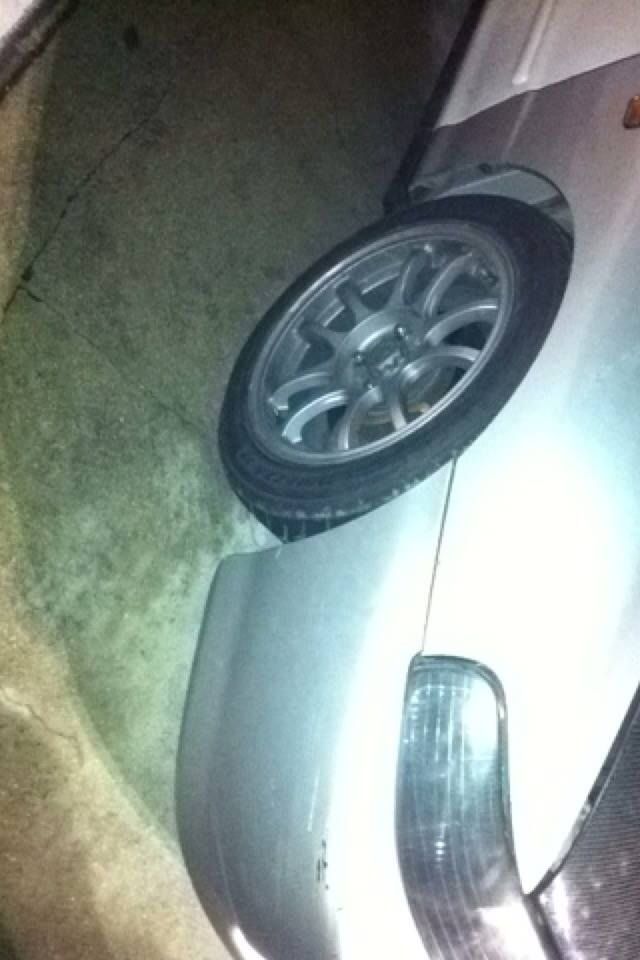

      After all that bullshit, I hacked off the rusty blown OEM struts and got a good drop with my coilovers [which I got for a steal too!]
      Plenty of room to go a lot lower [and I plan to, trust me]

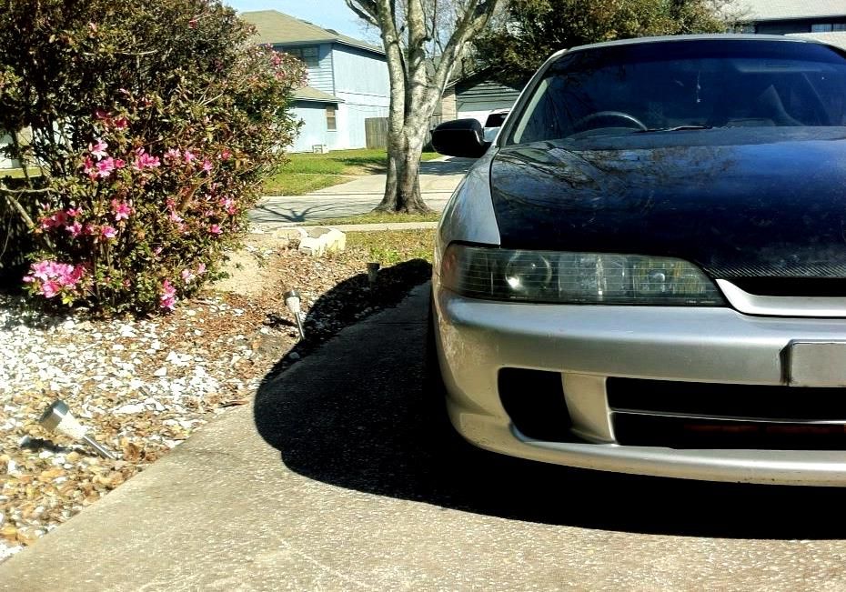

      Loving the new look, loving the stance, loving being so incredibly JDM. Did some last minute BS and rolled out to a meet that Saturday with my buddy Eldin.
      First time being driven in over 3 weeks.
      Took a few shots of the car with the new front end:
      My photography skills are improving

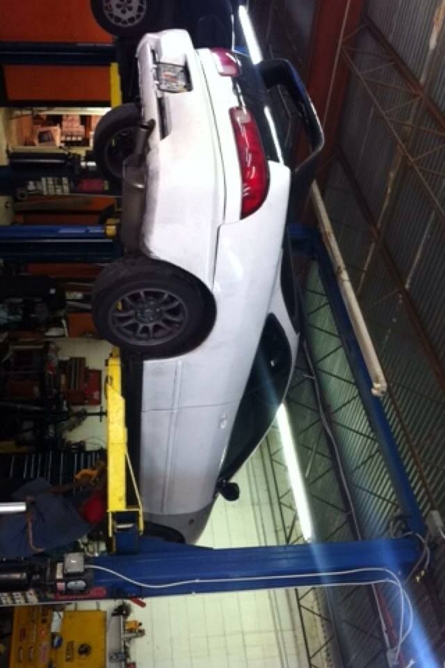

        Then the issues with the exhaust popped up more. I bought the car with a funky manifold and a bit of a leak, but I dealt with it and put it off for later. I got used to the sound and really didn't notice it until my newly lowness cracked said header and turned my car into a monster big block V8. Or at least it sounded that way. I began dumping fuel, running pig rich, and throwing check engine codes left and right. I was running open header and none of my emissions sensors knew what the fuck was going on. So I caved and took her to a local custom tuner exhaust shop [S&S Custom Exhaust] and had them weld everything up correctly to a new header I had.
        Here you can see that ITR spoiler. It really completes the look of the car, in my opinion.
        My baby's all better!
        She ran and drove fantastic afterwards. +1 to S&S. Will be taking her back there soon!

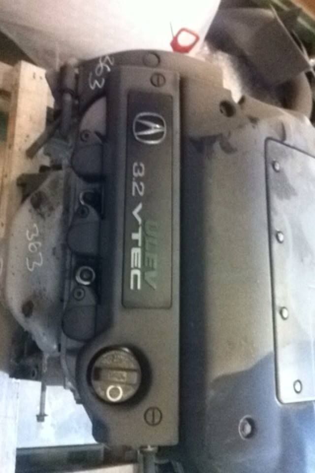

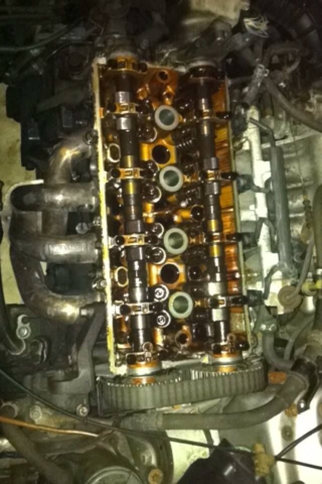

        Spotted a motor on our stands and thought about a possible swap. Then my B18 started knocking. After much discussion and research, I jumped on it.
        J32A2 V6 out of an 02 Acura TL. Got the motor for $300. Good shape too. It's a bitch of a swap, but I really want to do it for the performance and to be different [Mustard on the beat, ho]. I'm going to pull the tranny, axles, harness, and ECU at work this week. I'll have to drive another daily until I get this swap in and running 100%. But once I do, watch out, this thing will be NASTY.
