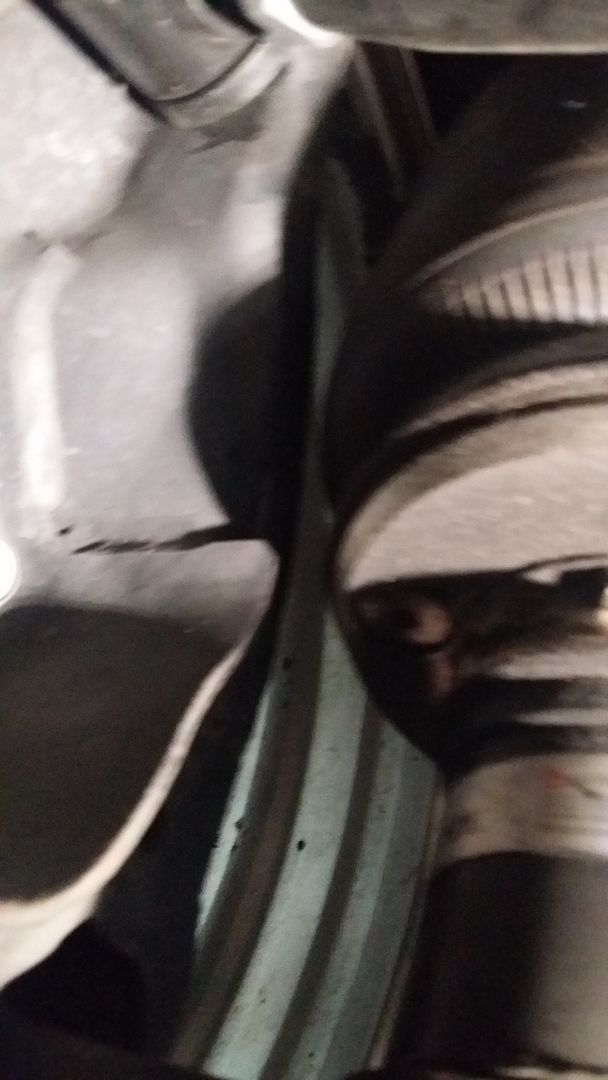

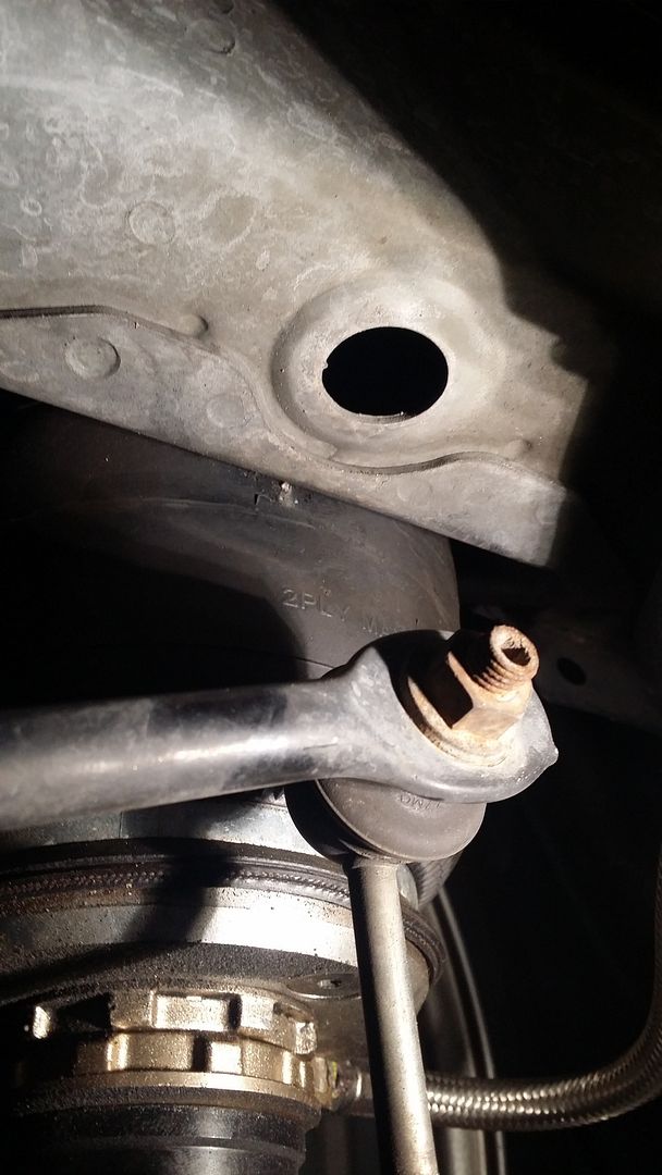

                      • Well just a little update, the system still isn't dialed in. I'm having some problems such as clunking in the rear when airring down, lines getting unmounted and shredded by the tires, leaks, and some "tapping" while driving.
                        Luckily I got up on a drive on lift Friday with a technician and had him do a full walk through of my system with me. Turns out my rear bags are rubbing, and if I don't do something tonight they may tear and I'll need 2 new bags. It's getting pinched between the frame rail, and the control arm that the hub mounts onto. The bags are wider than the stock suspension so it's an issue. We are going to attempt to shave the frame rail to allow some more travel room and shave the part of the arm where I'm getting caught up.
                        My bags still need to get threaded up more on the coilover as it's a little low which I believe is causing the tapping because it's not 100% secured and while the rear suspension is off I'm going to adjust the dampening because it's really soft in the rear right now.

                        • Here's where it's getting caught on the control arm(I'm aired up in the picture.
                          And the frame rail in question.
                          • I feel your pain on these teething issues.
                            I wonder if you need to notch the frame, like VW guys do for halfshaft clearance, but rotated 90º to clear that bag.
                            Glad to hear problems are being positively identified and progress is being made. Unfortunately, this is all just part of bagging a car that nobody (or in my case, practically nobody) has done before. You'll get there.

                              Yeah, I'm sure I'll get them worked out just one thing at a time. It took awhile to identify the problem mainly because I needed the car in the air, but still have the weight of the car. Luckily a friend really stepped up and stayed late at the dealership and threw me on the alignment rack since it was the only drive on lift they had.
                              Hopefully we can get something temporary done tonight just for safety until I can find someone to notch that section properly.
