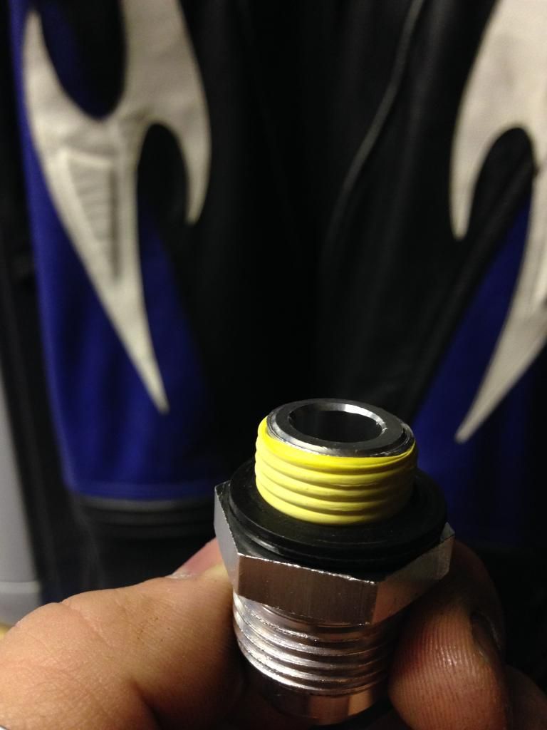

Punching out the old pins, Drilling out to 17/64" and tapping with M8 x 1.25

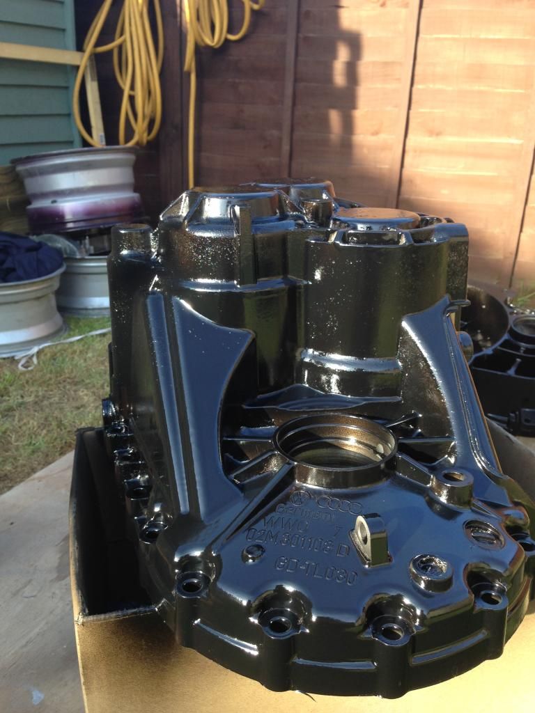

I managed to get back from work and get a little more done, gave the block it's first paint with some Por15 I had from one of my previous engines I built, waste not want not, plus I love the stuff really worth the money.
Have the block a prep which took a bit of work

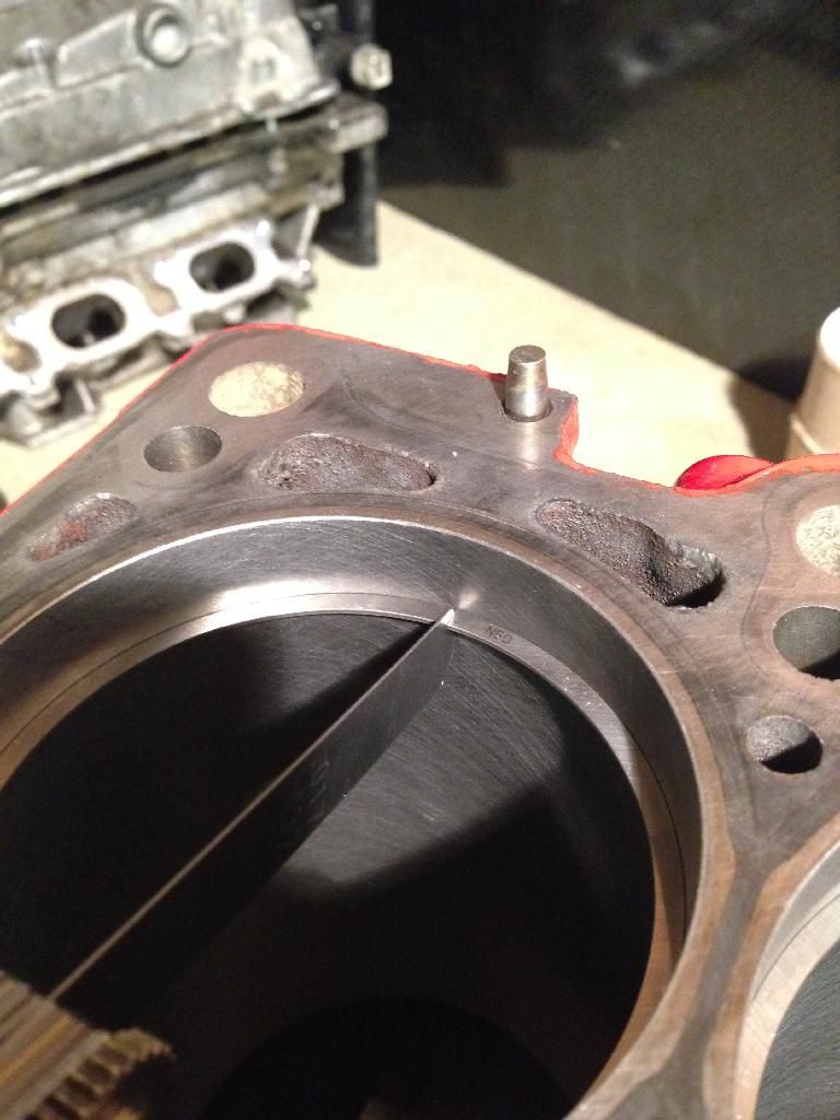

Moving along to checking tolerances and gapping the rings, 17thou top, 19thou bottoms. These were gapped to the absolute T.. the more anal you are with building your engine, the stronger and better it shall be.. Or so I keep telling myself haha.

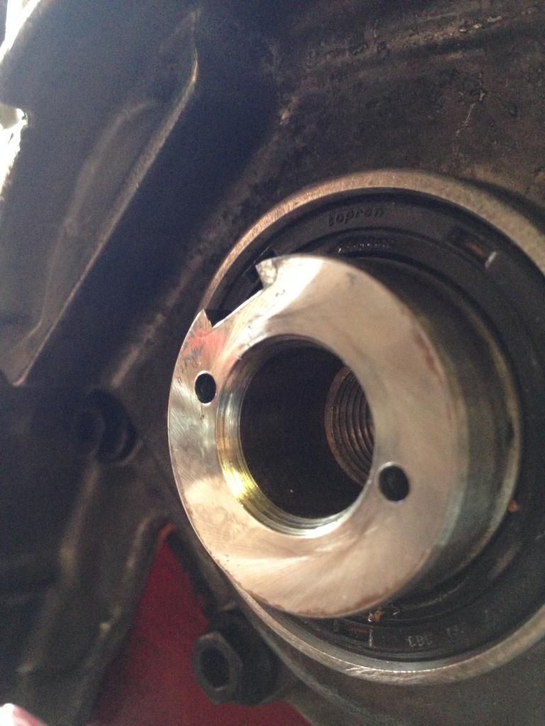

Time to get the crank pegged
Cut to length
No brainer really... isnt it?
Found this old bad boy crank tool I smashed together in few mins from a few years back, and its lasted this long ?!
