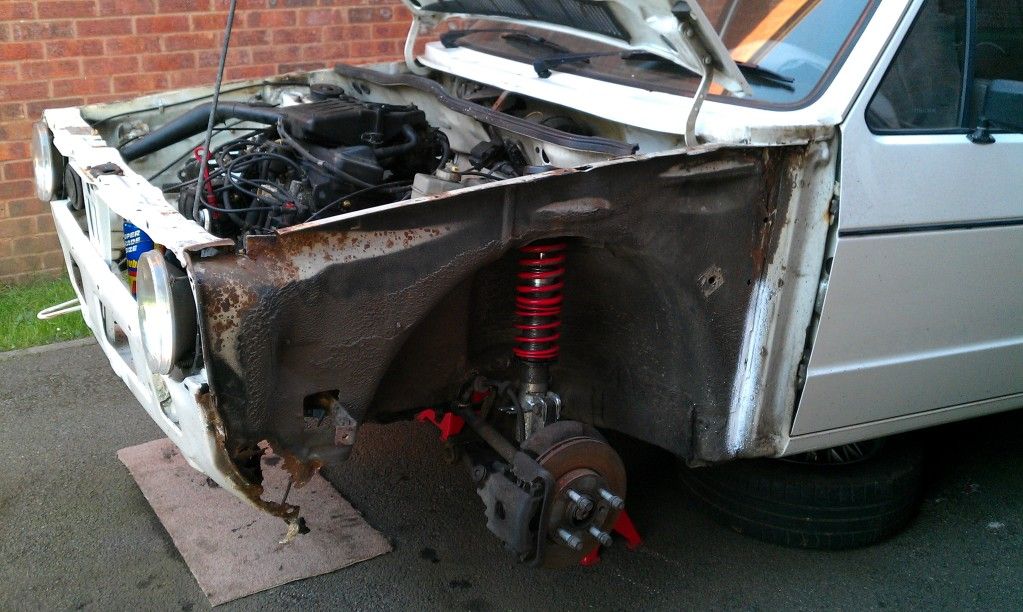

So about now was the time I had been dreading, Finding the extent of the rot. Being an import they never really treated the car how it should have been, Dribs and drabs had been done where ever they thought was necessary but nothing great.
Inner lowers rotted, Pretty standard on the Mk1's.
Rot Rot Rot
At least its straight !
