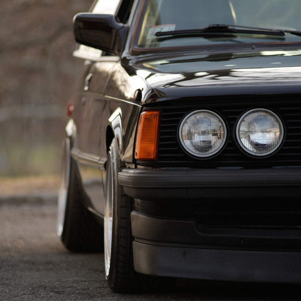

                Car got a feature on Petrolicious! Since those photos the car has been lowered a little more, and front wheels have been spaced out a bit. New photos soon...
                Owner: Sam Webber Year, Make, and Model: 1983 BMW 320is (E21) Location: West Brookfield, Massachusetts Photographer: Caleb Vincent DesCognets I became interested in cars after buying my first one, a Volkswagen GTI mk4. It was a fun car that left me wanting a faster car, then an older car, and then a more 'stylish' car.
