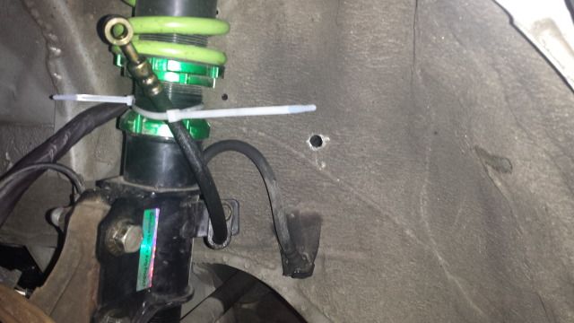

    Got the wire from the Starter ran through the same hole in front of the clutch into the door sill along the driver side and into the spare tire well. I also drilled out the hole in the fender arch that the new fusebox harness ran through, so that's done.

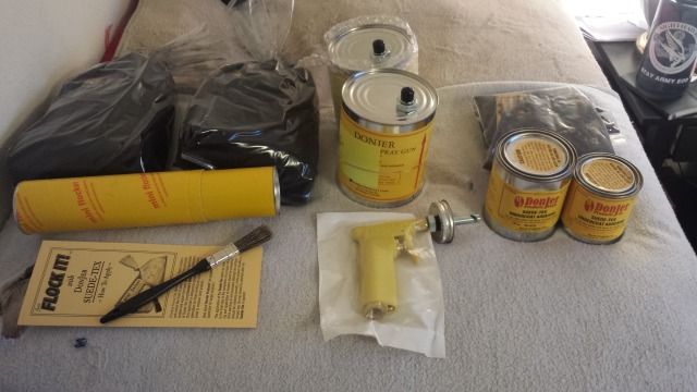

    In the mean time, the stuff to flock the interior showed up. I'm hoping to get started flocking the charcoal gray parts before this weekend.

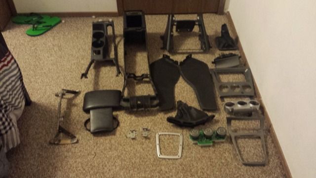

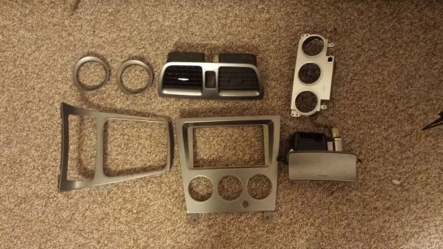

    In prep to do the rest, which will be black, I disassembled the 06/07 STI center console as far as it'd go.
    Because they're high wear areas, all the parts here are getting mailed off to be vinyl wrapped in matte black.

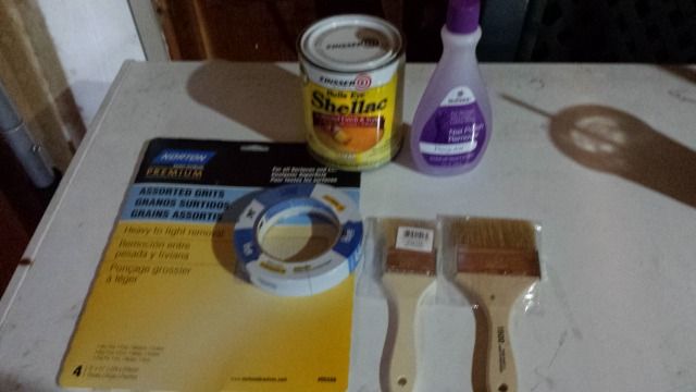

    Quite a bit finished up/worked on since the last time I posted. I've also had a couple changes made to the direction some things are going. Mainly, I decided that I'm not going to be ordering anymore Alcantara. At $110.00/yd, and the difficulty of working with it, I just don't think the end result is really worth it. The ~3 yards I have now will be used for the headliner, and any scraps will be used for a shift boot and other miscellaneous things. After doing a considerable amount of research, I realized that flock is a reasonable alternative. I ordered a couple pounds of black nylon flock and 3 ounces of charcoal gray to do some accents with. http://www.flockit.com/
    In preparation to do the flocking, I sanded down all the interior trim pieces, then further wiped them down with a red scotchbrite and acetone to remove any of the stuff left over. I went over to home depot and got some shellac to cover the dash and the other pieces with "texture" to them. This should create a nice uniform surface for the adhesive

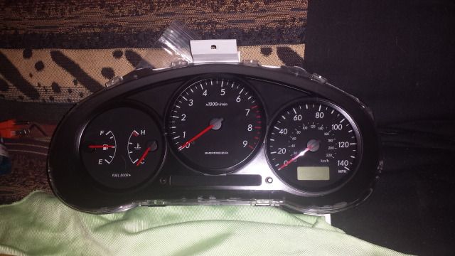

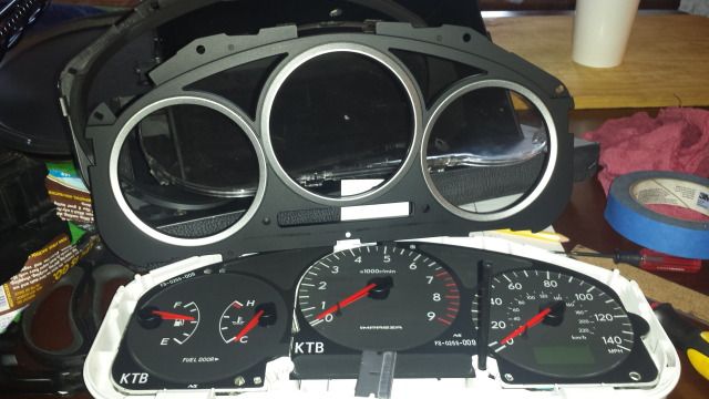

    In order for everything to match up nicely, I disassembled my gauge cluster, sanded down the silver rings you see, cleaned them with acetone and sprayed them black.

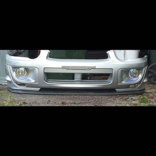

    Got my JDM multi color foglights and bezels installed onto my bumper today. Very excited about this.

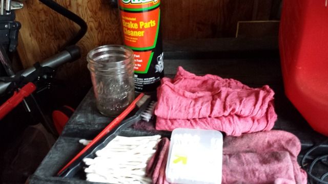

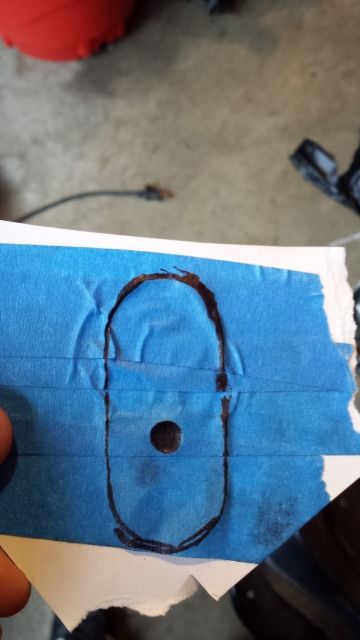

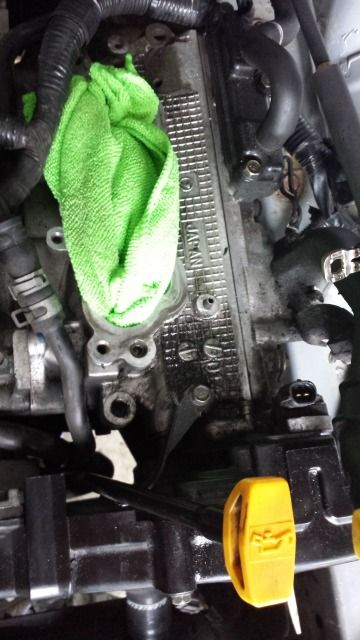

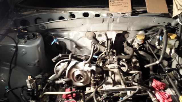

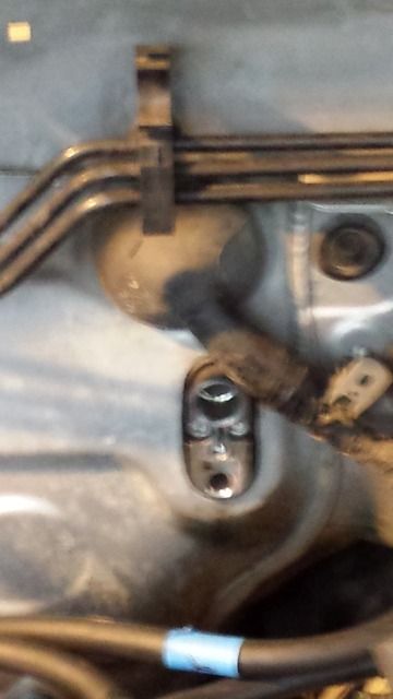

    Finally worked up the ambition to get out and get some work done this evening. The first thing I did was take some masking tape and tape over this port that the AC lines used to run into.
    I then traced the outside of the port and made an indent where the threaded hole is. I've got a friend who's a machinist, so I'll have him cut me a plate that'll sit flush and cap this off. Less welding is better for me. I don't mind just capping stuff off where I can get away with it.

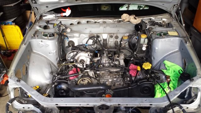

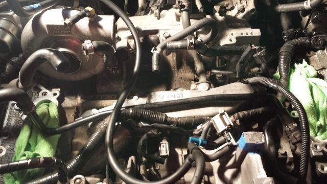

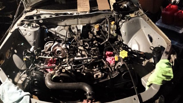

    I gathered up some cleaning supplies (brake clean/toothbrushes/qtips/rags) and got to cleaning off some of the grease and junk that's on the motor and tranny.
    And last, but not least..the brake lines that are in the engine bay are gone.
    That about does it for stuff that needs to be deleted out of the bay. I still need to reroute and shorten up some of the vacuum line, and generally just move some other shit out of the way.
