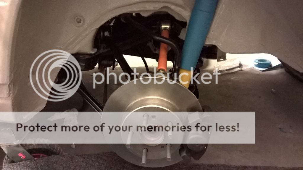

Rear brakes in place.
Test fitting wheel, 10x17" ET25
