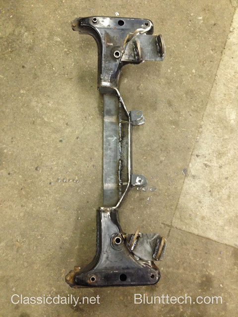

              Well the subframe from before was a bust.... The z3 steering rack was wanting to be in the same spot as the header. So we start again.
              The engine about in it's final location
              This is the e30 m3 rack rotated slightly down to clear the header.
              Rack in it's new home in the subframe jig.
              Bending a piece to connect the dots
              Trimmed down and tacked together
              Testing and ears for rack
              Boxing it in
              You can see a piece of bent plate going under the pan here. This piece was fun to make.
              Tacked together
              Clearance to the pan...around 1/8-1/4"
              Out of the car
              I really like how this part came out. Some little open holes still.
              Before (opposite side of after pic)
              After
              Still more cleanup needed.
              Entire thing before welding...

                  This update is from a few weeks ago but just finally getting around to uploading all the pics and posting.
                  Welding the new subframe up.
                  Starting on mounts
                  drivers side
                  These will be fully boxed and also a new set of plates will be drawn and then water jetted. These are the mock ups.
                  Subframe with mounts welded on
                  And with both mounts connected. All this will be powder coated
