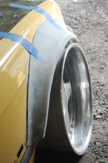

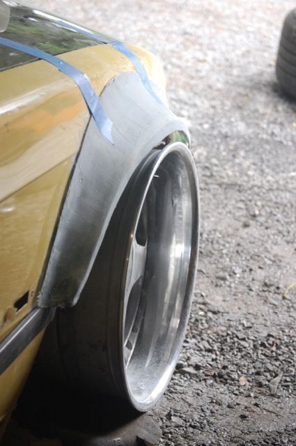

    so not that anybody asked me, but i think what mr sparkler is saying is that the shape of the arches in relation to the car is off, maybe. so using my superdooper editing skills i stole from a 2 year old i made a pictar to hang on the fridge
    widearchededit1
    looks like you've put a lot of hard work into this, the paint looks great, as someone else said your headed down the MAX car path, but its your car please continue.
    Agreed, needs to taper back into the body more imo. but to each his own. Keep going

      Thanks for the input, i can understand this criticism i did toy with tapering it into the body but it didnt look right, i think the only thing i would do to change it would be too apply a add on bit to the front bumper to bring it further down.

          Yes, poorly arched. They don't flow and look like they oil-can like a mo fo!

            very poorly arched first i love this thread but then see that you dont make the arches fit and see the crappy fake rims, now it isnt interessting anymore.

              I apreciate the hard work in specially because it was made by yourself , but the arches are not my style , maybe some modified oem ones would have been looked better

                In waiting for fitment to be sorted before thinking of adjusting the arches, i dont know how its going to sit until the wheels are on, then adjustments MAY be made. oil can?
                • #53

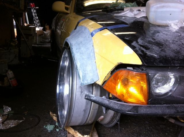

                  These are the angles that really throw me off. You're kind of mixing widebody style with flares. You should flow the flares into the body above the moldings and bumpers like the other guy said. OR make the part that goes onto the bumpers and over the moldings a seperate piece and flow it back in in a crisper/less rounded way or continue all the way to the bottom. Also it looks like the top center of the arches aren''t the widest part which looks odd.
                  Jaze and I were kicking around flare ideas one day so I glassed up this super rough idea. I tried keeping the factory arch line and doing it kind of liberty walk e46 style. If I went through with them I was going to make a hard cut off or a sharp angle back into the bumpers and quarters with seperate pieces for the bumpers (and probably sepearate pieces for the rear doors as well). With a little work I think this idea could be awesome. Hell maybe I'll make some in the future.
                  18x11 -30
                  Sorry to thread jack just wanted to offer you some more insight. I'm sure your set up will still look pretty good with aggressive fitment. But unfortunately those things are gonna crack like a ma fucka.

                    I like what you've done there Ollie, like that a lot, it was so hard trying to get the arches located properly due to poor original moulds and also the fact that this is the first type of body modifications I have ever done, closest I've done to this before was fibreglass repairing a front bumper. I'm hoping that these will work with the fitment correct but if not, It can always be amended. In regards to cracking, I have my belief in these arches , its not just layer's of filler, they have been fibreglassed, fillered, riveted and am pretty confident they will hold out, only time will tell I guess

                        looks good man! I have to agree with others, the arches do look a little weird now that they have been pointed out, though I never noticed. Good luck with the rest of the build, I want to see these wheels on it.
                        • #57
                          I'm also from South Wales or S|W those arches would benefit from some chopping but you have the right idea
