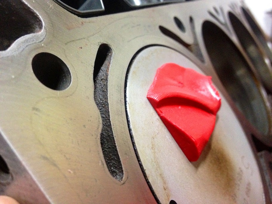

    New cam came in, I set it up, measured my piston to valve clearance and degreed it in. Pistons are going to need to be flycut as I thought, no big deal. I'll get to it this week. Got the new LS6 valley cover on, it has the PCV built into it.
    .029" clearance. .080" is considered "safe" .100 is optimal

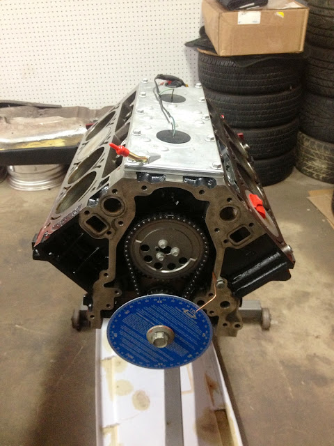

        The engine is finally about to go together, I just had to degree the cam in to find the centerline. It's an advertised 109 degree centerline, it came in a 108.5, I'm happy with that.

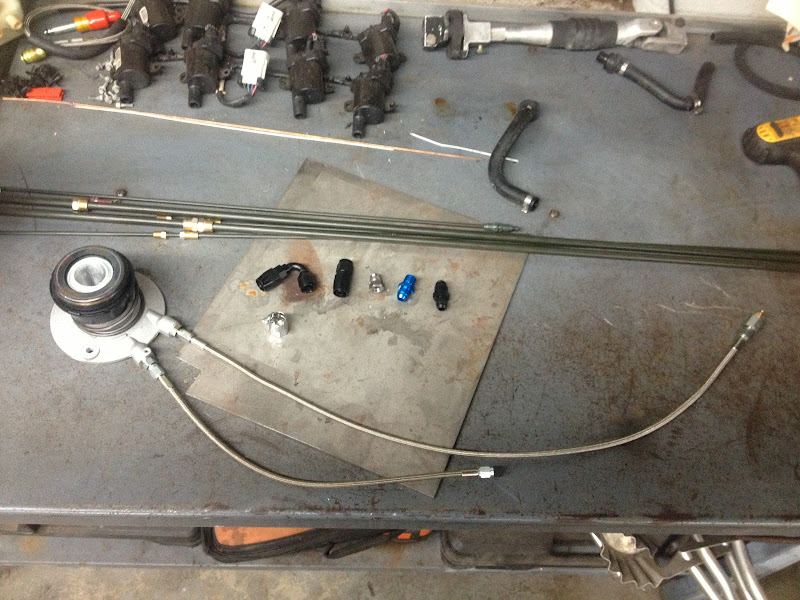

        Got a few more things done. Picked up the fittings I needed for power steering as well as made my clutch line and remote bleeder.

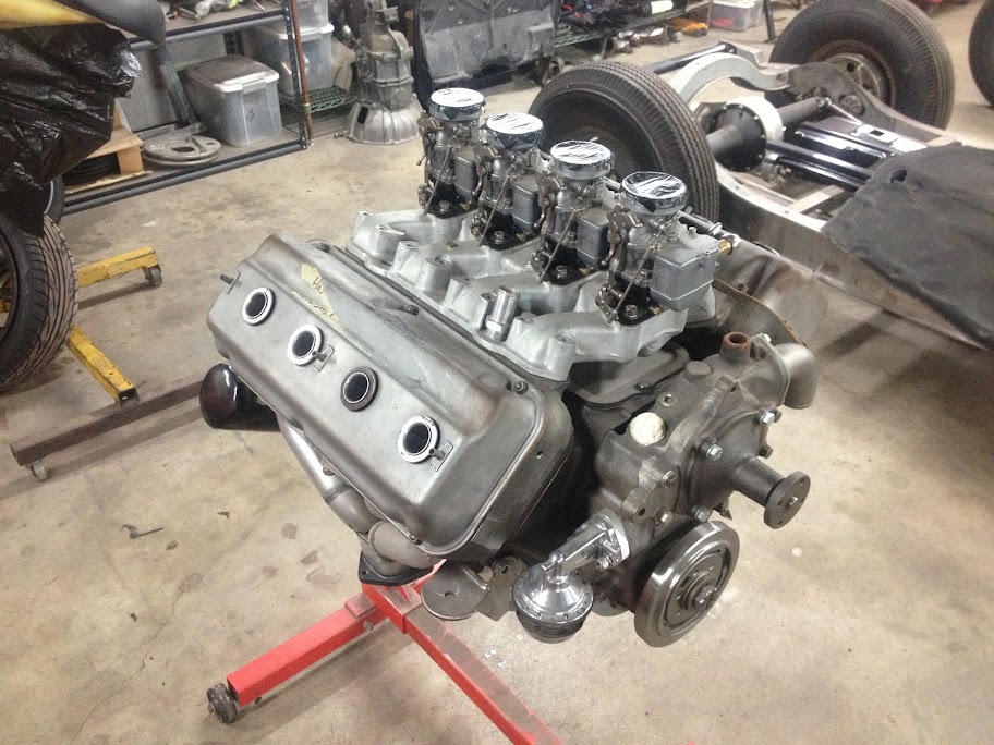

          And just because, the DeSoto hemi going in my '32 Ford you can see behind it. 401hp out of 291 cubes. This thing sounds AMAZING, partly due to the .630 lift solid roller cam

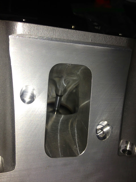

            I received the flycutting tool I rented in the mail today. It's an LS3 head with the valve seats removed so the cutting head will fit in there. A shaft connects it through the valve guide and you use a tap handle to turn it and cut the piston. There's a collar on the shaft to set the depth on how far you want to cut. I'm running my clearances tight, but I still needed to take .050 off. Turned out great, so this thing is about ready to go in. Just need to torque the heads down and put the rockers in.

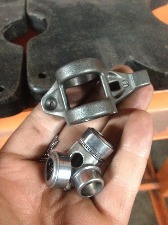

            he factory GM trunion bearings are needle bearings on a shaft enclosed by a pressed in metal race on each side. These are prone to failure on LSx engine with higher lift cams as well as higher revs, thus puking them out into the engine which can be catastrophic. A cheap insurance policy is Comp's trunion upgrade. It uses 2 separate enclosed bearings for each side, a shaft in the center, and C clips lock rings on each end, virtually failure proof if installed correctly.

            All stripped
            The Comp components
            All assembled
